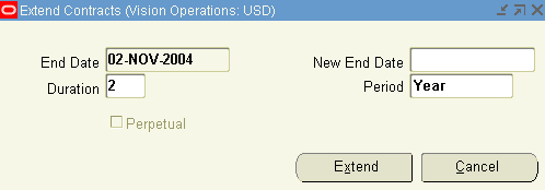

From the Contract Navigator, highlight a contract and right-click.
Select Extend.
The Extend Contracts window appears.
Select a Duration and Period.
The End Date field is populated based on the duration and period.
Select Extend.
A decision message indicating that the contract was successfully extended appears. Click Yes to save changes.
To verify if that the contract was extended, highlight the contract and right click.
Select Open.
The contract authoring window appears.
Check the duration of the header to verify whether the contract was extended.
Select the Lines tab and Effectivities subtab to verify whether the lines were extended.

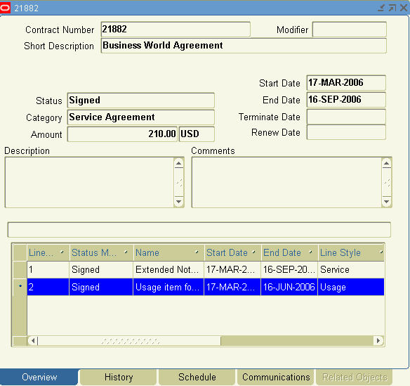

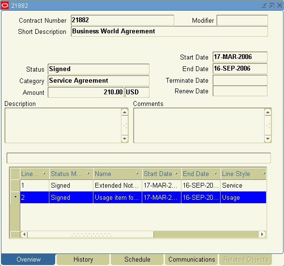

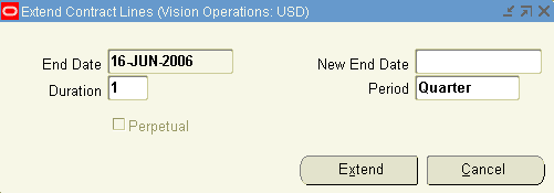

From the Contract Navigator, select the contract that contains the line to extend.
Double-click the contract to open the Contract Execution window.
Select the Overview tab. The lines of the contract appear in the lower portion of this tab.
Highlight the line you want to extend, right-click and select Extend Line.
The Extend Contracts Line window appears.
Enter a duration and period.
Click Extend.
A decision box appears, indicating that the line was successfully extended.
Select Yes from the decision box.
Close the Contract Execution window and return to the Contract Navigator.
To verify that the contract line was extended, return to the Contract Execution window.
Select the line, right-click, and select Refresh.

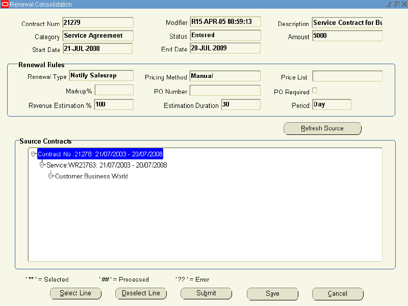

From the Service Contracts Authoring window, select the Summary tab and Renewals subtab.
From the Pricing Method LOV, select a pricing method.
If you have selected Price List, then enter the price list to be used for the renewal in the Price List field.
If you have selected Markup Percent, then:
Enter the percentage, which adjusts the price accordingly. Entering a positive number marks up the price. A negative number discounts the contract renewal.
If you are marking up the contract price and wish to put a limit on the maximum price the customer will pay, then enter a price list in the Price List field. The price of the renewed contract cannot go over the price listed in the price list.
For example, if you enter 20% as your markup and the current list price of the service is $100, then the renewed contract is priced at $120. If you enter a price list that lists the service at $110, however, then this price list caps the maximum price for the service at $110. The customer pays a maximum of $110 for the renewal.
Note: The price cap works only for (positive) markups and not for discounts.
From the Contract Navigator, highlight an active contract.
Right mouse click to select Renew.
The Renew Contract window appears with the following fields populated:
New Number: new contract number.
New Modifier: a modifier to differentiate the old and renewed contract.
New Start date: new start date.
Enter the Duration and Period.
The New End date field populates after you enter the duration and period.
Note: If your contract is a large contract, you may wish to process the contract in the background. You can do this by selecting the Submit Request check box.
Click Renew.
A decision message appears indicating that the contract successfully renewed. Click Yes to save changes.
The Contract Navigator appears.
On the right hand side of the form, right mouse click to select Refresh.
You should be able to identify the contract with the new modifier.
On the right hand side of the form, highlight the contract with the New Modifier and right mouse click to select Open.

From the Contract Navigator, select a target contract, right-click and select Renewal Consolidation.
The Renewal Consolidation window appears.
Note: The Renewal Rules region references the rules that will be applied to all lines, which are consolidated into the target contract.
Click Query Source.
If there are no contracts eligible as source contracts for the target contract, the lower half of the window will remain empty.
To select a line, highlight the branch and click Select Line.
If selected the source line is identified with **.
To deselect a line, highlight the branch and click Deselect Line.
If a branch with child branches is cleared, all the child branches are also cleared.
A single child branch may be deselected, as required. If deselected, the source line(s) are no longer identified with a **.
You can reselect the Source lines by highlighting the line and clicking the Select Line button.
Note: If a source contract is deselected and the operation instance is submitted for renewal consolidation, it may be selected at a later time for consolidation in the same target contract as long as the target is still in Entered status. If the target contract has already been approved and activated, the contract may be consolidated as a source in another target contract.
Verify source lines are valid for consolidation.
To save and retrieve the consolidation at a later review, click Save. You can leave this window and when your changes are reflected in the Renewal Consolidation window.
To submit the Renewal Consolidation, click Submit.
A Note window with a concurrent request id appears.
Save.
You can refresh the window by clicking Refresh Source to monitor the processing. After the line has been consolidated the ## appears next to the line, which indicates Processed.
Open the target contract and verify all source contracts have been consolidated successfully.
Submit contract for approval.

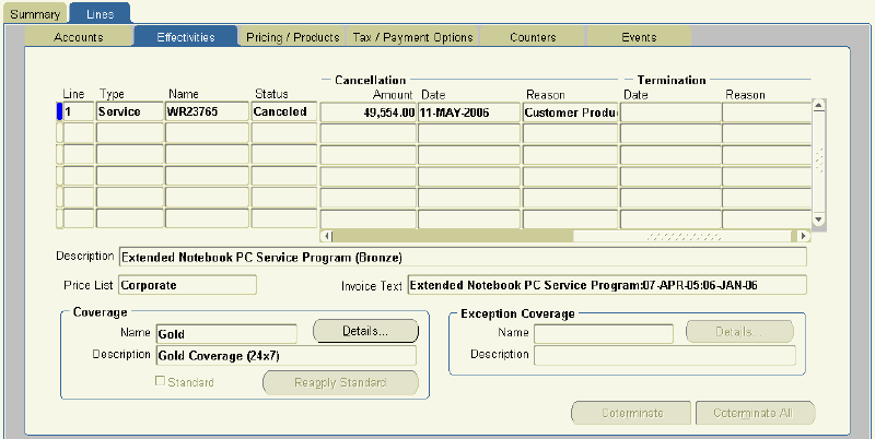

To cancel a contract line
Select Lines tab and Effectivities subtab.
Select the line to cancel.
From the Tools menu, select Change Status. The Service Line Status window appears.
From the New Status LOV, select Canceled.
Select a reason from the LOV.
Select OK. A confirmation message appears. Click OK to continue.
The Status field within the service line is Canceled.
Scroll right to view the Cancellation fields, Amount, Date, and Reason.
Select the Pricing/Products subtab and Effectivities secondary tab. Cancelling the line cancels the subline.

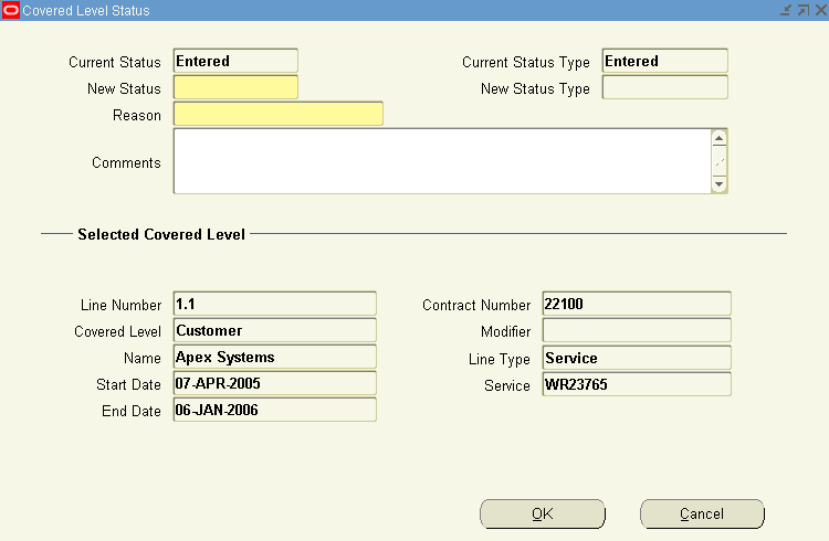

To cancel a contract subline
Select Lines tab and Pricing subtab.
From the Effectivity secondary tab select the subline to cancel.
From the Tools menu, select Change Status. The Covered Level Status window appears.

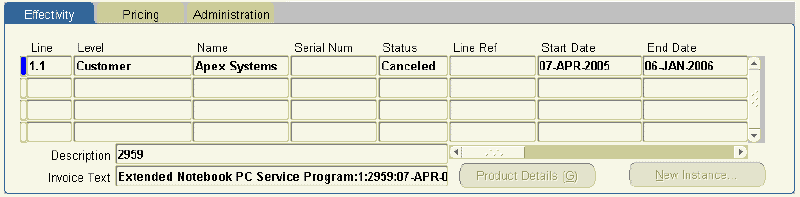

The Status field within the service subline is Canceled.
Scroll right to view the Cancellation fields, Date and Reason.
Select the Effectivities secondary tab. Cancelling the subline does not cancel the line.
