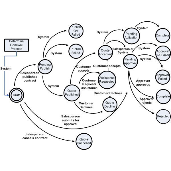

The following diagrams provide an overview of status transitions during contract negotiation.
Note: For new contracts, the status transitions are the same as those of a manual renewal process, except for the Determine Renewal Process step, which does not apply to new contracts. Refer to Manual Renewal Process Status Transition State Diagram.
The preceding diagram shows negotiation status transitions during a manual renewal. The following describes the process:
Determine Renewal Process: System changes negotiation status to Draft.
Draft: Salesperson publishes contract and negotiation status changes to Pending Publish, or salesperson cancels the contract and the negotiation status changes to Quote Canceled.
Pending Publish: System changes negotiation status to Publish QA Failed, Publish Failed, or Quote Published.
Pending Approval: Salesperson submits the contract for approval and one the following occurs.
System changes negotiation status to Approval QA Failed.
System changes negotiation status to Approval Failed.
Approver approves contract, which changes negotiation status to Complete.
Approver rejects contract, which changes negotiation status to Rejected.
Quote Published: If the system updates the negotiation status to Quote Published, one of the following occurs:
Customer accepts the quote and the negotiation status changes to Quote Accepted.
Customer requests assistance and the negotiation status changes to Assistance Requested.
Customer declines the quote and the negotiation status changes to Quote Declined.
Quote Accepted: Either the system updates the negotiation status to Pending Activation, or the salesperson or system updates the negotiation status to Pending Approval.
Assistance Requested: After the customer receives assistance, he can choose to either accept or decline the quote.
Quote Declined: Customer declines quote.
Pending Activation: System changes status to Complete.

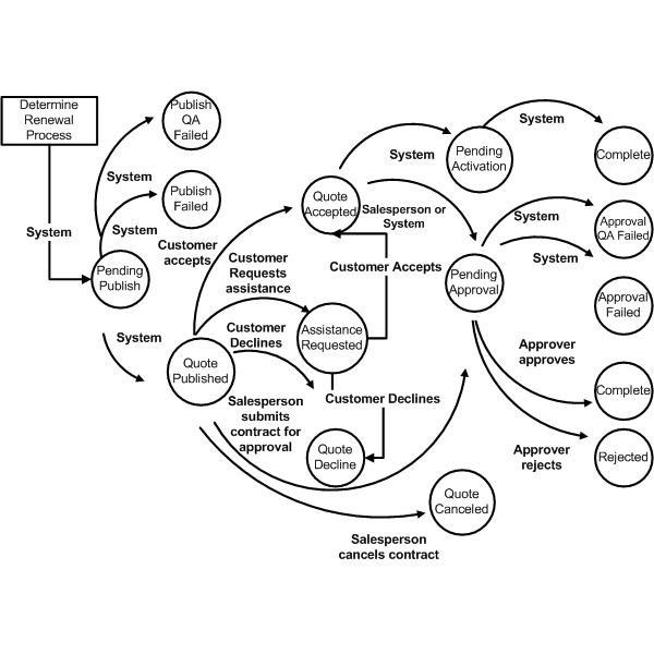

The preceding diagram shows negotiation status transitions during an online renewal. The following describes the process:
Determine Renewal Process: System changes negotiation status to Pending Publish.
Salesperson accepts the quote and the negotiation status changes to Pending Approval.
Salesperson cancels the quote and the negotiation status changes to Quote Canceled.
Quote Accepted: Either the system changes the negotiation status to Pending Activation or the salesperson or system changes the negotiation status to Pending Approval.
Assistance Requested: After he receives assistance, the customer chooses to accept or decline the quote.

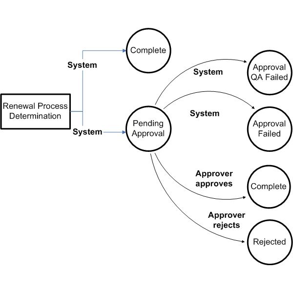

The preceding diagram shows negotiation status transitions during an evergreen renewal. The following describes the process:
Determine Renewal Process: System changes negotiation status to Complete or Pending Approval.
Pending Approval: One the following occurs.
