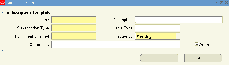

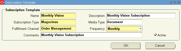

A subscription template contains attributes, that are associated to a subscription item in Oracle Inventory. The attributes include Subscription type, Media and Property type, Fulfillment Channel, and Frequency.
A subscription item can be a tangible item like a magazine, or an intangible item like a membership.
Currently Oracle Order Management is supported as the fulfillment channel. If no fulfillment channel is specified, it is considered an intangible item, and no delivery schedule is created for that item. Subscription Frequency such as Yearly, Monthly, Weekly, and Daily identifies how often an item should be delivered.
The following procedure describes setting up a subscription template, Setting Up a Subscription Template.

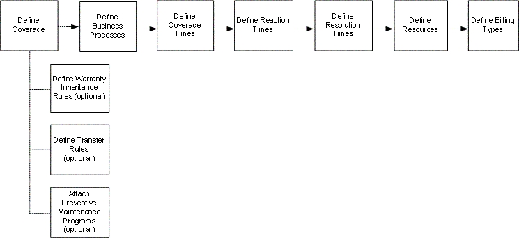

Creating a Standard Coverage
The preceding diagram shows the steps necessary to complete standard coverage. A description of the steps and an example follow:
Define Coverage: Specify coverage name, type, importance level, effective dates, warranty inheritance, transfer rules, or attach a preventative maintenance program.
Define Business Process: Specify the business processes that the Standard Coverage will use.
For example, select the Field Service business process. You will need to define coverage times, reaction times, resources, and billing types for each business process that you add.
Define Coverage Times: Specify the days of the week and hours used to calculate reaction and resolution times. A customer can request service anytime. If they call up support, the service agent will not turn down the call if the call is beyond the coverage times. The coverage times simply determine the starting point from where you start counting reaction and resolution times. For example, if coverage ends at 5 p.m. on a Monday and starts again at 9 a.m. on a Tuesday, with a two-hour response time, then a call received at 4 p.m. on Monday, will have a respond time of 10 a.m. Tuesday (assuming that work through is not selected). If the coverage is 24 hours per day, seven days a week, then the respond by time would be 6 p.m. Coverage times are defined for each business process as part of coverage terms, and they are applicable to one time zone.

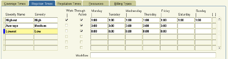

Define Reaction Times: Specify the allowed amount of time by which action must be initiated for a requested process.
For example, set up reaction times of two hours on Monday through Sunday, Therefore, you must respond within two hours of being notified by the customer.
Reaction times are tied to severity.

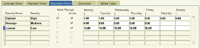

Define Resolution Times: Specify a fixed time per contract by which a normal operation should be restored. The Resolution Times will be made available to other functions, such as Service Request.
For example, you could set up resolution times of eight hours Monday through Friday, which means if the customer calls Monday through Friday you must resolve the issue within eight hours.
Resolution times are tied to severity.

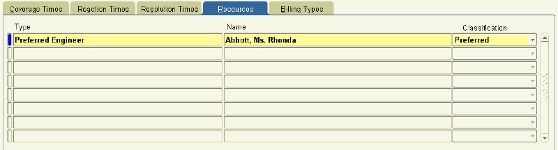

Define Resources: Specify the list of resources that are eligible to work on a specific task when a service request is created. Resources can be classified as Primary, Preferred, or Excluded.
For example, identify a primary service engineer that responds to service calls.
This information is used by Assignment Manager to assign a service engineer.

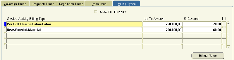

Define Billing Types: Specify for each Business Process, what type of work is covered, to what limit, and at what rate. The billing types and rates are used when calculating the amount to charge a customer when work has been performed.
For example, define a replacement transaction type where the customer is charged for material and labor.

From the Reaction Times tab, enter the following:
Severity Name: Enter a name for the severity definition, for example, Level 1 or Important.
Severity: Select the level of severity, for example High, from a LOV.
Workthrough check box: If selected, this check box overrides the normal coverage times for that transaction.
For example, suppose you have support between 9 a.m. and 5 p.m. from Monday through Friday with a two-hour reaction time. If a customer calls at 4:45 p.m. in the middle of the week and Work Through is selected, then the customer is entitled to receive support by 6:45 p.m. that evening. If the Work Through option is not selected, then the support representative has until 10:45 a.m. the next morning to respond to the call.
Active check box: If selected, this check box indicates this severity level is active and makes the reaction times available through an entitlements call.
Reaction Times for days of the week: Enter specific reaction times, in hours, for each applicable day.
For example, if 2:00 is entered in the Monday field, then a service call must be made within two hours if the call occurs on Monday.
Workflow: Select the applicable workflow for each reaction time name specified.
From the Resolution Times tab, enter the following:
Severity Name: Comes from the Severity Name on the Reaction Times tab.
Severity: Comes from the Severity on the Reaction Times tab.
Active check box: If selected, this check box indicates this severity level is active and makes the resolution times available through an entitlements call.
Resolution Times for days of the week: Enter specific resolution times, in hours, for each applicable day.
For example, if 4:00 is entered in the Monday field, then the issue must be resolved within four hours if a call occurs on Monday.
From the Resources tab, enter the following:
Type: Select a resource type from the LOV. For example, Engineer.
Name: Select the resource by name.
Classification: Select the proper classification for the resource from the LOV.
You can classify a resource as Preferred, Primary or Excluded.
If you classify a resource as Excluded, the Assignment Manager removes the resource from the list of available resources.
From the Billing Types tab, enter the following:
Service Activity Billing Type: Select the billing type from the LOV.
Duplicates are not allowed.
If the billing type is Labor, then the Billing Rates button is enabled.
Up To Amount: Enter the maximum allowed amount.
If you leave this field blank, the upper limit is restricted by the percentage covered or discount you enter in the % Covered field.
% Covered: Enter the percentage covered or discount.
For example, if new parts have been installed to fix a problem at a customer site, the bill for the work needs to be calculated, taking the coverage on the service contract into account. If parts are covered 50% up to a maximum of $300, and the charge for parts was $800, after applying the rates agreed on the contract, the charge would be calculated as $500, after the maximum discount of $300 has been applied. For the same contract rates, if the charge for parts came to $500, the customer would receive the full 50% discount ($250) because the discount is below the $300 maximum.
Allow Full Discount check box: If selected, this check box provides 100% coverage for warranties without requiring setup of billing types. If unchecked on the template, the box will be grayed out on the contract. Any bill types data populated on the template will override the use of this check box.
Billing Rates: Check this button to open the Billing Rates form.
Save.
From the Navigator, navigate to Service Offerings, and then select Subscription Template.
The Subscription Template window appears.
In the Name field, enter a name for the template.
Examples of names include Monthly or Yearly.
In the Description field, enter a description for the template.
Examples of descriptions include Monthly Subscription and Yearly Subscription.
In the Subscription Type field, select the type of subscription from the LOV.
Examples of subscription types include journals, magazines, and newsletters.
In the Media Type field, select the type of medium from the LOV.
Examples of medium include document, image, and audio.
In the Fulfillment Channel field, select of one the following options:
Order Management: for tangible items that need to shipped
None: for intangible items
In the Frequency field, select a subscription frequency:
Daily
Weekly
Monthly
Yearly
Enter any additional information in the Comments field.
Verify that the Active check box is selected to ensure that the subscription template is active.
Select OK.
