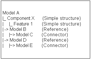

This section discusses Oracle Configurator concepts you need to be familiar with before implementing a TSO solution.
Some of the diagrams that appear in this chapter show the structural relationship between Connectors and Components of a Model. The following sample diagram and table show and describe the conventions for the Model diagrams.
The following table refers to the preceding diagram.

Using the structure in the following figure as an example, you can create rules using nodes from Connector A and Connector B, even though their targets are the same. (You can also create rules using nodes from Connector A and Connector B if their targets are different.)
Connectors to the Same Trackable Model
If a configuration rule violates any of the requirements in this section, Oracle Configurator Developer displays an error when you generate logic.
