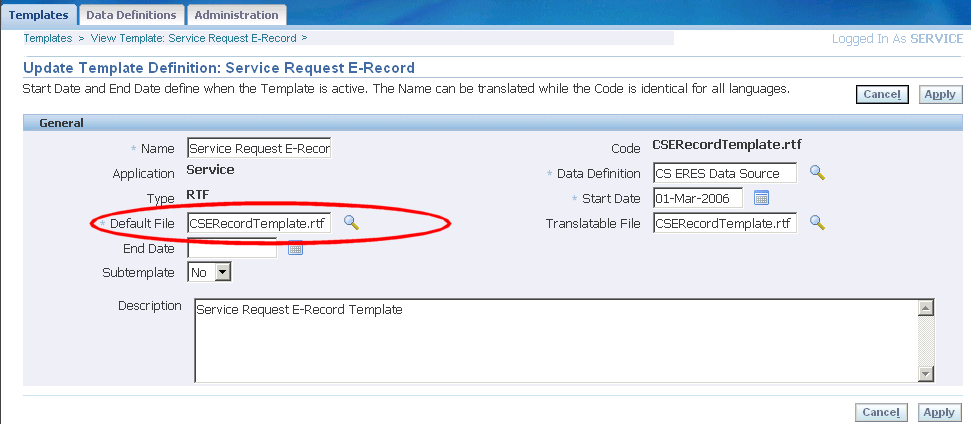

The template (CSERecordTemplate.rtf) is an RTF document with embedded XML codes that pull in service request information. The template is set up to provide either a summary or a detailed report. For a listing of the attributes listed in each report and the differences between them see About the E-Record Template.
By default, the application generates the summary report to conserve system resources. You can modify the electronic record template to remove or add attributes or change its appearance. If you do, you must upload and register the new file using either Oracle XML Publisher or Oracle E-Records. For details, see Downloading and Registering the E-Record Template.

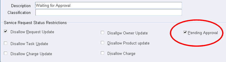

An intermediate status is the status of the service request while it is waiting for the approval process to complete, for example, “Waiting for Approval”.
To create an intermediate status, you must select the Pending Approval check box while setting up the status in the Service Request Statuses window. The image below highlights the check box.

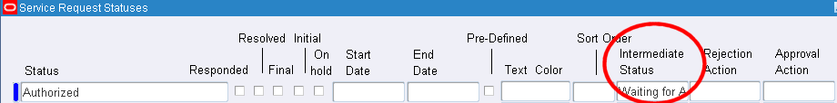

A status you are setting up becomes a triggering status when you enter an intermediate status in the Intermediate Status field as highlighted in the following image.
If your process generates an electronic record only (no approvals required), then you must still enter an intermediate status. However, as the e-record gets generated immediately when the service request is updated, the application never sets the service request to that intermediate status.

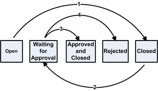

Approval Before Closure With Approval Action Status
Suppose you create the statuses listed in the following table for the approval process:
| Status | Description |
| Open | Initial |
| Closed | Triggering and Final |
| Waiting for Approval | Intermediate |
| Approved and Closed | Approval Action and Final |
| Rejected | Rejection Action |
The application behaves as follows (numbers in brackets refer to the diagram below):
An agent wants to close the service request and so sets the service request status to Closed (1).
If no approval process is triggered by the rules you set up, the service request remains Closed.
If approval is required, then the application sets the status to Waiting for Approval. (2)
If the service request is approved, then the application resets the service request status to Approved and Closed(3)
If it is rejected, then the status becomes Rejected.(4)
Note that the service request can end up in one of two final statuses: the triggering status “Closed” if no approval is required, or “Approved and Closed” if approval is required and obtained.

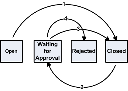

Approval Before Closure Without an Approval Action Status
To set service requests to the same “Closed” status regardless of any approval process, you can set up your statuses without the rejection action status:
| Open | Initial |
Then the application behaves as follows:
The agent sets the service request status to Closed (1).
If your rules determine that service request requires no approval, the status remains Closed.
If approval is required, then the application sets the service request to Waiting for Approval (2).
If the service request is approved, the application resets the service request status back to Closed (3)
If it is rejected, the status gets set to Rejected.(4)
If you do not enter a rejection status, then the application reverts the service request to its previous status. If the agent had changed the service request from “Open” to the triggering status “Closed”, a rejection resets the status to “Open”. If you do not use a rejection status, then agents cannot tell that the service request was rejected without looking at the history log.

Create the intermediate status. The procedure is almost the same as that described in Setting Up Service Request Statuses. There is one additional step: for intermediate statuses you must select the Pending Approval check box. When you do, the application automatically selects the following check boxes:
Disallow Request Update
Prevents the service request from being updated while the service request is in the intermediate status.

Optionally, modify the seeded electronic record (e-record) template and register the new version according to the procedures outlined in Downloading and Registering the E-Record Template.
You can add or remove information or modify the template's appearance. Oracle does not recommend extensive modifications. See About the E-Record Template for guidelines and a list of service request attributes used by the template.
Specify the template you want to use for creating e-records and set other variables according to the procedure described in Setting the E-Record Template and Other Oracle E-Record Variables.

Enter a name in the Status field. This is what the agent sees when the application sets the service request to this status.
Enter an intermediate status using the Intermediate status list of values. If the Oracle E-Record process you have set up requires approvals (e-signatures), then the service request will be set to this status until all the approvals are obtained. If no approvals are required, then the service request remains in the triggering status.
If approvals are required, then select the Approval Action status and the Rejection Action status.

If you modify the seeded template, you must upload it under a different name and then make it the default.
This is accomplished by clicking Update and entering the file name (Code) in the Default File field in the Update Template Definition page.
