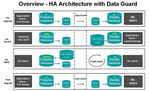

The diagram given below describes the four phases in High Availability.
Pre-Upgrade
The production instance is online and another standby database, a clone of the production instance, is created with Data Guard Flashback, a technology used to track and maintain historical changes to data.
The standby instance is configured to:
Disable responsibilities that are not used in the HA mode. The standby instance will contain only HA responsibilities.
Hide/disable fields and features not supported by HA via personalization.
Disable concurrent programs that are not used in the HA mode.
Disable all workflows and business events that are not used in the HA mode.
When the configuration is complete, the standby database is ready to act as the primary instance for the duration of the outage.
High Availability Record
The production instance is taken offline for patching and the standby high availability is put online. Users can connect to the high availability instance to perform critical business transactions, which are captured and can be replayed in the production instance.
Click Start HA Record on the HA Console to start the HA Record phase. Only one active HA Record session is allowed at any specific time and this phase must end before importing in the HA Apply phase. However, multiple HA Record sessions can be processed during a single HA Apply session.
Once the HA Record phase starts, users can connect to the HA instance.
High Availability Apply
The production instance and the high availability instance are brought down for a limited time and the log from the high availability instance is imported into the production instance.
Once the log is successfully replayed on the production instance, the HA database is refreshed from the production instance so that the HA instance and the production instance are synchronized.
Click the Apply button on the HA Console to initiate this phase. Before this phase is initiated, the transaction logs must be imported into the patched production instance. The HA Console lists all available HA Record sessions that are ready to be applied. If multiple HA Record sessions are pending they are uploaded in a sequential manner, starting with the oldest session to the latest session.
Caution: : The profile Task Manager: Enable Audit is automatically set to No during this phase and administrators must NOT set this profile option manually. This profile is used to enable audit of tasks. It is set to No during the HA Apply phase to switch off auditing of tasks. After the HA Apply phase is complete this profile is again automatically set to Yes.
Post Upgrade
The production instance is brought online and all users are allowed to connect back to this instance.

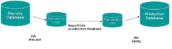

HA Apply
Import the transaction log to the production instance.
Bring up the production instance after the HA instance returns to the pre-HA mode.
Connect users back to the production instance.
Transaction logs comprise several database tables containing all data captured in the HA Record phase. During the HA Record phase the transaction log is used to capture information on users' activities.
You can import the transaction logs using any of the following methods:
Database Links - This method is shipped out of the box with the High Availability feature and includes the script, csmhaimp.sql. This script is used to import data from the selected tables using SQL using database links. The basic assumption is that a database link must be present to import the transaction logs.
Transportable Tablespaces - You can use transportable tablespaces to import the transaction logs if it is not feasible for you to use the database links method. The transaction logs must be a part of a single schema, CSM_HA. The DBA must move these tables into the CSM_HA schema.
The CSM_HA schema must be created in a separate tablespace so that it can be configured to be a transportable tablespace. The tables to be included in the CSM_HA schema are as follows:
