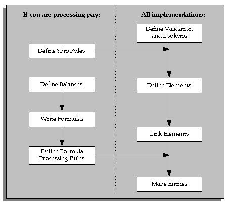

Follow this process to set up earnings, deductions, and other items in the compensation package you offer to employees. This process assumes you are defining elements, formulas, balances, and other rules from scratch. However, you may be able to use template earnings and deductions that you select in the Configuration Workbench, or generate certain earnings and deductions using the Element Design Wizard or template windows, depending on your localization. You can then follow this process to configure the generated or template earnings and deductions, if required.
There are additional steps for setting up the following types of compensation and benefits:
Salaries for Salary Administration; see: Setting Up Salary Administration
Absence elements and PTO accrual plans
Benefits; see: Standard and Advanced Benefits Setup: Overview
Items subject to collective agreements; see: Setting Up a Collective Agreement, Oracle HRMS Enterprise and Workforce Management Guide
Compensation and Benefits Setup
Define validation for entries of any new elements you are creating.
To restrict compensation entries to a list of valid values, define a new Lookup Type and add Lookup Values for this new lookup.
See: Adding Lookup Types and Values, Oracle HRMS Configuring, Reporting, and System Administration.
To validate compensation entries using formulas, write a formula of type Element Input Validation.
See: Writing Formulas for Validation, Oracle HRMS FastFormula User Guide.
To create a matrix of values (such as bonus amount against years of service) for use in formulas or QuickPaint reports, set up user tables.
See: Setting Up User Tables, Columns, and Rows, Oracle HRMS Configuring, Reporting, and System Administration Guide.
If some elements should not be processed in every payroll run, write formulas for element skip rules defining the conditions when the run should process these elements.
See: Writing Formulas for Element Skip Rules, Oracle HRMS Configuring, Reporting, and System Administration Guide.
If the Proration tab is available on the Element window for your localization, you can set up proration. For earnings or deductions that the payroll run should prorate when relevant factors (such as pay rates, grades, or working hours) change during a pay period, make sure you have completed the basic proration setup steps. See: Setting Up Proration.
Define elements and element input values:
To record information about employee compensation, benefits, and equipment
For processing earnings and deductions. (Note that some elements for legislative deductions are predefined.)
See: Defining an Element.
See: Defining an Element's Input Values.
See also: Deleting an Element.
Define frequency rules, if necessary, to determine the periods in which the element should be processed.
See: Defining Frequency Rules.
If the payroll costs of an element should be distributed over other elements, define a distribution set.
Define element links to identify one or more groups of employees who are eligible to receive an element.
See: Defining Element Links.
See also: Running the Element Link Details Report.
Oracle Payroll has many predefined balances installed with the system. You can define other balances.
Define secondary element classifications.
Create classes of balance feeds by entering or removing secondary classifications for your elements.
Define user balances and create balance feeds for individual elements.
See: Defining User Balances.
See: Creating Balance Feeds for Individual Elements.
For information on uploading initial balances, please refer to the appropriate Legislative Balance Initialization technical essay.
Oracle Payroll provides formulas for processing legislative deductions. For other elements, you can write formulas to calculate element results and other processing outcomes in payroll runs.
See: Writing Payroll Formulas for Elements, Oracle HRMS FastFormula User Guide.
To define which formula processes an element for Active assignments (and optionally for other assignment statuses), define processing rules for the element. To specify what happens to formula results (that is, the values you include in the formula's Return statement), define formula result rules.
See: Defining Formula Processing and Result Rules.
If your localization supports net-to-gross processing, you can define rules for iterative processing of earnings and for excluding balances.
Define rules for the processing of the iterative formula. See: Defining Iterative Processing Rules, Oracle HRMS Compensation and Benefits Management Guide.
Specify which balances to exclude from the net-to-gross calculation. See: Excluding Balances From an Element's Grossup Calculation, Oracle HRMS Compensation and Benefits Management Guide.
For elements without Standard links, make entries of your elements for all employee who should receive them.
Recurring elements may require frequency rules to determine in which pay periods they should process. For example, a monthly deduction might be processed in the third period of the month for weekly-paid employees and in the second period of the month for employees paid on a semi-monthly basis.
It is possible to set frequency rules to process once- or twice-yearly deductions on monthly, quarterly, or semi-annual payrolls. These rules' periods then refer to periods within a year (months, quarters or half years) instead or periods within a month. However, for infrequent deductions, you may prefer to define them as nonrecurring and use BEE to make entries when required.
Use the Frequency Rules window to define or change an element's frequency rules at any time.
