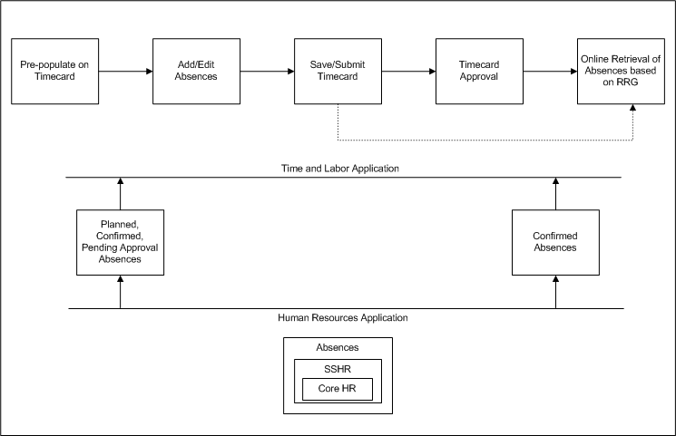

Oracle Time and Labor integrates with Absences to provide an additional method to capture absence information in addition to the existing ways. With the integration of OTL with the Absences module, the OTL application automatically imports absence entries created in Self Service HR or HR Absences module onto a worker’s timecard when the worker opens a timecard for time booking. You can capture/edit absences from OTL timecard and you do not require to use different applications to record absence information and to record time worked.
The OTL Administrators or OTL Application Developers set up the integration feature. Once this integration is set up, the OTL application automatically imports absence entries created in Self-Service HR or HR absences modules onto a worker’s timecard when the worker opens the timecard for a time booking.
Important: If you use absence integration, then you cannot create or update the absence type from Self-Service or HR if a timecard exits for that time period.
A brief overview of how the integration works is depicted in the following diagram:
Once you enable and set up Absences Integration, absence entries from Oracle HR and the Self-Service Absences modules automatically display on the OTL timecard. Workers can view and update the timecard with time entries directly from their OTL timecards. When workers save these entries, the OTL application validates the timecard based on time entry rules and other existing checks. The timecard containing absence entries and time entries is then stored in the OTL time store. When the timecard is submitted for approval, the approval system triggers and sends the timecard for approval. Absences are posted to Oracle HR automatically with timecard actions (Save, Submit or Approve) based on the online retrieval preference.
Important: The OTL transfer process excludes absence entries time entries when moving the data to workers’ assignments.
If OTL Rules Evaluation preference is set to Yes, then the application transfers the absence entries populated or entered in the timecard to the Entry/Validation/Approval window to enable time processing based on time management structures and policies. Such absences are view only and cannot be edited in the Entry/Validation/Approval window.
To set up OTL Absence Integration, complete the following steps:
