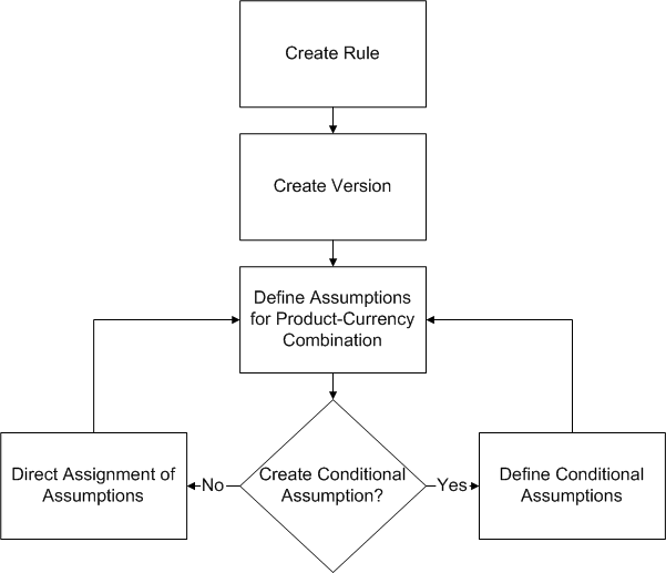

Setting Transfer Pricing rules is one of the mandatory steps in the Oracle Transfer Pricing process. Unless you set Transfer Pricing rules, you cannot transfer price your products. A Transfer Pricing rule is used to manage the association of transfer pricing methodologies to various product-currency combinations. It can also be used to manage certain parameters used in option costing. See: Transfer Pricing Methodologies and Rules.
Setting the Transfer Pricing rules is a two-step process. You need to first create rules and then versions. Transfer pricing methodologies are associated to various product-currency combinations within a version. A Transfer Pricing rule can have more than one version. See: Transfer Pricing Rules.

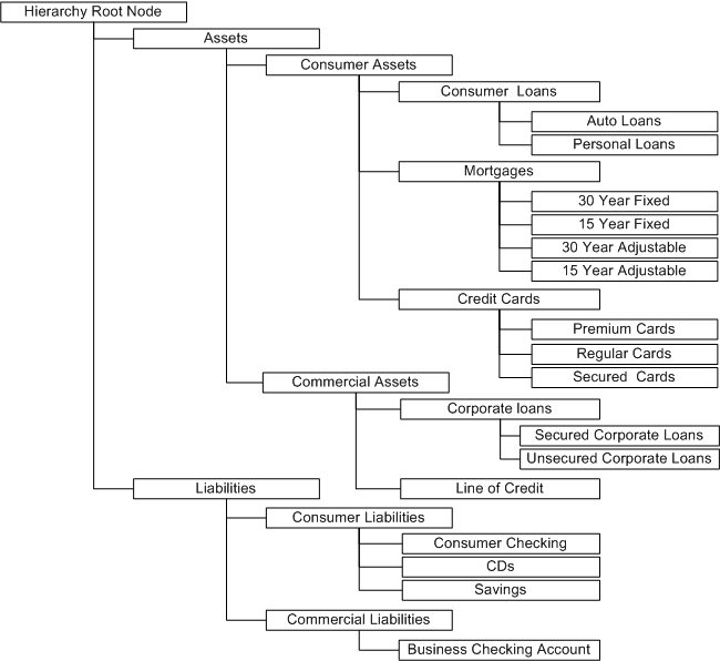

To reduce the amount of effort required to define the transfer pricing methodologies for various products and currencies, Oracle Transfer Pricing allows you to define transfer pricing methodologies using node level and conditional assumptions.

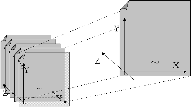

Oracle Transfer Pricing uses the Line Item Dimension to represent a financial institution’s product portfolio. Using this dimension, you can organize your product portfolio in a hierarchical structure and define parent-child relationships among different nodes of your product hierarchies. This significantly reduces the amount of work required to define transfer pricing, prepayment, and adjustment methodologies.
You can define transfer pricing, prepayment, and adjustment methodologies at any level of your product hierarchy. Children of parent nodes on a hierarchy automatically inherit the methodologies defined for the parent nodes. However, methodologies directly defined for a child take precedence over those at the parent level. See: Defining Transfer Pricing Methodologies Using Node Level Assumptions.
This feature allows you to segregate your product portfolio based on common characteristics, such as term to maturity, origination date, and repricing frequency, and assign specific transfer pricing methodologies to each of the groupings.
For example, you can slice a portfolio of commercial loans based on repricing characteristics and assign one global set of transfer pricing, prepayment, and adjustment methods to the fixed-rate loans and another to the floating-rate loans. See: Associating Conditional Assumptions with Transfer Pricing Rules.

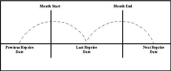

Oracle Transfer Pricing also allows Mid-period Repricing. This option allows you to take into account the impact of high market rate volatility while generating transfer prices for your products. However, the mid-period repricing option applies only to adjustable rate instruments and is available only for certain noncash flow transfer pricing methods.

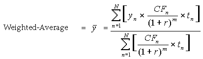

The Weighted Term method builds on the theoretical concepts of duration. As shown earlier, duration calculates a weighted-average term by weighting each time period, n, with the present value of the cash flow (discounted by the rate on the instrument) in that period.
Since the goal of the Weighted Term method is to calculate a weighted average transfer rate, it weights the transfer rate in each period, yn, by the present value for the cash flow of that period. Furthermore, the transfer rates are weighted by an additional component, time, to account for the length of time over which a transfer rate is applicable. The time component accounts for the relative significance of each strip cash flow to the total transfer pricing interest income/expense. The total transfer pricing interest income/expense on any cash flow is a product of that cash flow, the transfer rate, and the term. Hence, longer term cash flows will have relatively larger impact on the average transfer rate. The Weighted Term method can be summarized by the following formula:
In this formula:
N = Total number of payments from Start Date until the earlier of repricing or maturity
CFn = Cash flow (such as regular principal, prepayments, and interest) in period n
r = Periodic coupon rate on instrument (current rate/payments per year)
m = Remaining term to cash flow n/active payment frequency
tn = Remaining term to cash flow n, expressed in years
yn = Transfer rate in period n

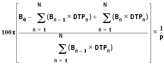

The Zero Discount Factors (ZDF) method takes into account common market practices in valuing fixed rate amortizing instruments. For example, all Treasury strips are quoted as discount factors. A discount factor represents the amount paid today to receive $1 at maturity date with no intervening cash flows (that is, zero coupon).
The Treasury discount factor for any maturity (as well as all other rates quoted in the market) is always a function of the discount factors with shorter maturities. This ensures that no risk-free arbitrage exists in the market. Based on this concept, one can conclude that the rate quoted for fixed rate amortizing instruments is also a combination of some set of market discount factors. Discounting the monthly cash flows for that instrument (calculated based on the constant instrument rate) by the market discount factors generates the par value of that instrument (otherwise there is arbitrage).
ZDF starts with the assertion that an institution tries to find a funding source that has the same principal repayment factor as the instrument being funded. In essence, the institution strip funds each principal flow using its funding curve (that is, the transfer pricing yield curve). The difference between the interest flows from the instrument and its funding source is the net income from that instrument.
Next, ZDF tries to ensure consistency between the original balance of the instrument and the amount of funding required at origination. Based on the transfer pricing yield used to fund the instrument, the ZDF solves for a single transfer rate that would amortize the funding in two ways:
Its principal flows match those of the instrument.
The Present Value (PV) of the funding cash flows (that is, the original balance) matches the original balance of the instrument.
ZDF uses zero coupon factors (derived from the original transfer rates, see the example below) because they are the appropriate vehicles in strip funding (that is, there are no intermediate cash flows between origination date and the date the particular cash flow is received). The zero coupon yield curve can be universally applied to all kinds of instruments.
This approach yields the following formula to solve for a weighted average transfer rate based on the payment dates derived from the instrument's payment data.
Zero Discount Factors = y =
In this formula:
B0 = Beginning balance at time, 0
Bn-1 = Ending balance in previous period
Bn = Ending balance in current period
DTPn = Discount factor in period n based on the TP yield curve
p = Payments per year based on the payment frequency; (for example, monthly payments gives p=12)

Mid-Period Repricing Option: Select the check box beside this option to invoke the Mid-Period Repricing option.

Across all Organization Units: Allows you to specify whether weighted average of transfer rates has to be taken across all organization units. See: Defining the Unpriced Account Methodology.
Note: The Unpriced Account method applies only to accounts that use Management Ledger Table as their data source.

The following diagram depicts a typical Mid-Period Repricing situation where the instrument reprices during the current processing month.
If an instrument reprices during the current processing month, then there are multiple repricing periods spanning the current month. In this example, there are two repricing periods in the current processing month and the computed last repricing date > beginning of processing month. Consequently, the repricing dates need to be rolled back by the repricing frequency until the Prior Last Repricing Date (Prior LRD) <= Beginning of Month and the Mid-Period Repricing Computation process should be executed as follows:

In Oracle Transfer Pricing, your product portfolio is represented using the Line Item Dimension. Node Level Assumptions allow you to define transfer pricing, prepayment, and adjustment assumptions at any level of the Line Item (product) dimension. The Line Item dimension supports a hierarchical representation of your chart of accounts, so you can take advantage of the parent-child relationships among different nodes of your product hierarchies while defining transfer pricing, prepayment, and adjustment assumptions. Child nodes for which no assumption has been specified automatically inherit the methodology of their closest parent node.
Node level assumptions can be applied only to the product (Line Item) dimension and not to the currency dimension. Node level assumptions simplify the process of applying rules in the user interface. It is also not required for all rules to assign assumptions to the same nodes. Users may assign assumptions at different levels.
The following graphic displays a sample product hierarchy:
Suppose you want to transfer price this product hierarchy using the Spread from Interest Rate Code transfer pricing method except for the following products:
Mortgages: You want to transfer price these using the Zero Discount Factors cash flow based method.
Credit Cards: You want to transfer price all but secured credit cards using the Spread from Note Rate method.
To transfer price in this manner, you need to attach transfer pricing methods to the nodes of the product hierarchy as follows:
Hierarchy Root Node: Spread from Interest Rate Code
Mortgages: Zero Discount Factors Cash Flow
Credit Cards: Spread from Note Rate
Secured Credit Cards: Spread from Interest Rate Code
The transfer pricing method for a particular product is determined by searching up the nodes in the hierarchy. Consider the Secured Credit Cards in the above example. Since Spread from IRC is specified at the product level, the system does not need to search any further to calculate the transfer rates for the Secured Credit Cards. However, for a Premium Credit Card the system searches up the hierarchical nodes for the first node that specifies a method. The first node that specifies a method for the Premium Credit Card is the Credit Card node and it is associated with the Spread from Note Rate method.
Note: Not specifying assumptions for a node is not the same as selecting the None methodology (also known as the "Do Not Calculate" method in the Adjustments rule). Child nodes for which no assumptions have been specified automatically inherit the methodology of their closest parent node. So if neither a child node nor its immediate parent has a method assigned, the application searches up the nodes in the hierarchy until it finds a parent node with a method assigned, and uses that method for the child node. However, if no parent node has a method assigned then the application triggers a processing error stating that no assumptions are assigned for the particular product/currency combination. However, if the parent node has the method None assigned to it then the child node inherits None, obviating the need for calculation and for a processing error.
All parameters that are attached to a particular methodology (such as Interest Rate Code) are specified at the same level as the method. If multiple Interest Rate Codes are to be used, depending on the type of the product, the method would need to be specified at a lower level. For instance, if you want to use IRC 211178 for Consumer Products and IRC 3114 for Commercial Products, then the transfer pricing methodologies for these two products need to be specified at the Commercial Products and Consumer Products nodes.
You need not specify prepayment assumptions at the same nodes as transfer pricing methods. For example, each mortgage category can have a different prepayment method while the entire Mortgage node uses the Zero Discount Factors cash flow method for transfer pricing.

To define a Conditional Assumption, you need to complete a series of steps beforehand. The following diagram displays, at a high level, how the Conditional Assumptions functionality fits with the overall Create process of a Transfer Pricing rule.
Assigning Conditional Assumptions is a sub-process within the Create or Update Flow of the Transfer Pricing, Prepayment, and Adjustments rules. Once you create a Rule and a Version, you have two options for defining your transfer pricing methodologies for a product-currency combination.
Direct assignment of a transfer pricing, prepayment, or an adjustment method to a product-currency combination.
This is the conventional method. See: Defining Transfer Pricing Methodologies and Defining Prepayment Methodologies.
Assignment of the methodology through a Conditional Assumption.
In this scenario, you would define IF-THEN-ELSE logic that will determine the Transfer Pricing or Prepayment Methodology for product-currency combinations. See: Conditional Assumptions.

The following diagram illustrates a three-driver prepayment table:
The ~ signifies a point on the X-Y-Z plane. In this example it is on the second node of the Z-plane. The Z -plane behaves like layers.
Oracle Transfer Pricing allows you to build prepayment tables using the Prepayment Table rule. The Prepayment Table rule can then be referenced by a Prepayment Rule. See: Prepayment Table Rules.

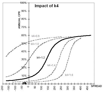

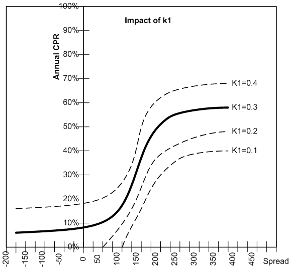

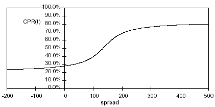

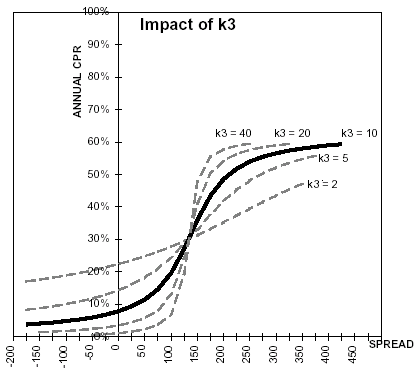

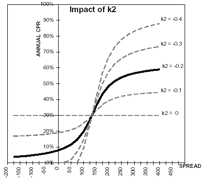

The Arctangent Calculation method uses the Arctangent mathematical function to describe the relationship between prepayment rates and spreads (coupon rate less market rate).
Note: All prepayment rates should be input as annual amounts.
User defined coefficients adjust this function to generate differently shaped curves. Specifically:
CPRt = k1 - (k2 * ATAN(k3 * (-Ct/Mt + k4)))
where CPRt = annual prepayment rate in period t
Ct = coupon in period t
Mt = market rate in period t
k1 - k4 = user defined coefficients
A graphical example of the Arctangent prepayment function is shown below, using the following coefficients:
k1 = 0.3
k2 = 0.2
k3 = 10.0
k4 = 1.2
Each coefficient affects the prepayment curve in a different manner.
The following diagram shows the impact of K1 on the prepayment curve. K1 defines the midpoint of the prepayment curve, affecting the absolute level of prepayments. Adjusting the value creates a parallel shift of the curve up or down.
The following diagram shows the impact of K2 on the prepayment curve. K2 impacts the slope of the curve, defining the change in prepayments given a change in market rates. A larger value implies greater overall customer reaction to changes in market rates.
The following diagram shows the impact of K3 on the prepayment curve. K3 impacts the amount of torque in the prepayment curve. A larger K3 increases the amount of acceleration, implying that customers react more sharply when spreads reach the hurdle rate.
The following diagram shows the impact of K4 on the prepayment curve. K4 defines the hurdle spread: the spread at which prepayments start to accelerate. When the spread ratio = k4, prepayments = k1.

Setting and executing the Transfer Pricing Process rule is one of the mandatory steps in the Oracle Transfer Pricing process. The Transfer Pricing Process rule allows you to:
Submit transfer pricing, prepayment, and adjustment assumptions, respectively contained in the associated Transfer Pricing, Prepayment, and Adjustments rules, to the Transfer Pricing Cash Flow engine for processing.
Determine the data that you want to process in a particular run.
Define parameters used in transfer rate, option cost, and adjustment calculation, migration of transfer pricing results to the Management Ledger table, propagation, and auditing.
Choose the calculation mode for generating transfer pricing results, such as Remaining Term or Standard.
Select which calculations, such as, Transfer Rates or Option Costs, or both, should be performed.
Setting the Transfer Pricing Process rule is a two-step process. You need to first create a rule and then a version. The Transfer Pricing Process rule has a separate Run page. Once a Transfer Pricing Process rule has been created, a user may select Run to execute it. The Run page allows you to supply all the run time parameters to get the required results. See: Transfer Pricing Process Rules.
