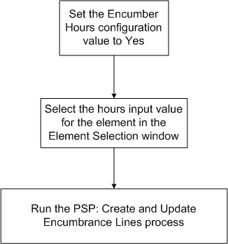

Oracle Labor Distribution now enables you to set up Oracle Labor Distribution to encumber the hours an employee will work during a payroll time period.
For more information on the configuration value that you need to enable to encumber hours, See Setup Configuration Options
The following diagram illustrates how Oracle Labor Distribution encumbers hours:
