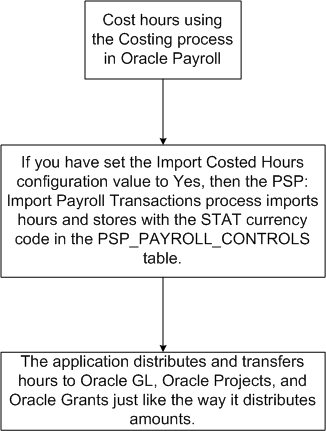

Oracle Labor Distribution now enables you to configure Oracle Labor Distribution to distribute and encumber the hours an employee worked during a payroll time period. In Oracle Payroll, apart from costing monetary costs, you can cost hours. You can import any element containing hours that you cost in Oracle Payroll into Oracle Labor Distribution.
For more information on the configuration value, see: Setup Configuration Options.
The following diagram illustrates how Oracle Labor Distribution distributes hours.
For more information on how the application distributes hours with the help of an example, see the example in the Determine Charging Instructions Using Element Entries section in this topic.

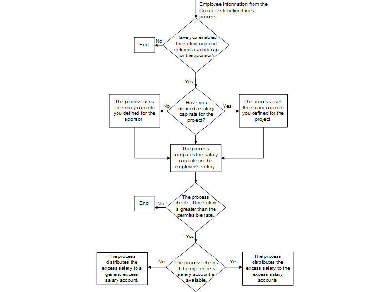

The National Institute of Health (NIH) restricts the amount of direct salary that organizations can pay to individuals under an Agency for Healthcare Research and Quality (AHRQ) grant, cooperative agreement, or application contract. The maximum amount of direct salary is the Salary Cap. As a Labor Distribution Administrator, you use Labor Distribution to transfer salary in excess of the predefined salary cap to another PTAEO or GL Account (Excess Salary Account).
To set up Salary Cap, use the Salary Cap page. The Salary Cap page enables you to:
Create new salary cap values for a sponsor.
Set up overrides for a project. You can override the salary cap for a project if, for example, you have explicit permission from the sponsor, or if you have some salary cap amount remaining to distribute from a previous year.
Create an excess salary account at the organization level.
The Create Distribution Lines process distributes the excess salary to the excess salary account based on your setup. If the organization excess salary account does not exist, or if its charging instruction dates are not valid, then the application transfers the funds to the generic excess salary account. For more information, see Setting Up a Generic Excess Salary Account
Important: The Create Distribution Lines process does not apply salary cap rates to the suspense account. This is because a suspense account is a temporary location to store funds and not the actual account where the process distributes funds. Therefore, ensure that the process does not charge funds to the suspense account.

The following diagram illustrates how the application computes salary cap rates for employees’ salaries:
Salary Cap calculation when distribution is 100% to a single award

| Payroll Period | Salary (US Dollars) | NIH Award Account (US Dollars) | NASA Award Account (US Dollars) | Excess Salary Account (US Dollars) |
| January | 15,000 | 1,500 | 13,500 | 0.00 The salary is less than the monthly salary cap, hence the application does not transfer any amount to the excess salary account. |
| February | 15,000 | 1,500 | 13,500 | 0.00 |
| March | 15,000 | 1,500 | 13,500 | 0.00 |
| April | 15,000 | 1,500 | 13,500 | 0.00 |
| May | 15,000 | 1,500 | 13,500 | 0.00 |
| June | 15,000 | 1,500 | 13,500 | 0.00 |
| July | 20,000 | 1,500.83 | 18,000 | 4,99.17 (Salary - NIH Award Account - NASA Award Account) 10% of the monthly salary ($2000) exceeds the NIH Salary Cap ($1500.83), hence the application transfers the excess amount ($2000 - $1500.83 = 499.17) to the Excess Salary Account. |
| August | 20,000 | 1,500.83 | 18,000 | 4,99.17 |
| September | 20,000 | 1,500.83 | 18,000 | 4,99.17 |
| October | 20,000 | 1,500.83 | 18,000 | 4,99.17 |
| November | 20,000 | 1,500.83 | 18,000 | 4,99.17 |
| December | 20,000 | 1,500.83 | 18,000 | 4,99.17 |
| Total | 210,000.00 | 18,004.98 | 189,000 | 2,995.02 |

It is mandatory that you set up a generic excess salary account. The application transfers excess funds to this account if you do not define an organization excess salary account for the organization of the employee's assignment.
To set up a generic excess salary account, you identify an organization as a generic organization, and then set up an organization excess salary account under that organization.
On the Configuration Values page, select Salary Cap as the module from the Module Name list.
Select Assign Generic Organization for Excess Salary Account from the Configuration Type list.
Click Update, select the organization that you want to identify as a generic organization, and click Apply.
On the Salary Cap page, in the Excess Salary Accounts tab, create an excess salary account under the organization that you identified as a generic organization.
You can set up annual salary cap rates for a sponsor. Based on the annual salary cap rate that you define, the Create Distribution Lines process determines the excess funds. Ensure that you use the Configuration Values page to map the sponsor code to the sponsor that you created in Oracle Grants Accounting.
See: Configuring Values for Labor Distribution
To set up a salary cap rate
From the Setup menu, click Salary Cap.
On the Salary Cap page, click Add Salary Cap in the Annual Salary Cap tab.
On the Add Salary Cap page, specify the required information and click Apply. If you want to add another salary cap rate, then click Add Another.
You can set up a salary cap rate for a project. When the Create Distribution Lines process processes the salary cap for a project that contains an override, it overrides the annual salary cap rate and uses the salary cap rate that you defined for that project.
To set up a project override
On the Salary Cap page, click the Project Overrides tab, and click Add Override.
On the Add Override page, specify the required information and click Apply. If you want to add another override, then click Add Another.
You must create an organization excess salary account to enable the Create Distribution Lines process to transfer excess funds.
To set up an organization excess salary account
On the Salary Cap page, click the Excess Salary Accounts tab, and click Add Account.
On the Add Account page, specify the required information, and click Apply. If you want to add another organization excess salary account, then click Add Another.
Copyright © 1998, 2015, Oracle and/or its affiliates. All rights reserved.
