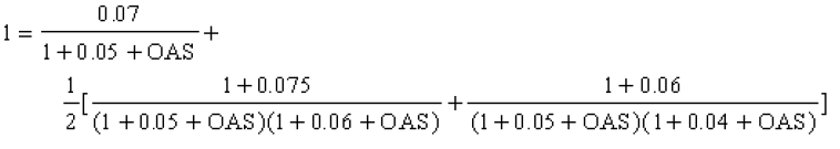

The OAS is the solution of the following equation:
By trial and error you get a value of 1.88%.
To summarize:
option cost = static spread - OAS = 2%-1.88% = 12 basis points

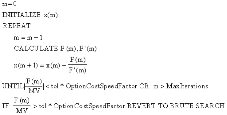

You can calculate the static spread using the Newton-Raphson algorithm. If Newton-Raphson algorithm does not converge, which can happen if cash flows alternate in sign, you can revert to a brute search algorithm. However, this algorithm is much slower.
You can control the convergence speed of the algorithm by adjusting the value of the variable OptionCostSpeedFactor. This variable is defined through a profile option, Option Cost Speed Factor.
The default value is equal to one. A lower speed factor provides more accurate results. In all experiments, a speed factor equal to one results in a maximum error (on the static spread and OAS), which is lower than half a basis point.
To recap the Newton-Raphson algorithm, let x be the static spread. At each iteration m, the function F(m) is defined by the following equation:
Equation A
The algorithm is:
For performance reasons, the code utilizes a more complicated algorithm, albeit similar in spirit. This is the reason why the specific values for tol and MaxIterations, or details on the brute search are mentioned above.

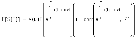

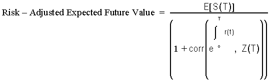

The risk-adjusted expected future value of a portfolio is equal to its expected future value after hedging all diversifiable risks.
The total risk-adjusted return of a portfolio is equal to the risk-adjusted expected future value divided by the initial value of the investment.
The risk-adjusted margin m of a portfolio is the difference between the risk-adjusted rate of return (used to calculate the total risk-adjusted return) and the risk-free rate r.
More precisely,

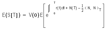

Here N is another martingale in the risk-neutral measure. The expected value of the portfolio is then:
Here, <N, N> is the quadratic variation of N. This is equivalent to:

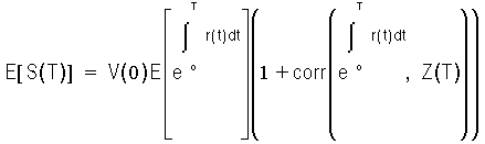

This represents the relative risk of the portfolio with respect to the standard money market account, that is, the account where only an initial investment of V(0) is made. Then

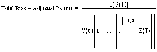

In other words, the expected future value of the portfolio is equal to the expected future value of the money market account adjusted by the correlation between the standard money market account and the relative risk. Assuming complete and efficient markets, banks can fully hedge their balance sheet against this relative risk, which should be neglected to calculate the contribution of a particular portfolio to the profitability of the balance sheet. Therefore:
In this example, the risk-adjusted rate of return of the bank on its portfolio is equal to the risk-free rate of return.

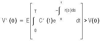

Now suppose that another instrument offers cash flows C' > C.
Assuming complete and efficient markets, the market value of this instrument is:
The value of the corresponding portfolio is denoted by S' > S.

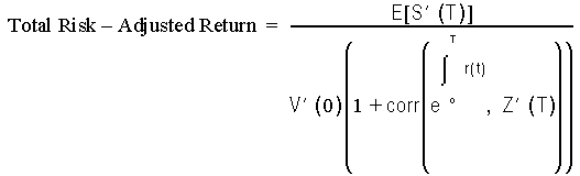

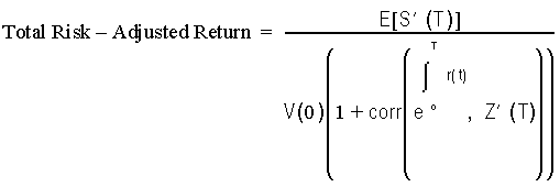

Again, the risk-adjusted rate of return of the bank on its portfolio is equal to the risk-free rate of return. Suppose now that markets are incomplete and inefficient. The bank pays the value V(0) and receives cash flows equal to C'. We have:
By definition of the total risk-adjusted return for Equation B, we have:
Equation C

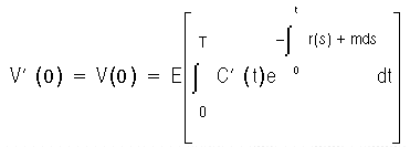

The solution of Equation D and Equation F is:
By the law of large numbers, Equation D and Equation F result in:
OAS = m
In other words, the OAS is equal to the risk-adjusted margin.

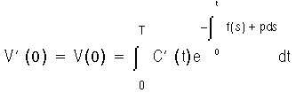

Static spread calculations are deterministic. Therefore, they are a special case of the equations in the previous section where all processes generally are equal to their expected value, and the margin p is substituted for the risk-adjusted margin m. The equivalent of Equation C is then:
Here f is the instantaneous forward rate.
The equivalent of Equation D and Equation F is then:
dV' = (r + m)V' dt - C' dt
Equation H
dI' = rI' dt + C' dt
dS' = dV' + dI'
V'(0) = V(0)
The solution of Equation G and Equation I is:
Equation J
Comparing Equation J and Equation A:
ss = p
In other words, the static spread is equal to the margin.
