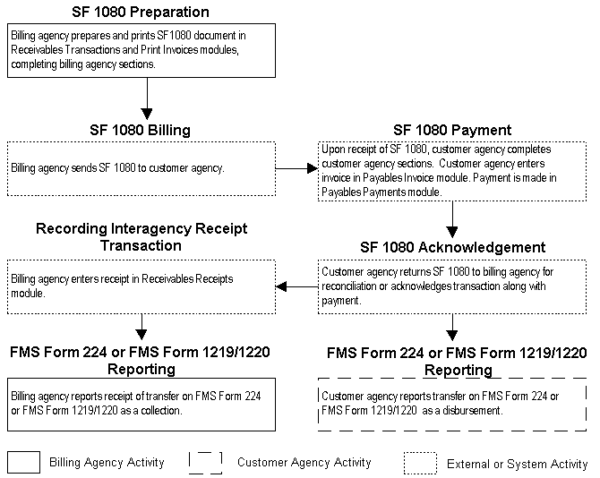

The Interagency Transactions process for SF 1080 transactions includes these steps:
The billing and customer agencies enter required information in the Define Federal Options window. The billing agency must enter Agency Name and Address to be printed on the SF 1080.
The billing agency prepares and prints the SF 1080 in the Receivables Transactions and Print Invoices modules.
The Interagency Billing and Payment for SF 1080 Transactions Diagram illustrates the Interagency Transactions processing cycle for SF 1080 transactions.
The billing agency enters:
Billing agency department, bureau, and address
Customer agency department, bureau, and address
Details of amount billed
Remittance name and address
Accounting classification of billing agency
The billing agency forwards the SF 1080 to the customer agency.
Upon receipt, the customer agency ensures that the transaction is correct and completes:
Customer agency voucher number
Customer agency schedule number
Paid by information
Certification of customer office
The customer agency enters the invoice in Payables.
After accomplishment, the customer agency returns the SF 1080 to the billing agency along with the payment.
If the Department of Treasury disburses payments for the agency, the customer agency reports the transaction as a disbursement on the FMS Form 224 report for the appropriate accounting period.
If the Department of Treasury does not disburse payments for the agency, the customer agency reports the transactions as a disbursement on the FMS Form 1219/1220 report.
The billing agency enters the SF 1080 bill and receipt in Receivables.
If the Department of Treasury disburses payments for the agency, the billing agency reports the transaction as a collection on the FMS Form 224 report for the appropriate accounting period.
If the Department of Treasury does not disburse payments for the agency, the billing agency reports the transaction as a collection on the FMS Form 1219/1220 report for the appropriate accounting period.

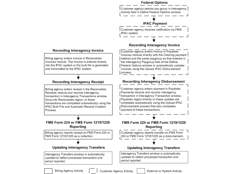

The Interagency Transaction Process consists of these steps. The Interagency Billing and Payment for IPAC Transactions Diagram illustrates the process.
The customer agency enters a paygroup in the Interagency Paygroup field in the Define Federal Options window to ensure that interagency transactions appear correctly on the FMS Form 224 report or FMS Form 1219/1220 report.
The billing agency enters the IPAC bill in Receivables.
The billing agency records the invoice in the IPAC system in either of the following ways:
The billing agency logs on to the IPAC system and records the bill to the customer agency including additional information in the description area. The IPAC system assigns an IPAC Billing Document Reference Number for the bill.
Alternately, the billing agency uses the IPAC bulk file, which is created in Oracle U.S. Federal Financials.
The customer agency is notified of the IPAC bill through the FMS IPAC system.
The billing agency records the receipt of IPAC Receivables in the Interagency Transactions window, Accounts Receivable region, to ensure proper reporting on the FMS Form 224 report or the FMS Form 1219/1220 report.
Alternatively, the receipt is automatically recorded in the Interagency Transactions window, Accounts Receivable region if the IPAC Bulk File is created.
The customer agency enters the invoice in Payables directly with the Clearing payment method and the Interagency paygroup indicated in the Define Federal Options window, or automatically updates invoices by using the Upload IPAC Disbursement process.
The customer agency approves the invoice in Payables and records the transaction in the Interagency Transfers window, Accounts Payable region for the FMS 224 and FMS 1219/1220 processes or reviews the payable transaction generated from the Upload IPAC Disbursement Process. The process creates payments against existing or newly created IPAC transactions.
If the Department of Treasury is disbursing payments, the billing agency generates its FMS Form 224 report for the accounting period indicated on the IPAC bill. The transaction is reported. If the receipt is not entered in the Accounts Receivable region of the Interagency Transfers window, the transaction will not be reported properly as a negative disbursement in Section II on the FMS Form 224 report.
If the Department of Treasury is not disbursing payments, the billing agency generates its FMS Form 1219/1220 report for the accounting period indicated on the IPAC bill. The transaction is reported. If the receipt is not entered in the Accounts Receivable region of the Interagency Transfers window, the transaction will not be reported properly on the FMS Form 1219/1220 report.
If the Department of Treasury is disbursing payments, the customer agency generates its FMS Form 224 for the accounting period indicated on the IPAC bill. If entered correctly in the Accounts Payable region in the Interagency Transfers window, the transaction is included in the report as an interagency disbursement.
If the Department of Treasury is not disbursing payments, the customer agency generates the FMS Form 1219/1220 for the accounting period indicated on the IPAC bill. If entered correctly in the Interagency Transfers window, the transaction is included in the report as an interagency disbursement.
Note: If a payment with the Payment Method of Clearing and the paygroup indicated in the Interagency Paygroup field of the Define Federal Options window is not entered in the Interagency Transfers window, Accounts Payable region, the transaction is not reported on the FMS Form 224 report or the FMS Form 1219/1220 report. The transaction appears on the FMS Form 224 Exception Report or the FMS Form 1219/1220 Exception Report for correction. To allow corrections to be made, Oracle recommends that the FMS Form 224 or the FMS Form 1219/1220 be printed in Preliminary mode to determine if transactions were omitted before printing in Final mode for submission.

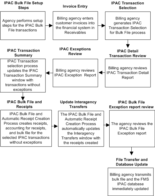

The IPAC Bulk File process includes these steps. The IPAC Billing Bulk File Process Diagram illustrates the process.
The billing agency adds customers in the Customers window assigning FEDERAL as the customer class, the Receiver Department Code in the Trading Partner descriptive flexfield, and a primary bank account with the customer ALC for the billing location in the Customer Addresses window.
The billing agency records its DUNS number in the Define Federal Options window.
The billing agency adds the Disbursing Office (DO) Code in the Alternate Name field in the Remit-To Addresses window.
The billing agency enters bank accounts that are used to receive funds in the Bank Accounts window. The ALC is defined for the bank account.
The billing agency enters customer invoices in Receivables. The purchase order number is entered in the More tab of the Transactions window.
These transactions can be entered directly into Oracle U.S. Federal Receivables or imported from an external application.
The billing agency initiates the IPAC Transaction Selection process.
The IPAC Transaction Summary window enables users to exclude certain invoice transactions using the Exclude check box. Records marked for exclusion are not reported in the IPAC Bulk File.
Exception records can be viewed on the IPAC Exception Report. Transactions with an exception are not reported in the IPAC Bulk File; however, users can correct transactions causing an exception. After correcting the exception, users must rerun the IPAC Transaction Selection process to include the corrected transactions.
When appropriate, billing agency users can generate the IPAC Bulk File and Automatic Receipt Creation process to create the IPAC Bulk File in the specified format.
This file contains invoices generated by the billing agency. After the bulk file is generated, the transactions included in the file are updated in the IPAC Transaction Summary window. These records are marked as Processed.
In addition, the transactions included in the file are updated in the Interagency Transactions window, Accounts Receivable region. Exception records can be viewed on the IPAC Bulk File Exception Report. Transactions with an exception are not reported in the IPAC Bulk File; however users can correct transactions causing an exception. After correcting the exception, users must rerun the IPAC Bulk File and Automatic Receipt Creation process to include the corrected transactions on the next bulk file.
The process automatically creates receipts for IPAC transactions reported on the bulk file.
The FMS IPAC database is updated immediately after successful transmission of the IPAC Bulk File.

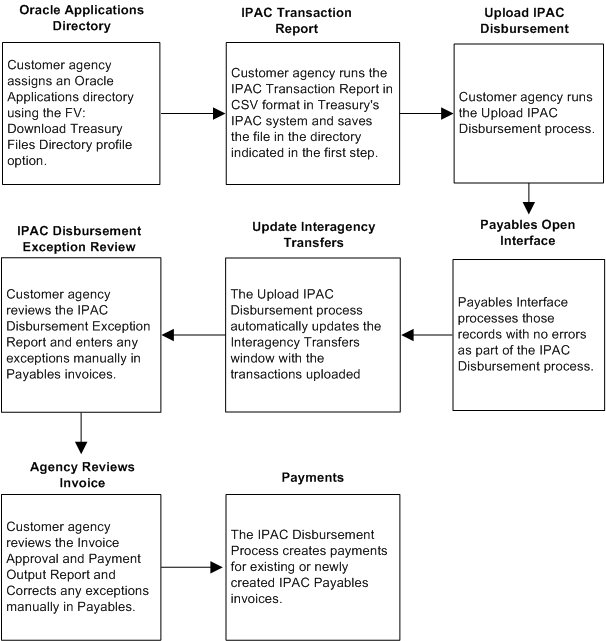

The IPAC Disbursement process includes these steps. The IPAC Disbursement Process Diagram illustrates the process.
The customer agency assigns an Oracle Applications directory using the FV:Download Treasury Files Directory profile option and sets up the AP: Using Invoice Batch Controls profile option.
For information on the FV: Download Treasury Files Directory profile option and the AP: Use Invoice Batch Controls profile option, see Step 3. Specify Profile Options.
The customer agency runs the IPAC Transaction Report in CSV format in Treasury’s IPAC system and saves the file in the directory indicated in Step 1.
The customer agency runs the Upload IPAC Disbursement concurrent process and referencing the file created in Step 2. This process performs these tasks:

FV_IPAC_IMPORT and FV_IPACT_IMPORT_HISTORY store the IPAC Disbursement File data. FV_IPAC_IMPORT initially stores and validates IPAC import data. FV_IPAC_IMPORT_HISTORY stores only validatedIPAC data.
After the Payables Open Interface tables are loaded, the Payables Interface processes those records with no errors.
The Upload IPAC Disbursement process automatically updates the Interagency Transfers window, Accounts Payable region for the invoices created.
The customer agency reviews the IPAC Disbursement Exception Report and enters any exceptions manually in Payables invoices.
The customer agency reviews the Invoice Approval and Payment Output Report of the IPAC Automated Payments Process to review invoices that are paid or error reasons for those that could not be paid.
The Upload IPAC Disbursement Process creates payments against IPAC transactions.
