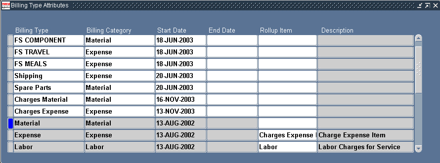

Billing Categories classify Billing Types into Material, Labor, and Expense. Each serviceable item in Inventory is classified using Billing Type Codes associated to a Billing Category.
A Service Activity Code is a type of action to be performed, for example, replace, return, install, drain, fill. The combination of Billing Type and Service Activity defines the Order Type for a given operating unit. It also provides the basis upon which discounts for a Service Contract can be applied.
To define the Billing Type Codes, use the Oracle Service Lookups window.
From the Navigator, use the following path to open the Oracle Service Lookups window:
Service Request > Setup > Customer Support Lookups.
Query up the Lookup Type MTL_SERVICE_BILLABLE_FLAG.
Add the new required Billing Type Codes. You can use the online help for more information.
The seeded Billing Type Codes are M, L, and E.
To associate Billing Type Codes to Billing Categories, use the Billing Type Attributes window. The seeded Billing Categories include Material, Labor, and Expense.
Use the following path to navigate to the Billing Type Attributes window:
Switch responsibilities to Customer Support, Vision Operations and navigate to Setup > Charges > Billing Type Attributes.
Only the Billing Types associated with a Billing Category in this window appear in the Billing Type Name List of Values in the Service Activities and Billing Types form. Similarly only the Billing Type Names associated here appear in the List of Values for Billing Type: Material, Labor, and Expense in the Repair Types form.
Note: You cannot associate the Billing Category Labor to a new Billing Type. The seeded Labor Billing Type is mapped to the Labor Billing Category.

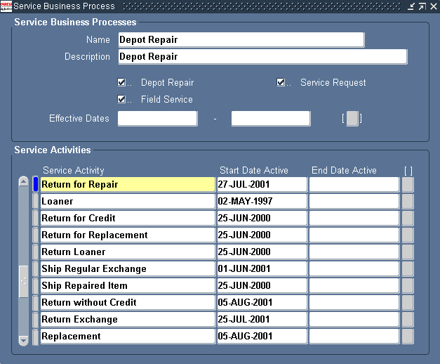

A Business Process is a group of Service Activities created with a view to restricting Service Activity availability. A Business Process supports the charge lines that the line of business in your organization can utilize, such as, Depot Repair.
Use the Service Business Process window to define your Business Process and associate Service Activities with it. Ensure that the Depot Repair check box is selected when setting up the Business Process. For a particular Business Process, the selected flag check boxes indicate the modules (Service Request, Field Service, Depot Repair) in which this Business Process can be used.
Open the Service Business Process window using the following navigation path:
Service Request > Setup > Charges > Service Business Process.
Enter the appropriate value in the Name and Description fields.
Select the Depot Repair check box.
You can also optionally select any of the other check boxes for the applications (Service Request, Field Service) where you want this Business Process to be visible.
Enter the Effective Dates for the Business Process if you want the Business Process to be used only for a limited time.
In the Service Activities region, select the Service Activity you want to associate with the Business Process.
Save your work, and exit the Service Business Process window.

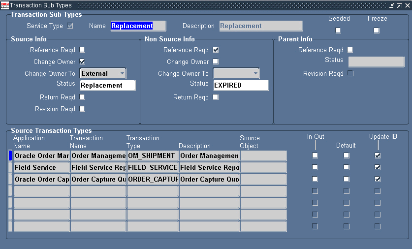

Use the Transaction Sub Types window to specify the type of update that can be performed in an Installed Base instance by transactions originating from Depot Repair that are interfaced with Installed Base.
For Depot Repair, the Service Type checkbox should be selected. When the Service Type checkbox is selected, the Name field List of Values displays the Service Activities for which you can create an Installed Base Transaction subtype.
You can define the transactions and the kind of actions they can perform on the Source, Non Source, and Parent instances.
Source Info area: Specify details of the instance being transacted, such as in a sales order, as a shipped or a returned item.
Note: Transaction sub types defined as shipments, that is, which have OM_SHIPMENT as their source transaction type, should not have Reference Reqd checked in the Source Info area. This is because Shipping does not understand and does not need Installed Base reference numbers.
Also, for non-serialized Installed Base trackable items, when an item is shipped back to the customer, a new instance with a new Installed Base reference number is created in Installed Base for the shipped instance. For a serialized Installed Base trackable item, the shipped item instance is identified in Installed Base by the shipped item and the serial number.
Non Source Info area: Specify information on a related instance, such as one that is being replaced by the source instance.
Non Source information is required for the Service Activities associated with the Repair Types Exchange, Advance Exchange, and Replacement. In these cases, to transfer the warranty, the Non Source Info region should have Reference Reqd check box selected. This ensures that at the time of shipping the new item, the warranty information is transferred.
Note: For the Replacement Repair Type, the damaged item status is changed to EXPIRED by setting this value in the Status field in the Non Source Info area.
Parent Info area: This area is reserved for future use.
The Change Owner check box and Change Owner To fields determine whether the instance ownership has to be changed.
In the case of Repair Type Return and Repair, for example, the Transaction Sub Type for Return and Ship in the Source Info area has neither the Change Owner check box selected nor the Change Owner To field populated.
But in the case of Repair Type Exchange, the item is changed, and hence the Source Info area for the Transaction Sub Types for Return and Ship has the Change Owner check box and Change Owner To field selected.
In the Source Transaction Types area, for Oracle Depot Repair, only Oracle Order Management needs to be set up as a source application. Ensure also that the Update IB check box is selected here.
Detailed information on Installed Base Transaction Sub Types is available in the Oracle Installed Base Implementation Guide.

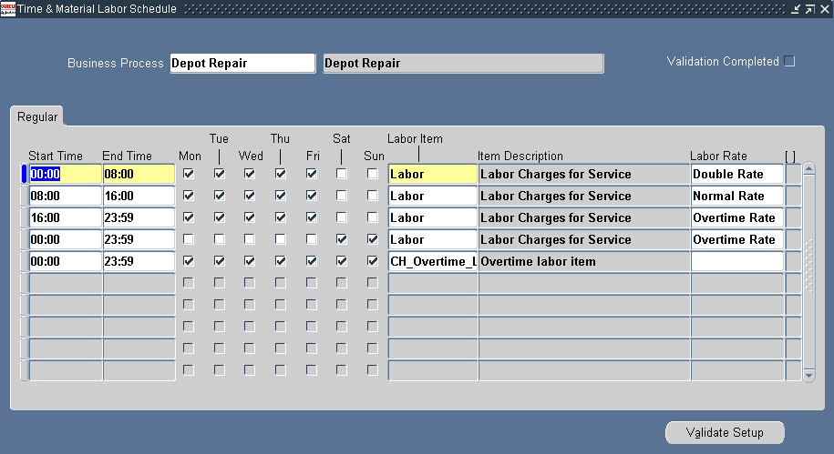

Use the Time & Material Labor Schedule window to set up schedules for the Depot Repair Business Process. This is required to process any labor transaction in the Debrief form accessed from the Repair Tasks tab in the Repair Orders form.
From the Navigator, use the following path to access the Time & Material Labor Schedule window:
Service Request > Setup > Charges > T&M Labor Schedule.
For more information, please refer to the Oracle TeleService Implementation Guide.

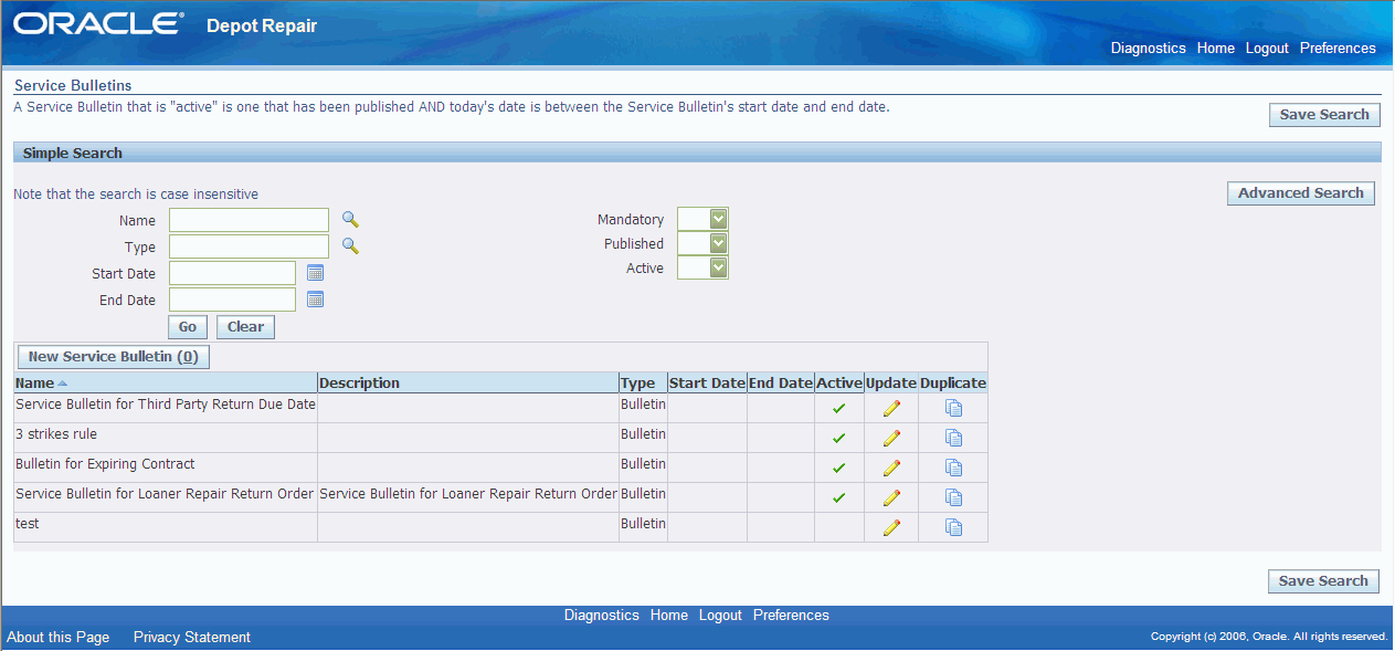

Depot Repair provides an interface to the repair manager enabling him to trigger notifications, escalations, and/or workflows based on key business events in the repair shop. The repair manager can drill down to the details of critical activities to speed up the resolution of issues, thereby increasing customer satisfaction.
Navigate to the Service Bulletins page.
This page displays the existing service bulletins in a summary table. The Simple and Advanced Search options enable you to look for a particular service bulletin.

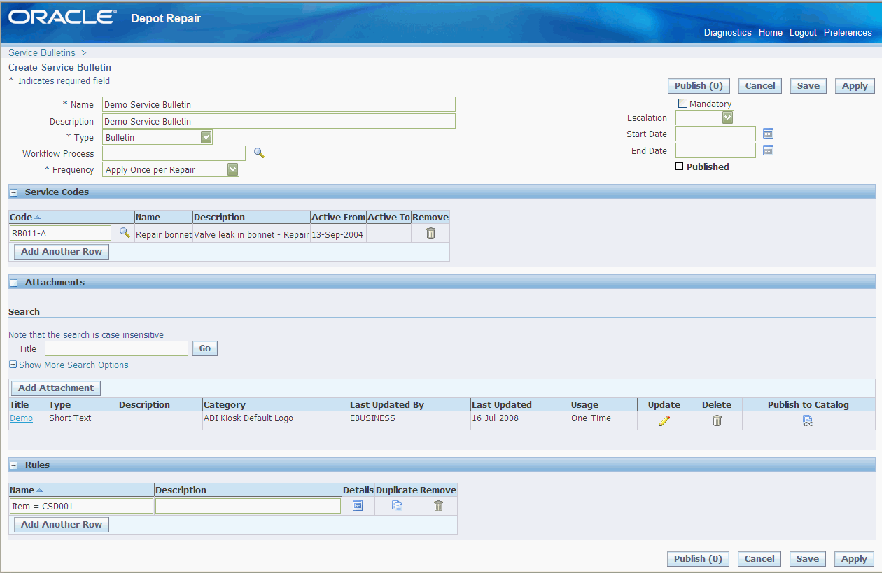

Click the New Service Bulletin button to navigate to the Create Service Bulletins page.
Enter the information in the following fields. The fields marked with an asterisk (*) are mandatory:
Name: Name of the service bulletin
Description: Description of the service bulletin
Type: Select the type of the service bulletin
Workflow Process: Associate a workflow process to the service bulletin
Frequency: Select how frequently the service bulletin is applied
Apply Once per Item Instance implies that the service bulletin is applied only once for a particular instance. For example, you can set this frequency when an engineering change order is applied only once and for which the same bulletin does not need to be applied repeatedly. A bulletin with this frequency never gets attached to Repair Orders with Non-Installed Base items.
Apply Once Per Repair implies that the service bulletin is applied every time there is a new repair order.
Mandatory: Select this checkbox to mark the service bulletin as mandatory on the repair order
Escalation: You can define your own statuses.
Start Date: The activation date of the service bulletin.
End Date: The expiration date of the service bulletin.
Note: If the dates field is left blank, it implies that the service bulletin is always active.
In the Service Codes region, click Add Another Row to define the service codes for the service bulletin.
You can add one or more attachments to a service bulletin using the Attachments region. Click Add Attachment to navigate to the Add Attachment page.
Note: You can add a File, URL, or Text as an attachment.
The Rules region enables you to define multiple rules to associate to the service bulletin. Click Add Another Row to define rules.
Click the Details link in the Rules region to navigate to the Update Service Bulletin Rule page.
Use the Conditions region to define conditions for the rule. Click Add Another Row to enter the condition.
A rule can have multiple conditions and all the conditions are evaluated to hold true for the rule to apply.
Click the Details link to navigate to the Update Rule Condition page.
Enter the required rule conditions and click Apply.
Navigate back to the Create Service Bulletin page and click Publish.
Note: Once you publish the service bulletins, it becomes read only. You can only modify the start and end dates.

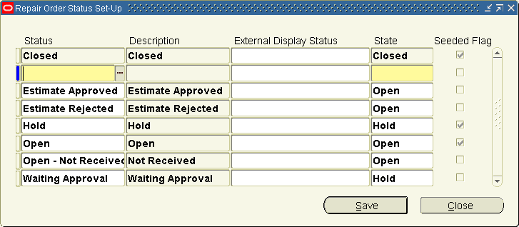

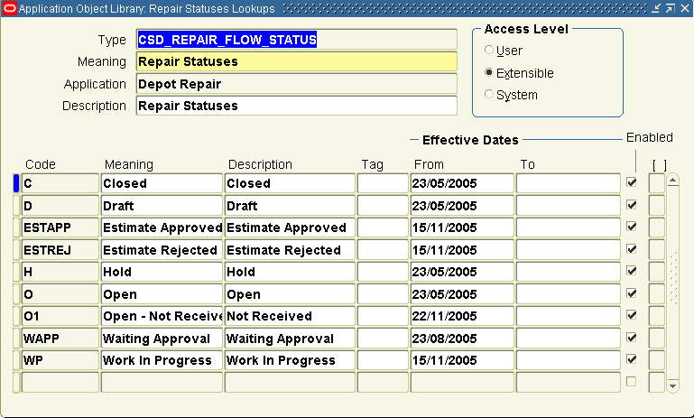

You must first create a repair status lookup.
From the Depot Repair Navigator, use the following path to open the Repair Statuses Lookup window:
Depot Repair > Setup > Repair Statuses
Add a new record, with values for Code and Meaning.
You can also add values for Description, Tag, and Effective From and To dates.
To allow activation of the status, ensure that the Enabled check box is set
Save your work.
You must associate each status that you create with a State of Open. Hold, or Closed..
There are limitations on the operations that can be performed on a repair order set to a Status associated with either the Hold or the Closed State. For details, see Constraints on User Operations.
Important: After you have associated a Status with a State, you cannot update that association.
Important: You can delete non-seeded Status-State associations, but you should do so with great care. Repair orders whose latest status resulted from a deleted Status-State association may be corrupted.
From the Depot Repair Navigator, use the following path to open the Repair Order Status Set-Up window:
Depot Repair > Setup > Repair Order Status Set-Up
Select the Status and State.
Optionally enter a Description.
Save your work.

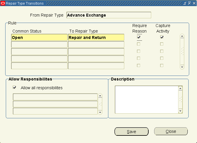

Repair type transitions are possible only when a repair order status is associated with more than one repair type. Defining a repair type transition allows users to switch the repair type of a repair order, when the repair order status is a status common to the repair types.
Important: Repair type transitions do not add, delete, nor default any logistic lines. After a repair type transition is performed on a repair order, you must perform manual adjustments to your logistic lines, if your organization processes require this
If you are not already in the Repair Types window, then, from the Depot Repair Navigator, use the following path:
Depot Repair > Setup > Repair Types
Select a Repair Type and click Repair Type Transitions.
The From Repair Type field shows the current repair type.
For each repair type transition, perform the following in the Rule area:
Select a Common Status and a To Repair Type.
Optionally check Require Reason, if you want to make it mandatory for a repair type changer to enter a reason at the time of repair type change.
Optionally check Capture Activity, if you want changing to the new repair type to result in the creation of a viewable Activity.
For each repair type transition, select the transition and, in the Allow Responsibilities area, either select the check box "Allow all responsibilities" or select individual responsibilities for which the repair type changes are allowed.
For each repair type transition, select the transition and optionally enter a Description.
Save your work.

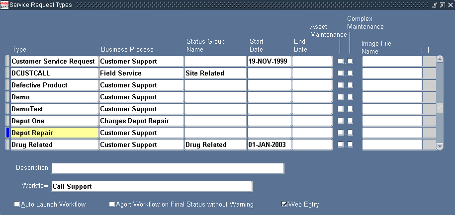

Service request types help categorize your service requests. For each service request type, you can set up service request statuses.
Each service request type can be linked to an existing Oracle Workflow process. The workflow can be automatically launched when the service request is created (not when it is updated) or manually launched depending on the settings you enter while defining service request types.
You must define at least one service request type for Oracle Depot Repair use. Typically you define one service request type called Depot Repair. However, you can use any name for the service request type, so long as it is associated with a Business Process that can be used in Oracle Depot Repair. See Defining Business Processes.
The new service request types set up for Oracle Depot Repair use and their related statuses register as entries in the lists of values for their fields in the Repair Orders window. See the Oracle TeleService Implementation Guide for more information.
The Service Request Type window is used to link a Service Request Type to a Business Process. The Service Request Type Depot Repair needs to be associated with the applicable Business Process for your organization.
Navigate to Service Request Types window using the following path:
Service Request > Setup > Service Requests > Request Types
The window lists all the existing service request types.
Click the New toolbar button to create a blank row for defining your service request type.
In the Type field, enter the name Depot Repair for the service request type.
Typically, you have one service request type called Depot Repair, but it is not essential to have that exact name. You must have at least one service request type that is mapped to the Depot Repair Business Process.
In the Business Process field, select the Business Process for which this service request type is being created. In this case, the Business Process is Depot Repair.
Enter the Status Group Name, which in this case is Depot Repair.
Enter the effective dates for the service request type in the Start Date and End Date fields.
Enter a brief description of the request type in the Description field.
In the Workflow field, select the Generic workflow. Do not select the Auto Launch Workflow check box, if this workflow is selected.
Optionally, select from the available check boxes. Refer to the following table for details of the actions initiated when the checkboxes are selected.
| Checkbox | Action |
| Auto Launch Workflow | Launches workflow automatically when the service request is saved. Not to be used with Oracle Depot Repair Generic Workflow. |
| Abort Workflow on Close | Aborts workflow when service request status is set to closed |
| Web Entry | Makes this service request type accessible to web entry through iSupport. Currently not used with Oracle Depot Repair. |
Save your work.

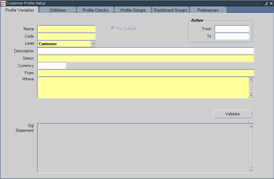

A Customer Profile displays summarized information about the customer that is appropriate for the service representative to know. It may contain information such as the number of open service requests. These profile checks are flagged by appropriate ratings and colors that provide instant visual clues to the service representative to assist in appropriate engagement with the customer. Customer Profiles also furnish the ability to drill down from a profile check to a detailed list, and then to the original transaction.
You can define profile checks, and combine multiple checks with complex criteria. It is also possible to define critical customer criteria by using profile checks.
The profile engine (a concurrent program) runs periodically to check and store changes to profile checks.
Use the Customer Profile Setup window to define the profiles based on critical customer information that needs to be readily accessible by the service representative. You may already have set up Customer Profile if other Oracle Service application modules are in use at your organization.
To navigate to the Customer Profile Setup window, use the following path:
Service Requests > Setup > Customer Management > Customer Profiles
Follow these steps to setup Customer Profiles:
Define Profile Rating Lookup Codes
Define Profile Variables
Define Drilldowns
Define Profile Checks
Define Profile Groups
Define Dashboard Groups
Associate Profiles with Modules
Define Preferences
Define Rating Labels
Define Categories
Run the Customer Profile Engine
For detailed instructions, refer to the Oracle TeleService Implementation Guide.

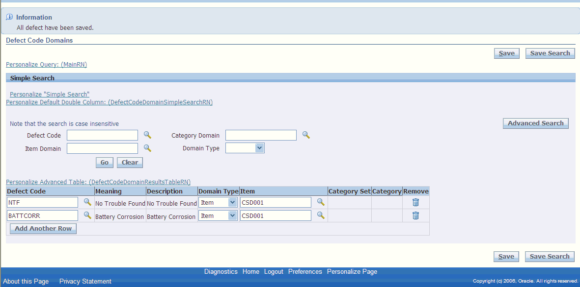

Oracle Depot Repair provides the ability to associate repair problems with a Diagnostic Code, and to associate the potential resolutions with a Service Code. By utilizing Diagnostic Codes and Service Codes, users can quickly document repair efforts for customer charges and depot service history.
You make use of Diagnostic Codes and Service Codes when you process a Repair Order. If you have recorded one or more Solutions in Oracle Knowledge Management to previous problems similar to the one in the current Repair Order, then you can examine these previous cases, and if appropriate, apply one or more of the previous Solutions to the current Repair Order.
The full setup of Diagnostic Codes and Service Codes includes setup steps in both Oracle Depot Repair and Oracle Knowledge Management.
This section deals with the setting up of Diagnostic Codes in Oracle Depot Repair.
For details of setting up Service Codes in Oracle Depot Repair, see Setting Up Service Codes in Oracle Depot Repair.
For details of setting up Diagnostic Codes and Service Codes in Oracle Knowledge Management, see Setting Up Knowledge Management.
In Oracle Depot Repair, when you create a Diagnostic Code, you associate it with one or more domains. There are two domain types, Item and Category. Each associated domain is either an item or an item category, as defined in Oracle Inventory.
The list of values for the Category field will be a list of all item categories for the category set selected for the profile option CSD: Default Category Set for Diagnostic Codes and Service Codes.

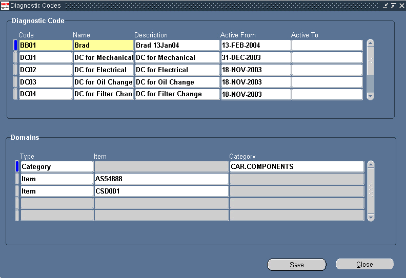

Use the Diagnostic Codes window to define the Diagnostic Codes, and their associated items or categories or both.
Navigate to Diagnostic Codes window using the following path:
Depot Repair > Setup > Diagnostic Codes
The window lists all the existing Diagnostic Codes.
Click the New toolbar button to create a blank row for defining your Diagnostic Code.
Enter a Code and a Name for the Diagnostic Code.
Optionally, enter a Description for the Diagnostic Code.
In the Active From field, enter the date on which the Diagnostic Code is activated.
The date defaults to the current date. You can change it to any later date, but not to a prior date.
Optionally, set the Active To date field.
Click any field in the Domains area, and if necessary, click the New toolbar button to create a blank row for defining a domain.
In the Type field, select either Item or Category. from the list of values.
Depending on the Type, select either an Item or a Category from the list of values in the Item or Category field respectively.
Repeat steps 7 to 9 for as many domains as you want to associate with the Diagnostic Code.
Click the Save icon on the toolbar to save your setup.

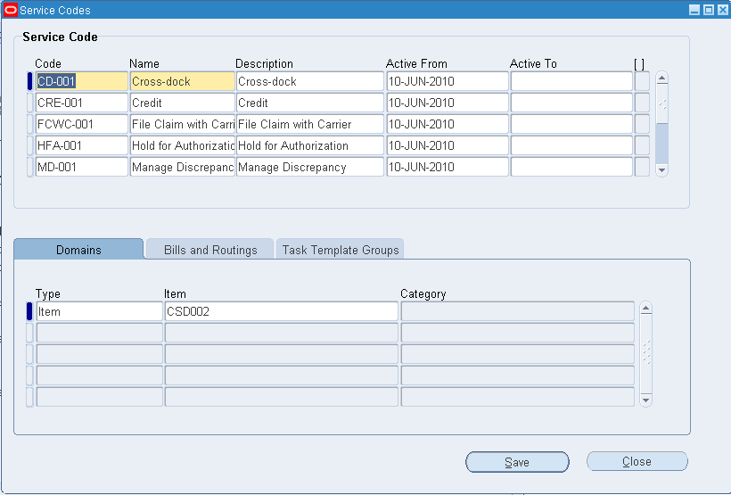

Use the Service Codes window to define the Service Codes, and their associated elements.
Navigate to the Service Codes window using the following path:
Depot Repair > Setup > Service Codes
The window lists all the existing Service Codes.
Click the New toolbar button to create a blank row for defining your Service Code.
Enter a Code and a Name for the Service Code.
Optionally, enter a Description for the Service Code.
In the Active From field, enter the date on which the Service Code is activated.
In the DFF field, enter flexfield information associated with the Service Code. The DFF name is Depot Repair Service Codes.
If you want to associate the Service Code with a domain:
Click the Domain tab, if it is not visible
Select either Item or Category from the Type list of values
Depending on your choice of Type, select either an Item or a Category from the appropriate list of values.
Repeat this step for as many domains as you want to associate with the Service Code.

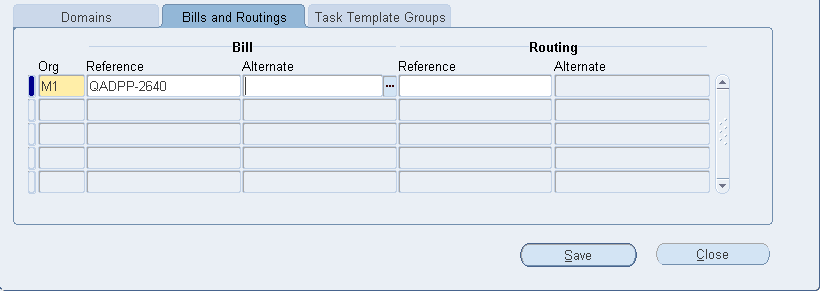

If you want to associate a bill or routing or both to the Service Code:
Click the Bills and Routings tab.
Select the organization from the Org list of values.
To associate a bill, select from the Bill Reference list of values, and if you require an alternate bill, select also from the Bill Alternate list of values.
To associate a routing, select from the Routing Reference list of values, and if you require an alternate routing, select also from the Routing Alternate list of values.
Repeat this step for as many bills and routings as you want to associate with the Service Code.
If you want to associate one or more task template groups to the Service Code:
Click the Task Template Groups tab.
Select the task template group from the Name list of values.
This also populates the Description field.
Repeat this step for as many task template groups as you want to associate with the Service Code.

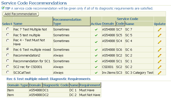

The main elements of a service code recommendation are the following:
A name
A service code and one of its domains
A recommendation type of Sometimes or Always
One or more requirements involving diagnostic codes and their domains; each requirement mandates either the existence or the absence of a diagnostic code and one of its domains
For example, if an examination of past repairs leads you to the conclusion that the service code S7 will always be useful when diagnostic code D1 is present and diagnostic code D99 is absent, you could set up a service code recommendation whose main elements are as follows (assume that all domains are the same as the repair item):
Recommendation Name: S7_D1Y_D99N
Recommendation Type: Always
Service Code: S7
Diagnostic Requirement 1: Must Have D1
Diagnostic Requirement 2: Must Not Have D99
Service code recommendations are used in the Repair Order page, as follows:
You click the Recommend Services button.
The system checks all the diagnostic codes in the Diagnostic Codes region against all the requirements of the service code recommendations.
If all the requirements of one or more recommendations are fulfilled, the corresponding service code or codes are added to the Service Codes region.
Any service code added from a recommendation whose Type is Always will be marked as Applicable and disabled, so that any jobs generated from the Service Codes region will include the bills and routings associated with that service code.
For details, select from the following:
Open the Service Code Recommendations window using the following navigation path: Depot Repair > Setup > Service Code Recommendations
The window shows the existing service code recommendations.
Select a recommendation to see its diagnostic code requirements at the foot of the screen.:
Optionally, click the Update icon for a recommendation to update it.
For a new recommendation, click Add Recommendation..
Enter a Name for the recommendation.
Select a Recommendation Type, of Sometimes or Always.
Optionally, select a Start and End Date.
Select a Service Code.
From the list of values, select the entry with the item or category domain that you want to associate with the recommendation. This is the domain that will be compared with the repair order item domain, to try to find a match when you click Recommend Services in the Repair Order page.
You can create one or more entries in the Diagnostic Requirements area.
For each diagnostic requirement, select the following
Diagnostic Code
Selecting from the list of values populates the Name, Description, Domain, and Domain Type fields.
Requirement - either Must Have or Must Not Have
In the process of entering the requirements, you can Remove an entry.
Save your work.
You can maintain existing Lookups as well as define additional Lookups for your shared Lookup Types.
Each Lookup has a Code, a Meaning, and a Description. Lookup Codes are not editable, but Meanings and Descriptions are. If you make changes to a Lookup, you must log out and then log back on before your changes take effect.
The following Lookup Types are pre-seeded in Oracle Depot Repair. For more information, refer to Appendix B.
| Lookup Type | Description |
| CSD_APPROVAL_STATUS | Repair Approval Status (Approved, Rejected) |
| CSD_ESTIMATE_STATUS | Estimate Status (Accepted, Bid, Closed, Draft, Hold, Rejected) |
| CSD_EST_BILLING_TYPE | Estimate Billing Type (Expense, Labor, Material) |
| CSD_EVENT | Repair Event (Customer Approved, Charges Recorded, Repair Diagnosed, Repair Job Completed) |
| CSD_PRODUCT_ACTION_CODE | Product Transaction Action Code for Repair Orders (Customer Item, Exchange, Loaner, Replacement, Defective, Usable) |
| CSD_PROD_ACTION_TYPE | Depot Repair Order Product Transaction Action Types (Return, Ship, Move In, Move Out) |
| CSD_PRODUCT_TXN_STATUS | Product Transaction Status (Booked, Entered, Received etc.) |
| CSD_REASON | Reason for current status of repair process (Customer Approves the Estimate, Estimate Approved, Repair On Hold) |
| CSD_REJECT_REASON | Estimate Reject Reasons (Customer Reject, Machine Unavailable, Resource shortage) |
| CSD_REPAIR_MODE | Repair Mode for the depot repair processes (WIP, Tasks, None, All) |
| CSD_REPAIR_STATUS | Repair Status (Closed, Open, On Hold) |
| CSD_REPAIR_TYPES | Depot Repair Types (Advance Exchange, Walk-In with Return and Repair etc.) |
| CSD_RO_TXN_STATUS | Repair Order Transaction Status (OM Booked, OM Received, OM Released etc.) |
| CSD_UNIT_OF_MEASURE | Lead Time Unit of Measure (Hour, Week, Day) |
| CSD_WIP_JOB_STATUS | Repair Job Status (Released, Unreleased) |
| CSD_WARRANTY_STATUS | Supplier Warranty Status (Rejected, Submitted, Approved) |
| CSD_SOURCE_TYPE | Repair BOM |
| CSD_DEF_ENTITY_ATTR_RO | Repair Owner, Ship From Sub-Inventory, RMA Receiving Sub-Inventory, Repair Organization, Ship From Organization, Inventory Organization, RMA Receiving, Organization, Repair Priority, Repair Type, Vendor Account |
| CSD_BULLETIN_TYPES | Notification, Recall, Regulatory Compliance, Soft Entitlement, ECO, Bulletin |
| CSD_BULLETIN_SOURCE_TYPE | Rule, Manual |
| CSD_DEFAULTING_ENTITIES | Repair Order |
| CSD_DEFAULTING_VALUE_TYPES | Attribute, PL/SQL API, Profile |
| CSD_RULE_TYPES | Service Bulletin Rule, Defaulting Rule |
| CSD_RULE_OPERATORS | <>, <, >, = |
| CSD_BULLETIN_FREQUENCY | Apply Once Per Repair, Apply Once Per Item Instance |
| CSD_ESCALATION_CODES | New, Reopened |
| CSD_BULLETIN_ACTION | Mark as Viewed, Mark as Unviewed |
| CSD_WARRANTY_VIOLATION | Yes, No |
| CSD_REWORK | Yes, No |
| CSD_RECALL_FLOW_STATUS | Recall Flow Status (Closed, Draft, Open) |
Switch to the Application Developer responsibility.
From the Application Developer Navigator window, use the following path to navigate to the Applications Object Library Lookups window:
Functions (tab) > Application > Lookups > Application Object Library
Run a query to display the details of the Lookup Type under which you want to define the lookup code. Several lookup types (listed above) are pre-seeded in Oracle Depot Repair.
Click anywhere in the spread table. Now click the New tool bar button to open a blank row.
Enter a name for the Lookup Code in the Code field. The code name is internal to the system.
Enter a User Name for the Lookup Code in the meaning field. This value is displayed in the LOV.
Optionally enter a description in the Description field.
If you want the Lookup Code to be effective only for a specific period, set the period by selecting the Effective Dates From and To fields.
Verify that the Enabled check box is selected. Only enabled Lookup Codes will appear in the List of Values.
Save your work.

| CSD: Mandate Service Code Recommendations | None | Yes or None | When a user clicks the Recommend Service Codes button in the repair technician portal, the service codes that are recommended as Always will be automatically checked and disabled so that the user must apply the service code when generating jobs. |

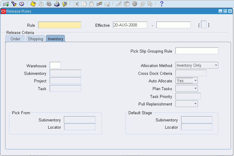

To activate auto reservation in Depot, please check the following setups:
Set profile: CSD: Automatic Serial Number Reservation to Yes
Navigate to the Release Rules page.
Click the Inventory tab and set the Auto Allocate to Yes.
Save and close the form.

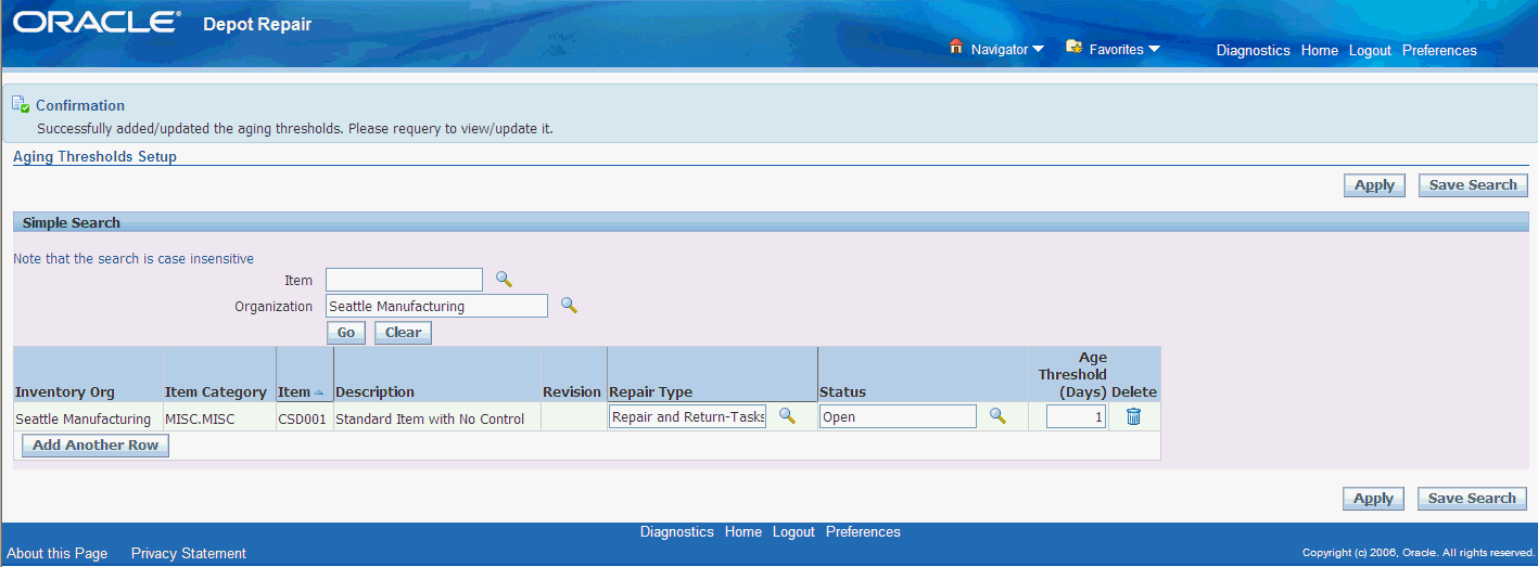

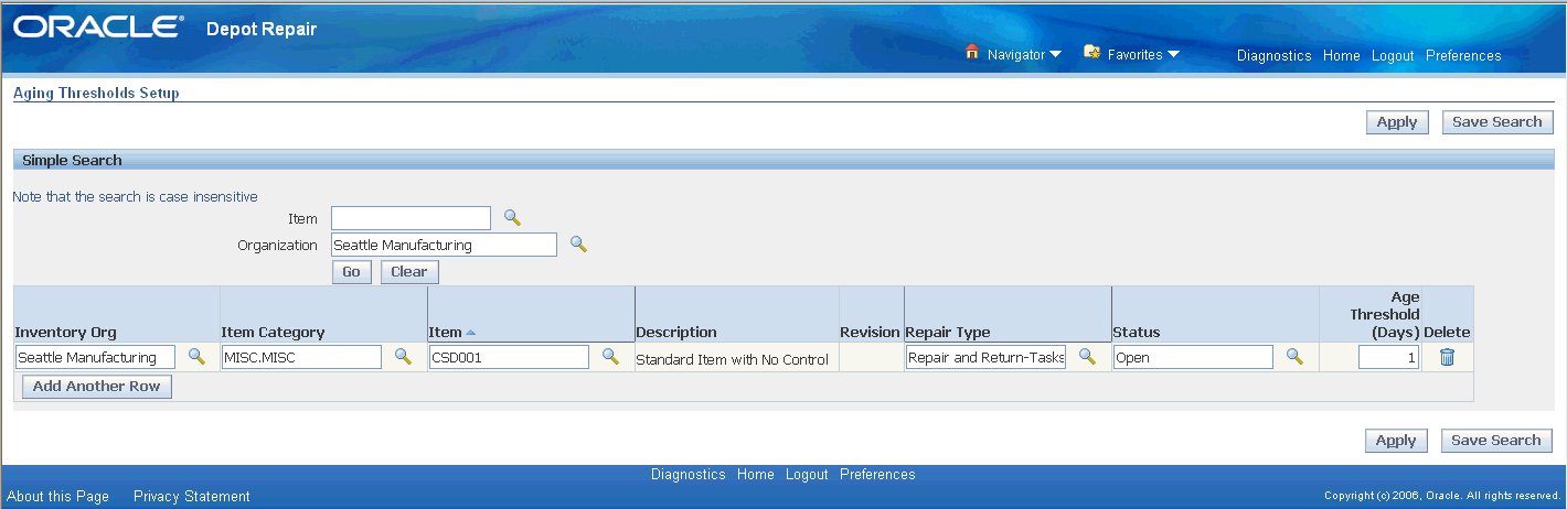

Aging is defined as the amount of time from repair orders creation or the amount of time that a repair order is in a specific status. Aging is related to elapsed calendar time and not to actual repair time. The unit of measure (UOM) for aging is time-bound, for example, days, hours, minutes, and so on.
To set up aging threshold
Navigate to the Aging Thresholds Setup page from the Depot Repair Setup menu.
Select an organization. To search for an existing aging threshold go to step 3 or continue to step 4 to set up a new aging threshold.
Click Go to search for an existing aging threshold in the selected organization.
Click the Add Another Row button to enter aging threshold details.
Enter the following information:
Inventory Org: Displays the default organization to which you belong based on your user profile organization.
Item Category: Select the item category. If you choose an Item Category, the Item field is disabled.
Item: Select the item. If you select an Item, the Item Category field is disabled.
Description: Describes the item.
Revision: For revision-controlled items, you can optionally specify thresholds to specific revision number.
Repair Type: Specifies the repair type for which age threshold applies.
Status: Specifies the status to which age threshold applies.
Age Threshold (Days) : Specifies the number of days at which a repair is considered aging. It must be a positive value (>0).
Delete: This icon deletes an aging threshold entry.
Click Apply to record the new aging threshold.
A confirmation message appears on the top of the page.

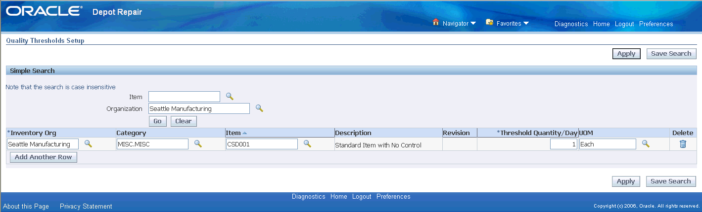

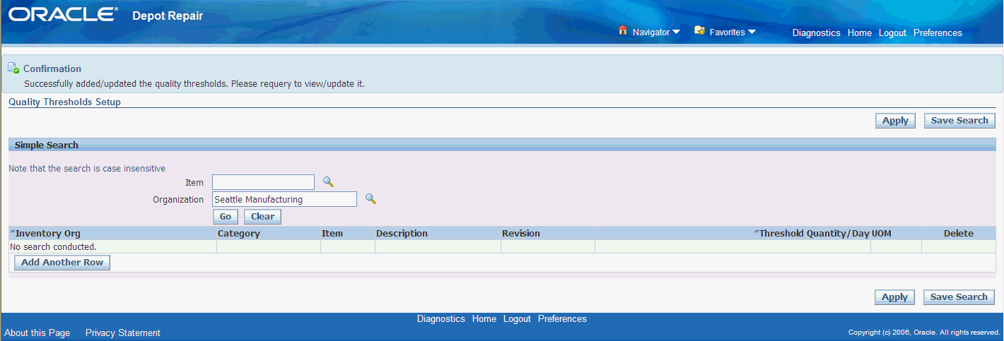

Quality thresholds setup page enables you to create item record and corresponding quantity per day. Use quality thresholds to set how many items can be returned per day.
To set up quality threshold
Navigate to the Quality Thresholds Setup page from the Depot Repair Setup menu.
Select an organization. To search for an existing quality threshold go to step 3 or continue to step 4 to set up a new quality threshold.
Category: Select the item category. If you choose a Category, the Item field is disabled.
Item: Select the item. If you select an Item, the Category field is disabled.
Revision: Active only for revision-controlled item.
Threshold Quantity/Day: Represents the number of returns per day at which a repair is considered a quality event. It must be a positive value (>0).
UOM: Describes the item’s unit of measurement.
Delete: This icon deletes a quality threshold entry.
Click Apply to record the new quality threshold.

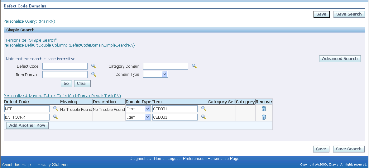

Oracle Depot Repair provides a setup interface where each root cause code is linked to specific items or item categories. On the basis of this setup, the Repair Technician module displays only the root cause codes that match the item or category of the required item.
To set up defect codes
Navigate to Defect Code Domains page using the following path:
Depot Repair > Setup > Defect Code Domains
The page lists all the existing Defect Codes.
Click Add Another Row to create a blank row to define the new defect codes.
Select the new Defect Code from the list of values.
Select the Domain Type and the Item.
Repeat steps 2 to 4 for as many domains as you want to associate with the Defect Code.

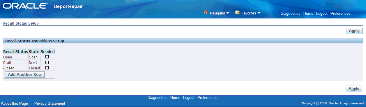

The recall statuses indicate the stage of the recall lifecycle and critical milestones. Each status is associated with one and only one state. Each business defines its own status and transitions.
To set up recall status
Navigate to the Recall Status Setup page. The page defaults to the existing statuses.
The Recall Status Transitions Setup region allows you to enter various recall statuses. Click the Add Another Row button to define new status.
Click the Apply button to save the new status.

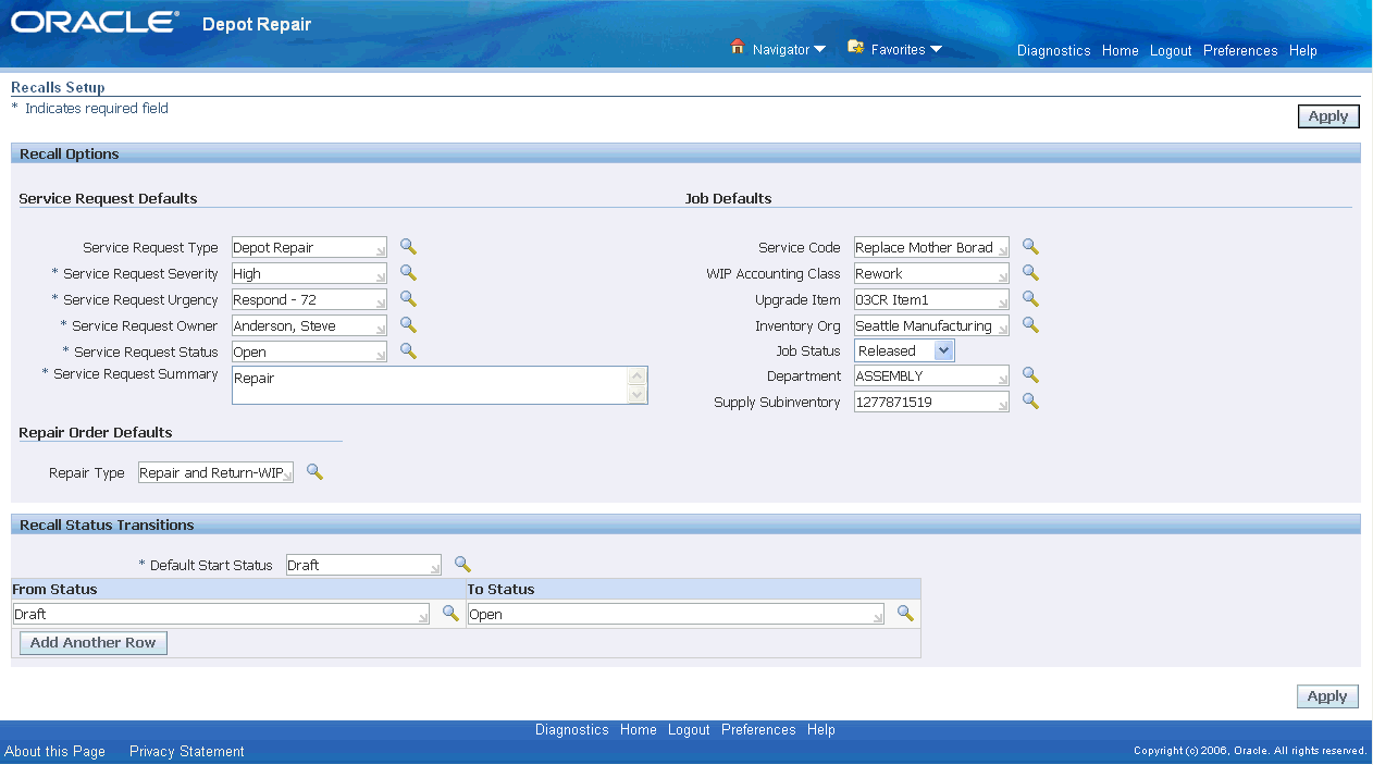

The Recalls Setup page enables you to set up various recall options.
The Recall Options region displays the following information:
The Service Request Defaults region contains the mandatory fields required for the creation of Service request from the Recalls page.
The Repair Order Default region specifies the default repair type to be used for the Repair Orders created via Recalls page.
The Job Defaults region specifies the default job attributes to be used for the WIP jobs created via Recalls.
Recall Status Transitions region enables you to perform the following actions:
Specify the Default Start Status for the recall.
Setup status transitions if any. For example, you can set up a transition from Draft to Open. In this case, you can change the status of recall to Open only from draft. Any other status transition is disallowed.

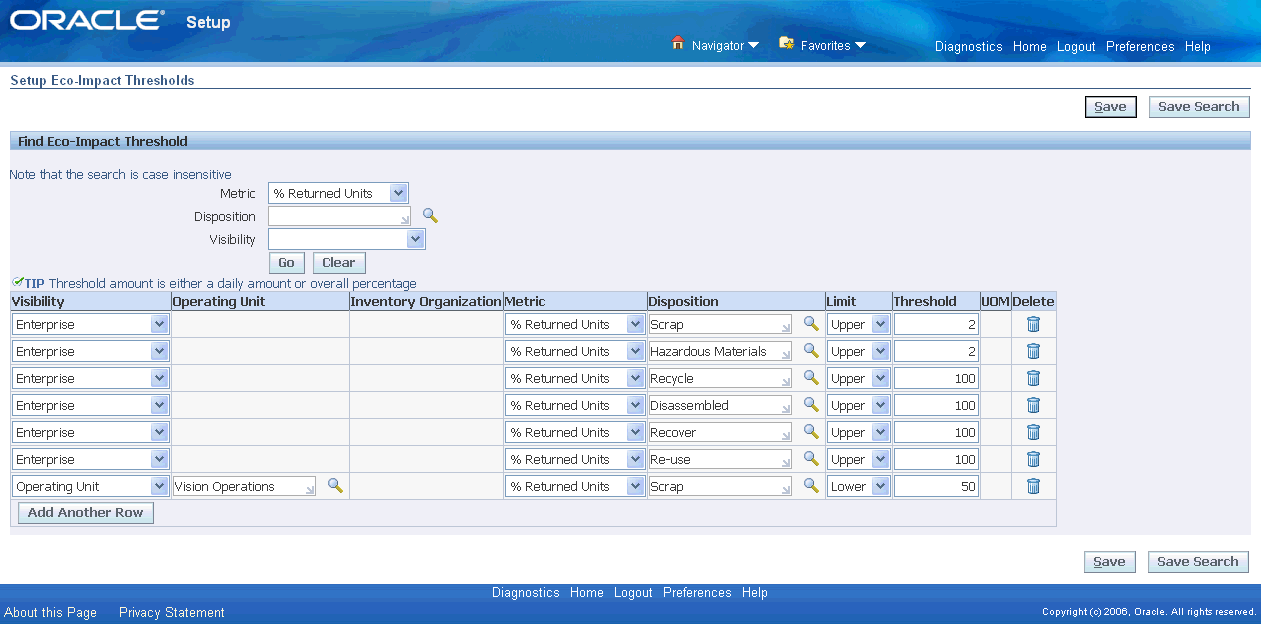

The Eco-Impact Threshold Setup page enables you to setup the thresholds for:
Percentage of Returned Units
Percentage of Returned Weight
Number of Units
Weight
To facilitate the availability of data within a specific inventory organization for an entire operating unit or for the enterprise, the system allows setting up thresholds for each of these levels.
To define an eco-impact threshold
Navigate to the Setup Eco-Impact Thresholds page. The Find Eco-Impact Threshold region enables you to search for existing thresholds. Enter any one of the following search criteria:
Metric
Disposition
Visibility
Click the Go button. The thresholds matching the search criteria are displayed.
Click Add Another Row to define a new threshold.
Select a Visibility from the list.
If you select Enterprise, both the Operating Unit and Inventory Organization fields are not visible.
If you select Operating Unit, the Operating Unit field is visible. You can enter the required operating unit.
If you select Inventory Organization, the Inventory Organization field is visible. You can enter the required Inventory Organization.
Choose the appropriate Metric from the list.
If you choose % Returned Units, the UOM field is disabled.
If you choose % Returned Weight, the UOM field is disabled.
Note: The percentage (%) thresholds are an overall percentage for the period queried in the returns dashboard.
If you choose Number of Units, the UOM field is enabled.
If you choose Weight, the UOM field is enabled.
Note: The thresholds for Number of Units and Weight are a daily threshold.
Enter a Disposition. See: Setting Up Material Disposition Reasons
Enter the Limit. You can enter either Lower or Upper.
Enter the required Threshold value.
Click the Save button. A confirmation message appears stating that all eco-impact thresholds have been saved.

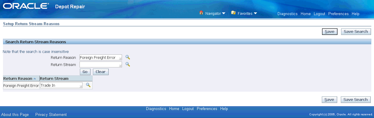

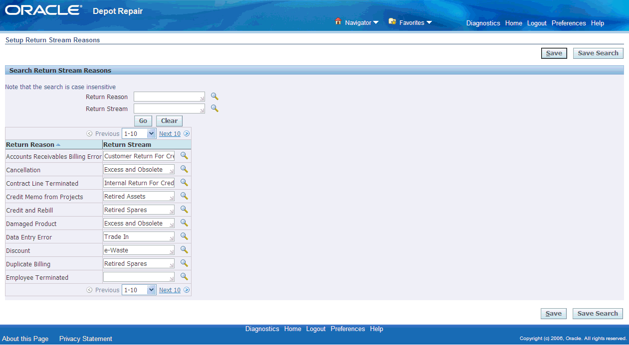

The Setup Return Stream Reasons page enables you to define which RMAs are grouped together into each return stream. Each RMA Return Reason Code is linked with only one single Return Stream. However, a Return Stream can be composed of many RMA Return Reason Codes.
To set up a new Return Stream for Return Reason
Navigate to the Setup Return Stream Reasons page.
Search for a return reason that does not have a return stream associated with it.
Enter the Return Stream for the searched Return Reason.
Click the Save button. A confirmation message appears stating that all return stream reasons have been saved.

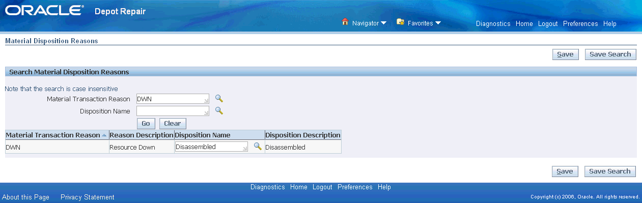

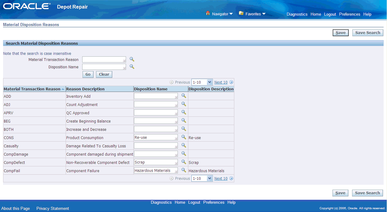

The Setup Material Disposition Reasons page enables you to define which WIP Material Transactions are grouped together into each Material Disposition. Each WIP material transaction reason is linked with only one single Disposition. However, a Disposition can be composed of many Material transaction reason. Currently, only WIP returns and negative issues are counted in the disposition metrics for the Returns Dashboard.
To set up a new disposition
Navigate to the Material Disposition Reasons page.
In the Search Material Disposition Reasons region, query the Material Transaction Reason that does not have an associated Disposition.
Enter the Disposition Name to associate.
Click the Save button. A confirmation message appears stating that all material disposition reasons have been saved.

The following examples illustrate Charges and Repair Types setup for Installed Base and Non-Installed Base trackable items. Separate Service Activities and Repair Types are required for Installed Base trackable items and non-Installed Base trackable items. Refer to the relevant sections within this document for navigation paths and other details.
Perform the following steps to set up Service Activities and Billing Types.
Consider the Service Activity Return for Repair for an Installed Base trackable item. This Service Activity will be used for returns for repair, and requires a corresponding Installed Base Transaction Sub Type.
Perform the following set up.
Service Activity
Service Activity: Return for Repair
Line Category: Return
Depot Repair Quantity Update check box: Selected
Billing Type
Order Management Header and Line Types
Operating Unit: Vision Operations
Order Type: Mixed
Line Type: Return (Receipt)
Consider the Service Activity Return for Repair for a non-Installed Base item. This Service Activity will be used to process returns for repair, and does not have a corresponding Installed Base Transaction Sub Type set up.
Enter Service Activity value as Return for Repair, non-Installed Base. Set Billing Type and Order Management Header and Line Types as detailed above for the Installed Base item.
Consider the Service Activity Replacement for an Installed Base item. This Service Activity will be used for shipping replacements, and requires a corresponding Installed Base Transaction Sub Type. Perform the following set up.
Service Activity: Replacement
Line Category: Order
Depot Repair Quantity Update: Selected
Set up Billing Type and Order Management Header and Line Types as explained in the first example.
A separate Service Activity has to be set up for Replacement of non-Installed Base items. Set up the Replacement Service Activity for a non-Installed Base item as you did for the Return for Repair example. This Service Activity setup does not have a corresponding Installed Base Transaction Sub Type set up.
After defining required Service Activities and Billing Types as illustrated in the above example, define a Service Business Process and include the required Service Activities.
After defining Service Activities and Billing Types and Service Business Processes, set up the Installed Base Transaction Sub Types as follows:
Transaction Sub Type: Return for Repair. This Transaction Sub Type is seeded.
Transaction Sub Type: Replacement. The Change Owner checkbox in the Source Info region of the Transaction Sub Types window is selected when the Service Activity is Replacement. Also select the Reference Reqd checkbox in the Non Source Info region. The Change Owner To Status and Status fields in the Source Info region must be populated with the values External and Replaced respectively. The Status field in the Non Source Info region has the value EXPIRED.
Other seeded Transaction Sub Types include Ship Loaner, Return Loaner, Material Transaction, and Ship Repaired Item. For Return for Repair, Ship Repaired Item, Ship Loaner, and Return Loaner, the Change Owner checkbox in the Source Info region is not selected. This is because, in these transactions, the owner does not change.

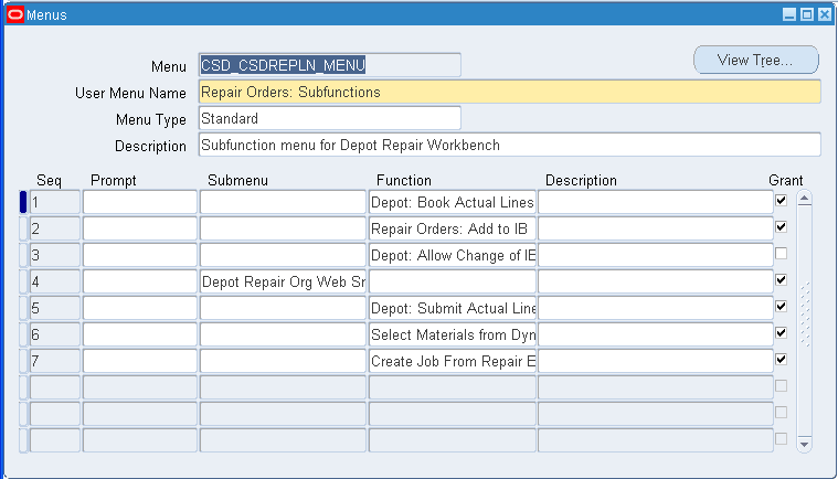

The following steps facilitate setting up transfer Install Base ownership function.
To set up transfer Install Base ownership:
Login with the System Administrator responsibility.
Navigate to the Menus page.
Query for the CSD_CSDREPLN_MENU in the menu field.
In the sub menus listed, locate the menu Depot: Allow Change of IB Ownership.
Select the Grant check box.
Click Save.
Click OK on the message window. This notifies you about the request being submitted to recompile the menu.
