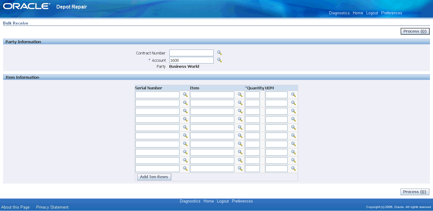

For each batch perform the following operations:

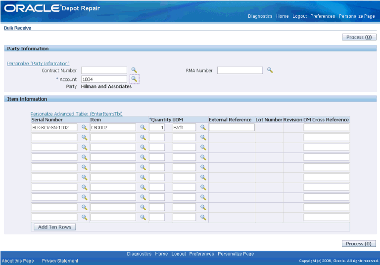

Enter either the customer account number, or a service contract number - from which Oracle Depot Repair derives the account number.
Note: The search criteria in the header region are only used to uniquely identify a Party and Account. It does not filter the search to limit serial numbers.
For each item, enter as much of the following data as you know:
Item Name
Serial Number, for serialized items
Quantity (mandatory)
UOM
If the UOM is not entered, the primary UOM of the item is derived.
Click Process to process the batch; if there are any problems with the data entered for any item, you can correct the data, and then process the batch.

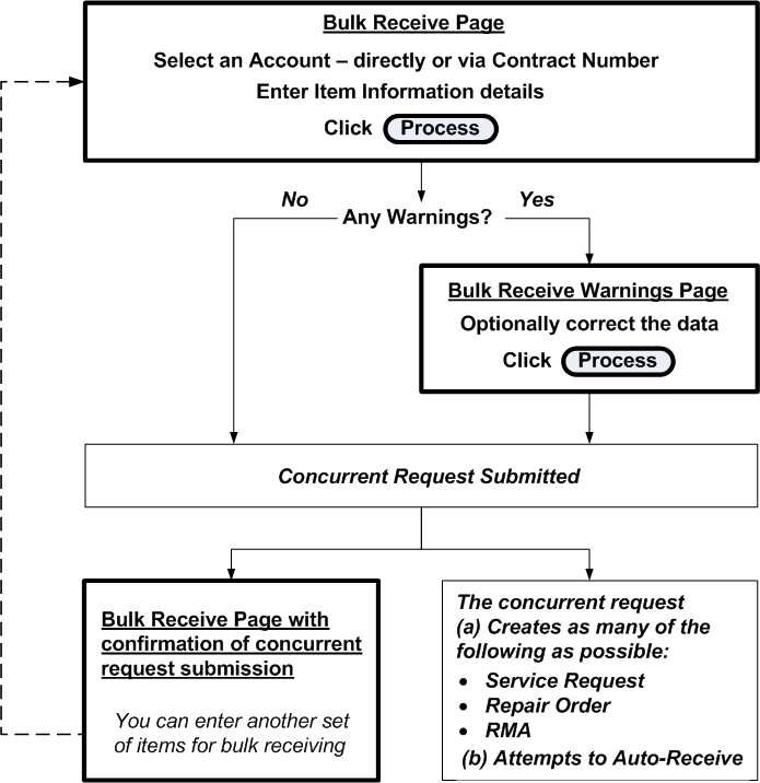

The following diagram shows an overview of the Bulk Receive processing, as performed in two pages, the Bulk Receive page and the Bulk Receive Warnings page.
Select the Account or Contract Number.
Oracle Depot Repair uses Contract Number to derive the Account.
The Party is derived from the Account.
For each item, you enter as much of the following data as you know:
Item Name
UOM
For processing the expected receipts, set the profile option, CSD: Enable Expected Receipts for Bulk Receiving, to Yes. The Party Information region has Incident Number that defaults the account details and is used if there are any unplanned receipts. A new unplanned Repair Order is created against this incident number if it is entered.
To proceed without processing the expected receipts, continue with the following steps.
Click Process.
If there are no problems with any of the data, continue at step 9.

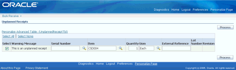

If there is at least one problem, the Bulk Receive Warnings page appears.
You can optionally edit any of the fields.
Click Process.
The Depot Repair Bulk Receive Items concurrent request is submitted. A confirmation message shows the request number and the Transaction number parameter associated with the request.
Note: Note down the Transaction number. In case there are any errors in the processing of the entries, it can be reused in a subsequent submission of the concurrent request - see step 12.
The concurrent request attempts to create the following objects for each data row, depending on what data has been entered:
One service request
A repair order and an RMA for each item
The concurrent request will also attempt to auto-receive the items.
To see the results of the concurrent request, examine the output of the request.
The report shows which objects were created, and also any errors.
After you correct the errors, you can explicitly resubmit the Depot Repair Bulk Receive Items concurrent request, entering as a parameter the same Transaction number that appeared in the confirmation message at step 8. This resubmitted concurrent request will attempt to process only the error entries.
