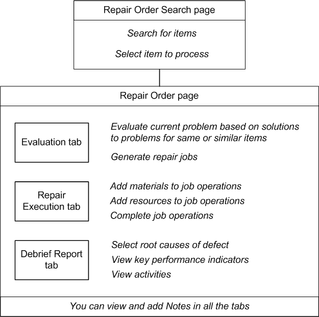

High volume repair is an enhancement to the standard repair and return process. It automates and facilitates the creation of work orders, procuring and issuing materials, and assigning resources with minimal input and decision making from a repair technician. Based on a finite number of possible symptoms and a finite number of responses to those symptoms, the system can recommend or dictate work to be done, materials demanded, and resources needed for low complexity repairs based on symptoms captured by a technician.
The following diagram shows an overview of the high volume repair processing, to be performed in two pages, the Repair Order Search page and the Repair Order page.

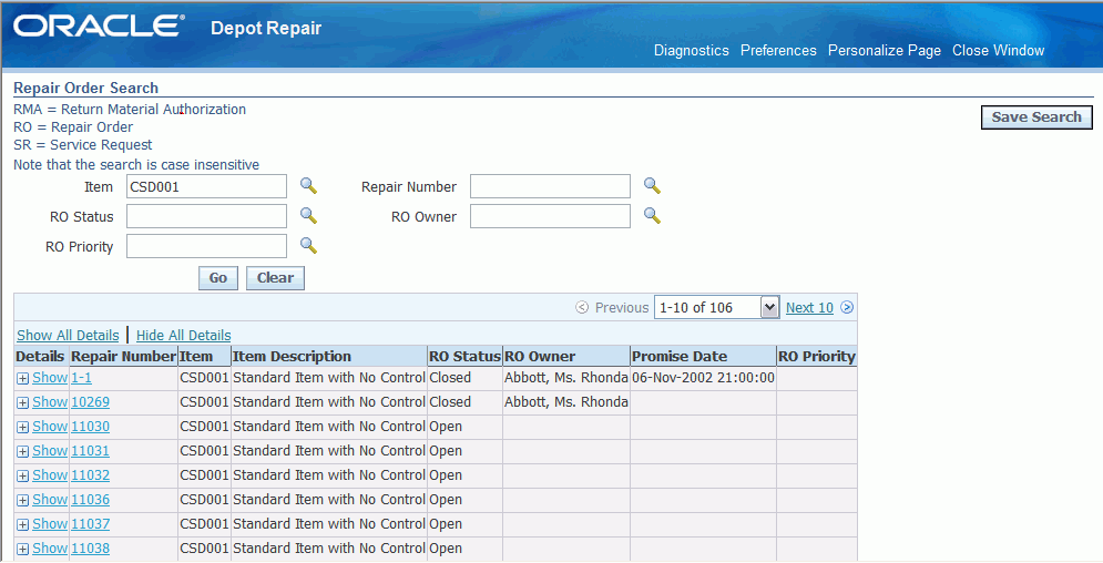

In the Repair Order Search page, you can search for all non-draft repair orders.
The seeded default search parameters are
Item
Repair Number
Repair Order Status
Repair Order Owner
After filling in one or more search parameters, click Go to perform the search.

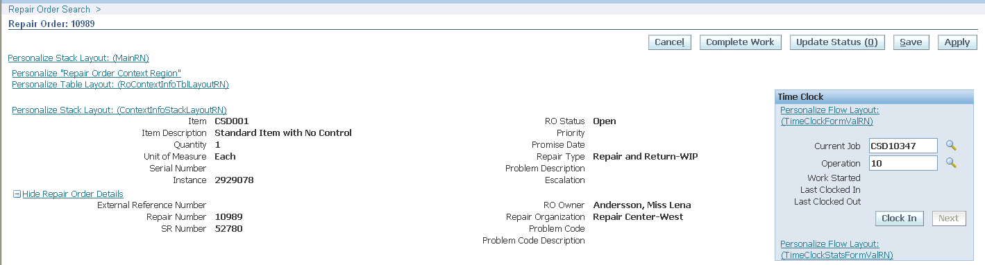

Click the Repair Number link to continue processing a repair order in the Repair Order page.
The top of the Repair Order page contains general information about the item instance that is being repaired. You can also show or hide repair order details in this region.
Note: You can view the Recall Number link if it’s view is personalized. Click on the link to drill down to the view-only Recall Details screen.
The main actions to perform in this page are controlled by the buttons: Save, Apply, Cancel, and Update Status.
The main body of the Repair Order page contains three tabs - Evaluation, Repair Execution, Debrief Report - where you perform the main repair order processing.
For more details about these tabs, select one of the following:

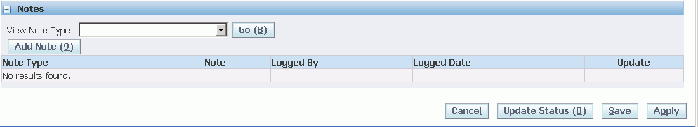

The Notes region, at the bottom of the page, is to allow you to view and add notes.

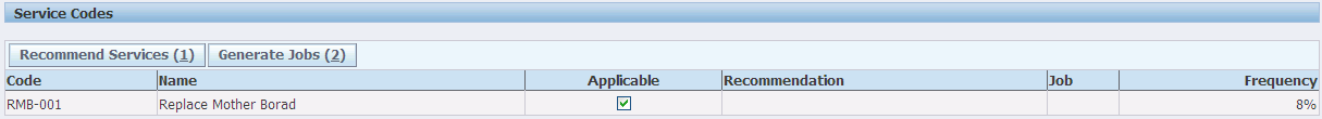

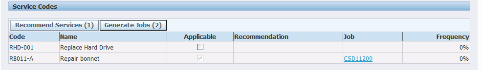

The Service Codes region initially displays the service codes associated with the repair order item, that is, the service codes which fulfill at least one of the following conditions:
The service code has the repair order item as one of its item domains.
The service code has a category domain which is the same as the category of the repair order item.
For more information, see the topic Setting Up Service Codes in the Oracle Depot Repair Implementation Manual.
The frequency indicates the percentage of times that the service code was marked as Applicable in all closed repair orders for the same repair item.
Mark one or more service codes as Applicable.
Click Recommend Services.
Note: To use this feature, you must have previously set up the recommendations. See Setting up Service Code Recommendations in the Oracle Depot Repair Implementation Manual.
After you click Recommend Services, you may get several service codes returned and automatically marked as Applicable in the Service Codes region, depending on how you set up your recommendations.
When the profile option CSD: Mandate Service Code Recommendations is set to Yes, then any service codes returned which had been set up with a Recommendation type of Always are automatically marked as Applicable and are disabled. This is to ensure that the service codes are used in any jobs generated from this region.
Click Generate Jobs.
For each service code marked as Applicable, Oracle Depot Repair generates a WIP job, with any bills and routings that were previously associated with that service code.
For more information, see Setting Up Service Codes in the Oracle Depot Repair Implementation Manual.
In the Service Code table, click the hyperlinked Job number to drill into the WIP Details. The WIP Details page provides information on the available quantity for the parts required on a job, the operations which are for outside repair, and other details that are provided in WIP Jobs.

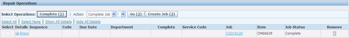

The Repair Operations region shows the operations for the current repair order item instance, whether generated from the Evaluation tab, or created explicitly in the Repair Execution tab.
Update operation details - click the Update icon for the operation.
Add operations to a job - select one or more operations, select the Action Add Operation to Job, select the job from the list of values, and click Go.
Complete operations - select one or more operations, and click Complete.
Complete the job - select the Action Complete Job, select the job from the list of values, and click Go.
Drill into WIP Details – Click the Job link to navigate to the Job Details page to drill into the WIP details of the job.

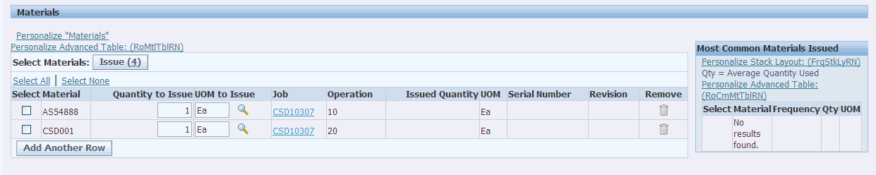

The Materials region has two sub-regions:
The general Materials area
The Most Common Materials Issued area
The first-time display of the Materials area shows the materials automatically added to a job through service codes.
The Most Common Materials Issued area, if populated, shows which materials were used in previous similar repair jobs and repair orders.
Specifically, all closed repair orders for the current repair order item with completed or closed jobs are examined. The Frequency column for a material shows the proportion of those examined repair orders whose completed and closed jobs used the material. The Average Quantity Used shows the average units used in all the "matching" repair orders whose jobs contained the material, rather than in all the examined repair orders.
Examine the materials in the Most Common Materials Issued area, and decide if they are relevant to the current repair order. If so, select one or more materials, and click Add to Materials.
Note: You cannot add materials that already appear in the general Materials area.
The selected materials appear in the general Materials area.
In the general Materials area, you can enter quantity and UOM values for a material before or after it is issued to a job.
If the quantity to issue is 1 for a serialized item, you must also enter the Serial Number for the item.
For materials added from the Most Common Materials Issued area, enter and select values for Quantity to Issue, UOM to Issue, Operation, and Job.
Click Save to save the data you have entered so far.
If you selected an operation and job in the current session, the materials are added to the job details, but not issued to the job; the Job field displays a link to the job.
To issue materials to a job, select one or more materials, and click Issue.
For materials that require more information, the Material Issue Details page appears.
For example, if you want to issue more than one serialized item, you must enter the serial numbers here. Also, if your item has lot control, you must enter the lot number here.
After you have issued materials, the general Materials area shows the Issued Quantity and the primary UOM.
You can continue to enter Quantity to Issue values, including negative integer quantities.
Note: You can personalize the Materials table to enable the hidden Revision field. The Revision field allows you to enter and transact revision-controlled items. If the revision field is blank for a revision-controlled item, you are directed to the Material Issue Details page at time of issue or at time of operation or job completion for items with Assembly Pull Supply Type.. If the revision field and all other required fields are entered then the item is issued immediately.
The Revision field defaults to the latest revision for revision- controlled items if the profile option CSD: Default Current Item Revision for Material Transactions is set to Yes. When the profile is set to No, the revision field is not defaulted and it is left blank.
You can personalize the Materials table to display the Request Parts button that enables a technician to create a purchase requisition for one or more items on the Materials table.
You can personalize the Materials table to display the Material Transaction Reason Code column that provides Disposition Code that is used in the Eco-Impact tab of the Returns Dashboard. For more information on the Returns Dashboard, please see: Returns Dashboard chapter.

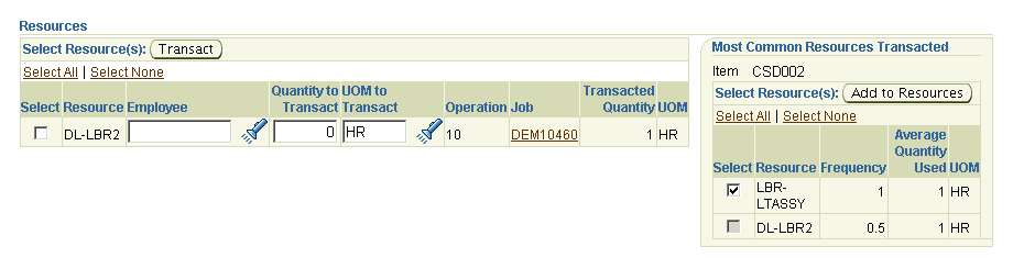

The Resources region has two sub-regions:
The general Resources area
The Most Common Resources Transacted area
The first-time display of the Resources area shows the resources automatically added to a job through service codes.
The Most Common Resources Transacted area, if populated, shows which resources were used in previous similar repair jobs and repair orders.
Specifically, all closed repair orders for the current repair order item with completed or closed jobs are examined. The Frequency column for a resource shows the proportion of those examined repair orders whose completed and closed jobs used the resource. The Average Quantity Used shows the average units used in all the "matching" repair orders whose jobs contained the resource, rather than in all the examined repair orders.
Examine the materials in the Most Common Resources Transacted area, and decide if they are relevant to the current repair order. If so, select one or more materials, and click Add to Resources.
Note: You cannot add resources that already appear in the general Resources area.
The selected resources appear in the general Resources area, with the Employee field set to the value of the profile option CSD: Default HR Resource.
In the general Resources area, you can enter quantity and UOM values for a resource before or after it is transacted to a job.
You can select a new employee.
For resources added from the Most Common Resources Transacted area, enter and select values for Quantity to Transact, UOM to Transact, Operation, and Job.
If you selected an operation and job in the current session, the resources are added to the job details, but not transacted to the job; the Job field displays a link to the job.
To transact materials to a job, select one or more resources, and click Transact.
After you have transacted resources, the general Resources area shows the Transacted Quantity and the primary UOM.
You can continue to enter Quantity to Transact values, including negative integer quantities.
Note: When you transact the resources in the Repair Technician Portal either by Work In process (WIP) move or manual transact, the records are put into WIP interface tables. A WIP concurrent program then processes it. The control comes back immediately to Repair Technician Portal page. However, the actual transaction data is not posted to the WIP tables immediately. Thus, if we try to import the repair actuals from WIP immediately after completing the job, the actuals may be incomplete at times.

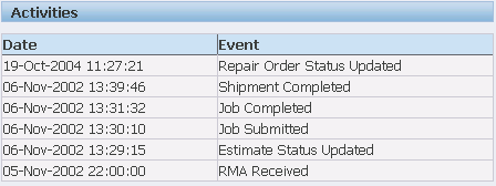

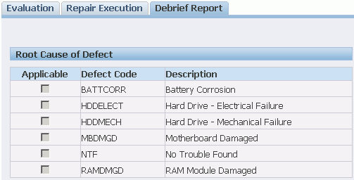

The Debrief Report tab enables you to view certain post-repair details, such as activity events, summary activity statistics, and key performance indicators, such as time to repair.
You can also select one or more defect types to associate with the repair order.
The Root Cause of Defect region lists the defects that you can associate with the repair order. You can optionally select one or more of the defects as applicable to the repair order.
Defect code domain setup enables you to link each root cause code to specific items or item categories. The Repair Technician module displays only the root cause codes that match the item or category of the item on the repair order.
Refer to Oracle Depot Repair Implementation Guide for details on Setting Up Defect Code Domains.

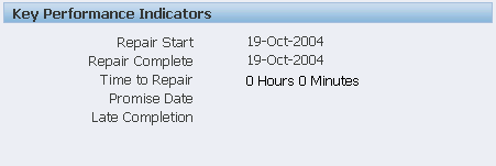

The view-only Key Performance Indicators and Activities region provides statistics about the repair order, including a history of the repair activity events.

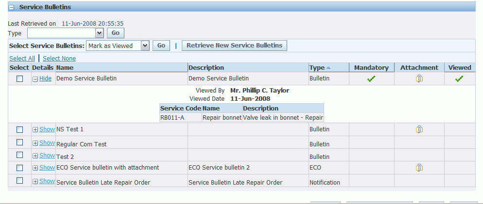

To view service bulletins
Navigate to the Repair Technician module. Query the repair order number for the item to associate the service bulletin.
Click on the repair order number link to navigate to the Repair Order page. The Repair Order page displays the detailed information of the corresponding repair order number.
In the Service Bulletins region, click Retrieve New Service Bulletins to display the newly created service bulletins. You can view a service bulletin by Type. For example:
You can retrieve multiple service bulletins within one repair order. In this case, one repair order triggers multiple service bulletins.
You can retrieve service bulletin for Chronic Repair Order. Set the profile CSD: Number of Days in Quality Check period to use this feature.
Note: The Depot Repair Service Bulletin Retrieval concurrent program checks the set of applicable repair orders and links any service bulletins which apply to them and have not already been linked. This supports business scenarios that need to check all open repair orders for service bulletin applicability. This concurrent program scans a selected set of open repair orders based on parameters such as:
Service Bulletin Type
Repair Order Status
Repair Order Inventory Organization
Repair Organization
Repair Order Item
Select a service bulletin and click Show to display the following details:
The Mandatory flag represents that the service bulletin is marked as mandatory in the setup stage. This also indicates to the repair technician that this service bulletin is mandatory.
The Attachment icon represents that an attachment is added to the service bulletin. Click the attachment to download the attachment.
The Viewed flag represents you have selected the service bulletin to Mark as Viewed from the list of values at the time when the service bulletin was set up. You can view who has viewed the service bulletin and the date of viewing. You can mark a service bulletin as unviewed by selecting Mark as Unviewed.
It enables a service organization to capture whether or not a technician has viewed and complied with a bulletin that contains an instruction. No enforcement for this exists within the application, but this provides a tracking mechanism if you choose to enforce it.
The Service Code represents that a service code is linked to the service bulletin.
Navigate to the Service Codes region. The selected Applicable checkbox represents that a service code is linked.
These service codes are attached to the service bulletin on the setup page. When you retrieve the service bulletin and attach it to an RO, if any of the service codes linked to the service bulletin at time of bulletin setup are valid for the repair item and inventory organization then the Applicable checkbox on the Service Codes region of the Evaluation tab is checked.
At this point, repair technicians can generate jobs from these service codes by clicking Generate Jobs. Once you generate a job, the job number displays in the Job column and the Applicable checkbox is disabled.

The service bulletin automatically applies the specific service code to the repair for taking the ECO.
Note: If the ECO is applied already, the profile stops the notification from triggering each time, assuming you have already applied the ECO the first time you were notified. This prevents you from receiving constant notifications.

Backflushing implies automatically performing an inventory material transaction whenever an operation is completed or whenever a job is completed. There are two Supply Type setup options in Inventory/BOM that allow backflush:
Assembly Pull: Assembly Pull issues the material to the job when the job is completed
Operation Pull: Operation Pull backflushes the item when the Operation is completed.
If either of these values are chosen for the supply type, then the item backflushes, if its non-serialized. This function reduces the repair technician clicks on jobs where components are not tracked serially.
The high volume repair centers mostly create a single job for any item they repair. When an item is repaired using a WIP job, the item must be issued to that job, and when the job is completed the same item is transacted to the WIP completion subinventory.
Auto-issue repair item to jobs feature enables a depot to automatically add the repair item as material demand for a job, thus freeing repair technicians from additional data entry.

The Repair Technician page contains a header level bin named Time Clock that facilitates clock in and clock out.
The Time Clock bin has the following layout:
Operation
This field defaults to the first operation on the Operations table.
If no operation exists, this field is left blank but defaults to operation 10 when creating Resource lines. You can select different operation from the list of values but you cannot select an operation outside of the Operations table.
You can update the Operation LOV before you clock in your time. You cannot update an operation once you clock in as the clock in time operates against a specific operation.
Operation LOV displays operations sequentially.
Work Started
Work Started field displays the first clock in time for a technician.
You can view the work-started time for your repair order only.
Last Clocked In
This timestamp displays the last recorded clock in time and date for the current technician.
This field is blank for the first time the technician opens the repair order.
When you clock in the time, this field reflects this new clock in time.
When you clock in the second time, the original clock in time is overwritten with the new time.
Last Clocked Out
This timestamp displays the last recorded clock out time and date for the current technician.
This field is blank of you are clocking out for the first time.
When you clock out, this field reflects this new value.
When you clock out the second time, the original clock out time is overwritten with the new time.
Clock In and Clock Out
Clock In and Clock Out are same buttons with toggled text.
This button displays Clock In when the clock is stopped and Clock Out when the clock is running.
You can clock in / clock out against a particular job multiple times.
Clock In button creates your record in the Resource Time table for the repair order, resource item, resource name, operation, and clock in time.
Clock Out button updates the clock out time for your record in the Resource Time table for the repair order, resource item, resource name, operation and clock out time.
You can clock in and clock out when there is no job or operation. The system assumes that all the time accrues to the first job created.
Note: If you fail to clock in or clock out you can notify the manager. The manager then opens the repair order and adjusts the total labor on the Resources table and updates the repair order status. This assumes that personalization is used to restrict access to the Resource table. In the absence of this personalization, you can add or remove resource time from the table.
Next
This button permits to clock out from current operation and clock in to the next one.
The button is enabled when you clock in the first time and it is disabled when you clock in to the final operation for a repair order.
This creates a new resource record in the Resource table. The Operation LOV gets updated to the next operation in the sequence. If more than one operation exists, the sequence is to complete all operations on the lowest job number first, then the next lowest job number operations and so on.
A new clock in record is also created for the resource item, resource name and new operation.
The Repair Technician page contains a header level button named Complete Work that enables you to stop the clock and trigger various actions like: complete operations, complete jobs, log labor hours, transact resources, issue materials, change repair status, or kick off a workflow.
This button is enabled using personalization.
When you click this button, materials, resources, operations, and jobs are processed first. Then the status is updated which triggers the workflow.
Clicking this button automatically clocks out the technician if it is not done already.
When issuing serialized items, you have to manually capture the serial number before clicking Complete Work button.
This button processes only the un-issued items, transacts only the un-transacted resources and completes the un-complete operations or jobs.
Note: Both the Time Clock bin and Complete Work order button are enabled by personalization.
