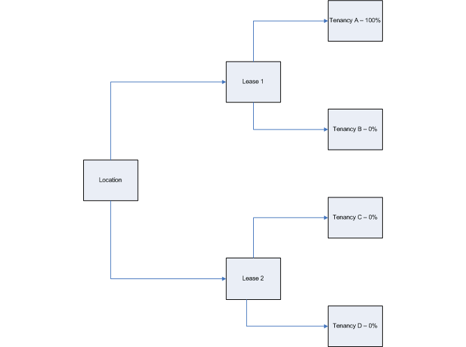

Allow Tenancy overlap within Lease: Yes
Multiple Tenancy Lease: Yes
Automatic Space Distribution: Yes
For this combination of system options, the following diagram describes the expected behavior of customer space assignments:

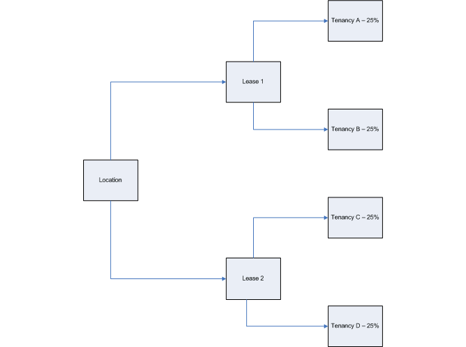

Automatic Space Distribution: No

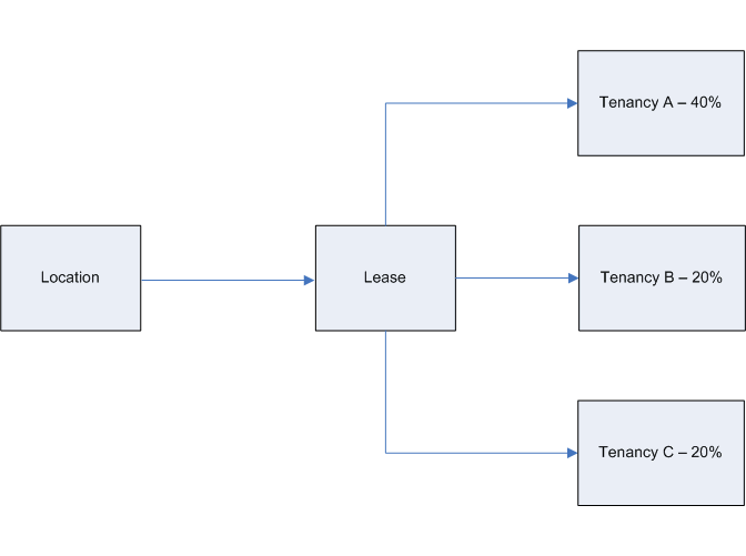

Multiple Tenancy Lease: No

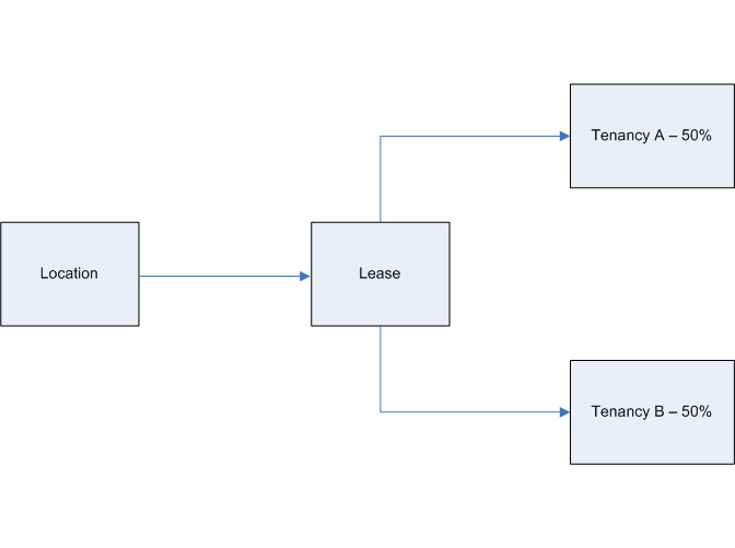

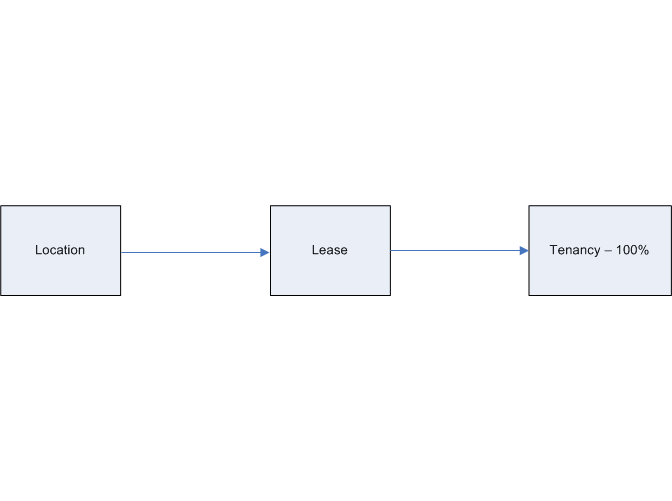

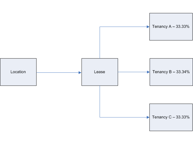

Allow Tenancy overlap within Lease: No
