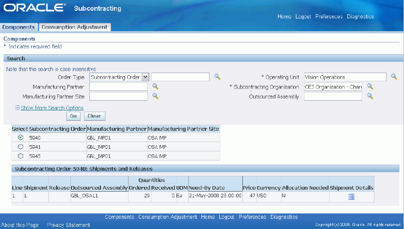

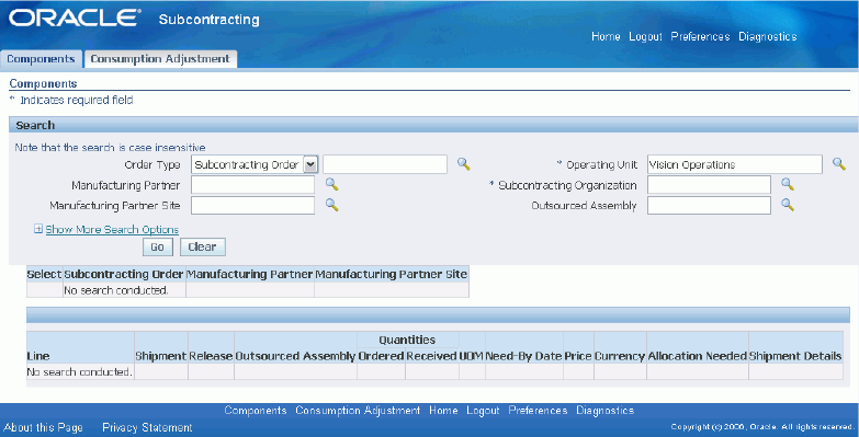

On the Components page of the Workbench, you can search and view Subcontracting Orders by manufacturing partner, or by an assembly. If you are using Project Manufacturing, then you can also search and view the subcontracting orders by project.
These subcontracting orders are regular purchase orders and releases created for outsourced assemblies. You can view header details in the Workbench.
Subcontracting order lines contain details of the outsourced assembly ordered through the MP.
Details of the components required for manufacturing the outsourced assembly at the MP's site can be viewed on the shipment details page.
Navigate to the Subcontracting Workbench User Interface.
Select the Components tab.
Select the Subcontracting Order type from the list of values.
Enter an Operating Unit and Subcontracting Organization (required).
Enter additional search options as desired, and click Go.
Search parameters include:
Subcontracting Order and Order number, or Replenishment Order and Order number
Operating Unit
Outsourced Assembly
Subcontracting Order Date From and To
Manufacturing Partner
Manufacturing Partner Site
Purchase Order Status
Allocation Needed

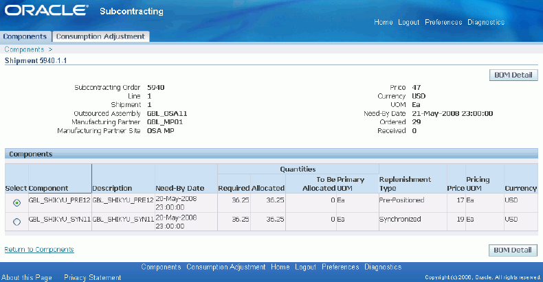

Click the Shipment Details icon to navigate to the shipment details page. The Shipment Details page displays the components to be shipped by the OEM to the MP for manufacturing the assembly.
This page shows the details of component requirements and allocations for manufacturing the assembly and list price (sales price) of the components at the time of creating the subcontracting order.

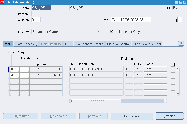

Click BOM Detail to view the current BOM details of the outsourced assembly.
The Bills Of Material window appears and displays component details. This is useful for comparing the components with the current BOM components in case the components are different from the BOM due to revision change introduced after creating the subcontracting order. You must cancel the subcontracting order and then recreate a new subcontracting order and run the Reconciliation Manager and Interlock Manager. The new subcontracting order and components are created with the new BOM.

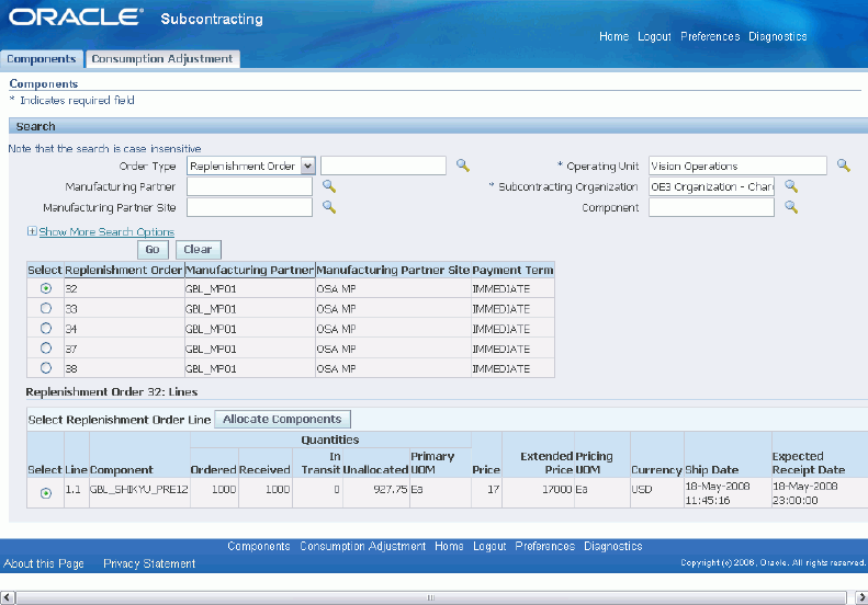

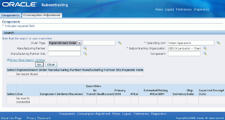

On the Components page of the Workbench, you can search and view replenishment orders created in the OEM organization for shipping components to the MP. You can search for replenishment orders by MP, by component, and by project. On the Components page:
Search results display as replenishment order headers
When selecting a specific order, you can view the replenishment sales order lines for shipping the components. For synchronized components, the replenishment order is allocated to one subcontracting order for the outsourced assembly. For pre-positioned components, the replenishment order is generally allocated to multiple subcontracting orders.
Click Allocate Components to view and create allocations
The Subcontracting workbench lets you manually allocate shipments if necessary.
To view replenishment orders
Select the Replenishment Order type from the list of values.
Enter additional search options as desired, and click Go. The Components page appears and displays a list of Replenishment Orders. The page also displays order lines for selected orders.

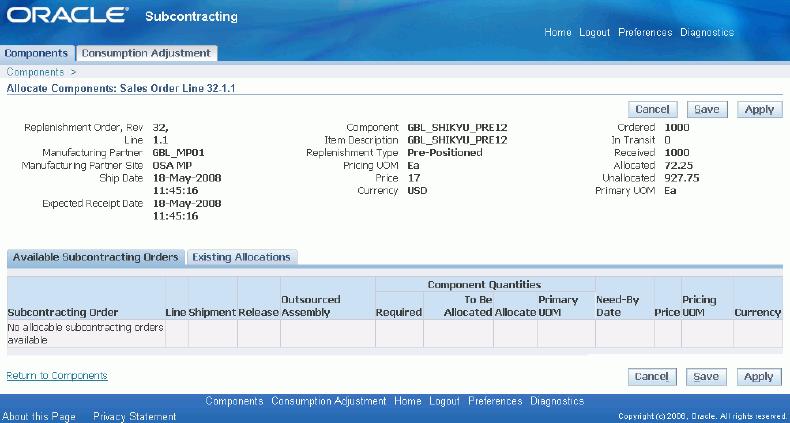

To view and create allocations
On the allocations page, you can view existing allocations that were created by Interlock Manager, and create allocations manually if required. For synchronized components, replenishment orders are always created for the required quantity of the discrete job associated to a subcontracting order. These replenishment orders are always fully allocated. For pre-positioned components, replenishment orders are created well ahead of requirements, and are allocated periodically. As a result, these orders can have unallocated quantities.
From the Components page, click Allocate Components. The Allocations page appears and displays allocation details for the selected order.
Select the Existing Allocations tab to view details of the subcontracting orders allocated to the current replenishment order.
Select the Available Subcontracting Orders tab to display a list of subcontracting orders that require component allocations. For replenishment sales orders of pre-positioned components, there may be unallocated quantity. If pre-positioned components are not fully allocated, then you can manually allocated them in this page.
Enter the quantity to allocate in the Allocate column and click Apply.

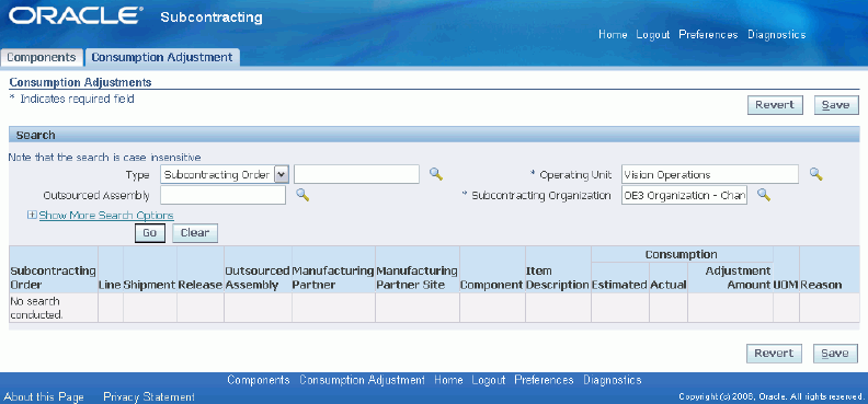

Subcontracting orders are executed based on the planned component requirements as per the BOM of the outsourced assembly. It is assumed that the MP consumes the components based on the planned BOM component quantity and Yield, and the simulated inventory records of the MP organizations are processed accordingly. However, the MP might consume more or less components for manufacturing the assembly due to process variations, and the OEM must adjust the simulated records of the MP organization for proper inventory and financial accounting.
The MP sends a report of actual material usage at the period end, and the OEM verifies and adjusts the simulated records.

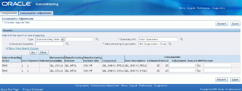

Use the Consumption Adjustments page to enter adjustments for the subcontracting component based on reports sent by the MP. You can search subcontracting order components by OEM organization, subcontracting order number, or component. Enter the actual consumption of the subcontracting order component at the manufacturer partner’s facility.
The component adjustments reported through the workbench are further processed by the Subcontracting Consumption Adjustment Manager concurrent request. It adjusts subcontracting components on-hand quantity in supplier organizations, and adjusts allocations between subcontracting replenishment orders and subcontracting orders.
To report consumption adjustments
Navigate to the Subcontracting Workbench.
Select Consumption Adjustment.
Select Subcontracting Order or Component (required).
Note: If the adjustment type is by Subcontracting Order, then input into the Purchase Order number is required. If adjustment type is by Component, then input into the Component is required.
Enter additional search options as desired, and click Go. The Consumption Adjustments page appears and displays subcontracting order line details.
Enter the Adjustment Amount and a Reason for the adjustment.
Click Save.
Note: The application displays required quantity based on the BOM. Actual consumption will be the same as planned consumption. You must enter the variation in the consumption. If the consumption is more, then enter positive quantity in the adjustment amount indicating more consumption than planned quantity. If consumption is less, then enter quantity with a minus (-) sign, indicating that quantity consumed is less than the planned quantity.
