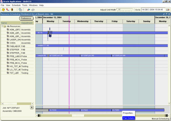

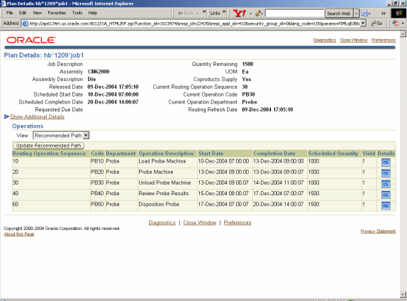

Use the Oracle Shop Floor Management HTML user interface to change recommended paths, or choose substitute components.
If changes are made, then you can reschedule the entire shop floor based on mid-point, forward, or reverse scheduling. The scheduling is based on the infinite scheduling method.

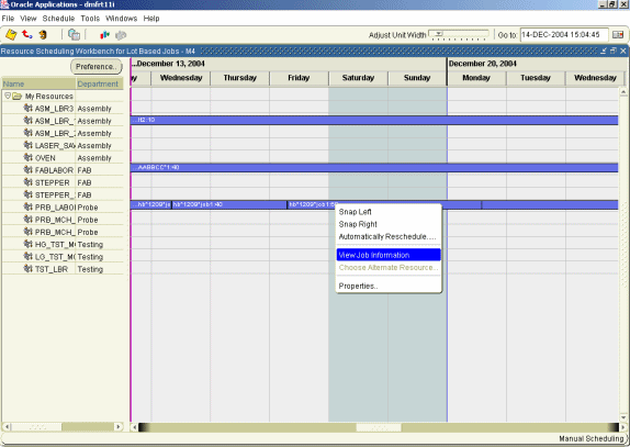

Launch the Resource Scheduling Workbench by navigating to the Resource Scheduling Workbench for Lot Based Jobs window from the Resource Scheduling Workbench menu item in Oracle Shop Floor Management responsibility.
The workbench appears and shows all the jobs in the Navigator hierarchy and Gantt Chart panes.
The navigator on the left side of the workbench displays the resources, and the Gantt Chart pane displays graphical bars that represent the job operation that the resource is used in.
My Resources is the root in the navigator, and contain no resources the first time you open the workbench. The resources that you select and the display order are saved in User Preferences.
If you drill down a level from the resource, then you will see all resource instances for that resource. Person type instances also display under Resources in the navigator. You can assign the same person to multiple resources.
The Resource in the navigator is a combination of the resource and owning department, and any instances under that resource belong to the department.
The bars in the timeline represent the job operations where the resource is being used. The duration of the bar depicts the start and end times of the resource used in that job operation.
Each job and operation bar has a label that represents the job, operation, and department where the resource is used. You can customize labels in the Preferences window.
If a resource is used in multiple job and operations, and those job and operations overlap, then the bars overlap in a cascading pattern.
The current operation of a lot-based job displays in adifferent color.

If you position the cursor over a job operation, then that job operation bar is selected. If you keep the cursor over the bar, a tool tip appears, giving details about the job operation.
If you position the cursor over a job operation that contains a simultaneous resource, then any other corresponding simultaneous job operation resources are selected. Similarly, if you place the cursor over a job/operation for a batched resource, then all other job/operations in that batch will also be selected.
The bars in the gantt chart contain a progress indicator. Since a lot-based job does not have partial completion, this indicator displays either 0% or 100%. This displays separate completed operations from those not completed.
If you select a bar that is in a group of overlapping bars, then that bar appears at the top of the group. The vertical position of the bar will not change, and the bar will remain on top as long as the mouse button is pressed. Once the mouse button is released the bar will return back to its original position.

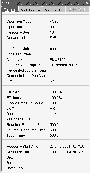

Property windows for jobs, operations, or resources are available in the Gantt Chart pane. These windows contain information about dates, quantities, descriptions of the scheduling data. See: Job Properties Window, Operation Properties Window, and Resource Properties Window.
Right click on a job, operation, or resource in the navigator hierarchy or Gantt Chart pane.
Right click on a job, operation, or resource.
A drop-down menu appears.
Choose Properties. The property window for the respective job, operation, or resource displays.
Right click on an operation resource bar, select menu "View Job Information" and a job view will appear on the bottom of the window.
Right click on the operation in "Job View" area, select menu "Properties", a property window for the job operation will show up.

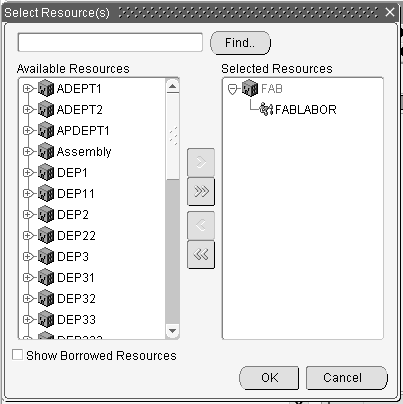

You can select a specific resource. If you are uncertain of the resource name, expand a job and an operation and view the specific resource of interest. Select a resource bar with your mouse pointer (yellow text bubble appears which indicates the name of the resource). The name of the resource is also available on the Resource Properties window.
To select a resource
In the Select Resource(s) pane choose the Select Resources button.
The Select Resource(s) window appears.
In the Available Resources pane select a resource or an instance.
Choose the right arrow button.
The resource appears in the Selected Resources pane.
Choose OK.
The name and description of the resource appears in the Select Resources pane and its corresponding graphic display for the resource appears in the Resource Load Versus Capacity pane. This represents the resource load for all jobs on the shop floor requiring this resource. The default graphic view is Table. The Required and Available key indicators appear.

Right click on the job operation bar that you wish to move. A menu will appear.
Choose Snap To from the menu
Choose Snap Left or Snap Right. Snapping left aligns the starting time of your job operation to the next closest start or end time of another job operation. Snapping right aligns the ending time of your job operation to the next closest starting or ending time of the nearest job operation.

Right click a job or operation bar in the Gantt Chart region.
Select View Job Information from the drop down menu. The Job Information region displays a new graphical region at the bottom of the Gantt Chart region that displays the job information.
Right click a job bar in the Job Information region.
Select Plan Details from the list. The Plan Details HTML window appears and displays the plan details of the job. You can make changes to the lot-based job from the Plan Details HTML window.
