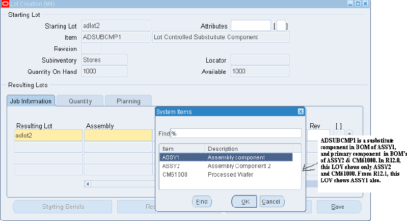

With this new functionality you have the choice to create lots with the same name as the earlier sector.
Default Job Name in Lot Creation form
When you create a lot in Lot Creation form, you have the option of job names being defaulted with the same name as that of the parent lot or different name from that of the parent lot. If you set Reuse Job Name to No, then the newly created jobs will have names with the job separator appended to the parent lot name. If Reuse Job Name is set to Yes, then the newly created jobs will be defaulted with the same name as the parent lot, provided there is only one resulting job. If there are multiple resulting jobs, then the first job will have the same name as the parent lot and the remaining jobs will have names appended with job separator.

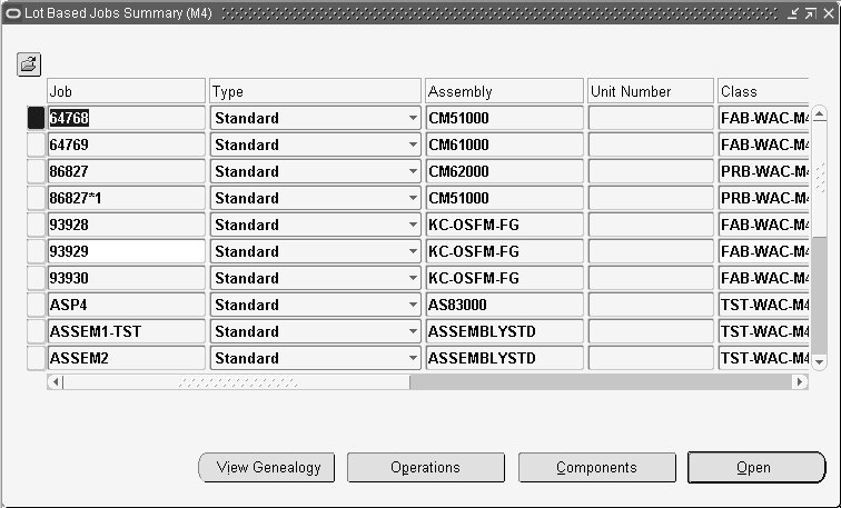

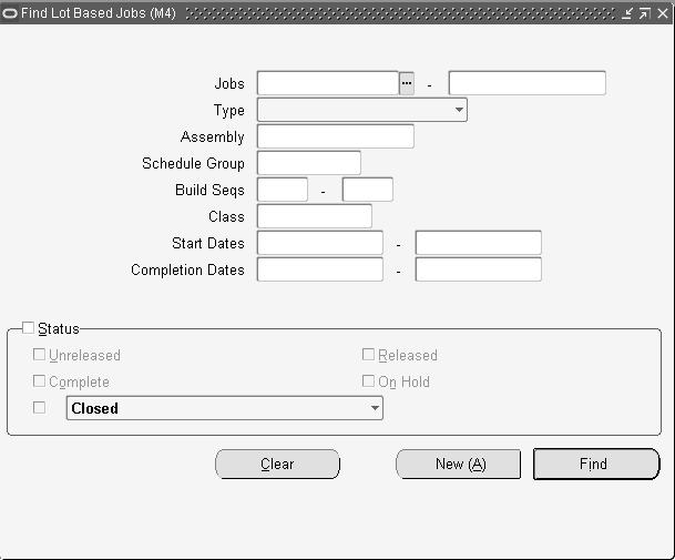

To find lot based jobs
Navigate to the Lot Based Jobs window.
The Find Lot Based Jobs window displays.
Enter your search criteria.
You can query by job name, assembly, accounting class, a range of start dates, a range of completion dates, or job status. You can combine or omit criteria as required.
Choose Find to display the Lot Based Jobs Summary window.
Select a lot based job and choose one of the following actions.
View Genealogy to view historical informations in the Lot Genealogy window, see: Displaying Genealogy and Where used Views.
The Operations window is used to view the resource requirement for the lot-based job.
The lot-based job provides the resource details for the first operation during job creation and the resource requirement for the other operations are shown whenever the job is moved to this operation.
Components to access the Material Requirements window displaying all the components for this job

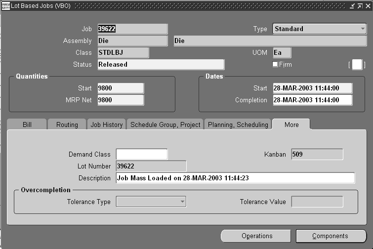

Open to display the details of this job in the Lot Based Jobs window.

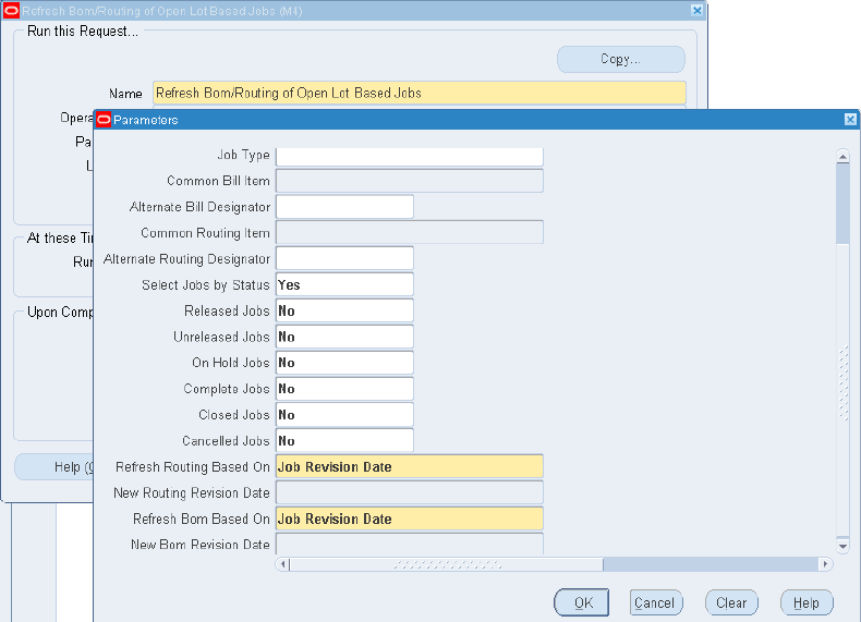

If you set the WSM: Create Job Level BOM and Routing Copies profile option to Yes (Option 2), then you can choose Plan Details from the Tools menu to open the UI and display the planned operation details.

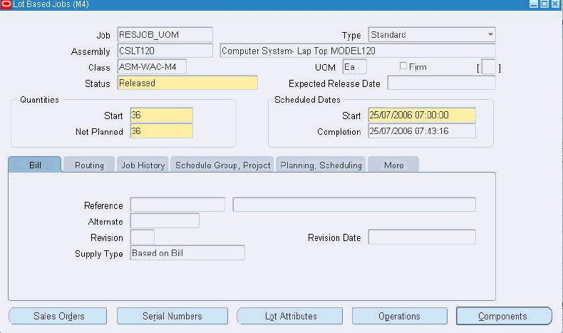

If you are creating a new lot, Choose New (A). The Lot Based Jobs window opens.
Enter the name of the job in the Job field.
Oracle Work in Process discrete jobs and Shop Floor Management lot based jobs must not use the same value for Job name. In the Job Type field, the value defaults to standard. Oracle Shop Floor Management uses both standard and non-standard jobs.
As you proceed with the manufacturing process, the job name changes as lots are created, split, renamed, and completed. While creating lots, the name cannot exceed 80 characters.
Note: Do not use the same character value for both the job completion separator, and in a segment of the job name. When lots are completed the resulting lot designation is the original lot number, followed by the job separator value, followed by the lot sector extension. Using the same character value creates an error in the resulting lot name.
Select the assembly in the Assembly field.
Select the job status in the Status field.
When you define a job, its status defaults to Unreleased but can be changed to Release or On Hold.
Use the Firm indicator to firm this job.
Firming a job prevents planning suggestions for rescheduling. However, lot based jobs are not considered in the Oracle Master Scheduling and MRP, but are planned in Oracle Advanced Supply Chain Planning. This field is not used by non-standard jobs.
In the Quantities region, enter the Job quantity of the job or lot in the Start field.
When you enter a Job start quantity for the Lob Based job using bills and routings, the component material requirements and resource equipment for the First Operation will be exploded into this Job.
You can change the quantity on jobs without transactions.
In the MRP net field, the quantity is derived from the job start quantity.
Oracle Shop Floor Management does not integrate with Oracle Master Scheduling/MRP. This field supports Oracle Advanced Planning and Scheduling, applications.
In the Dates region, enter a value in either the Start or Completion field.
If you enter a start date, the completion date is forward scheduled. Similarly, if you enter a completion date, the start date is backward scheduled.
Save your work.

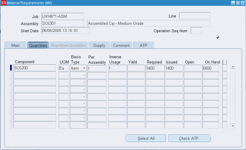

Viewing Component Requirements
To view component requirements
Choose Components. The Material Requirements window displays showing all the components of this job.
If you set the WSM: Create Job Level BOM and Routing Copies profile option to No (Option 1), then you can view component requirements for completed and current operations only. If you set the WSM: Create Job Level BOM and Routing Copies profile option to Yes (Option 2), then you can also view component requirements for future planned operations. The profile value is set as Yes by default and not changeable, hence the Option 2 action is always shown.

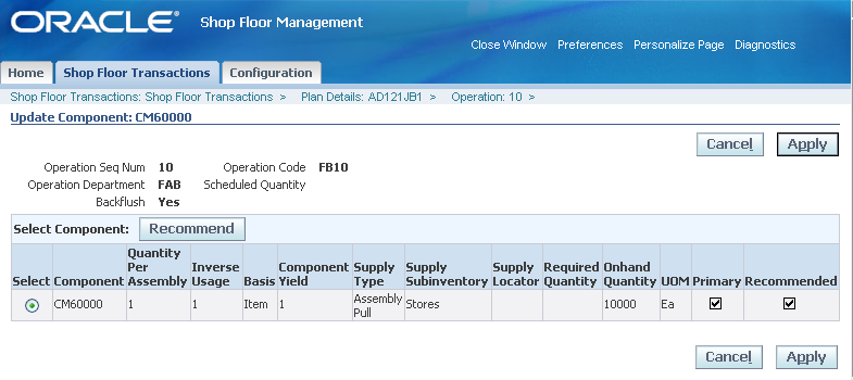

Updating the Existing Records
You can update the components at any operation; for example, it may be in Run/Queue/To Move.
Case 1
If you change the Quantity Per Assembly, then you must proportionately change the displayed Required Quantity.
Caution: Note that you are only changing the display value of the Required Quantity and not the value in the system.
Case 2
You can also update the required quantity of the component at any operation.

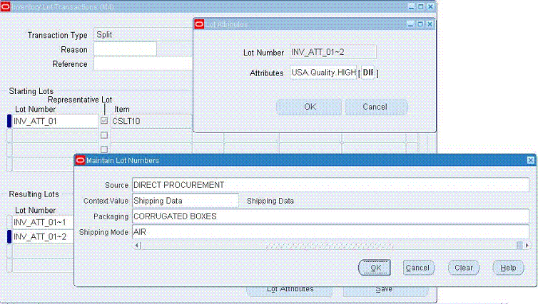

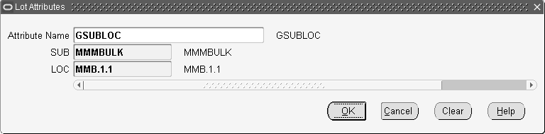

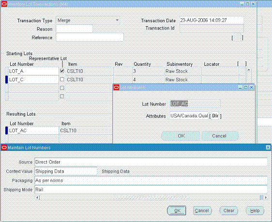

Viewing, Entering, and Updating Lot Attributes
To view, enter, and update lot attributes
Choose Lot Attributes. The Lot Attributes window appears and displays the lot number and attributes of this job.
If you are entering or updating lot attributes, then enter or update attributes with appropriate values for Wharehouse Management and Inventory attributes based on the lot attributes setup that you or your system administrator have completed.
Choose OK to save and return to the Lot Based Jobs window.
Choose Cancel if you do not want to save the lot attribute changes.
If you are only viewing the lot attributes without making changes, then you can choose OK or Cancel.
Save your work.
Note: If you do not enter a required segment value, then an error message appears. If you wish to view detailed information for an error message, then you must execute the concurrent request Get Messages using the parameter DB_TO_RUNTIME with a specific Language.

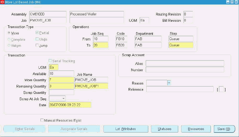

To update reservations during move transactions
During moves, if available quantity falls below the net quantity, a warning is shown.
During split and merge transactions, you have to manually transfer reservations to new child jobs.
Reservation will be transferred to inventory from the lot based job on assembly completion transaction.
During assembly return transaction, reservations transferred from job to inventory on assembly completion will be reversed.

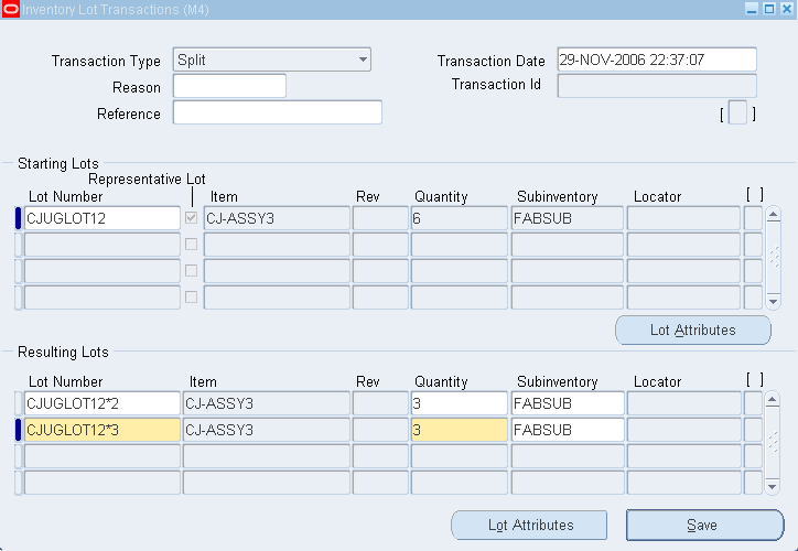

Split: If one of the resulting lots is same as the starting lot, then Reservation Quantity changes with respect to job Net Planned Quantity of the resulting lot.

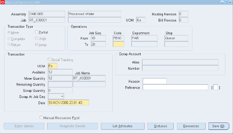

To perform lot move transactions
Navigate to the Move Lot Based Jobs window.
In the Assembly or Job field, select either an item assembly number or lot job number.
Depending on which value you enter, the defaulting information for the corresponding field displays.
Move displays in the Transaction Type region.
Move transaction type indicates moving from one operation to another. Complete transaction type is active only when the job is moving to the last operation and last intra-operation step. See: Move Transaction Types, Oracle Work in Process User's Guide.
Select the Undo Last Move check box if you want the option of cancelling the last move transaction. The Undo Last Move indicator on the Shop Floor Parameter window must be selected to enable this functionality.
Select the Partial checkbox if you want to move a job partially to the next operation in sequence, when required, or within an operation from one intraoperation step to another. Partial checkbox is clear by default.
Enter the quantity (from the Available quantity) you want to partially move to the next operation in the Move Quantity field.
The original job with the partial quantity moves to the specified next operation, the split part (child job) of the original job will remain at the same operation level with the difference in the original quantity.
The remaining quantity is displayed in the Remaining Qty field. The checkbox is defaulted for the next move transaction. If the Partial checkbox is checked, the Move Quantity and Remaining Quantity cannot be zero.
You can move a partial quantity of a job during a Move transaction. A new job is created for the remaining quantity, while the partial quantity is moved with the parent job. It is equivalent to a combination of a WIP Split transaction in the background and a Move transaction.
Partial Move is not supported with the Move and Scrap transaction. It is also not supported for jobs at Run interoperation step.
In the Operations region, enter operation sequence values in the To row.
Values in the From row are defaulted based on the current status of the lot job. The information for Operation Code, Department, and Operation Step automatically displays, see: Operations, Oracle Bills of Material User's Guide.
The To row permits moves only to those operations which are valid, based on network. However, you can jump to any operation not defined in the network routing. See: Operation Jumps.
If there is quantity to scrap, enter Scrap Quantity in the Transaction region.
Enter the Scrap At Job Seq to define the operation wherein the quantity should be scrapped. You can scrap at the From operation or the To operation.
Scrap At Job Seq is enabled only for intraoperation moves (from one operation to another.) From and To refer to the operation sequence number, not the intraoperation step.
When executing a move and scrap transaction at the first operation, you cannot scrap and move in one step. This must be completed in two steps, and Lot Genealogy will display as a scrap transaction followed by a move transaction. See: Operations, Oracle Inventory User's Guide.
If the estimated scrap accounting is enabled, and you are moving material to scrap in this transaction, then Alias information displays in the Scrap Account region. Otherwise, it will be a blank field that you can update.
The scrap account alias number is an easily recognized name or label representing an account charged on miscellaneous transactions. This is used for viewing, reporting, and reserving. The scrap account number displays. See: Defining Account Aliases, Oracle Inventory User's Guide.
If manual resources exist for the completed operation, then the Manual Resource Exist indicator is selected. If there are Manual resources at the operation that is being completed, then the application notifies you that manual resources exist at the operation so that you can manually charge them. See: Charging Resources with Move Transactions, Oracle Work in Process User's Guide.
In the Reason field, select a transaction reason. See: Defining Transaction Reasons, Oracle Inventory User's Guide.
In the Reference field, enter any descriptive information to identify transactions, used on standard reports.
Choose Save to save the transaction.
If the supply type of the component at the operation is Operation Pull, then the Backflush window displays any consolidated component requirements for the move and scrap (if scrap is applicable) as a single transaction, . If the item quantities, and the lot and serial numbers are correct, then choose Done to complete the move and scrap transaction.

To view, enter, and update lot attributes:
Choose Attributes in the Lot Attributes window. A new Lot Attributes window appears.
Select an Attribute from the list of values.
Enter parameter and segment values.
Choose OK.
Save your work.

You can view and change the recommended plan components using the Update Components UI window.
To update the recommended plan components
Navigate to the Lot Based Jobs window and open a job.
Select Plan Details from the tools menu. The Plan Details UI window appears.
Choose the Details icon for a Routing Operation Sequence. The Plan Resources and Components Details UI window appears.
Choose Components to display component information.
Select a Component and choose Update.
Select a component line and choose Recommend. The Update Components UI window appears.
Enter any changes to Required Quantity and choose Apply to save your changes. Choose Cancel to discard any changes and return to the Plan Resources and Components window.

To update open lot based jobs
Navigate to the WSM_REFRESH_JOBS Parameters window.
Enter Yes or No to Refresh All Open Jobs. (Required)
You can refresh all open jobs with any status except Closed by entering Yes for Refresh All Open Jobs. If this value is Yes, then the application ignores all other search parameters, and refreshes BOM and Routing copies for all open lot based jobs in the current organization. If this value is No, then additional job selection criteria are required.
Enter a range of jobs to refresh in the From Job Name and To Job Name fields (Optional).
Enter a Job Assembly (Optional).
Enter the Job Type (Optional).
Enter a Common Bill Item and Alternate Bill Designator (Optional).
Enter a Common Routing Item and Alternate Routing Designator (Optional).
Enter Yes or No to Select Jobs by Status.
If you select No, then the application refreshes the specified jobs and does not consider job status. If you select Yes, then the application considers each of the job status values that you select.
Choose OK.
The WSM_REFRESH_JOBS window displays the request information.
Choose Submit.
Note: If the Refresh Open Job Copies concurrent program runs, and the Infinite Scheduler program runs to assign dates on the jobs. If scheduled dates are not available, the Resource Centric Work bench will not show these jobs or operations in the Workbench user interface.
Refresh Open Job Copies updates copy tables, but does not refresh current operation information. Refreshing copy tables is intended to update future operations with changes. Any changes made to the current operation from the User Interface are not captured by the Resource Scheduling Workbench or lot based job. If you intend to make changes to current operations, then you must use WIP windows.
Refresh BOM/Routing of Open Lot Based Jobs functionality is used to propagate the changes made to bills of material and routing of an assembly to the jobs that were created for the assembly prior to the changes. This enables the jobs to get the new (or changed) details of the BOM/Routing that are refreshed based on the routing revision date.
Previously, the changes made to BOM/Routing were effective as on Routing Revision Date. To update the routing revision date on the job and incorporate the changes, you have to do Update Routing transaction through the OSFM WIP Lot Transaction. But if the changes made to BOM/Routing are not effective as on the Routing Revision Date, then the changes will not be updated on the job.
Refresh BOM/Routing of Open Lot Based Jobs with Revision Dates refreshes all selected jobs based on New Revision Dates or Current Job Revision Dates, depending on the parameters you select. If you update the job's BOM or Routing, then Refresh Job Copies concurrent request runs to successfully update plan details of the job.
Four parameters are added to Refresh BOM/Routing of Open Lot Based Jobs concurrent request, so that you can refresh all selected jobs either as per Job Revision Date or New Revision Date. These parameters (two for BOM and two for Routing) are:
Refresh Routing Based On:
This has three values.
Job Revision Date: If you select this option, then the job is refreshed based on the job's current Revision Date.
New Revision Date-All Jobs: If you select this option, then enter a new date for the New Routing Revision Date parameter. Job's plan details are updated based on the new date.
New Revision Date-Job Revision Date less than new date: If you select this option, then enter a new date for the New Routing Revision Date parameter. In this case, the job is refreshed in the following ways:
If the job's current revision date is less than New Routing Revision Date, then the application updates the job's plan details based on the New Routing Revision Date.
If the job's current revision date is greater than New Routing Revision Date, then the application updates the job's plan details based on the job's current Revision date.
New Routing Revision Date: Enter a New Routing Revision Date to refresh whenever required as described in the previous option.
The two similar parameters for BOM are Refresh BOM Based On and New BOM Revision Date. The preceding descriptions apply for BOM as it is for Routing.

Lot Splitting: You can divide a lot into any number of child lots. The split lots have a value proportional to the number of units being split away. When a lot is split into multiple children, the costs allocated to the starting lot are reallocated to the resulting lots.
New lot numbers are automatically assigned to the child lots of a split transaction, and can be changed. New lots are independent entities linked by a transaction history associating their genealogy.

For split transactions, select the lot to split in the Starting Lot region.
In the Resulting Lot region—the system automatically assigns new lot numbers according to your setup in the Shop Floor Management Parameters window, see: Defining Parameters. When new lots are created, the resulting lot designation is the original lot number, followed by the lot separator value set in the parameter, followed by sequential numbering.
The lot details are transferred from the original lot number: item number, quantity, subinventory location, and locator. Enter the quantity of the new lot in the Quantity field. You can also change the subinventory location.
If a co-product definition is defined, then there should be no date in the future where the split percentages remain undefined. For this reason, you cannot change existing date ranges. If you want to change date ranges, then define new dates that overlap with existing dates.

Split
Lot attributes specified during Job Creation, Execution, or Completion get transferred from the job (WIP lot) to the inventory lot.
Lot attributes of the Starting Lot defaults to the Resulting Lots and you can update them, if required.
Navigate to Inventory Lot Transactions window.
Select Split as Transaction Type.
Enter Lot Number in the Starting Lots region to query.
Click Lot Attributes in the Starting Lots region.
The Lot Attributes window appears displaying the Lot Number and the WMS and Inventory lot attributes.
Click OK.
Enter split lot details.
Click Lot Attributes in the Resulting Lots region.
Inventory lot attributes default and update them if required.
Merge
Lot attributes of the Representative Lot are transferred to the Resulting Lot and you can update them if required.
Select Merge as Transaction Type.
Enter Lot Number in the Starting Lots region.
To check the lot attributes, click Lot Attributes in the Starting Lots region.
The Lot Attributes window appears displaying the lot number and the WMS and inventory lot attributes.
Click OK.
Click Lot Attributes of the Resulting Lots region.
The Lot Attributes window of the resulting lot appears.
Check and update the Inventory Lot Attributes.
Click OK.

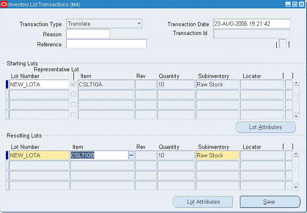

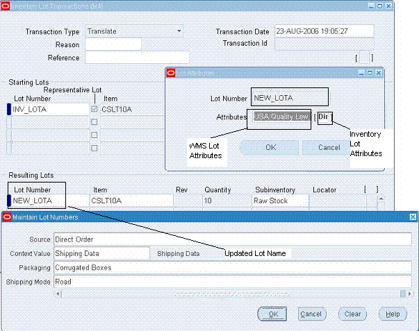

Translate
Update Lot Name
Lot attributes are transferred to the Resulting Lot and you can update them if required.
Select Translate as Transaction Type.
Click OK.
Update the Lot Name of the resulting lot in the Resulting Lots region.
Click Lot Attributes.
The Lot Attributes window appears.
Update the inventory lot attributes for the updated lot name.

To create lots on the shop floor
Select an Inventory lot number in the Starting Lot field.
Information displays for subinventory location, locator number, item number and description, revision number, quantity on hand, and quantity available to transact.
In the Job Information tab, the resulting job name will be defaulted based on the Reuse Job Name parameter. When multiple jobs are created, the first job name will be defaulted based on the Reuse Job Name parameter and the remaining jobs will be defaulted with the starting lot number, followed by the New Lot Separator value, followed by sequential numbering. You can also define the revision number and revision date for bill of material and routing in order to use the component and operations effectivity.
Information displays in the following fields and can be changed: Accounting Class, Completion Subinventory and Locator.
Note: Please note that the starting component with phantom supply type in the first operation of the subsequent sector assembly bill of material is not allowed. Therefore, the Lot Creation window does not permit you to create the lot based job with phantom supply type material in the first operation.
If you define two components in the first operation, then only one is pushed into this job based on the starting lot selected.
Using Substitutes during Lot Creation
You can also create a lot based job from a substitute item. For example, Item A is an assembly item and Item B is the component for Item A. In the event of nonavailability of Item B, you can identify an alternate item or a substitute item for Item B from Bills of Material of Item A. You can enter an inventory lot number for this alternate or substitute item and create a lot based job for Item A.
When you enter a lot number in the lot creation form, all other information of that starting lot default. In the resulting lot assembly, you can select the assembly of the substitute component for which the lot based job is being created.
Substitute component should be at the first operation and it should not be a phantom component, i.e., Supply Type of primary component of the substitute component should not be phantom in bills of material.
If the same component is present as substitute and primary component at the first operation, then it is treated as primary component.
If the same component is a substitute of two primary components in the same bills of material, then it is treated as a substitute of primary component with minimum sequence number in bills of material.
ADSUBCMP1 is a primary component in BOM of ASSY2 and CM61000.
ADSUBCMP1 is a susbstitute component in BOM of ASSY1.
You can now create a lot by issuing primary as well as substitute components.
In the Quantity tab—The Job Quantity for this job is derived based on starting lot quantity available under this lot number, and you can change the job quantity. You can also create multiple jobs for different assemblies and quantities. The application creates multiple jobs and pushes this lot into the jobs. You can also create a job with less than the defaulted quantity. If you create a job using less than the starting lot quantity in the subinventory, then the remaining quantity of the starting lot remains in the subinventory, and you can use this for subsequent job creation. You can also issue a starting component for the quantity more than or less than the component required quantity suggested by the application. In this case, you can enter the required value in the Component Quantity Issued field. In addition, the following information is available in this tab:
Component usage per assembly
Component requirement for the job quantity
Start Job Quantity
MRP Net
You can change some of theses values depending on the transactions performed for this lot.
In the Planning tab, Start Date and Completion Date values display and can be changed. Choose the Co-Products Supply check box to indicate that resulting lots are used as co-product supply.
If the inventory lot from which the new WIP lot is created, and the new WIP lot have the same attribute context, then lot attributes will be copied to the new WIP lot. If they have different context, then enter lot attributes as follows.
To view lot attributes for starting lots
Choose Attributes.
If the starting lot contains attributes, then the lot attributes window appears.
Choose WMS or INV attributes to view individual segments of the attribute.
Choose OK when you are finished viewing the attribute.

Kanban is a pull based replenishment process in a manufacturing system. You can create lot based and discrete jobs to replenish empty kanbans. In addition, Kanban supports creation of lot based jobs by selecting the starting inventory lot during Kanban replenishment process.
The following are major features of Kanban support on lot-based jobs:
During Kanban replenishment process, you can choose the starting inventory lot for the item attached to first operation. This is similar to lot-based job creation using the Lot Creation window.
Use the Honor Kanban Size parameter to create a lot based job quantity equal to kanban size when components are pushed from an inventory lot during kanban replenishment. If this check box is not selected, lot based jobs are created for the maximum number of assemblies which can be built using the selected component lot. If the check box is selected, the application will honor the kanban lot size.
After a job is created using Kanban replenishment, you can query the Lot Based Job window to view Kanban information.
If the assembly from replenishment lot based job is completed, then the supply status of a production Kanban is updated to Full.
Shop Floor Management allows jobs with a Kanban reference to be merged with another job with a different kanban reference (case 1), or a job with a kanban reference with a job without any reference (case 2). In the first case, one of the jobs is the representative lot, for that wip lot the net effect from a kanban standpoint is the same as a quantity update. But for a non-representative lot, the quantity become zero and the corresponding Kanban card status is set to Empty, and the job should not be referenced. In the second case, if the Kanban reference job is the representative lot, then the net effect from a Kanban standpoint is the same as a quantity update for that job. Otherwise, the quantity becomes zero, the corresponding Kanban card status is set to Empty, and the job should not be referenced. See: Defining Kanban Pull Sequences, Oracle Inventory User's Guide.

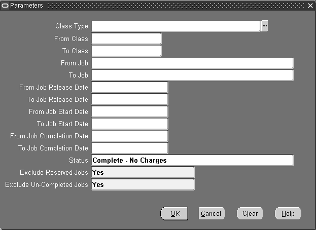

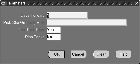

To run the Lot Based Job Component Pick Release (SRS) report
Navigate to the Lot Based Job Reports window.
Select the Lot Based Job Component Pick Release (SRS) report from the Name list of values.
Enter Days Forward.
Enter the Pick Slip Grouping Rule from the list of values.
Optionally, enter Print Pick Slips for the list of values.
Optionally, enter Plan Tasks from the list of values.
Choose OK.
Choose Submit to run the report.
If there are pending transactions associated with a lot based job, then the lot based job cannot be closed. You can report on all pending transactions for a given set of jobs and review to take appropriate action before launching the close job program. The close job program provides selection criteria with an option to eliminate jobs with pending transactions. The Pending transaction report can be used during period closing.
To run the Pending Transactions Report
Select the Pending Transactions Report from the Name list of values. The Parameters window appears.
Enter report parameters.
Choose OK.

Lot Based Job Creation/Lot Creation: Starting a job at an OSP results in automatic purchase requisition creation. For the define Lot Based Job and Lot Creation windows, the starting operation, which is always the first operation of the routing, would need to have an OSP resources for this to occur. Creating a lot based job to start at a PO Move OSP operation gives an error and not allow the transaction to be saved (applies for both released and unreleased status).

Move: Moving a job to the queue of any OSP operation results in the automatic creation of purchase requisitions. Moving to a PO Move OSP operation results in an error. You can move from an OSP operation without formally receiving the OSP item.
Jump: Jumping to the queue of an OSP operation, both inside and outside the routing, results in the creation of a purchase requisition. A jump from an OSP operation queue (with Charge Jump From Queue set to OFF) results in a warning to manually cancel purchase requisitions. Jumping to a PO Move OSP operation results in an error.
