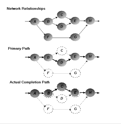

As seen in this illustration, the first example shows the Network—that is, the entire network of the routing and all operations that the WIP Lot can use.
The next example—Primary Path—shows the main path that a job is most likely to follow.
And the third example—Actual Completion Path—shows the real route a particular job moved. This path could be the primary path or any of the other valid paths defined in the network. In the illustration, the job deviates from the primary path after operation B, and moves to operation C instead of D.

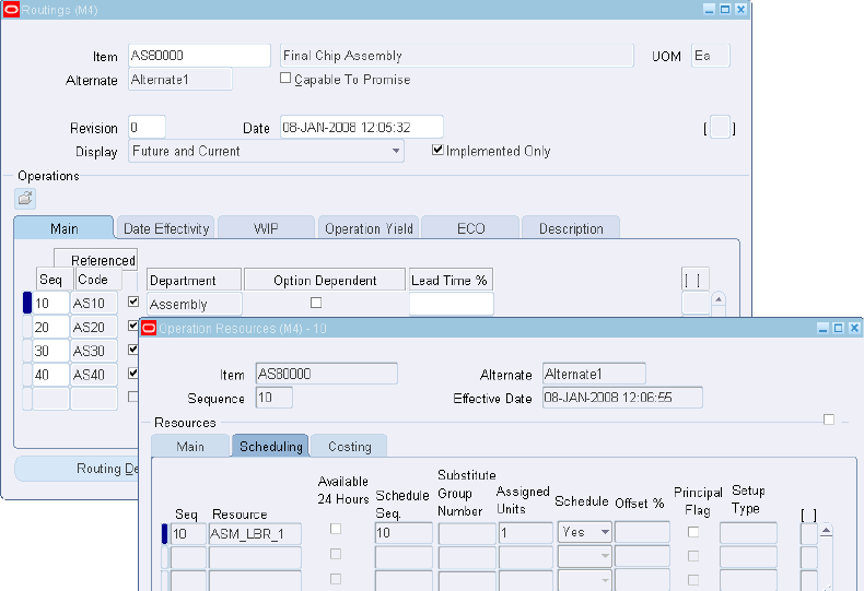

To create a network routing
Navigate to the Routings window in the Oracle Shop Floor Management menu and enter information to define this item's routing.
This includes item number, alternate routing designator, revision, operation sequence, operation code, department, effective date, effective time, disabled date and disabled time. See: Creating a Routing, Oracle Bills of Material User's Guide.
Note: When jobs are moved through network routing or WIP lot transactions are performed, Oracle Shop Floor Management considers an operation effective if the job's routing revision is greater than or equal to the operations effective date and less than or equal to its disable date if defined. In addition, a component is considered as effective if its effective date is less than or equal to the job's BOM revision date.
The operation sequence numbers entered for each operation in this window do not signify the order of the particular operation in Oracle Shop Floor Management. The actual operation sequencing is built as you choose the operations based on the network path.
Choose Routing Details to enter completion subinventory and locator information, or to view a common routing.
The completion subinventory defaults from the stocking point of the last operation. See: Completion Subinventory and Locator Fields, Oracle Bills of Material User's Guide..
You can unreference a standard operation at this time. This lets you enter more resource information for that particular operation. You can also enter any alternate resources or additional resources by unreferencing a standard operation.
Save your work.

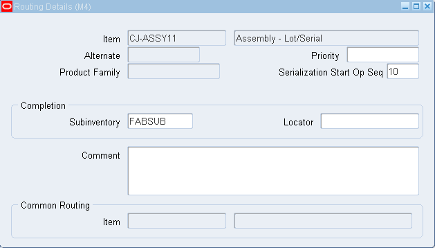

Choose Routing Details to enter the Serial Start Operation.
This operation is defaulted to the lot based job. If the routing is defined for a Lot and Serial Controlled Assembly, then Serialization Start Operation Sequence should be specified in the Routing Details window.

To specify serialization start operation sequence
Navigate to the Network Routing window.
Choose Routing Details.
Specify serial start operation in Serialization Start Op Seq field.

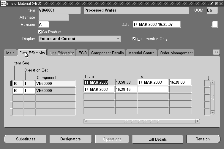

Navigate to the Bills of Material window.
Select values in the From and To Effectivity Date fields for the first component.
Select values in the From and To Effectivity Date fields for your new component.
Save your work.

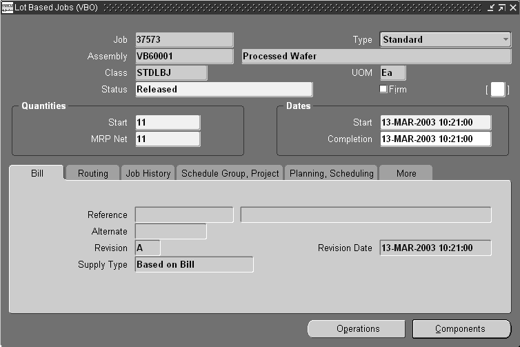

Navigate to Lot Based Jobs window.
Operation Effectivity and the Component Effectivity defined earlier can be seen when you create a lot based job using the revision date for the routing or Bill of Material.
If the system date is greater than the job start date, then the system date is used for the routing revision date and the BOM revision date
You can change this system default date to any date to implement the operation or component effectivity.
Save your work.
Note: Lot based jobs explode the material and resource requirement for the first operation only. At the time of job creation, the BOM revision and routing revision is copied into the job and the material.
Note: If you enter job completion date and not BOM revision date, then the BOM revision date will be defaulted with the completion date.

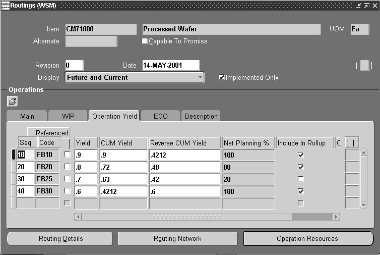

To define yield values on a routing
Navigate to the Routings window and enter the item number.
This includes item number, alternate item number, revision, display option, operation sequence, operation code, department, and date ranges, see: Creating a Routing, Oracle Bills of Material User's Guide.
Choose the Operation Yield tab.
The values you entered for operation sequence and operation code number are displayed in this tab.
In the Yield field, enter a value for component yield for first operation.
This is the percent of the amount of a component required for an assembly plus the amount lost while building an assembly. For example, a yield factor of 0.90 means that only 90% of the usage quantity of the component on a bill actually becomes part of the finished assembly.
Check the Include in Rollup check box if you want the items, resources, and overhead in this operation to be included in the cost rollup. Otherwise leave the box unchecked.
The Include in Rollup check box defines if the operation is going to be included in the standard cost rollup. All operations, both primary and alternate, are defined on this form. You do not want all operations, both primary and alternate, to be included in the standard cost. When checking the box, make sure you want that operation to be included. If all operations are checked, including operations in the alternate paths, this would lead to an exaggerated standard cost and could create large variances.
Ideally, you should check the Include in Rollup flag for all operations on the primary path.
Note: Oracle Shop Floor Management only uses the standard costing method.
Select the Operation Yield indicator if you want this operation's yield to be calculated.
Repeat steps 3 through 7 for all the operations in the routing.
Save your work.
To calculate cumulative yield and reverse cumulative yield
Select Calculate Operation Yields from the Tools menu.
This will calculate cumulative yield and reverse cumulative yield for the routing. When the calculations are computed, a note will appear letting you know the process is complete. Choose OK in the Note window. The CUM Yield, Reverse CUM Yield, and Net Planning % fields are then populated.
Save your work.

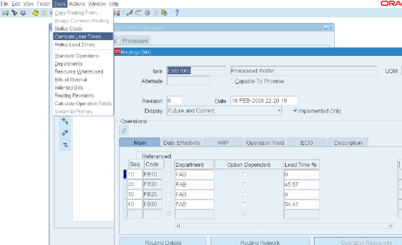

You can calculate Manufacturing Lead Times and roll up Cumulative Lead Times from the Tools menu of the Routings form.
When you choose the responsibility: Shop Floor Manager, the Network Routings form will have two options such as Compute Lead Times and Rollup Lead Times by default in the Tools menu.
Note: You need not do any customizations to use these options. They appear by default. However, to remove these options from the default settings, switch to System Administrator responsibility and query on Shop Floor Manager responsibility. In the Function field of the Menus form, add Routings: LeadTimes followed by Bills of Material: LeadTimes. Save the form. Navigate to Routings form in the Oracle Shop Floor Management menu to continue your operation without these options in the Tools menu.
You can use this option to calculate manufacturing lead times for the selected item in the Network Routings form. The calculation updates the lead time attributes of this manufacturing item, irrespective of whether you manually maintain this item's lead times or not. Changes to routing and resource usages can impact an item's lead times. After each change you make to a routing (adjusting usages, adding operations, etc.), recalculate the manufacturing lead time for the item.
To compute lead times
Click Tools menu to select Compute Lead Times
Caution: Lead time for items with network routings is calculated using resources only on the primary path, although this may not be the path with the least lead time.
You can use this option to roll up the cumulative lead times after every change made to a bill (adding components, assigning to a different operation, etc.) or the item lead times. Changes to the indented bill of material and component lead times can impact a parent item's cumulative lead times.
Click Tools menu to select Rollup Lead Times
Note: This option is also available in the Tools menu of the Bills of Material form.

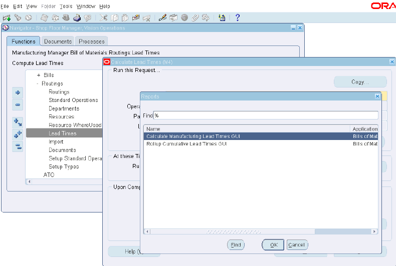

You can also calculate Manufacturing Lead Times and roll up Cumulative Lead Times for the same item (and more items) by using the concurrent request.
Navigate to Shop Floor Manager, Vision Operations: Manufacturing Manager
Double click Bills of Materials
Double click Routing
Click Lead Times
Submit a New Request page appears
Select your option of Single Request or Request Set and click OK
Calculate Lead Times page appears.
Select Calculate Manufacturing Lead Times GUI from the list of values in the Names field to calculate Manufacturing Lead Times
Select Rollup Cumulative Lead Times GUI to roll up Cumulative Lead Times
