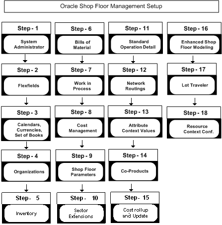

The following table lists setup steps. After you log on to Oracle Applications, complete these required steps to implement Oracle Shop Floor Management.
| Step No. | Step |
| Step 1 | Set Up System Administrator |
| Step 2 | Set Up Key Flexfields |
| Step 3 | Set Up Calendars, Currencies, and Set of Books |
| Step 4 | Set Up Organizations |
| Step 5 | Set Up Oracle Inventory |
| Step 6 | Set Up Oracle Bills of Material |
| Step 7 | Set Up Oracle Work in Process |
| Step 8 | Set Up Oracle Cost Management |
| Step 9 | Define Oracle Shop Floor Management Parameters |
| Step 10 | Define Sector Extensions |
| Step 11 | Define Standard Operation Details |
| Step 12 | Create Network Routings |
| Step 13 | Define Attribute Context Values |
| Step 14 | Define Co-Products |
| Step 15 | Perform Cost Rollup and Cost Update for Assemblies |
| Step 16 | Enhanced Shop Floor Modeling |
| Step 17 | Lot Traveler |
| Step 18 | Resource Context Configuration |

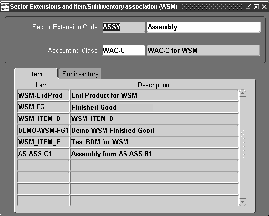

Sector extension codes are associated with assemblies and subinventories. These codes are appended to the job name when the assembly is completed to the subinventory.
Note: Subinventories are valid stocking points when they are associated with sector extension codes.
See: Defining and Viewing Lot Sector Extensions.

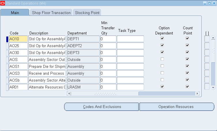

This step defines the steps within an operation that are mandatory, and the location used for stocking points. See: Defining Standard Operation Details.
You can configure Move In, Move Out, and Move To Next Operation based on Standard Operation level or Organization level (see Step 9).

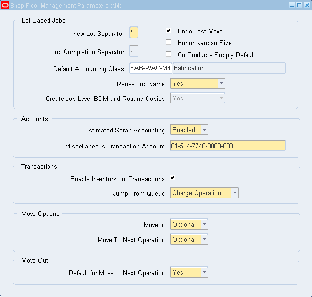

The Oracle Shop Floor Management parameters define operation movement and default values for the transactions you are creating.
Shop Floor Parameters
To define Shop Floor Management parameters
Navigate to the Shop Floor Management Parameters window.
In the Lot Based Jobs region, set the value you want to use when lots are created and completed.
In the New Lot Separator field, the default value is a dash character (-) and can be changed to any value. When lots are created, split, or renamed—the resulting lot designation is the original lot number, followed by this value, followed by sequential numbering. See: WIP Lot Transactions, Inventory Lot Transactions
In the Job Completion Separator field, the default value is a dash character (-) and can be changed to any value. When lots are completed the resulting lot designation is the original lot number, followed by this value, followed by the lot sector extension. See: Create Lot Move Transactions.
Note: Do not use the same character value in both the job completion separator, and in a segment of the job name. This creates an error in the resulting lot name.
After you save your work, you can change these values if the jobs have not been completed.
The Undo Last Move indicator lets you undo the last move transaction. This indicator must be selected for the functionality to be defaulted on the Move Transaction window. See: Create Lot Move Transactions
Honor Kanban Size parameter is used to determine whether to create a lot based job quantity equal to kanban size when components are pushed from an inventory lot during kanban replenishment. If this indicator is not selected, then lot based jobs are created for the maximum number of assemblies which can be built using the selected component lot. If the indicator is selected, then the application will honor the kanban lot size.
In the Co Products Supply Default field, the default value is empty, but can be selected. If the indicator is selected, then planning will take into consideration supply for the co-products.
In the Default Accounting Class field, enter the accounting class to be used as the default accounting class in the Lot Based Jobs window. If no other rules, like getting the accounting class based on the item or subinventory association, return an accounting class then this default accounting class will be used.
The Reuse Job Name parameter gives you the option to use an existing job name while creating new lots. You can choose either Yes or No from the list box. You can update this parameter whenever you want. It works independently and does not have any impact on other parameters.
While defining OSFM parameters for a new organization or setting this parameter for the first time for an organization that already has OSFM parameters, it will be defaulted to Yes and you can opt for your choice and save it. See: Overview of Lot Transactions
When the parameter value is Yes, then the sector extension is appended to the job name, when the job is completed or cancelled. When the parameter value is No, it is not appended.
The Create Job Level BOM and Routing Copies field reflects the setting of the site level profile WSM: Create Job Level BOM and Routing Copies, which is applicable to all OSFM enabled organizations. See WSM: Create Job Level BOM and Routing Copies.
In the Accounts region, enter defaults for estimated scrap and miscellaneous transactions.
The Estimated Scrap Accounting field is used to disable scrap and operation yield calculations. The default value is Enabled, and the values are as follows:
Enabled: The application calculates Operation Yield Accounting and Estimated Scrap Absorption when creating transactions for lot based jobs. The Scrap Account field is required when defining a department in the Departments window.
Disabled: Operation Yield Accounting and Estimated Scrap Absorption are not calculated. The Scrap Account is not a required field in the Departments window; you can enter an account number at the time of the scrap transaction.
Note: For an organization, which has Estimated Scrap Accounting enabled, the application defaults the scrap absorption accounts defined in the department for Scrap and Bonus accounts and uses them for Scrap and Bonus transactions in MoveOut page.
For an organization, which has Estimated Scrap Accounting disabled, you should personalize the MoveOut page to enable the accounts region and enter Scrap/Bonus accounts during scrap and bonus transactions.
Caution: This action is only for HTML UI and there is no change for Forms UI.
In the Miscellaneous Transactions Account field enter the account to be used when issuing or receiving material.
In the Transaction region, set the value you want to use when the transactions are complete.
If you do not have Oracle Warehouse Management installed, select the Enable Inventory Lot Transactions indicator. This indicates that the Oracle Shop Floor Management Inventory Lot Transactions API is used for importing transactions into Oracle Applications.
If Oracle Warehouse Management (WMS) is installed, then Warehouse Management System users are encouraged to use WMS for Inventory Lot Transactions. You can run these transactions through the Warehouse Management System mobile (RF) user interface. You can view Inventory Lot Transactions performed in Warehouse Management in the Lot Genealogy window.
The Jump from Queue field is used to specify if material, resources and overhead charges of an operation are to be charged when you jump from queue of the operation. The default value is Charge Operation.
Ignore Operation: Ignores the operation, therefore material resources and overhead charges at the From operation are not charged.
Charge Operation: Materials, resources and overhead is charged at the From Operation.
In the Move Options region, set to Optional or Always for Move In and Move To Next Op fields.
The Move In transaction is used to move a lot from Queue intraoperation to Run intraoperation, where the lot will be picked up and worked on.
Move To Next Op transaction enables you to transfer a lot from the To Move intra-operation to the Queue of the next operation.
If your Organization requires tracking Move In and Move To Next Op, then you can choose them from your system.
Always: Move In or Move To Next Op is a required step for every operator.
Optional: If Move In is Optional, you can choose to perform the Move In or directly perform the Move Out transaction. If Move To Next Op is Optional, during Move Out transaction, you can either stay at the current operation or move directly to the next operation.
Never: Move In or Move To Next Op is never performed and is covered by Move Out transaction.
In the Move Out region, set the default value to either Yes or No.
The Move Out field reports completed work and results, while transferring a lot from the Run intraoperation to To Move intraoperation or next operation Queue intraoperation.
If Move To Next Op is Yes, then moving to next operation as part of Move Out transaction defaults to Yes, otherwise by default it stays in the current operation (No).
Save your work.

To define and view the Lot sector extension codes
Navigate to the Sector Extensions and Item/Subinventory Association window.
The Find Sector Extension window displays. You can query lot sector extensions by subinventory name, item name, or both.
If you are searching for an existing lot sector extension, enter search criteria and choose Find. Choose New to create a new record.
The Sector Extension and Item/Subinventory window displays.
Enter a unique value in the Sector Extension Code field, and a description.
Select an accounting class from the Accounting Class Code list of values window.
In the Item tab, select the item numbers to assign to this lot sector.
In the Subinventory tab, select the subinventory location associated with this sector extension. See: Assigning Items to a Subinventory., Oracle Inventory User's Guide
Save your work.
Note: Subinventories are valid stocking points when they are associated with sector extension codes. An item or subinventory is associated with only one sector extension.
Operation code information for standard operations is defined on the Standard Operation Details window. This window sets the intraoperation steps that are mandatory and subinventory location used as the stocking point.
Note: The fields in the Operation Details form have been moved to BOM Standard Operation form and it has been obsoleted.
Navigate to the Standard Operation window.
Select an operation code in the Standard Operation field.
Select Main tab to enter Description, Department, Minimum Transfer Quantity and Task Type. Check the fields that are mandatory for your operation.
Select Shop Floor Transaction tab. Check the steps that you want as mandatory within an operation. See: Intraoperation Steps, Oracle Work in Process User's Guide.
Note: For Shop Floor UI, checked implies mandatory and unchecked implies optional, while for WIP Parameters intraoperation setup, checked implies allowed (optional) and unchecked implies disallowed (never). Also, note that it is a standard operation-level setup in Shop Floor, whereas WIP Parameters setup is at organization level.
Select Stocking Point tab Subinventory field, select the default location that completed material from this operation that is to be placed.
If this subinvenory is locator controlled, the Stock Locator field is enabled.
Choose Codes and Exclusions to enter Bonus Codes, Scrap Codes and Responsibility Exclusions for this operation.
Note: The Code that appears here is the Meaning of the Code that you have defined in the Lookup windows of Resource/Scrap/Bonus Downcodes.
Minimum Transfer Quantity is not relevant for lot based jobs.
Choose Operation Resources to add resources and details on scheduling and costing for the resource.
Save your work.
