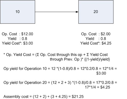

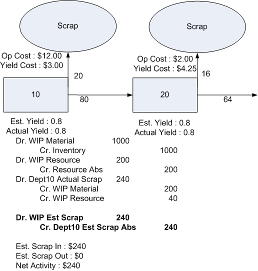

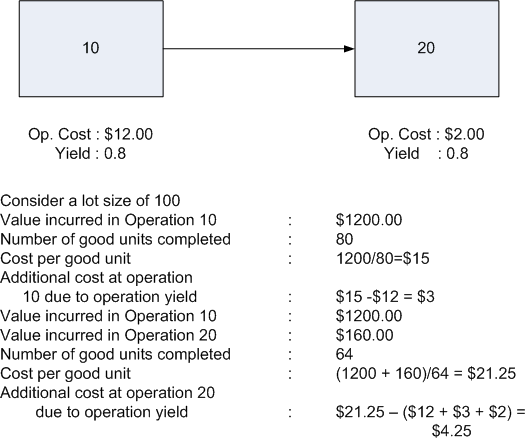

Consider an operation 10, department A, with operation yield of 70%. If 100 units were sent into operation 10 in order to produce 10 completed units, then at 100% yield, the unit cost of the assembly is assumed to be $10. However, at the estimated yield of 70%, the unit cost is (100 * 10)/70
Hence the additional cost per unit assembly due to operation yield is
(100*10)/70- 10 = 10 * (1/0.7 - 1) = 10 * [(1-0.7)/0.7]
Estimated Scrap per unit = (Total operation cost per unit through the current operation + Total Estimated Scrap Cost per unit through the previous operation) * [(1 - op.yield)/op.yield]
Dollars absorbed by the department due to good units completed in an operation = Estimated Scrap per unit * Number of good units that passed through the operation.
The accounting entries for estimated scrap absorption transaction are:
| Account | Debit | Credit |
| WIP Valuation Estimated Scrap Account | XX | |
| Department Estimated Scrap Absorption Account | XX |

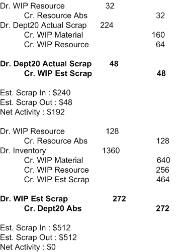

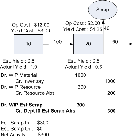

Consider a second operation 20 following operation 10 from the previous example:
Suppose that, out of the 70 good units that were sent into operation 20, 5 units were scrapped at operation 20. Since these have absorbed the additional cost due to estimated scrap in each of the previous operations (operation 10 in the present example), it is essential to reverse the estimated scrap absorption that has been done for the scrapped units.
Net Reversal = (Total estimated scrap per unit through the previous operation) * Number of units actually scrapped
| Department Actual Scrap Account | XX | |
| WIP valuation Estimated Scrap Account | XX |

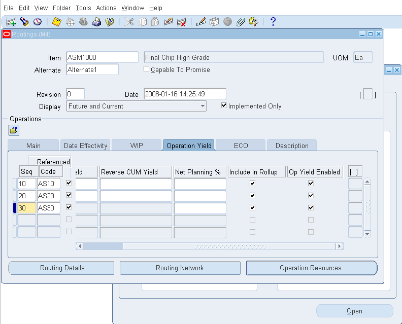

To enable Operation Yield for the operation:
Navigate to the Routings window in the Oracle Shop Floor Management menu
Enter item in the Item field
Select Operation Yield tab in the Operations region
Select Op Yield Enabled check box for the corresponding operation sequence

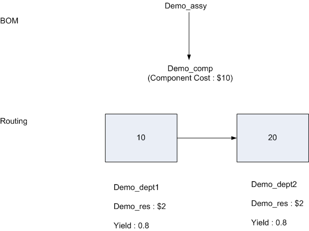

Setup: Example
Estimated Scrap Accounting: Example

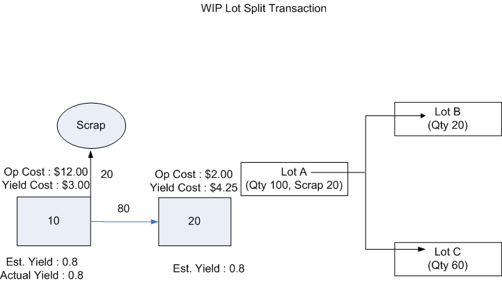

Lot Split Transactions
Lot Merge Transaction
Bonus Transactions
Update Quantity Transactions
Lot Based charges include lot based resources, lot based departmental overheads, and resource based overheads based on lot based resources.

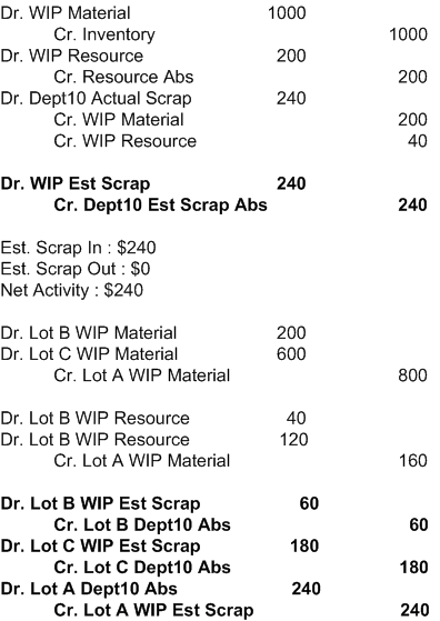

When you divide a single parent lot into multiple child lots, the actual costs of materials and resources issued to the parent lot (including lot based resources and overheads) are reallocated to the child lots, based on the quantity ratios. The actual costs (the net value remaining in the parent lot) are reallocated to the child lots on a sub-elemental basis. If the net value for any sub-element is negative, it is not reallocated to the child lots and is remain in the parent.
At the time of a split, WIP Lot Spit transactions are created, that will adjust the WIP value of the parent lot and resulting lots with the appropriate balance.
Consider a lot A of size 10 with material charges of $100, items based resource charges of $50, and lot based resource charges of $50. One item is scrapped, resulting in a relief of $20.
The net balance in lot A is ($200 - $20) = $180.
If this lot were split into lot B of size 4 and lot C of size 5, the net balance is proportionally reallocated to the child lots. The parent receive a credit of $180, and the children receive a debit based on the quantity ratio:
Lot B receive a debit of (4/9) * $180 = $80
Lot C receive a debit of (5/9) * $180 = $100
The accounting entries are:
| WIP Valuation Accounts for resulting lots | XX | |
| WIP Valuation Accounts for starting lot | XX |
The estimated scrap absorption in the parent is reversed for the charge that has been reallocated to the child lots. Each child lot receive a debit for the additional cost due to operation yield based on the charge that has been reallocated to it.
For the starting lot:
| Department Estimated Scrap Absorption Account | XX | |
| WIP Valuation Estimated Scrap Accounts | XX |
For resulting lot:
| WIP Valuation Estimated Estimated Scrap Account | XX | |
| Department Estimated Scrap Absorption Accounts | XX |
Note: Cost incurred by the scrapped quantity remain in lot A.

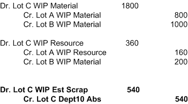

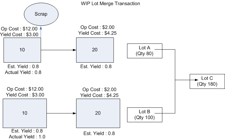

When combining several lots into a single existing lot, the cost of materials and resources is reallocated to the resulting lot. The cost is proportionately reallocated to the resulting lot, based on the costs incurred by the representative lot. The net value in the representative lot is reallocated to the resulting lot on a sub-element basis. If the net value for any sub-element is negative, it is not reallocated to the resulting lot and will remain in the parent.
The lot based charges are not proportioned and the resulting lot incur the same lot based charges as the representative lot. Lot based charges incurred by the non-representative lots are not charged to the resulting lot.
Consider a lot A of size 10 with a material charge of $100, item based resource charges of $50. In addition, A has a charge of $100, which is incurred because component E was pushed to the lot.
Consider a lot B of size 10 with a material charge of $100, item based source charges of $50, and lot based resource charges of $50. In addition, B has a charge of $200, which it incurred because a different component F was pushed to the lot.
Merge lot A and B into a lot C of size 20. Choose A as the representative lot.
Since A is the representative lot, all charges in C are based on charges incurred by lot A. Hence lot C will receive a debit of: [(20/10) * (item based charged)] + (lot based charges) = [(20/10) * ($250)] + ($50) = $550.
Lot A receive a credit of: (10/20) * $500 +$50 = $300
Lot B receive a credit of: (10/20) * $500 = $250
The additional charges of $200 that was incurred by lot B, but not by lot A, remain in lot B. The lot based charges incurred by B is not charged to the resulting lot and remain in lot B. Lot B therefore have a net balance of $150.
| WIP Valuation Accounts for resulting lot | XX | |
| WIP Valuation Accounts for starting lots | XX |
The estimated scrap absorption in the starting lots are reversed for the charge that has been reallocated to the resulting lot. The resulting lot absorb the additional cost due to operation yield based on the charge that has been reallocated to it.

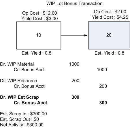

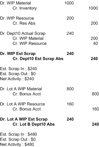

You can create bonus lots to perform operations on assemblies that were previously scrapped. The quantity starts in the intraoperation step of queue of the starting operation. Therefore, components at the starting operation are not automatically charged when the bonus lot is created. The standard cost of the assembly through the previous operation is credited to the bonus account. The account is often the scrap account. Operation yield is calculated for all previous operations, based on standards.
Consider an assembly A with a component B ($10) and a resource R1 ($2) at operation 10. It also has a component C ($20) and a resource R2 ($1) at operation 20.
Create a bonus lot, lot-A of size 10 at operation 20. The lot incurs all charges in operation 10. Since the lot is at the intraoperation step of queue at operation 20, charges in operation 20 are not included in the bonus lot.
Hence lot-A incurs a charge of: 10 * $10 + 10 * $2 = $120.
| WIP Valuation Accounts for bonus lots | XX | |
| Bonus Account (user specified) | XX |
The bonus lot also receives a debit for the additional cost due to operation yield based on the charge that it has incurred.
Based on this, a job bonused in at sequence 10 (the first sequence) is like a new job that has just been opened. As this is the first operation in the routing there will not be any costs incurred from a previous operation. If it is opened at a later operation such as 20 it will incur the standard cost from 10 or up through the previous operation and not any cost for the current operation.

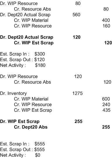

An example of how a bonus transaction should be done at an operation other than the first operation is shown in the following section:
Create a job with 1000 at operation 10, where 1000 components are issued to the job
Scrap 200 at operation 10 and complete 800 good at operation 10
Move 800 through operation 20 and complete
Bonus in a job of 200 at queue of 20. (It will be valued at standard cost as having completed operation 10 including starting material. The standard cost of the assembly through the previous operation is credited to the bonus account. The account is often the scrap account.)
Move 200 out of operation 20 and complete

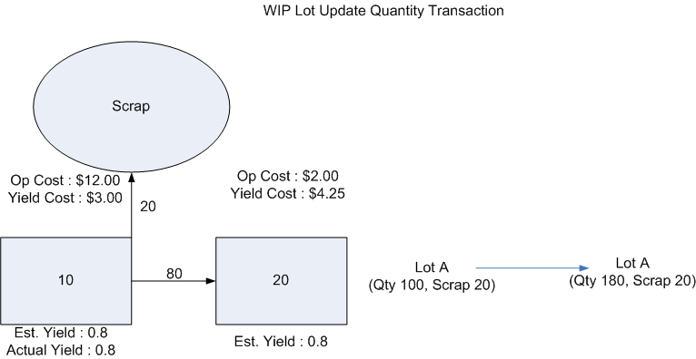

You can increase the quantity remaining in a job using the update quantity transaction. Cost incurred by the job (except lot based cost) will be proportionately debited to the job, based on the new quantity and the net value remaining in the job. The net value remaining in the parent job is reallocated on a sub-elemental basis. If the net value for any sub-element is negative, it is not reallocated to the resulting lot.
The lot based charges are not proportioned in the update lot.
The credit is to the account specified while creating the update quantity transaction and is often the scrap account.
Consider a lot A of size 10 with a material charge of $100, lot based resource charge of $50, and resource based overhead charges of $20 from overheads associated to the lot based resources.
Update the quantity in lot A to 20.
The cost incurred in the new lot is: [$100 * (20/10) + $50 + $20 = $270
The non-lot based charges of $100 are proportioned. The remaining lot based charges are not proportionate and remain in the job. Hence lot A receive a credit of $100.
The accounting for the new charges to the job are:
| WIP Valuation Account | XX | |
The updated lot also receive a debit for the additional cost due to operation yield based on the additional charge that it has occurred.
