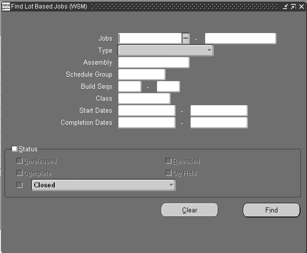

Navigate to the Close Lot Based Jobs window.
The Find Lot Based Jobs window displays.
Enter your criteria and choose Find.

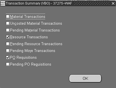

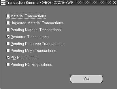

Select Transaction Summary from the Tools menu to view all pending transactions.
Only jobs without pending transactions can be closed.

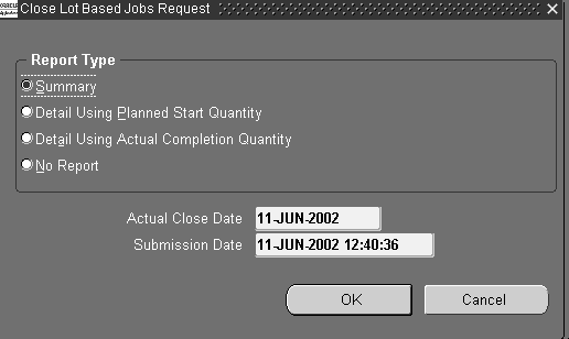

Select Close from the Tools menu to display the Close Lot Based Jobs Request window. This window is used to select close options.
Select a report type.
Reports are printed, per the Report Type specified, after the close process computes job close variances. The Discrete Job Value Report – Standard Costing is printed when standard lot based jobs and non-standard asset jobs are closed. The Expense Job Value Report is printed when expense non-standard jobs are closed. Report Type options and formats are as follows:
Summary: Lists each job and includes job header, period–to–date summary, and cumulative–to–date summary information.
Detail Using Planned Start Quantity: Lists each job using the planned start quantity of the job to calculate the material usage variance.
Detail Using Actual Completion Quantity: Lists each job using the actual completion quantity of the job to calculate the material usage variance.
No Report: Does not print a report.
Select an Actual Close Date, the system date is the default.
Select a Submission Date and time, the system date and time is the default.
Choose OK to submit this request.
Only those jobs with appropriate statuses are closed. The statuses of jobs that are being closed are changed to Pending Close until the close process completes.

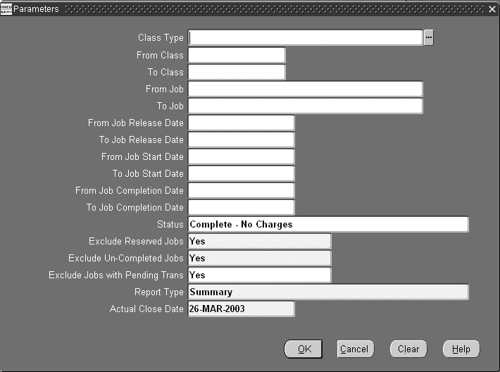

To close a lot based job using Submit Requests:
Navigate to the Close Lot Based Jobs (SRS) window. The Parameters window appears.
Select an accounting class in the Class Type field, or range of accounting classes in the From and To Class fields.
The options are Standard discrete, Asset non- standard, or Expense non- standard. If you do not select a class type, the system closes job for all class types.
If you select a class type, you can only select accounting classes of that class type. If you do not select a To Class, all jobs from the From Class forward are closed. If you do not select a From Class, all jobs through the To Class are closed.
Select a range of lot based jobs to close in the From and To Job fields.
If this field is left blank, all jobs that fit the close requirements are closed.
You can select a range of job release dates, job start dates, job completion dates in the From and To fields.
Select a job Status.
You can only close jobs with one with the following statuses: Cancelled, Complete, Complete – No Charges, Failed Bill Load, Failed Close, Failed Routing Load, On Hold, Release, or Unreleased.
Exclude Reserved Jobs parameter gives you the option to exclude or include jobs linked to sales orders from the processing.
Exclude Un- Completed jobs parameter, gives you the option to exclude or include jobs having a status other than Complete from the processing.
Enter Yes in the Exclude Jobs with Pending Transactions field. If you enter Yes, then the application excludes jobs having pending transactions.
Select a Report Type.
Summary: Lists each job and includes job header, period- to- date summary, and cumulative- to- date summary information.
Detail using planned start quantity: Lists each job using the planned start quantity of the job to calculate the material usage variance.
Detail using actual completion quantity: Lists each job using the actual completion quantity of the job to calculate the material usage variance.
Choose OK to submit the request.

Navigate to the Unclose Lot Based Jobs window.

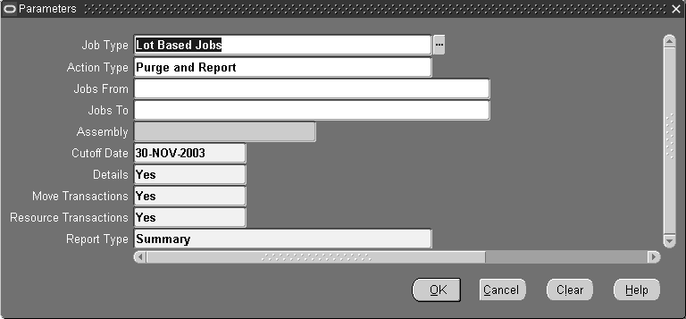

To purge lot based job transactions
Navigate to the Purge Lot Based Jobs Parameters window.
Job type defaults to Lot Based Jobs.
Enter the Action Type.
Enter the Jobs From and Jobs To fields to define a range of lot based jobs to purge.
Enter the Assembly.
Enter the Cutoff date for the closed inventory accounting period.
Enter purge selection criteria. If you choose to purge headers, then Details, Move Transactions, and Resource Transactions fields default to Yes.
Enter the Report Type.
Choose OK. The Purge Lot Based Jobs window displays request details.
Choose Submit to run this request.
