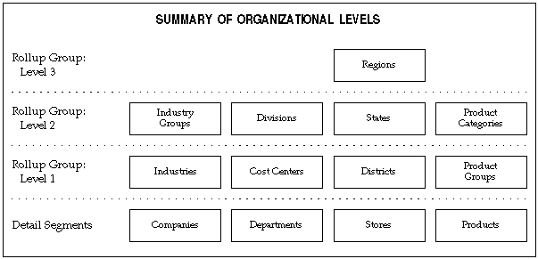

Define rollup groups to create summary accounts whose summary balances you can review. You assign parent segment values to rollup groups.
See: Defining Rollup Groups, Oracle Applications Flexfields Guide

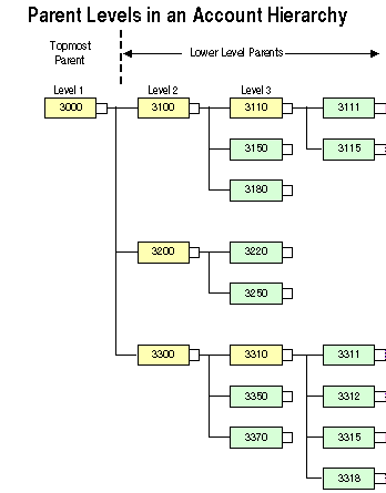

Define your account segment values. If you plan on defining summary accounts or reporting hierarchies, you must define parent values as well as child or detail values.
You can set up hierarchy structures for your segment values. Define parent values that include child values. You can view a segment value's hierarchy structure as well as move the child ranges from one parent value to another.
See: Defining Segment Values, Oracle Applications Flexfields Guide

We recommend that you allow parent values for segments in your Accounting Flexfield. Parent values are used to create summary accounts and define security rules. Using parent and child values increases the productivity of General Ledger.

Define your Accounting Flexfield segment values. When specifying a parent value, be sure to mark the Parent check box and enter the rollup group level information and hierarchy details. Be sure you do not assign overlapping ranges of child values to the same parent value. For multi-level hierarchies, be sure that grandparents do not share the same child ranges as their lower level parent values. This causes looping and will affect your summary accounts.
You use rollup groups to create summary accounts. Decide your segment hierarchy before you create parent and child segment values.

A rollup group is a collection of parent values. Only parent values can be assigned to a rollup group. Parent values and child values belong to the same value set, which is then attached to a key flexfield segment.
A rollup group allows you to group related parent values for creating summary templates. Given a summary template, General Ledger creates summary balances using all parent values assigned to that rollup group.

The diagram below illustrates the concept of parent levels in an account hierarchy. This concept is used throughout the remainder of this chapter.
A parent level contains a parent segment value that has one or more child segment values associated with it. Parent levels are displayed in Account Hierarchy Manager in a top-down fashion. The level 1 parent is always the topmost parent, as shown in the diagram. The remaining parent levels, starting with level 2, are referred to as lower level parents.
As illustrated in the diagram, a parent value can be a child of a higher level parent. For example, in the diagram, parent value 3110 has two child segment values, 3111 and 3115. The parent is itself a child of the higher level parent value 3100, which also includes the child values 3150 and 3180. Parent value 3100 is, in turn, a child of the topmost parent value, 3000, which also includes the lower level parent values 3200 and 3300, as well as all of their child values.
When you select a parent level in the Account Hierarchy Manager, you are selecting the parent segment value plus all of its child values, which include lower level parents and their associated child values. For example, if you select the parent value 3300 from the hierarchy shown in the diagram above, you are selecting the values 3300, 3310, 3311, 3312, 3315, 3318, 3350, and 3370.

Hierarchy window: Graphically displays all parents and children belonging to a segment selected in the Values List window.
Attributes window:Displays all attributes for parent and child values listed in the Hierarch window.
The Account Hierarchy Manager displays the following icons to represent hierarchy relationships in many of the windows.
The Chart of Accounts- Segments window lists all the Chart of Accounts you can access subject to Chart of Accounts Security
Expand any Chart of Accounts folder to view the individual segments, such as Company, Department, Account, etc.
Highlight a specific segment and choose Find in the Query Values window.
The window changes to the Values List window and displays all the Parent and Child values for that segment.
Highlight any parent value and choose the View Hierarchy button.
The Hierarchy window appears. Parent and Child values are displayed in a graphical hierarchy.

To build a hierarchy, select a parent value from the Values List window and choose the View Hierarchy button from the toolbar. The parent value and all its children are displayed in the Hierarchy window.
To continue building a hierarchy, select additional values from the Values List window, then drag and drop them in the Hierarchy window. Any new values must be added to existing parent values in the hierarchy window. For example, you can select a child value, drag it to the Hierarchy window, then drop it onto any parent value. You can also select a parent value, drag it to the Hierarchy window, and drop it on any parent value.
However, there are instances when you cannot drop a selected value onto an existing value in the hierarchy diagram. For example, you cannot drop a child value onto another child value. The Account Hierarchy Manager will prevent you from completing the drag and drop in these instances.
To remove a value from a hierarchy, select it and choose Remove from the right-click mouse menu.

Rollup Groups: Opens the Rollup Groups window, where you can create a new rollup group or edit an existing rollup group.

Choose the new parent value from the Values List and select Hierarchy from the View menu.
Add values to your hierarchy, as needed, working down from the topmost node.
Save your work.
Select the Chart of Accounts and Segment for the existing hierarchy.
Select the segment value that represents the parent value of your hierarchy, and choose Hierarchy from the View menu. The Account Hierarchy Manager displays the parent value and all of its child values.
From the Values List window, select the value you want to add to your hierarchy.
Drag the selected value to the intended parent value in the Hierarchy window, then drop it.

Start the Account Hierarchy Manager by navigating to Setup > Accounts > Manager.
In the Chart of Accounts - Segment window, select the Chart of Accounts and Segment for the existing hierarchy. Choose Find in the Query Values window.
Choose New Parent Value from the Edit menu. The Parent Attributes window appears.
Enter a new Segment Value. The segment value must comply with the security rules you defined for the value set associated with the segment. The Account Hierarchy Manager validates the value when you close the Parent Attributes window.
Optionally, enter a Description, assign a Rollup Group, and specify a range of Effective Dates.

After considering how you want to summarize within each of your organizational dimensions, think about how you want to combine your summary views across different organizational dimensions. For example, if you summarize departments into divisions and districts into regions, you may wish to reference and report on divisions by region.
You can also combine a particular summary level for one organizational dimension with a different summary level for another organizational dimension. For example, you may wish to reference and report on departments by region.
To decide upon the combinations of summary views across your organizational dimensions, you can lay your summarization level sketches side by side so that you can consider your summarization levels conceptually. The following chart shows how you might roll up your account segments into several levels:
For a text description of this illustration, see Text Description of Summary of Organizational Levels, Oracle General Ledger Online Help

You enter summary account templates to create summary accounts. General Ledger uses the templates in combination with parent segment value definitions to create summary accounts.
From the Summary Accounts window, enter the summary account Template using one of the following values for each segment:
D: Your template creates and maintains a summary account for every detail segment value. This value creates the most summary accounts of any template value.
Note: General Ledger will not allow you to define a summary account template using only D template values.
T: Your template creates and maintains a summary account that sums balances of all detail segment values. This value creates the fewest summary accounts of any template value.
If you enter T for a segment, all summary accounts created by the template will have the value T for the segment. Therefore, the value T must be defined and enabled for the segment. Also, the segment value must be a parent and detail posting and budgeting are not allowed.
Note: Do not define a summary account template using only T template values. A template using T values for every segment will have a zero balance if your general ledger is in balance.
[Rollup Group Name]: Your template creates and maintains a summary account for each parent segment value assigned to the rollup group you specify. The more parent segment values in a given rollup group, the more summary accounts your template creates.
