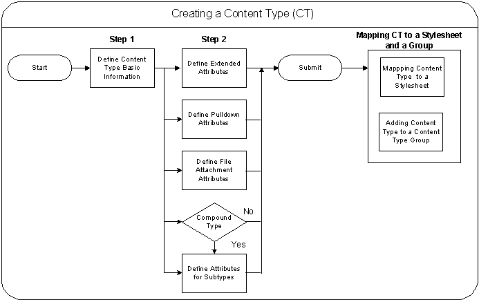

Creating a content type is a two step process:
In the first step, provide the basic details of the content type such as the name, owner, and the default stylesheet.
In the second step, define its attributes.
After creating a content type, you can map it to a stylesheet and also add it to a content type group. For details, see sections Mapping Stylesheets to a Content Type and Creating and Managing Content Type Groups.
Use the following procedure to create a content type.
Steps
Log into Oracle Content Manager as the Content Super User and navigate to Content Types tab.
Click Create Content Type.
Enter the required details such as name, description, and owner fields.
Select active from the Status menu.
Only if the content type is active, it is available for creating content items.
Enter an XML tag for the content type in the Content Type XML tag field.
The XML tag should not contain any spaces and must be unique. OCM stores this data in XML and uses it to present the content item.
Select a default stylesheet from the Search LOV.
Stylesheets enables you to preview the content item based on the stylesheet definition.
Optionally, to encrypt a URL, select the Encryption box.
Click Continue..
In the Create Content Type: <content type name>: Attributes page, the content type name and attributes are displayed with their order of display. You cannot modify the order.
To define extended and pull-down attributes, click Add Another Row in the respective regions.
The Field Length field defines the maximum number of characters that can be entered as a value for this attribute while creating content items.
The Default Value Updateble field indicates if the default value can be updated by the user while creating content items. To restrict users from updating the default value for this attribute, select No.
The Display Value field indicates the display priority. By default, the fields are displayed in a serial order.
In the Compound Content Type region:
Select a content type, which becomes the subitem of the compound content item.
Select a default content item from the Search LOV, which is displayed as a default subitem.
The Default Item Updateable field indicates if the default item can be updated by the user, while creating a content item.
Click Submit.

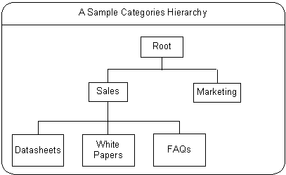

A category is a specifically defined classification, which is used to logically group a set of content items together. While folders are work areas to organize content items, categories reflect more of a business group. Many organizations define content that can be classified into one or more categories. Categories also have a hierarchy of subcategories for finer classification. You can browse the library based on the categories.
Root Category
The Root category is the highest level in the category hierarchy. The Root category is seeded, and any seeded category cannot be deleted or renamed. You can create a category under the Root category depending on the permissions you have. The following figure represents a sample categories hierarchy.
In the figure, Sales and Marketing are two categories under the Root category. Similarly, many such categories can exist under the Root category and subcategories under categories. Data sheets, White Papers, and FAQs are examples of subcategories under Sales.
To maintain a category hierarchy, it is necessary to have robust data security to provide fine grain access control to different users at different category levels. Category access control involves assigning Users or Groups the permissions to access a category. Access control is a combination of permissions and exclusions.

A category is a specifically defined classification, which is used to logically group a set of content items together. The Content Super User or an administrator must update the Root category for users to have Manage Category permission. Without this permission, no user will be able to create a subcategory under the Root category.
As an administrator, you can also assign content items to one or more categories. Only live versions of the content items can be assigned to the categories. Also, you can view, reject, or remove the content items from a category.
Managing Categories
You can perform the following tasks:
Move a category. You can move a category and alter the category hierarchy. The category being moved retains its original permissions.
Delete a category with subcategories. To perform this you must have Manage Category permission on the parent category and subcategories. If a category is deleted, then all content item mappings to the category are deleted.
Disable a category. By disabling a category, all its subcategories are disabled. A disabled category cannot be viewed in the library.
Enable a category only if the parent category is enabled.
