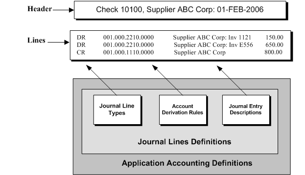

The different elements of a subledger journal and their relationships to the AMB are displayed in the diagram below and explained in the subsequent text.
Elements of a Subledger Journal Entry
The AMB includes journal entry setup components to configure each of these elements:
Journal Line Types: Control journal entry line options such as balance type, side, and summarization

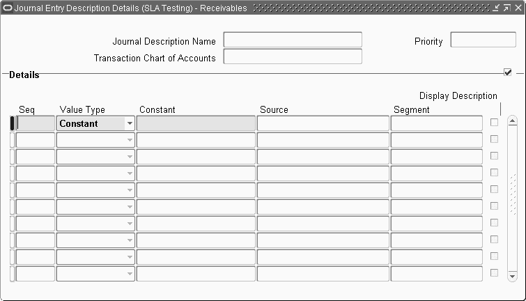

Journal Entry Descriptions: Control the description for the journal entry headers and lines
Account Derivation Rules: Control the derivation of Accounting Flexfield combinations for the journal entry lines
The journal entry setup components are associated with journal lines definitions that are attached to application accounting definitions. You can group detailed subledger accounting definitions for different kinds of transactions into consistent sets, each of which addresses different needs. While one application accounting definition can generate subledger journal entries to meet a particular set of requirements, another definition can be defined to satisfy completely different requirements.

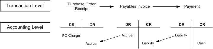

As an example of these groupings and assignments, consider a set of definitions set up to create accrual accounting for payables in the U.S. These definitions can be grouped into the U.S. Payables Accrual application accounting definition. Accrual accounting application accounting definitions for each application in the U.S., such as U.S. Payables Accrual and U.S. Receivables Accrual, can be grouped into the U.S. Accrual Subledger Accounting Method.
The relationship between the various AMB components are displayed in the diagram below and is described in the succeeding text.

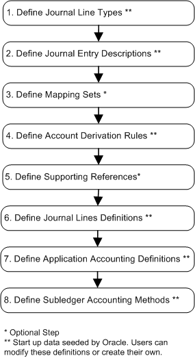

The Components for Building Accounting Definitions figure below shows the components in the Accounting Methods Builder process for building accounting definitions and is described in the succeeding text.
The components in the figure above are used by the Subledger Accounting program to create subledger journal entries. Before creating or modifying any components or definitions, check whether the seeded application accounting definitions meet your requirements. In the event that more detail is required than that provided by the default definitions, modify them or create new ones.
Since the flexibility for creating accounting definitions is dependent on source availability, Oracle subledgers provide standard sources. Create custom sources for use in accounting definitions.

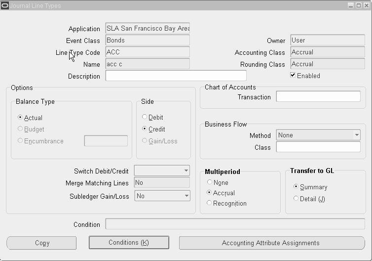

Set up journal line types for a particular event class and determine the characteristics of the subledger journal entry lines. Also, set up conditions for the use of the journal line type.
This is startup data seeded by Oracle. Modify these definitions or create new ones.
See: Journal Line Types
Define the journal entry description for the subledger journal entry. Descriptions are assigned to the journal header and lines.
See: Defining Journal Entry Descriptions

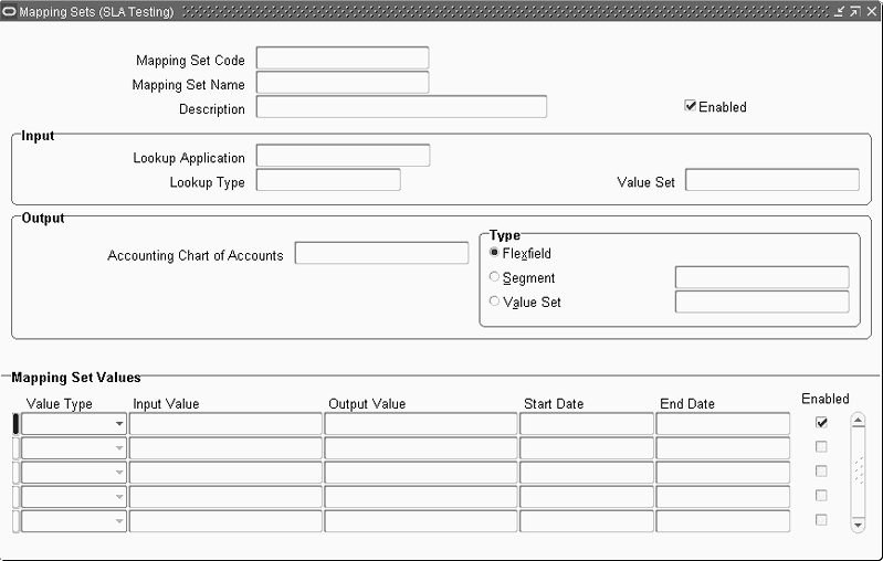

Use mapping sets in the account derivation rules setup. By mapping input values to different outputs, mapping sets provide flexibility in the creation of account derivation rules. The use of mapping sets is optional.
See: Mapping Sets

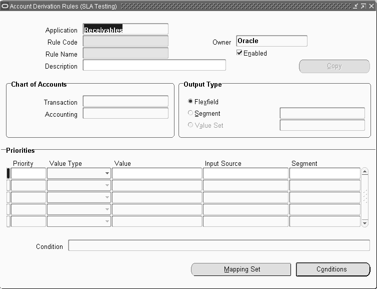

Account derivation rules determine the Accounting Flexfields for subledger journal entries. You can also define conditions that determine when a particular rule is used.
Supporting references may be used as follows:
to provide additional business information about a subledger journal entry at the header or line level
to establish a subledger balance for a particular source value or combination of source values for a particular account
to assist with reconciliation of account balances
for financial and managerial analysis
The use of supporting references is optional.
See: Defining Supporting References

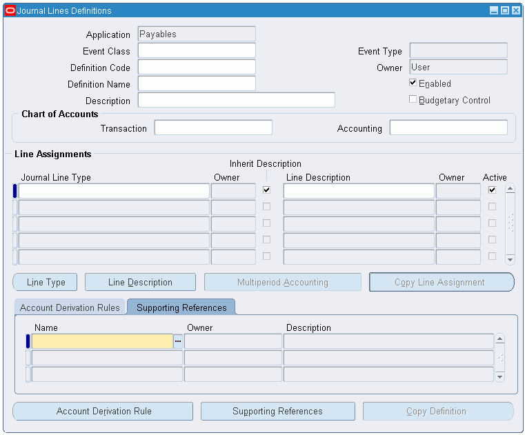

Use journal lines definitions to group and assign journal line types, account derivation rules, and journal entry descriptions into a complete set of journal entries within an event class or event type. Share these sets across application accounting definitions for the same application.
The use of journal lines definitions is required.
See: Journal Lines Definitions

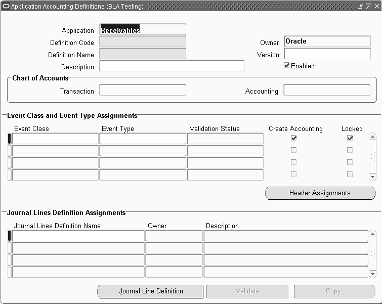

Use application accounting definitions to group journal lines definitions and header assignments for event classes and event types. You can also optionally add one or more supporting references.
Also, indicate whether to create accounting for a particular event class or event type. For example, when using cash basis accounting, you would not create a journal entry to record the accrual of an invoice.
See: Application Accounting Definitions

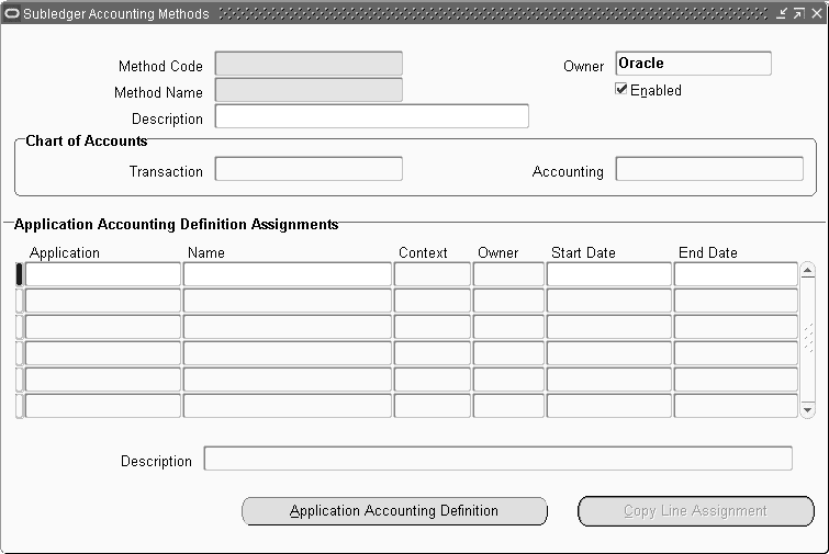

Group application accounting definitions that comply with a common set of accounting requirements into a subledger accounting method. Each subledger accounting method can be assigned to one or more ledgers.
See: Subledger Accounting Methods

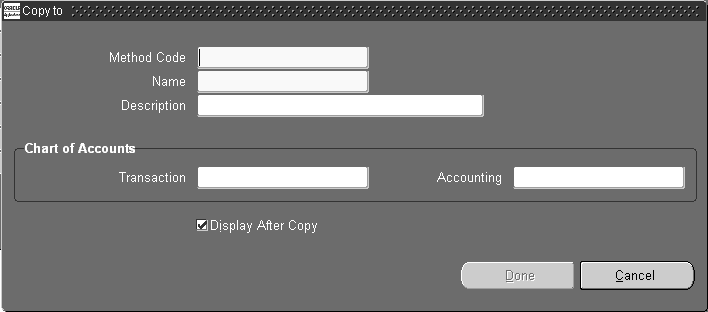

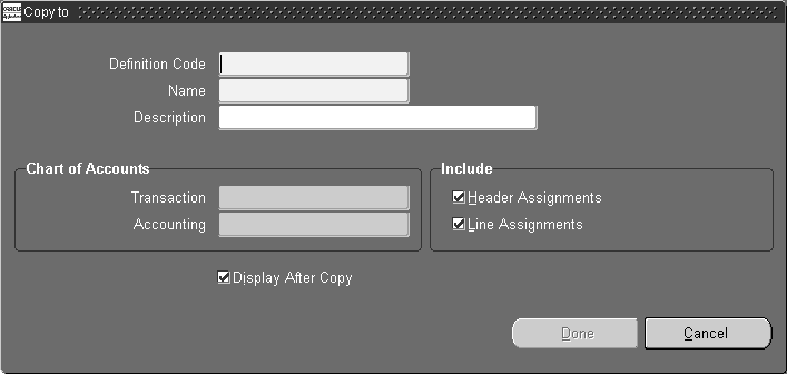

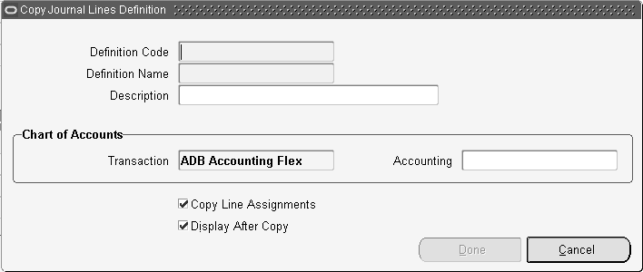

If you have specific accounting requirements that are not covered by the seeded definitions, use the copy feature included in the AMB to create copies of the seeded definitions and customize them. Also, create new definitions and copy and modify them appropriately.
The copy functionality reduces the need to repeat data entry functions when there are substantial similarities between two definitions. Definitions created by users are not overwritten by upgrades to Subledger Accounting. However, upgrades can still affect definitions if those definitions use seeded components. Use the merge analysis feature to assess whether any upgrades to the AMB impact any user-defined application accounting definitions.
The copy and modify functionality is provided for the following components of the AMB:
Subledger accounting methods
Application accounting definitions
Journal lines definitions
Journal line types
Journal entry descriptions
Assign custom components only to custom definitions. For example, assign a custom account derivation rule (one that has been copied from an existing account derivation rule and modified) only to a custom journal lines definition. Assign a journal lines definition only to custom application accounting definitions and custom subledger accounting methods.
Use seeded components in custom application accounting definitions.

Account derivation rules derive accounts for a specific accounting chart of accounts. The creation of all journal entries by Subledger Accounting is therefore done in the context of the accounting chart of accounts.

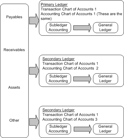

Assign each subledger accounting method to many ledgers. The combination of a subledger accounting method and ledger is called an accounting representation. The primary ledger reflects the primary accounting representation. In the primary ledger, the transaction and accounting charts of accounts are always the same.
Create multiple accounting representations by using secondary ledgers. Due to regulatory or other requirements, the accounting for these ledgers can be different than the accounting for the primary ledger. Each of these ledgers can have a different subledger accounting method assigned to it and is a secondary accounting representation. Create several secondary representations, each with a different currency, chart of accounts, calendar, and set of accounting definitions. An example of multiple accounting representations is described in the figure below.
Multiple Accounting Representations

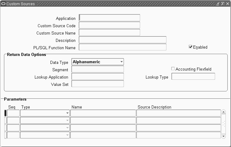

Extend the list of sources available to application accounting definitions. Using standard and system source values as parameters, write PL/SQL functions that create custom sources.
It is used to extend the list of sources available to application accounting definitions. First, decide your primary goal in defining a custom source. Also be sure to explore other alternatives, as custom source may impact the performance of the create accounting program. If you need to define one custom source, then define a PL/SQL function. In the function, you determine the input and output parameters. The output parameters becomes the return data options that you need to provide the Custom Source page. The name of the PL/SQL function must be provided in the Custom Source page. Provide the input parameters that you need in the PL/SQL function in the Parameters section of the Custom Source page. A custom source's PL/SQL function may use the seeded sources that are available to the application accounting definition or any constant value. You have to define the PL/SQL function in the database.
In the Custom Sources window, define custom sources using seeded sources and constant values when sources required for the definition of accounting rules are not provided as seeded sources.
The table below describes selected fields in the Custom Sources window.
| Field | Description |
| Enabled | Retains the default to make the source available for use |
| Segment | Marks a source as a segment for an Accounting Flexfield |
| Accounting Flexfield | Marks a source as an Accounting Flexfield. If selected, the Lookup Application, Lookup Type, and Value Set fields are disabled. |
| Lookup Application | Application to associate with a lookup type. If selected, the Value Set field is disabled. |
| Value Set | The list of values includes all enabled independent and table-validated value sets and enforces the following rules:
| Seq | Sequence in which parameters are described in the plsql function name |
| Type | Source type |
| Name | Parameter name |

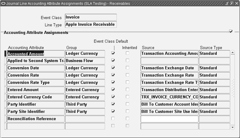

The accounting program uses accounting attributes values to create subledger journal entries. The types of accounting attributes values are as follows:
Values that are subject to special processing or values that are stored in named columns in journal entry headers and lines
Examples of accounting attributes of this type are Entered Currency Code and Entered Amount.
Values that control the behavior of the subledger program when processing a specific accounting event or transaction object line
Examples of accounting attributes of this type are Accounting Reversal Indicator and Multiperiod Option.
Each accounting attribute is associated with a level:
Header to create subledger journal entry headers
Line to create subledger journal entry lines
The accounting program derives the values of accounting attributes by looking at the sources that are assigned to them. Almost all accounting attributes have sources assigned at the event class level. Depending on the accounting attribute, the accounting attribute assignment defaulted from the event class can be overridden on journal line types or application accounting definitions.

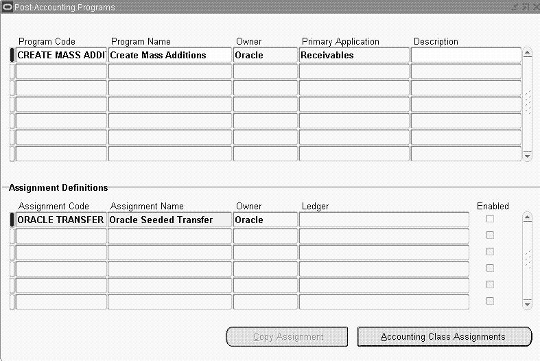

A Post-Accounting program is a container for accounting classes. Subledger applications use the Post-Accounting program assignment to determine which journal entry lines to retrieve for a particular process. For example: for mass-additions, Oracle Payables needs to define a Post-Accounting program to identify the journal entry lines that need to be pushed to Assets.
In the Post-Accounting Programs window, define Post-Accounting Programs and create assignments that may be associated with a ledger.
In the Accounting Class Assignments window, assign accounting classes to an assignment definition.
Seeded programs and assignment definitions cannot be deleted or updated. You can copy a seeded assignment definition and modify the copy.
The table below describes selected fields and buttons in the Post-Accounting Programs window.
| Field or Button | Description |
| Owner | Automatically populated. If seeded by Oracle developers, the owner is Oracle. Otherwise, the owner is User. |
| Primary Application | Defaults from the responsibility |
| Ledger | Ledger to seed ledger-specific assignments; disabled for assignment definitions seeded by Oracle development Enable only one assignment definition for a specific ledger. Assignments created for a specific ledger override the ledger-independent assignments. |
| Enabled | If selected, makes the program assignment available for use |
| Accounting Class | Opens the Accounting Class Assignments window |

A business flow is a series of logically related business transactions and their accounting where the creation of one transaction causes the creation of another transaction which itself can result in another transaction.
For example, when goods are received, an invoice is entered and the invoice is paid. The business flow at the transaction level is:
The receiving transaction is entered to acknowledge the arrival of the goods.
The invoice is entered to acknowledge that the supplier is owed for the goods and therefore references the receipt transaction.
The payment is created to satisfy the amount owed on the invoice and therefore references the invoice.
The business flow at the accounting level is:
The receipt generates an entry to the purchase order charge account.
This entry is offset by an accrual entry representing a future invoice liability.
The invoice reverses this accrual entry and creates the invoice liability, and the accounting for the payment reverses the invoice liability and generates the entry reducing the company's cash account.
The diagram below illustrates this example.
Basic Business Flow Example

The Journal Lines Accounting Attribute Assignments window displays all accounting attributes assigned to an event class. If the Inherit check box is enabled, the values for the selected attributes are inherited and are not available for update or entry.
Set up the following in the Journal Lines Definitions window:
Assign a journal line type to a journal lines definition
For Same Entry and Prior Entry, indicate that the journal lines definition inherits the journal entry description for the journal line type
For the Same Entry and None business flows method, assign account derivation rules
For the Same Entry and None business flows method, optionally inherit accounting segment values
See: To Define Journal Lines Definitions

Users can assign accounting attributes.
If an accounting attribute is relevant to the accounting event's underlying transaction, then its value is required to generate subledger journal entries for the transaction. By assigning standard sources to accounting attributes in the Accounting Attributes window, you can use standard source values as the values for accounting attributes.
See: Accounting Attributes Guidelineand To Define Journal Line Types

The table below describes selected fields and buttons in the Journal Line Types window.
| Field, Region, and Button | Description |
| Application | Automatically populated with the application name associated with the user's responsibility. |
| Line Type Code |
Note: Users cannot modify a seeded journal line type or any other seeded component as it could get overwritten in an upgrade. Instead users can copy the seeded type and then modify it appropriately. The copied journal line type has an Owner type of User. The list of values displays the component name and the owner to distinguish between seeded and user-defined components. |
| Name | Appears in the list of values when assigning the journal line type to a journal lines definition. |
| Accounting Class | Shared across applications and enables users to classify journal entry lines. For example, when a receipt is matched to a purchase order and the accrual method is On Receipt, an accrual journal line is created upon receipt creation. When the Payables invoice is matched to a purchasing document, Payables creates a journal line reversing the original accrual. In this case, Purchasing and Payables define journal line types to generate these accruals and both of them can assign the accounting class Accrual. Accounting classes are defined using an extensible AOL lookup type. The list of values for this field contains all accounting classes that are seeded but users can add new accounting classes. |
| Rounding Class | Defaults to the accounting class. The rounding class, along with the transaction rounding reference accounting attribute, groups lines together in order to determine whether rounding is necessary. |
| Enabled | If selected, makes this journal line type available for use. |
| Encumbrance | If this balance type is selected and the business flow method is not Prior Entry, an encumbrance type must be selected from the drop-down list. See: Defining Encumbrance Types, Oracle General Ledger User Guide This field is disabled if Prior Entry is selected as the business flow method or if Accrual or Recognition is selected as the Multiperiod option. |
| Side | A Gain/Loss journal line type creates a debit line for a loss and a credit line for a gain. The gain/loss side journal line type is used exclusively for the gain or loss amount automatically calculated by Subledger Accounting and can only be defined for the actual balance type.
Note: For journal line types with a side of Gain/Loss, the following accounting attributes are not displayed in the Accounting Attributes Assignments window when accessed from this window:
Note: If the business flow method Prior Entry or Same Entry is selected, the Gain/Loss option cannot be selected. The Gain/Loss option can only be selected if the business flow method is set to None and the Multiperiod option is also set to None. |
| Switch Debit/Credit | Determines whether negative amounts will result in negative amounts on the same side or positive amounts on the opposite side.
Note: If the Side is Gain/Loss, the Switch Debit/Credit field is disabled. |
| Merge Matching Lines | Summarizes subledger journal lines within each subledger entry. Journal entry lines with matching criteria are merged. The possible values are:
Note: Normally, users merge matching lines. However there are some exceptions. For example, in Italy, gain or loss amounts must be recorded for each invoice payment rather than at the total payment level. By setting the merge selection to No, users guarantee that journal entry lines are not merged, even though they are for the same transaction and entry. |
| Subledger Gain or Loss | Yes indicates that gain/loss is calculated in the primary ledger. The gain/loss amount is therefore not converted to the reporting currency and non-valuation method secondary ledgers. Select No for Subledger Accounting to calculate the gain or loss.
Note: When Gain or Loss is set to Yes, multiperiod accounting is disabled. |
| Transaction | Transaction chart of accounts. See: Transaction and Accounting Charts of Accounts and Application Accounting Definitions |
| Method | Business flow method If Prior Entry or Same Entry is selected, the Gain/Loss option in the Side region cannot be selected. If Prior Entry is selected, then the following accounting attributes are inherited from an upstream journal entry and cannot be selected or updated in the Accounting Attributes Assignments window:
| Class | Business flow class; required if the business flow method is Prior Entry |
| Multiperiod |
Note: When Gain or Loss is set to Yes, multiperiod accounting is disabled and defaults to None. See: Multiperiod Accounting |
| Transfer to GL | Select Detail to maintain the same level of detail as the subledger journal entry line. Select Summary to summarize subledger journal entry lines by Accounting Flexfield. One journal line is created in General Ledger to record the subledger activity. See: Subledger Accounting Setup Options Description |
| Conditions | Opens the Journal Line Type Conditions window. See Defining Conditions for and To Define Journal Line Type Conditions |
| Accounting Attribute Assignments |
Note: This button is enabled when the conditions are entered. Opens the Journal Line Accounting Attribute Assignments window.When creating a journal line type, accounting attribute assignments are automatically established based on the default accounting attribute assignments for that journal line type's event class or entity. In the Journal Line Accounting Attribute Assignments window, override this default mapping of standard sources to accounting attributes. The list of values for the Source field contains all header level sources that are assigned by developers to the accounting attribute and event class associated with the journal line type. Users can assign a source to the Reconciliation Reference accounting attribute which is used to meet accounting requirements in continental Europe. |
| Inherited | If selected, indicates the values of a selected accounting attribute can be inherited. |
| Source | List of values includes all header level sources assigned to the accounting attribute and event class associated with the journal line type.
Note: You can assign a source to the Reconciliation Reference accounting attribute, which is used to meet accounting requirements in continental Europe. |

In the Journal Line Types window, click Conditions.
In the Seq field, enter a Sequence number.
The details of the condition are created from left to right according to this number. This number does not necessarily correspond to the evaluation of the condition, as parenthesis and logical operators precedence can affect the order.
In the ( field, use the "(" and ")" symbols for grouping a section of a condition.
This is useful when a condition spans multiple lines with the And/Or operators.
In the Source field, select a source value.
Source values are seeded by the subledger application or custom application but access to the custom sources defined is also provided. This value is the first operand in the condition line.
In the Segment field, if the source is a key flexfield or an Accounting Flexfield, optionally select the segment.
The table below describes the relationship between the Source and the Value Type fields based on the transaction chart of accounts.
| Transaction Chart of Accounts | Nature of Source | Segments in List of Values |
| Null | Accounting Flexfield | All Accounting Flexfield qualifiers |
| Not Null | Accounting Flexfield | All segments for the transaction chart of accounts |
| N/A | Key Flexfield | All segments for the key flexfield and flexfield structure given by the source |
In the Operator field, select an operator to evaluate the condition.
In the Value Type field, select the value type of the second operand that is evaluated in the condition line.
The value types are:
Source: This includes any source defined for the application. The source can be seeded by Oracle or it can be a custom source.
Constant: Choose this value type for a comparison with constant values.
The table below describes the relationship between the source and the value type fields based on the transaction chart of accounts.
| Transaction Chart of Accounts | Nature of Source | Value Type |
| Null | Accounting Flexfield | Can only be Source |
| Not Null | Accounting Flexfield | Can be Source or Constant |
| N/A | Key Flexfield or any other source | Can be Source or Constant |
When defining a condition, you can compare one data source with another data source by using the comparison operator, for example, '=' or '<>'. In some cases, the value of one side of the data source could be null or blank when the extract data contains no value for the specific source that is being compared. In such cases, Subledger Accounting will return 'TRUE' or 'FALSE' depending on which comparison operators are used and which data source is being compared as shown in the table below.
| Condition | Expected Value |
| null source = constant or a non-null source | false |
| null source <> constant or a non-null source | true |
| null source = null source | true |
| null source <> null source | false |
If the Segment field to the left of the Independent Value field has a dependent segment and the value type is Constant, in the Independent Value field, enter the value of the segment that the dependent segment is based upon.
This is the value for the independent segment in the key flexfield that the dependent segment value is based upon. For example, the following condition, described in the table below, requires users to choose an independent value before choosing a value for the dependent segment.
| Source | Segment | Operator | Value Type | Independent Value | Value |
| Asset Category Flexfield | Minor Category | = | Constant | BUILDING | ADMINISTRATION |
In the Value field, enter a value as follows:
If a value type of Constant is selected, then enter a value for the constant and this value is used as the second operand to evaluate the condition.
If a value type of source is selected, then select an Accounting Flexfield code combination identifier or any other source value from the list of values for this field.
The table below describes the relationship between the source, segment, value type, and Value field.
| Source | Segment | Value Type | Value Field List of Values |
| Key Flexfield | Not populated | Constant | Complete key flexfield combination |
| Key Flexfield | Populated | Constant | Values for the segment selected |
| Any other source | N/A | Constant | Values based on value set or lookup type if specified for the source |
| Key Flexfield | Not Populated | Source | All key flexfield sources |
| Key Flexfield | Populated | Source | Includes all segment and key flexfield sources |
| Segment | N/A | Source | All segment sources |
| Any other source | N/A | Source | All sources of matching data type |
If a value type of Source and a value that represents an Accounting Flexfield code combination identifier are entered, optionally select a segment name in the Segment field.
This segment value is used as the second operand in the condition line.
In the ) field, use AND/OR values to concatenate two lines together when making complex conditions.
Typically, the AND takes precedence over the OR. Parenthesis are only required to overwrite this precedence. As an example, consider a condition that should use a particular account derivation rule if the following are true:
The Assets' tracking option is Yes AND.
The cost is less than $200 or the supplier is ABC.
Not only must the Assets' tracking option be Yes, but either or both of the remaining two conditions must also be true.
This condition utilizes the bracket operators as follows:
(Asset Tracking option = Yes) AND ((Amount < 200) OR (Supplier = ABC))
See Copy and Modify Functionality.
Note: If entering a transaction chart of accounts, the journal line type that is created supports this chart of accounts.
This field can only be entered if the line type being copied does not have a chart of accounts already assigned to it. If it does, the new line type that is created inherits the assigned chart of accounts and users cannot change the value.
If copying a nontransaction chart of accounts specific journal line types to a transaction chart of accounts specific journal line type, Subledger Accounting replaces any reference to Accounting Flexfield qualifiers in the conditions with the actual segment names for the qualifiers in the transaction chart of accounts. If no corresponding segment exists, an error message appears.
Use the Journal Entry Descriptions window to define the elements of a description that appear on the subledger journal header and line. The definition determines both the content and sequence in which the elements of the description appear.
Build descriptions using any of the available sources for the application. For example, an individual segment of an Accounting Flexfield can be included in the description. Use literal strings or a combination of both sources and literals. Some of the sources can only be used for descriptions applied at the line level. For example, a source associated with invoice line number can only be applied to a line description.
Assign journal entry descriptions headers and lines in the Applications Accounting Definition window.
The table below describes selected fields in the Journal Entry Descriptions window.
| Application | Defaults from the application associated with the responsibility |
| Owner | Automatically populated. Value is Oracle for seeded components. Value is User for components created on site by users. |
| Transaction Chart of Accounts | Chart of accounts used to input and create transactions See: Transaction and Accounting Charts of Accounts |
| Enabled | Retain the default to make the description available for assignment to application accounting definitions |
| Priority | Users can create more than one priority number for a journal entry description, each one with its own conditions and details. Description details are evaluated in ascending priority order, where the highest priority has the lowest number until a condition is met. For performance reasons, use the most commonly met descriptions first. Change the order in which description details are evaluated by updating the priority number instead of deleting and rewriting the descriptions. Once the conditions associated with a detail line are satisfied, the value from that line is used and other lines are ignored. See: Journal Entry Description Conditions If none of the conditions are met, enter a last line with no conditions associated to it. Because Subledger Accounting uses this line as a default, assign the lowest priority to this line. The Journal Entry Description field displays a concatenation of the elements of the description created in the Journal Entry Description Details window as described in To Define Journal Entry Description Details. |
Use the Journal Entry Description Details window to create the journal entry description that users see. Define the description content and the sequence in which it appears.
A journal entry description that uses sources that have values which vary by line cannot be assigned as a header level description.
| Seq. | Number for ordering the elements of a description Use this field to quickly change the order of appearance of the journal entry description contents. |
| Constant | If Constant is selected in the Value Type field, enter text to be used in the journal entry description. For example, enter Check Number or Invoice Number. By defining several lines, users can use multiple sets of constant strings in the description definition. These can be concatenated with a source, as described in the Source field, and appear according to the sequence number of the line. |
| Source | Note that the source selected serves as a placeholder. When the journal entry is created, this source value is replaced with appropriate source content. For example, the source Supplier Name populates the journal entry description with the actual name of the supplier. The same logic applies if the source is an Accounting Flexfield segment. |
| Segment | Define which segment value appears in the accounting description. If a transaction chart of accounts is specified, the list of values for this field displays the name of all the segments. If there is no transaction chart of accounts specified, the list of values displays the flexfield qualifiers available in General Ledger. |
| Display Description | Displays the segment description for an accounting flexfield segment source. |
Create journal entry description conditions in the same manner as described in Defining Conditions for Journal Line Types.
See: Copy and Modify Functionality and Copying Journal Line Types.
Use mapping sets to associate a specific output value for an Accounting Flexfield or Accounting Flexfield segment. Based on the input value, a specific value can be assigned to a single segment or to the entire Accounting Flexfield. Use mapping sets in account derivation rules to build the Accounting Flexfield.
To define a Mapping Set, pairs of values are specified. For each input value, specify a corresponding account segment or Accounting Flexfield output value. One or more related pairs of these input values and segment or Accounting Flexfield output values form a mapping set. Use value sets or lookup types for validating the input values of the mapping set.
For example, it is possible to create a mapping set based on two input values, Yes and No. Apply these input values to determine the balancing segment value of an account: 01 if the input value is Yes and 02 if it is No. Use this mapping set in one of the rules that builds the segment values of an account. The rule compares the value of a source to see if it is Yes or No and determines the segment value accordingly.
As another example, suppose a business has three major regions: East, South, and West. Assume also that the business has a Region Code segment in the Accounting Flexfield. Region names can be input values in applications such as transaction type names and service codes. These input values can be included with other information about the transaction and become part of the source information available to the AMB. Users can create a mapping set that maps region names to the corresponding region code as described in the table below.
| Input Value | Segment Value |
| East | 01 |
| South | 02 |
| West | 03 |
It is possible to restrict a mapping set to a range of dates by entering the start and end dates. The GL date of the potential subledger entry is compared to the effective date range of the mapping set. This determines whether mapping set values should be applied.
Using value sets and lookup types prevents data entry errors when entering input values. If planning to use either value sets or lookup types to validate the input values, they must be defined before setting up mapping sets. If neither a value set nor a lookup type is selected, users can enter any value in the Input Value field.
See: Overview of Values and Value Sets, Oracle Applications Flexfields User Guide
| Enabled | If selected, makes the mapping set available for use |
| Type region | Based on this selection, the mapping set is defined for the setup of the entire Accounting Flexfield, an individual segment in the flexfield, or a value set. The Flexfield and Segment options are disabled if the accounting chart of accounts is not specified. The Value Set option is disabled if the accounting chart of accounts is specified. |
| Segment | If selected, enter the segment to be used to assign a value the mapping set. |
| Value Set | If selected, select the value set. |
| Value Type | If the Value Type is Input, then enter an input value. If Input is selected and a value set or lookup type is defined, then the list of values includes all the allowable values defined for the lookup type or value set. Use the value type Default in cases where the source value from the transaction is not equal to any of the input values in the mapping set. If a mapping set is used and the Subledger Accounting program encounters accounting definitions with undefined input values, journal entries cannot be successfully generated unless there is a default. Using the example introduced earlier in this section, if there is a source value equal to Northwest, it would not map to any of the input values. Specify a default value of 04 for any regions not included as input values. This prevents entries from failing validation when the Subledger Accounting program is submitted. |
| Input Value | If the value type Input is selected, enter an input value to be mapped to a corresponding output value. |
| Output Value | For a given input value, enter the corresponding output value. The account derivation rule uses this value to populate either the accounting flexfield or accounting flexfield segment. If the Value Set option in the Type region is selected, the output value is an individual value from the value set entered in the Value Set field of the Type region, and the list of values includes all values from this value set. In the case where a mapping set is defined to populate an individual segment value, the output value is an individual segment value and the list of values includes all values for the segment entered in the Segment field. If the Accounting Flexfield option in the Type region of the Mapping Sets window is selected, then the output value is the entire Accounting Flexfield and the list of values includes all enabled combinations for the accounting chart of accounts. |
| Start Date and End Date | Effective range dates for the mapping set |
| Enabled | If selected, makes the mapping set values available for use. |

Use account derivation rules to determine the Accounting Flexfields for subledger journal entries. In addition, specify the conditions under which these rules apply. Using these capabilities, develop complex rules for defining accounts under different circumstances to meet their specific requirements.
Define a rule by Accounting Flexfield, segment, or value set. If the rule is by Accounting Flexfield, the rule determines the entire Accounting Flexfield combination. For example, an account derivation rule defined by Accounting Flexfield can be used to determine the complete supplier liability Accounting Flexfield in Payables.
Define segment rules to derive the Accounting Flexfield segment by segment. For example, a particular segment like the company segment can be determined from the Distribution Accounting Flexfield. Another segment can be determined with the use of a constant value. Creating the Accounting Flexfield one segment at a time offers greater flexibility but also requires more setup.
You can use both segment-based and flexfield-based rules to derive a single account. Subledger Accounting uses segment-specific rules where they are defined and takes the remaining values from a flexfield-based rule. For example, a user can select an account derivation rule which is for All Segments and also separately select a rule which is for one particular segment. Subledger Accounting derives accounts based upon segment-specific rules and then fills in the remaining segments with the rule that specifies All Segments. Segment-specific rules take precedence over the All Segments flexfield-based rule.
If the Create Accounting program returns an account that is end-dated or disabled and a substitute account is defined in General Ledger, Subledger Accounting uses the substitute account. The original account is stored on the journal line for audit purposes. If the substitute account is invalid and a suspense account is defined, Subledger Accounting uses the suspense account. An error message is displayed if a valid suspense account is not available.
See: Adding or Changing Individual Accounts, Oracle General Ledger User Guide
Define account derivation rules based on value sets in the absence of an accounting chart of accounts.
See: Overview of Values and Values Sets, Oracle Applications Flexfield Guide
Share account derivation rules across applications in the following ways:
Assign an account derivation rule from the same or a different application to a journal line type in the Journal Lines Definitions window
For example, to derive an expense account for journal line type Expense, assign the Projects Cost Account derivation rule owned by Projects to the Payables journal line type Expense.
Create an account derivation rule based on another account derivation rule from another application and assign it to a journal line type
For example, create a new account derivation rule Invoice Expense Account referencing Project Cost Account assigned in the Priorities region. Attach Invoice Expense Account rule to the journal line type Expense in the Journal Lines Definitions window.
Note: To share an account derivation rule across applications, all sources used by the account derivation rule must be available for the event class.
When an account derivation rule is assigned to a journal line type in the Journal Lines Definition window, Subledger Accounting verifies whether all sources used by the account derivation rule are available for the journal line type event class.
Set up Accounting Flexfield rules based upon four possible Value Types as follows:
Source value type
For Accounting Flexfield rules, all the code combination identifiers from the transaction chart of accounts that have been setup as sources are available to create the account. Derive the account combination by specifying a source such as the Distribution Account in the rule. The Subledger Accounting program then obtains the account by referencing the distribution Accounting Flexfield.
The transaction or accounting chart of accounts does not need to be known when this type of rule is defined. If no chart of accounts is specified, the value derived from the source uses the default chart of accounts for the subledger application.
Constant value type
Establish the account as a constant value. For example, the constant could be the account combination 01.000.2210.0000.000 from the accounting chart of accounts specified. This is the simplest way to derive an account.
Mapping Set value type
Derive the account combination by referencing a mapping set. Set up a mapping set rule to determine the complete account combination from the accounting chart of accounts specified.
Note: An accounting chart of accounts must be specified for rules using either constants or mapping sets.
Account Derivation Rule value type
Derive the account by referencing another account derivation rule. You cannot select account derivation rules that already have an assigned account derivation rule.
The transaction or accounting chart of accounts does not need to be specified when defining this type of rule. If the account derivation rule has an accounting chart of accounts, then all account derivation rules that are assigned must have the same or no chart of accounts.
When the value type is Account Derivation Rule, select only account derivation rules with matching output types.
Set up segment rules as follows:
When an accounting chart of accounts is specified, create a rule to derive a specific segment from the accounting chart of accounts.
If the accounting chart of accounts is not specified, create a rule to derive the value for an Accounting Flexfield qualifier.
Use a mapping set to determine the value of the segment. For example, using a mapping set that maps supplier types to departments, the supplier type can determine the department segment value.

Using a mapping set to derive an Accounting Flexfield
Consider a mapping set Vendor Category, which assigns the following accounts based on input vendor category described in the following table.
| Input Value | Output Value |
| Manufacturing | 01-100-2210-0000 |
| Services | 01-200-2210-0000 |
| Consulting | 01-300-2210-0000 |
For the given transaction, assume that the accounting event information includes a Source called Supplier Type. This serves as the Mapping Set Input Source. The account derivation rule is defined to use the mapping set as described in the following table.
| Priority | Value Type | Value | Input Source |
| 1 | Mapping Set | Vendor Category | Supplier Type |
To derive an account, the values of the Mapping Set Input Source specified in a rule are compared with the input values of the mapping set. In this example, Mapping Set Input Source values from the accounting event information include the Supplier Type source values. These are now compared with the Vendor Category input values to determine what the account should be.
Assume that the accounting event data of the transaction to which the account derivation rule is applied has a value for the Source Supplier Type of Manufacturing. The account built by the Subledger Accounting program is derived by applying the account derivation rule to the transaction object data. Using the mapping set defined, if the supplier type is Manufacturing, the account created is 01-100-2210-0000.

When the Subledger Accounting program is run, if the transaction chart of accounts is the same as the accounting chart of accounts, then the resulting segment value in the Belgium chart of accounts mirrors the cost center segment value from the Distribution Account in the transaction chart of accounts.
For secondary environments, where the transaction and accounting charts of accounts are different, the segment value is determined by the chart of accounts mapping.
See: Chart of Accounts Mapping

Navigate to the Account Derivation Rules window, and in the Find Account Derivation Rules window, click New.
The application name defaults from the application associated with the responsibility.
The Owner field is automatically populated by Subledger Accounting. For components seeded by Oracle, the value is Oracle. For components created on site by users, the value is User.
Retain the default for the Enabled check box which is selected to make the account derivation rule available for use for any application with reference objects used in this account derivation rule and accounting chart of accounts.
In the Chart of Accounts region, select values for the charts of accounts.
If a value for the accounting chart of accounts is not selected, users can create an account derivation rule for an Accounting Flexfield qualifier, an Accounting Flexfield, or a value set.
Note: Account derivation rules seeded by Oracle user are independent of the accounting and transaction chart of accounts.
The table below describes the accounting chart of accounts configuration.
| Accounting Chart of Accounts | Accounting Flexfield Rule | Segment Rule | Value Set Rule |
| Null | Value type must be Source and it must be an Accounting Flexfield or account derivation rule. | Value type must be source and the nature of the source can be Accounting Flexfield or segment of an Accounting Flexfield. | Value type can be Source, Mapping, or Constant. |
| Entered | Value type can be Source, Mapping Set, Constant, or Account Derivation Rule. | Value type can be Source, Mapping Set, or Constant. | Not allowed |
In the Output Type region, select the option that the account derivation rule will be based on.
If the output type Segment is selected, in the Segment field, select a segment from the list of values.
If the accounting chart of accounts is specified, the list of values includes all enabled segments for the chart of accounts. If the accounting chart of accounts is not specified, the list of values includes all segment qualifiers for the flexfield application and title.
If the output type Value Set is selected, in the Value Set field, select a value set from the list of values.
In the Priority field, enter a priority number.
Rules are evaluated in ascending order, where the highest priority has the lowest number, until a condition is met. It is advantageous to list the most commonly met rules and conditions first. The order in which rules and conditions are evaluated by updating the priority number instead of by deleting and rewriting detail lines can be changed. Once the conditions associated with a detail line are satisfied, the value from that line is used and other lines are ignored.
See: Account Derivation Rule Conditions
To handle the case in which none of the conditions are met, enter a last detail line with no conditions associated with it. As AMB uses this line as a default, assign the lowest priority to this line. Once a segment has a valid value, it cannot be overwritten and AMB proceeds with the building of the next segment value.
To specify the method of deriving the Accounting Flexfield or segment value, in the Value Type field, select a value type.
In the Value field, enter the value consistent with the value type selected.

Define supporting references to store transaction information on your journal entry. You can choose to maintain balances for each account and supporting reference detail value combination.
After the supporting reference is defined, assign it to the application accounting definition on the journal line types or on the header for event class and type. The accounting program will then associate values from the transaction to the journal entry created, based on your application accounting definition. You can also enter supporting references for manual journal entries. Use the online inquiry to view the account balances for a specific ledger and supporting reference.
Example: A user decides to capture the Project Number on the Invoice Expenses lines, and defines and assigns a supporting reference on the journal line type Invoice Expense in the line assignments for the event class Invoices. The Subledger Journal Entry Exampledescribes the subledger journal entry that is booked.
| Event Class/Event Type | Journal Line Type | Account | Amount | Supporting Reference: Project Number |
| Invoice/All | Invoice Expense | 01-100-4001-0000 | $400 | 100 |
As a result, $400 is added to the subledger balance for the account 01-100-4001-0000 and the project number 100. It is possible to execute an online inquiry on the subledger balances by project number for the account 01-100-4001-0000.
Users can also define supporting references without associated balances. These are mainly used as journal entry references and can be assigned at the journal entry header or line levels. In contrast, supporting references defined with balances can only be assigned at the line level.
The following steps describe how to set up supporting references.
Step 1: Create the Supporting References
Step 2: Assign Sources to the Supporting References Details
Step 3: Include the Supporting References in the Header and/or Line Assignments of the Journal Lines Definition
Step 4: Validate the Application Accounting Definition

Use journal lines definitions to create sets of line assignments for an event class or event type. These sets can be shared across application accounting definitions.
In the Journal Lines Definitions window, you can:
Assign account derivation rules, supporting references, and descriptions to journal line types
Define multiperiod accounting rules for a journal line type

This procedure describes selected fields in the Journal Lines Definitions window
Navigate to the Journal Lines Definitions window, and in the Find Journal Lines Definitions window, click New.
The Owner field is automatically populated. For components seeded by Oracle, the value is Oracle. For components created on site by users, the value is User.
Retain the default for the Enabled check box, which is selected, to make the journal lines definition available for use for this application and the selected chart of accounts.
To indicate that the journal lines definition is to be used only if the Create Accounting program is run in budgetary control mode, select the Budgetary Control check box.
To assign a journal line type to an event type, in the Journal Line Type field, select a journal line type.
The Owner field is automatically populated based on the journal line type selected.
To inherit the journal line description from another journal line, select the Inherit Description check box.
This check box is enabled only if the business flow method of the journal line entry is Prior Entry or Same Entry. If this check box is selected, the Line Description and Owner fields are disabled and cleared of any data.
In the Line Description field, enter the journal entry description to be used to populate the subledger journal entry lines.
The list of values includes all journal entry descriptions for the application to which the event class belongs that meets the following condition:
All sources used by the journal entry description have been assigned to the event class associated with the journal lines definition.
The Owner field is automatically populated based on the line description entered.
To use this line assignment to generate subledger journal entries, select the Active check box.
In the Line Assignments region, select an accrual journal line type and click Multiperiod Accounting Assignment to define the multiperiod journal entry and the multiperiod options.
Select the Account Derivation Rules tab.
In the Segment field, select an Accounting Flexfield segment or All Segments.
If entering an accounting chart of accounts for the journal lines definition, the list of values includes all segments in the Accounting Flexfield structure. Otherwise, the list of values includes the following Accounting Flexfield qualifiers:
All Segments
Balancing Segment
Natural Account Segment
Cost Center Segment
Management Segment
Intercompany Segment
If assigning both segment and Accounting Flexfield rules to a journal line type, segment rules take precedence over Accounting Flexfield rules enabling users to overwrite specific segments from the chart of accounts. If defining only qualifier segments in the Account Derivation Rules tab, the rule assignment is not complete. Define an assignment for All Segments.
Alternately, select a segment and build the Accounting Flexfield one segment at a time. A separate account derivation rule must be applied to each segment.
If the business flow method is Same Entry for the journal line type, to inherit the value in the Segment field from one side (debit or credit) of the current entry to the other, select the Inherit check box.
If this field is selected, the Rule Name, Owner, Description, and Side fields are blank.
In the Rule Name field, select the account derivation rule to populate the complete Accounting Flexfield or a particular segment based on the value for the Segment field.
The list of values includes all account derivation rules associated with the application for which the journal lines definition is created which meet the following conditions:
All sources used by the account derivation rule are assigned to the event class associated with the journal lines definition.
If the value All Segments is selected in the Segment field, the list of values includes only Accounting Flexfield rules.
For segment rules, account derivation rules that map to the particular segment or account derivation rules with a value set that maps to the particular segment, the accounting chart of accounts matches the one entered for the journal lines definition and the segment name matches the one entered in the Segment field. If no accounting chart of accounts is specified, the Accounting Flexfield qualifier associated with the segment rule matches the one entered in the previous field.
The Owner and Description fields are automatically populated based on the account derivation rule selected.
The list of values includes the following:
All account derivation rules associated with the application for which the journal lines definition is created
Sources that belong to the event class for which the line assignment is created and which meet the conditions described in the table below.
| Transaction Chart of Accounts | Accounting Chart of Accounts | Segment | Rule Name |
| Null | Null | All Segments | List of values includes all account derivation rules with no transaction and accounting chart of accounts and if the output type of the account derivation rule is Flexfield. |
| Null | Null | Accounting Flexfield Qualifiers | List of values includes all account derivation rules with no transaction chart of accounts and if the output type of the account derivation rule is the Accounting Flexfield qualifier. |
| Null | Not Null | All Segments | List of values includes all account derivation rules with no transaction and null or the same accounting chart of accounts as used by the accounting application definition and if the output type of the account derivation rule is All Segments. |
| Null | Not Null | Segments | List of values includes all account derivation rules with no transaction chart of accounts and the following: - no accounting chart of accounts if the output type has the same segment - no accounting chart of accounts, and whose output type is value set and that have the same value set as the one used by the Accounting Flexfield segment - same accounting chart of accounts, and whose output type is segment and that have the same segment as the one selected in the Segment field |
| Not Null | Null | All Segments | List of values includes all account derivation rules with the same transaction chart of accounts used by the journal lines definition or no transaction chart of accounts and no accounting chart of accounts and whose output type is Flexfield. |
| Not Null | Null | Accounting Flexfield Qualifiers | List of values includes all account derivations rules with the same transaction chart of accounts used by the journal lines definition or no transaction chart of accounts and no accounting chart of accounts and whose output type has the same segment qualifier as the one selected in the Segment field. |
| Not Null | Not Null | All Segments | List of values includes all account derivation rules with the same transaction chart of accounts used by the journal lines definition or no transaction chart of accounts and no accounting chart of accounts or the same accounting chart of accounts used by the journal lines definition and whose output type is Flexfield. |
| Not Null | Not Null | Segments | List of values includes all account derivation rules with the same transaction chart of accounts used by the journal lines definition or no transaction chart of accounts and the following: - no accounting chart of accounts and whose output type has an Accounting Flexfield qualifier that matches the one assigned to the segment - no accounting chart of accounts and whose output type has a value set that matches the value set used by the segment - same accounting chart of accounts and whose output type is the same segment |
Select the Supporting References tab to assign a supporting reference to the journal line type.
In the Name field, select the appropriate supporting reference.
The Owner and Description fields are automatically populated based on the supporting reference selected.
Users can enter account derivation rules for Prior-Entry business flow journal line types referring to non-upgraded journal entries. This tab is displayed only for federal installation when the FV: Federal Enabled profile option is enabled.
See: Profile Options, Oracle U.S. Federal Financials Implementation Guide
| Transaction | Optionally, if the journal lines definition that is being copied has no transaction chart of accounts assigned to it, select a transaction chart of accounts; otherwise, the transaction chart of accounts defined in the Journal Lines Definitions window defaults to this field. |
| Accounting | Optionally, if the journal lines definition that is being copied has no accounting chart of accounts assigned to it, select an accounting chart of accounts; otherwise, the accounting chart of accounts defined in the Journal Lines Definitions window defaults to this field.
Note: If there is no accounting chart of accounts, users cannot copy the journal lines definition to a specific chart of accounts if qualifiers used in the account derivations rules do not have a segment in the new accounting chart of accounts. |
| Copy Line Assignments | Copies all line assignments to the journal lines definition |
| Display After Copy | Automatically displays the new journal lines definition |
You cannot copy the Journal Line Definitions (JLD) across Chart of Accounts as the line assignments are dependent on the Transaction and Accounting Chart of Accounts. For example, two Journal Line Types (Test Item Expense and Test Item Liability) are created with both the Transaction and Accounting Chart of Accounts (COA) as Operations Accounting Flex. And, two Account Derivation Rules (Test Item Expense Rule and Test Item Liability Rule) are defined with the same Transaction and Accounting chart of account attached to it.
Now define the journal lines definitions with different Transaction and Accounting chart of account, with Services Accounting Flex, then the above two journal lines definitions and account derivation rules are not available in the Line Assignments or the Account Derivation Rules tab. Therefore, when you define the journal lines definitions (Test Accrual) with the Transaction and Accounting chart of account as same as the above journal lines definition and account derivation rules that is Operations Accounting Flex and assign the two journal lines definitions and account derivation rules respectively.
The same rule applies to the Copy functionality. When you copy the journal lines definitions along with the Line Assignments, you cannot change the Transaction and Accounting chart of accounts because the copied journal line definitions and account derivation rules are created with the Transaction and Accounting chart of account of the old Journal Lines Definition. To copy the Journal Lines Definition with different Transaction and Accounting Chart of Account, then copy the Journal Lines Definition without enabling the Copy Line Assignments option. In this case, the application copies only the header information without line assignments and you can enter different Transaction and Accounting Chart of Accounts such as Services Accounting Flex.

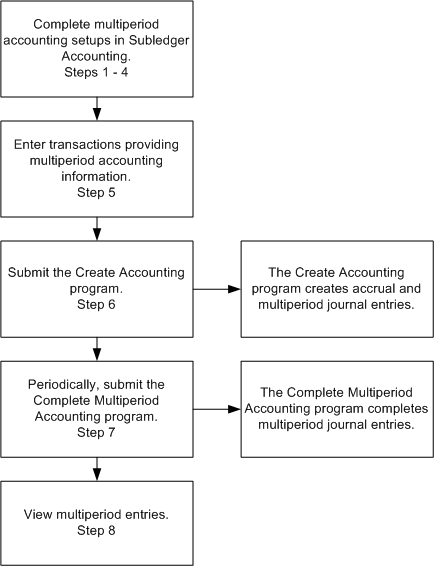

Multiperiod accounting enables users to create accounting for a single accounting event for more than one GL period. The functionality is primarily used to recognize revenue or a prepaid expense or revenue across multiple GL periods.
The figure below is described in Multiperiod Accounting Process Steps.
Multiperiod Accounting Process Flow
The multiperiod accounting process includes the following steps:
In the Journal Line Accounting Attributes Assignments window, assign sources for the following accounting attributes:
Multiperiod: Specifies whether a journal line type is eligible for multiperiod accounting
Multiperiod Start Date: Date to begin multiperiod accounting
Multiperiod End Date: Date to end multiperiod accounting
In the Journal Line Types window, define the journal line types to be used for multiperiod accounting by setting the multiperiod option.
See: To Define Journal Line Types
In the Journal Lines Definitions window, complete the following:
Assign the accrual journal line type
Navigate to the Multiperiod Accounting window to define the multiperiod options
In the Multiperiod Accounting window, users define the multiperiod options.
In the Line Assignments window, define the multiperiod line assignments as follows:
Update the line description for the accrual journal entry line type, which defaults from the Journal Lines Definitions window
Assign the recognition journal line types
Create transactions in subledger applications.
For example, a company may receive a Payables invoice in January for the cost of services for a whole year. However, the company must recognize the expense during the period the expense is incurred. The company enters the originating invoice in Payables to record its receipt.
Submit the Create Accounting program to create the originating journal entry as well as the multiperiod entries.
Periodically, submit the Complete Multiperiod Accounting program to complete incomplete recognition journal entries as their periods become open.
Once the multiperiod journal entries are processed, view the multiperiod journal entries in the inquiry pages for subledger journal entry headers, subledger journal entry lines, and accounting events.

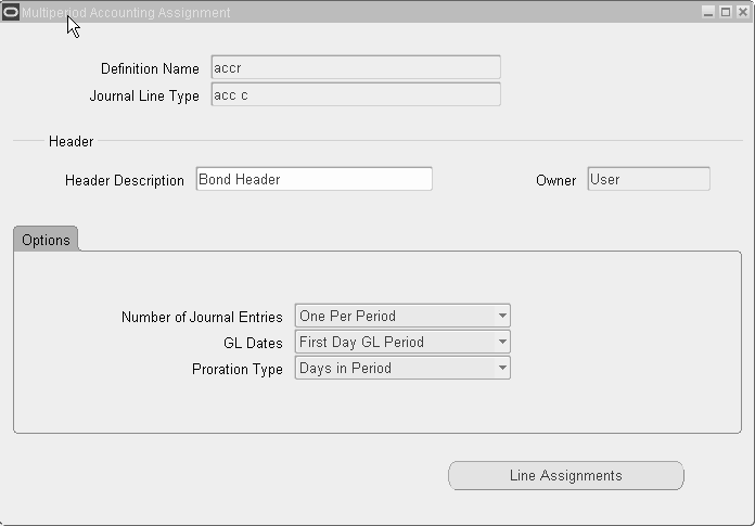

In the Line Assignments region of the Journal Lines Definitions window, select the accrual journal line type which will create the originating entry and click Multiperiod Accounting.
The Definition Name and Journal Line Type fields default from the Journal Lines Definitions window.
Enter data as described in the table below.
| Header Description | Description for the header of recognition entries |
| Number of Journal Entries | Number of multiperiod journal entries to be created. Options are:
| GL Dates | Specifies when the multiperiod journal entries are created in the GL period
Note: If a transaction calendar is assigned to the ledger, Subledger Accounting uses this calendar to ensure that the multiperiod accounting journal entries fall on business days. Options are:
| Proration Type | Specifies how the recognition amount per period should be calculated. Options are:

To assign journal line types to create the recognition journal line, enter data as described in the table below.
| Journal Line Type | Select the corresponding recognition journal line type. The list of values includes only recognition journal line types with the same natural side and event class as the accrual journal line type. |
| Name (Account Derivation Rule region) | The Owner and Description fields default based on the rule selected. |

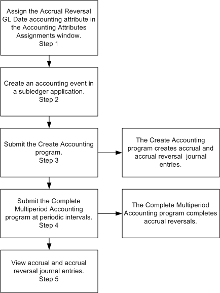

Use accrual reversal to define how and when accrual reversals are automatically performed. You can:
Indicate that an accounting event is eligible for accrual reversal
Schedule the reversal of accrual journal entries generated by the Subledger Accounting program
The diagram below shows the accrual reversal process and is described in the Accrual Reversal Process Steps.
Assign the Accrual Reversal GL Date accounting attribute at the event class level in the Accounting Attribute Assignments window.
Use this attribute to schedule the automatic reversal of a journal entry at the time it is created. Assign any standard date source or one of the following system sources to the accrual reversal GL date accounting attribute:
Next Day: The GL date of the accrual reversal will be the next day following the GL date of the accrual entry. If there is a transaction calendar assigned to the ledger, this will be the next business day.
First Day Next GL Period: The GL date of the accrual reversal entry will be the first day of the following period. If there is a transaction calendar assigned to the ledger, this will be the first business day.
Last Day Next GL Period: The GL date of the accrual reversal entry will be the last day of the following period. If there is a transaction calendar assigned to the ledger, this will be the last business day.
Note: Users can override the accrual reversal GL date accounting attribute values on the journal entry header in the Application Accounting Definitions window.
Create an accounting event in the subledger application.
Submit the Create Accounting program.
The Create Accounting program creates the accrual journal entry as well as accrual reversals and multiperiod journal entries. The program creates the accrual reversal entry to negate the impact of the accrual entry. Depending on the selection for Reversal Method for the ledger accounting options in the Update Accounting Options window, the accrual reversal entry will have the debit and credit signs reversed or it will have negative amounts.
The status of the accrual reversal journal entry and multiperiod journal entry is based upon the status of the GL period of the GL date of the accrual reversal journal entry and the End GL Date specified in the Create Accounting request parameters as described in the table below.
| GL Date | Open or Future Entry GL Period | Closed or Permanently Closed GL Period | Never Opened GL Period |
| The GL Date of the accrual reversal is on or before the End GL Date in the mode specified in the Create Accounting request | Creates the journal entry with the status specified in the Create Accounting request |
| GL Date of the accrual reversal is after the END GL Date specified in the Create Accounting request | Creates the journal entry with an incomplete status |
Submit the Complete Multiperiod Accounting program to complete accrual reversals in future GL periods as the periods are opened.
The Complete Multiperiod Accounting program looks at the GL dates of all incomplete accrual reversal and multiperiod journal entries as specified in the Complete Multiperiod Accounting request parameters. It completes those entries with GL dates in open or future entry periods that fall on or before the End GL Date parameter specified in the Complete Multiperiod Accounting request.
Once an accrual reversal or multiperiod journal entry is completed, it is sequenced and appears on reports and inquiries.
See: To Complete Multiperiod Journal Entries and Accounting Reversals
View accrual reversals.
See: Subledger Journal Entry Lines Inquiry and Subledger Accounting Events Inquiry Overview
The following examples describe how accrual reversals are scheduled and entered in journals.
A company receives materials worth $100 on the 30th of the month but has not been invoiced. The following journal entry is created when the material is received to record the accrual.
| Account | Entered DR | Entered CR | Accounted DR (USD) | Accounted CR (USD) |
| Accrual Expense | 100.00 | 100.00 | ||
| Accrual Liability | 100.00 | 100.00 |
The accrual reversal GL date is First Day Next GL period and the following journal entry is created to reverse the accrual.
| Accrual Liability | 100.00 | 100.00 | ||

Use application accounting definitions to assign journal lines definitions, supporting references, and header descriptions to event classes and event types.
Storing the accounting definitions validation status at the event class and event level enables you to generate subledger journal entries for certain event classes or event types even if the accounting definitions for other event classes or event types are invalid.
Each event class and event type assignment consists of a header assignment and one or more journal lines definition assignments. A header assignment includes the following:
source assignments for the GL date and Accrual Reversal GL date, if enabled for the event class
a journal entry description (optional)
one or more supporting references (optional)
You can assign multiple journal lines definitions to an event class or event type. Subledger Accounting generates a single journal entry per accounting event and ledger using the line assignments from all the journal lines definitions assigned to the event class or event type. The following can be assigned to a journal lines definition:
Journal line type
Sources are used by all of the above components.
The figure below shows the relationship of the components to an application accounting definition as described in the above text.
Application accounting definitions enable you to meet the subledger accounting requirement of multiple accounting representations. While one application accounting definition can generate subledger journal entries that are compliant with one particular set of accounting requirements, another definition can be defined to meet a completely different set of accounting requirements.
For example, use a complete set of US GAAP accounting definitions for Payables as an application accounting definition for the ledger US applications. Use a complete set of French GAAP accounting definitions for Payables can be used for the ledger French Operations. These two sets of definitions have differences based on the setup of the various components that make up their application accounting definitions.
Seeded application accounting definitions are provided for all Oracle subledgers. If specific requirements are not met by startup accounting definitions, users can copy and modify the seeded definitions and their assignments.
The Applications Accounting Definitions (AAD) Loader enables users to import and export application accounting definitions and journal entry setups between the file system and database instances. The AAD Loader also supports concurrent development and version control of the application accounting definitions.
Use the Application Accounting Definitions window to assign header descriptions and journal lines definitions to the event classes and event types for a particular application.
Assign a header description to the event class or event type in the Header Assignments window.
Journal Lines Definitions can be assigned to the application accounting definition in the Application Accounting Definition window.
Define the following:
| Field and Button | Description |
| Owner | Automatically populated. For components seeded by Oracle, the value is Oracle. For components created on site by users, the value is User. |
| Enabled | If selected, makes this application accounting definition available |
| Accounting | If selected, the following rules apply:
| Validation Status | Displays the validation status of the event class and event type. Values include:
An application accounting definition can only be used to create subledger journal entries for a valid event class and event type. The Subledger Accounting program creates errors in the following cases:
| Create Accounting | Select to create subledger journal entries for the accounting events associated with the event class and event type. If this check box is deselected, no journal lines definitions can be assigned to the event class and event type. If any journal lines definitions are assigned to the event class and event type, this check box cannot be deselected. |
| Locked | Controls whether the application accounting definition can be modified |
| Header Assignments | Opens the Header Assignments window to assign a journal entry description and supporting references to the event class and event type of the application accounting definition and to view the accounting attributes associated with the journal entry header.
Note: Supporting references maintaining balances or with line level sources assigned to the details may not be used on journal entry headers. |
| Journal Lines Definition Name | Assign ALL - event type journal lines definition to an event class and event type with ALL association in the application accounting definition and journal lines definitions window. List of values includes all journal lines definitions that meet the following criteria:
Users can assign one or more journal lines definitions to the event class or event type. Subledger Accounting generates a journal entry per event and ledger using the line assignments from all journal lines definitions assigned to the event class and event type. |
| Validates | Validates the application accounting definition |
When copying an application accounting definition, copy the header and line assignments associated with the original definition, or copy a definition and create the assignments manually.
| Chart of Accounts region | The transaction and accounting charts of accounts default from the original application accounting definition. Note that if values have defaulted for these fields, they cannot be updated. However, if the original application accounting definition does not have a transaction or accounting chart of accounts, then users can enter them in this window. If the charts of accounts are entered, then the following rules apply:
| Include region | Select the appropriate check boxes to copy the assignments associated with the original application accounting definition to the new one. |
After modifying a component of an application accounting definition, its validated status changes to Not Validated. Validate the modified definition in the Application Accounting Definitions window. Once validated, use it to generate subledger journal entries.

Application accounting definitions that comply with a common set of accounting requirements can be grouped into a subledger accounting method. The grouping allows a set of application accounting definitions to be assigned collectively to a ledger. This reduces setup time and helps ensure a consistent method of accounting for all subledgers feeding into a particular ledger.
For example, a subledger accounting method entitled French GAAP can be defined to group application accounting definitions that are accounted for using French GAAP criteria. As another example, a Cash Basis Accounting Method can be defined to group application accounting definitions that are used to account for transactions on a cash basis.
By assigning different subledger accounting methods to ledgers, the AMB enables users to create multiple accounting representations of transactions.
Note: Oracle recommends that users do not modify a seeded method or any other seeded component as it could get overwritten in an upgrade. Instead, copy a seeded component and then modify it appropriately. The modified component has an Owner type of User.
| Owner | Automatically populated. For components seeded by Oracle, the value is Owner. For components created on site by users, the value is User. When selecting component names from a list of values in AMB windows, users are presented with the name as well as the Owner of the component. This enables users to distinguish between seeded and user-defined components. |
| Enabled | If selected, makes this subledger accounting method available for use |
Note: The transaction and accounting chart of accounts are optional. If they are entered, then the following rules apply:
| Application | Application that owns the application accounting definition for this subledger accounting method |
When a subledger accounting method is copied, the new method is assigned all the application accounting definitions and associated header and line components of the original subledger accounting method. For example, if the subledger accounting method US GAAP is copied to a new subledger accounting method called US Management, then all the components of the AMB associated with US GAAP are now also associated with US Management.
To customize any of the components associated with the new subledger accounting method, copy the relevant component or create a new one and associate it with the new subledger accounting method.
The Transaction and Accounting charts of accounts defaults from the original subledger accounting method. Note that if a value has defaulted for these fields, they cannot be updated. However, if the original subledger accounting method does not have a transaction or accounting chart of accounts, enter them in this window.
These entries serve as the charts of accounts for the subledger accounting method created. If entered, only components defined with the same or no charts of accounts are available for assignment to the new subledger accounting method. The accounting chart of accounts, if entered, must match the chart of accounts of the ledger that this new subledger accounting method is to be assigned to.
