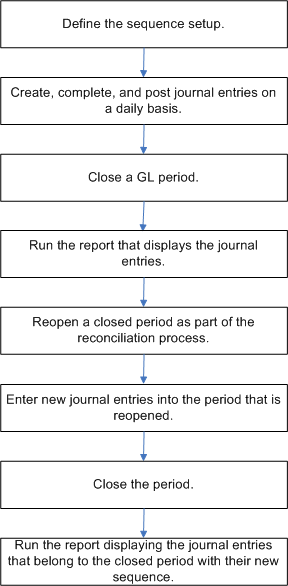

The diagram below shows the reporting sequence process and is described in Reporting Sequence Process Steps.
Reporting Sequence Process Flow Diagram
Define the sequence setup as part of the implementation process.
Create, complete, and post journal entries as part of the daily operations.
Close a General Ledger period as part of the period end operations and the reporting sequence program is automatically run.
After selecting the journal entries that belong to this period and to all the subsequent consecutive closed periods, the reporting sequence program calls the accounting sequence numbering program to perform the actual sequencing. The reporting sequence program selects the journal entries in chronological order based on the sequencing order.
When a GL period is closed, the journal entries are sequenced if all the prior GL periods are closed based on the sequence control date.
When there is one previous GL period open, the journal entries that belong to a closed period are not eligible for sequencing.
Run the report that displays the journal entries.
Run this report whenever you want. The journal entries that belong to a closed period appear in this report with their corresponding sequence number, while the journal entries that belong to an open period are displayed without the sequence number since they have not been sequenced yet.
You can decide to open a closed period as part of the reconciliation process and the reporting sequence program is automatically run.
The program erases the sequences that are assigned to the journal entries that belong to the reopened period. If there are other succeeding closed periods, the sequences assigned to the journal entries that belong to these periods are also erased. As the sequence assigned to the journal entries is a gapless sequence, the reporting sequence program calls the accounting sequence numbering program in erase mode with the lowest sequence assigned to the selected journal entries to avoid gaps when the journal entries are resequenced.
Enter new journal entries into the period that has been reopened.
Close the period and the reporting sequence program is automatically run.
The reporting sequence program calls the accounting sequence numbering program to sequence all the journal entries that belong to this period in chronological order based on the sequencing order. The reporting sequence program selects the journal entries that belong to the succeeding closed periods.
The following journal entries can be assigned a reporting sequence:
In Subledger Accounting, journal entries that are complete and transferred to General Ledger
Note: Draft entries are not assigned a reporting sequence.
In General Ledger, posted journal entries
Run the report that displays all the journal entries that belong to the closed periods with their new sequence.
