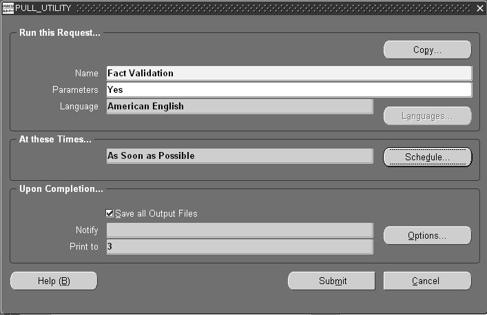

Choose the Demand Planning System Administrator responsibility.

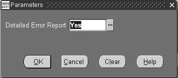

In the Navigator, select Audit Fact to open the Parameters window, which appears on top of the Pull_Utility window.
You can select either Yes or No in the Detailed Error Report field. If you select No, you will get a summary report. To get a detailed error report, choose Yes, then select OK to open the Pull_Utility window.
The Pull_Utility window contains the Fact Validation in the Name field and Yes in the Parameters field.

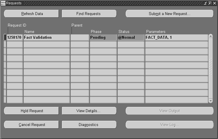

Select Submit. A message appears confirming that the request was submitted. Please note the Request ID.
Select No to close the window.
Select View > Requests from the main window menu bar.
The Find Requests window appears.
Select Find to open the Requests status window.
Select Refresh Data if you need to see the request status under the Request ID.
Select View Output to see the report.

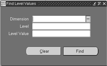

To open the Find Level Values window, select Dimension Values > Level Values in the Navigator.

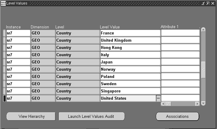

Select values for the Dimension and Level fields and select Find to open the completed Level Values window.
The View Hierarchy button is described in Graphical Display of Hierarchies.
Selecting Associations enables you to find a higher level value (parent) for a selected lower level value (child) for a dimension. For example, for the Geography dimension, if a country name such as United States is selected, it shows its corresponding area (or parent), which is North America.
Select Launch Level Values Audit.

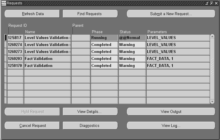

Select View > Requests from the main menu.

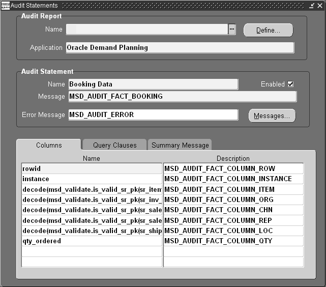

Sets of base queries have been seeded into the core application for both Audit Fact and Level Values Audit. You can review these query statements by following the directions below. Furthermore, implementation consultants, or users with limited SQL experience can add or modify this set of preseeded queries to provide custom detailed validation, or to format the output of existing audit statements.
In the Navigator, select Setup > Audit Statement.
From the menu bar select View > Find while the cursor is on the Name area.
A list of predefined audits appears.
Choose any of the Audit Statements (e.g., Booking Data), to open the Audit Statements window with the list of audits.
The following table lists the names of the fields, their functions, and legal values that appear in this window:
| Field | Function | Legal Values |
| (Audit Report) Name | User-defined name of the audit report. | List of Values |
| Define... button | Brings up FND form which lets you modify, create, or delete audit report. | Not applicable |
| (Audit Statement) Name | System-provided name of a preseeded audit statement. | Not applicable |
| Enabled check box | Indicates whether to execute the Audit Statement. | Checked or unchecked |
| Message | Gives the FND message that is output before the statement is run. | Not applicable |
| Error Message | Name of an error message that is displayed when the audit statement query retrieves any errors. | Not applicable |
| Messages... button | Allows you to define the specific error text that is displayed in the error message above. If the special token &COUNT has been included in this error text, it displays as the number of errors retrieved. | Not applicable |
| Columns tab: Name column | The Columns tab lists the columns of the query. Name is the actual column name or SQL expressions. | Not applicable |
| Columns tab: Description column | This field is optional. It refers to FND messages that are written as column headers in the report's output. | Not applicable |
If you want to change the FROM and WHERE clauses of your SQL query, select the Query Clauses tab.
If you want to define a Summary Message for the fact validation or level value validation, select the Summary Messages tab.
