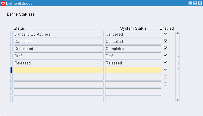

Follow these steps to define a work permit status.
To define a work permit status
Navigate to the Define Work Permit Status page (Enterprise Asset Management > Permit Statuses).
Click the New button to add a new status.
The Define Statuses page appears.
Enter the name of the new permit status.
Select a System Status value to associate to the new work permit status (required).
Select the Enabled check box if you want users to be able to use the new work permit status.
Save your work.

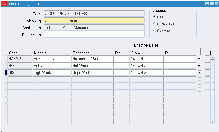

Follow these steps to define a work permit type.
To create work permit types
Navigate to the Manufacturing Lookups page (Enterprise Asset Management > Lookups).
The Manufacturing Lookups page opens in the add mode.
In the Access Level group box, select the User value.
In the Type field, enter the name of the permit type, WORK_PERMIT_TYPES.
In the Meaning field, enter Work Permit Types.
In the Application field, enter Enterprise Asset Management.
In the Code field, enter the name of the code to be associated with the permit type such as HAZARD.
Enter the Meaning for the permit type such as Hazardous Work.
Enter the Description for the permit type such as Hazardous Work.
Enter the Effective Dates for the permit type.
The From (beginning) date will default to the system date, but you can override this value. The To (ending) date is optional.
Select the Enabled check box if you want to enable users to select this permit type.
Save your work.

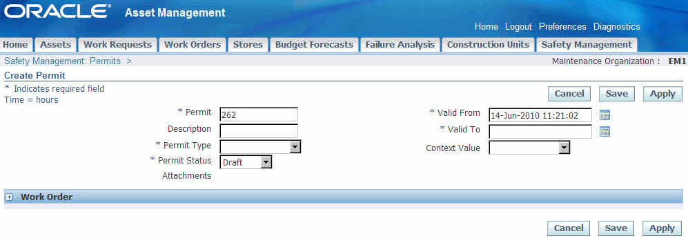

Use the Create Permit page to create a new work permit.
To create a new work permit
Navigate to the Safety Permits page (Maintenance Super User > Home > Safety Management > Permits).
Click the Create Permit button and the Create Permit page appears.
Enter a permit number or accept the default number in the Permit field.
(Optional) Enter a description for the work permit.
Select a work permit type (required).
Select a work permit status (required).
All new work permits are automatically created in the Draft status, but you can change this value.
Enter a date in the Valid From and Valid To fields (both are required fields).
The default value in the Valid From field is the system date and time that you are creating the work permit, but you can override this value.
(Optional) Click the FlexFields button to select a flexfield to add to the page.
See eAM Descriptive Flexfields, Oracle Enterprise Asset Management Implementation Guide and Oracle E-Business Suite Flexfields Guide.
Click the Work Order collapsible section to add work orders to the work permits.
Select the work orders to add.
See Updating a Work Permit for information regarding adding work orders to a work permit.
Click the Apply button.
You can add attachments to the work permit after you have saved the work permit.
Click the Attachments button to add attachments.

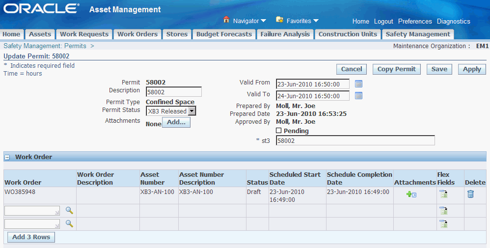

Use the Update Work Permit page to update a safety permit.
Click the Update Permit button for the safety permit that you want to update.
The Update Permit page appears.
Revise the permit details.
You can revise the following information:
Description
Permit Status
If you update a work permit to a status of Released (or a user-defined equivalent), a workflow notification is triggered upon save. The Completed status will open a new field in which you can enter the completion date and time.
Attachments (add)
Valid From and Valid To dates
(Optional) Click the Flexfields button to select additional flexfields to add to the page.
You can click one of these buttons to perform other actions:
Cancel: To return to the Safety Permits page without saving any changes.
Copy Permit: To copy the current work permit to a new permit.
Save: To save your changes and remain on the Update Permit page.
Apply: To save your changes and return to the Safety Permits page.

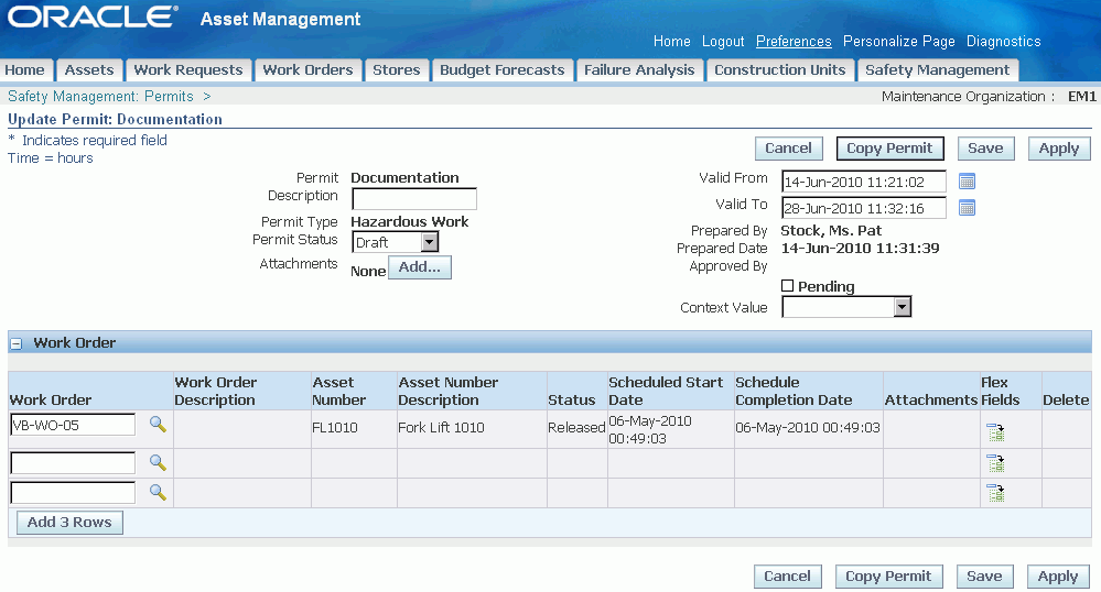

You can add (associate) one or more work orders to a work permit when you create the work permit or when you update the work permit.
Important: You can add (associate) existing work orders only to a work permit. You cannot create a new work order through the work permit.
To associate (add) a work order to a work permit
Click the Update Permit button for the safety permit to which you want to add a work order.
Enter the work order number in the Work Order field, or click the search button.
Search and select the appropriate work order to add.
Repeat these steps to add additional work orders to the safety permit. Click the Flexfields button to add additional flexfields to the page.
You can click one of these buttons to perform additional tasks on the safety permit:
Save your work.

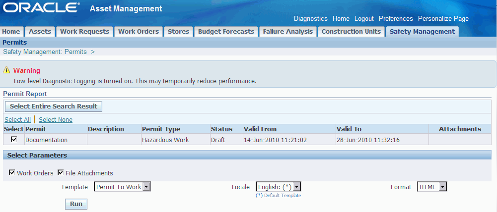

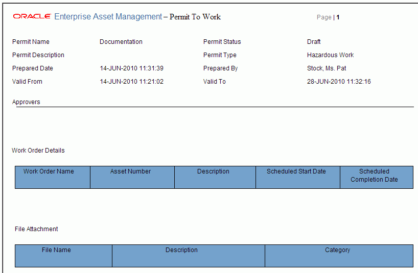

You can print a work permit.
Click the Print Permit button for the work permit that you want to print.
The Permit Report page appears.
Select the report parameters that you want to include such as Work Orders and File Attachments.
Select a template (if applicable).
The Locale defaults to the template (if applicable), and this describes the language in which you want the permit to be printed.
Select one of the following report formats:
Excel
HTML
RTF
Click the Run button to print the work permit.
View the printed work permit.
