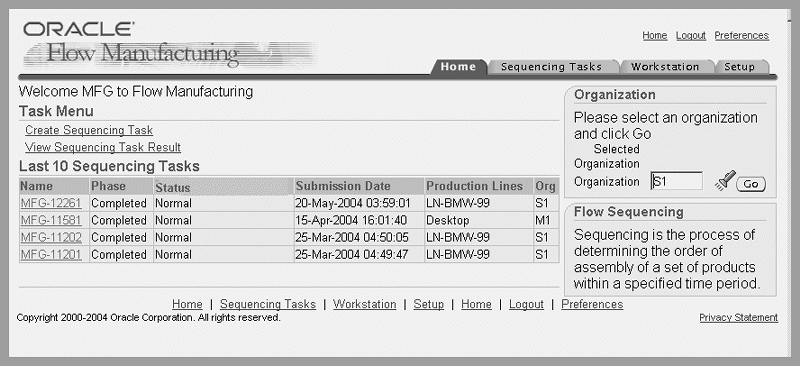

Flow Manufacturing Sequencing is setup, tasks created, and submitted in the Flow Manufacturing Sequencing and Execution pages. Attributes, constraints, rules, and production lines are set up in the Setup tabbed region. Tasks are created in the Sequencing Tasks tabbed region, and later submitted when your adjustments are finalized. You first select an organization in order to navigate to the other pages. The Home page enables you to:
View up to the last ten sequencing tasks generated. These are displayed in a table displaying showing the task Name, Phase, Status, Submission Date, and the Production Line assigned, and Organization. See: Viewing Sequencing Tasks
Navigate to the Task Summary detail page. See: Sequencing Task Summary
Create a new task. See: Creating Sequencing Tasks

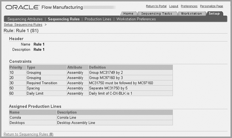

Rules are a grouping of prioritized constraints defined for the attributes. Rules are assigned to specific production lines. For example, Rule 1 consists of two prioritized constraints:
| Priority | Constraint | Attribute | Description |
| 10 | Required Transition | Assembly Item | Assembly 1 must be followed by Assembly 2 |
| 20 | Group | Assembly Item | Group assembly 3 |
On an automobile production line, you have an attribute specified as Color, a constraint created for the required transition. Then you can create another constraint for spacing— one of every 4 automobiles is red, the rest are black. Then group the constraints into a rule, and name it Rule 1.
A rule is a collection of constraints, and associated with one or more production lines.
For example, on an automobile production line, you have an attribute specified as Color, a constraint created for the required transition. Then you can create another constraint for spacing—one of every 4 automobiles is red, the rest are black. Then group the constraints into a rule, and named Rule 1—and associate it with a specific production line.

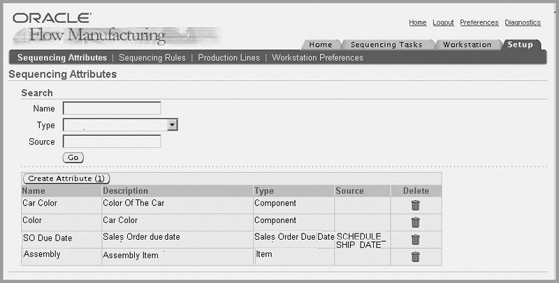

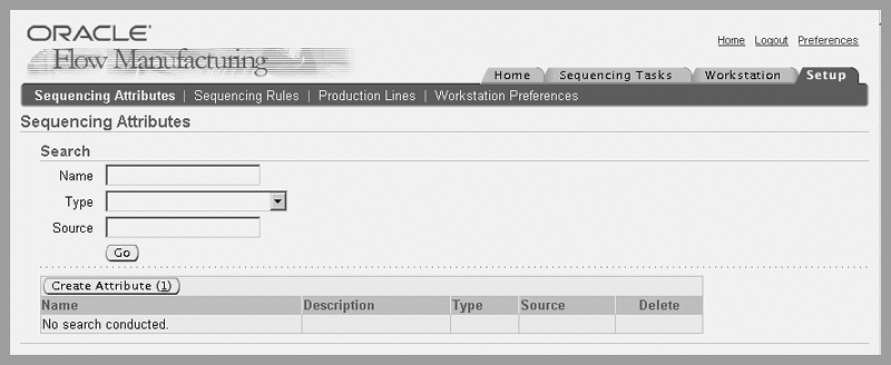

To view sequencing attributes
In the Flow Manufacturing Sequencing and Execution Home page, select a value in the Organization field and choose Go.
Select the Setup tabbed region.
Select Sequencing Attributes to display the Sequencing Attributes page.
To view existing attributes, enter values in the Search region to filter your search, or leave these fields blank to display all defined attributes.
You have the option to enter:
Name—a unique identifier for the attribute
Type—such as Item, Model, or Product Family. See: Attributes
Source—this is a table column field for property type attributes.
Choose Go to display the results of your search criteria.

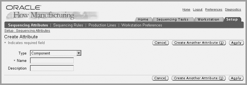

To define sequencing attributes
Choose Create Attribute to display the Create Attribute page.
In the Type field, select an attribute type.
See: Attributes
Enter a unique Name, and optionally a Description for this attribute.
If you are creating more than one attribute, choose Create Another Attribute to define another record.
Choose Apply to save your work.
A confirmation page displays when all your records are saved.

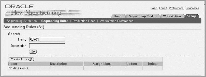

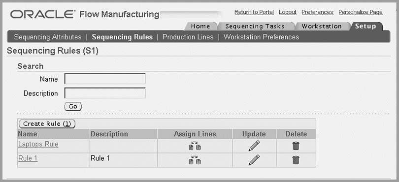

To view sequencing rules
In the Flow Manufacturing Sequencing and Execution Home page, select an organization in the Organization region, and choose Go.
Select the Setup tabbed region, and choose Sequencing Rules to display the Sequencing Rules page.
Enter values in the Search region to filter your search, or leave these fields blank to display all defined sequencing rules.
You have the option to enter Name and Description values.
This page displays a list of rules according to your search criteria. You can also view details of a rule, assign lines, and update the rule with new information. See: Assigning Production Lines and Rules, and Constraints
Select a rule in the Name field to display the Rule detail page.
This page displays the Constraints attached to the rule, and the assigned production lines. See: Rules
Rules are a grouping of prioritized constraints, the constraints use priorities to determine the sequence of production.

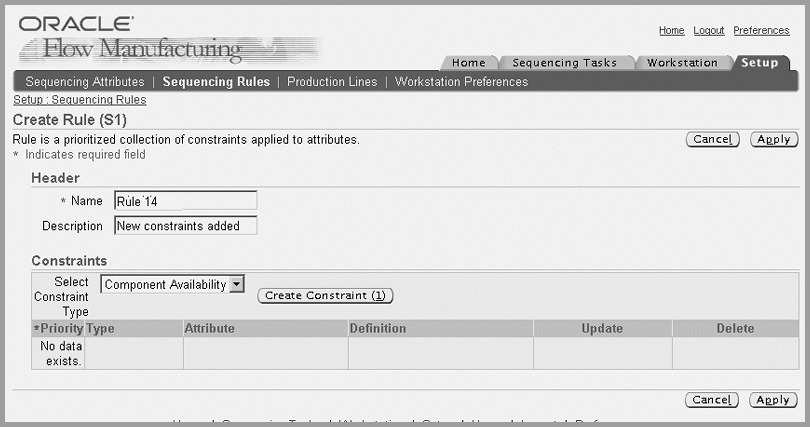

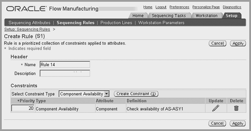

To define a sequencing rule
Choose Create Rule to display the Create Rule page.
Enter a unique value for this rule in the Name field, and optionally a description of this rule.

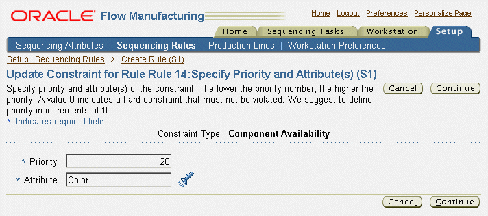

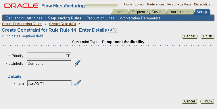

In the Constraints region, select constraint values from the Select Constraint type box.
Choose Create Constraint to display the Create Constraint page.
Enter a value in the Priority field, and select an attribute.
When you select an attribute, the Details field displays on the page.
Note: The lower the priority number indicates a high priority. A value of zero indicates a hard constraint that must not be violated. It is good practice to define priorities in increments of 10. See: Constraints
Select a component item number for this constraint.
Choose Finish to save your work.
The new constraint displays in the Constraints region of Create Rule page.
To modify constraints displayed in this list, select a constraint and choose Update. The Update Constraint for Rule page displays.
You have the option to modify the Priority and Attribute fields.
Choose Continue to display the Update Constraint Details page.
You have the option to change the item on this page.
Choose Finish to save your work. The updated constraint displays in the Constraints region of Create Rule page.
If you want to delete any of the constraints created for this rule, choose Delete for the selected rule.

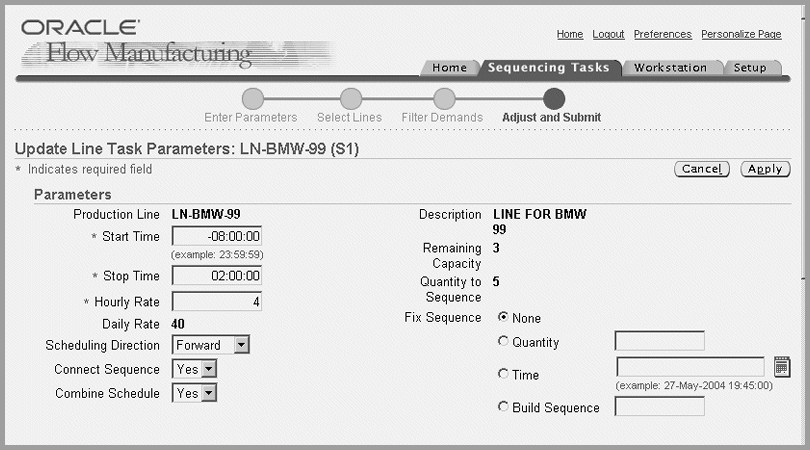

In the Sequencing Default Values region, you can enter default values for when running the Sequencing Concurrent program for this line. In the Scheduling Direction box, you have the option to change the scheduling from Forward or Backward.
The Connect Sequence field is used to connect this sequencing task to a previous sequencing task. Your choices are Yes or No.
This option enables you to sequence between days within the horizon, and gives you the option to connect the sequences with existing sequences without violating constraints.
The Combine Schedules field is used to combine similar concurrent demand into one schedule. Your choices are Yes or No.
The Fix Sequence field is used to prevent the resequencing of existing Flow schedule when new demand is added to the schedules, or a portion of the schedules are resequenced. Your choices are:
None—Indicates all existing schedules are resequenced.
Time—Existing schedules with a completion time less than or equal to this value are not resequenced.
Quantity—Flow schedules up to the specified quantity are not resequnced.

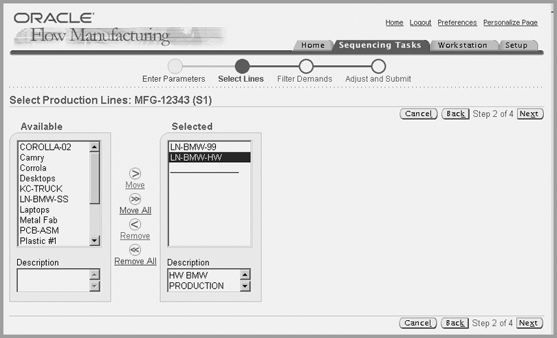

To assign a rules to a production line
Navigate to the Production Lines page, and Search for the record to update.
Select the production line, choose Update to display the Update Production Line page.
In the Assigned Rules region, choose Assign Rule.
Assign Rule to Production Line page displays.
Enter a search string in the Rule Name field and choose Search.
The Search and Select page displays with the results of your search.
Select a record. The record displays on the Assign Rule to Production Line page.
Choose Apply to assign this rule to your production line.
The rule displays in the Assigned Rules region of the Update Production Line page.

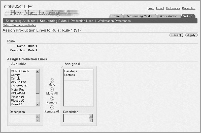

To assign production lines to a rule
Choose Sequencing Rules.
Display the appropriate rules. See: Viewing Sequencing Rules
Choose Assign Lines to display the Assign Production Lines to Rule page.
In the Rule region, the name and description of the rule displays.
In the Assign Production Lines region, select production lines from the Available box, and move them to the Assigned box.
You can move all the production lines, remove lines, or remove all the production lines in the Assigned box.

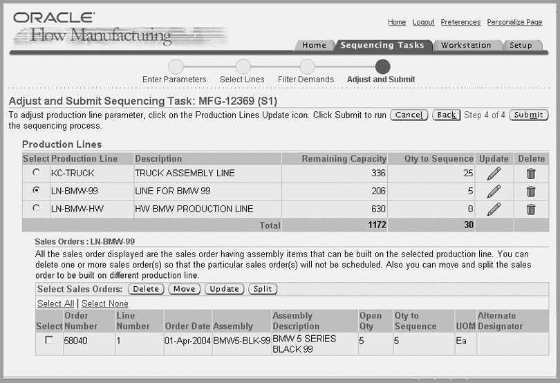

The Sequencing Task pages display a chronology of steps, or a train, showing where you are in the process. The train displays Enter Parameters, Select Lines, Filter Demands, and Adjust and Submit:
The first step is to enter parameters for the sequencing run. You create a name for the task, and specify the horizon dates, any applicable schedule group, and data used to create new schedules—or if the task is resequencing existing schedules.
The next step is to select the production lines used in this run.
In the Filter Demands step, you specify demand dates. The Filter Demands page has two regions—the first is for selecting demand date. The Optional region is used to add additional filter information such as assembly, customer, and attribute. For example, you may want to consider all sales orders of a specific due date, and then specify the particular customer and assembly number. This page is not used if you are resequencing existing schedules.

When you navigate to the Enter Production Lines page, Select Lines is highlighted in the step train.
To select production lines for a sequencing task
Navigate to the Enter Production Lines page by choosing Next from the Enter Parameters page.
Select lines from the Available box, and move to the Selected box.
Choose Next to display the Filter Demands page.

The Adjust and Submit Sequencing page is used to view the remaining capacity and demand for this sequencing task. If you enabled the Adjust Detail Demands box, on the Filter Demands page, demand data displays in the Selected Orders.
This page enables you to update task parameter lines, delete production line demand from this sequencing task, and update sales order demand information. You can also delete, move, or split the sales orders attached to this task.
To edit sequencing task results
Navigate to the Adjust and Submit Sequencing Task page by choosing Next from the Select Production Lines or Filter Demands pages.
Note: If you are resequencing existing schedules, the Filter Demands page is not used, and this page displays after the Select Production Lines page.
The Production Lines region displays Production Line, Description, Remaining Capacity, and Quantity to Sequence fields:
Remaining capacity is the capacity for the line. The value is calculated from the existing Flow schedules and the line capacity total.
The Quantity to Sequence value is calculated from the filter criteria you selected.
To update line task parameters, select a production line. Then choose Update to display the Update Line Task Parameters page.
To delete a production line from this task, select a production line and choose Delete.
In the Select Sales Order region, you have the option to delete, move, update, or split sales orders that are attached to the task. To remove a sales order from consideration, select the order number and choose Delete.
To move a sales order to another production line, select the order number and choose Move. See: Moving Demand
To update the sales order demand or change the routing, select the order number and choose Update. See: Updating Demands
To divide the demand between multiple Flow schedules and other production lines, choose Split. See: Splitting Demands
To submit this sequencing task to create Flow schedules, choose Submit.
On the Adjust and Submit Sequencing Task page, in the Production Lines region, select a line.
Choose Update to display the Update Line Task Parameters page.
Enter a Start and Stop Time range. These fields are required.
Enter the Hourly Rate of this line. This field is required.
This option enables you to sequence between days within the horizon. When sequencing for a specified horizon, this flag gives you the option to connect the sequences with existing sequences without violating constraints.
Build Sequence—Flow schedules up to the specified build sequence are not resequenced.
In the Rules and Constraints region, you can use the Copy Constraint from Rule box to select a rule, and use that rule's constraints. Choose Copy to copy the constraints to your current process.
The copied constraint displays in the Constraints region. The Constraints region displays all constraints in the current sequencing task. You can change priority—and create, modify, or delete constraints.
To change the priority level of the constraint, enter the new priority value in the Priority field. Choose Apply to save your changes.
To create a new constraint for this task, choose Create Constraint to display the Update Constraint page. See: Defining Sequencing Rules and Constraints
To delete a constraint, select the constraint and choose Delete.
To update a constraint listed on this page, choose Update.

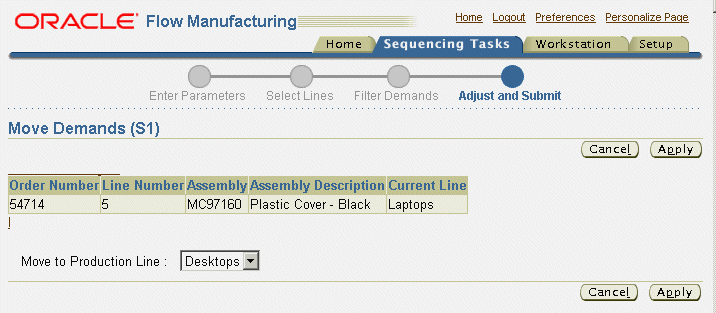

You may want to move demand to another production line. You can only move demand to an alternate routing, for a production line selected, when you created the sequencing task. See: Selecting Production Lines for a Task
To move demands on a sales order
On the Adjust and Submit Sequencing Task page, in the Order region, select an order.
Choose Move to display the Move Demands page.
This page displays the sales order information including fields for Order Number, Line Number, Assembly number, Assembly Description, and the Current Line for this demand.
In the Move to Production Line box, select the production line where you want to move this line.
You will return to the Adjust and Submit Sequencing Task page displaying the updated information.

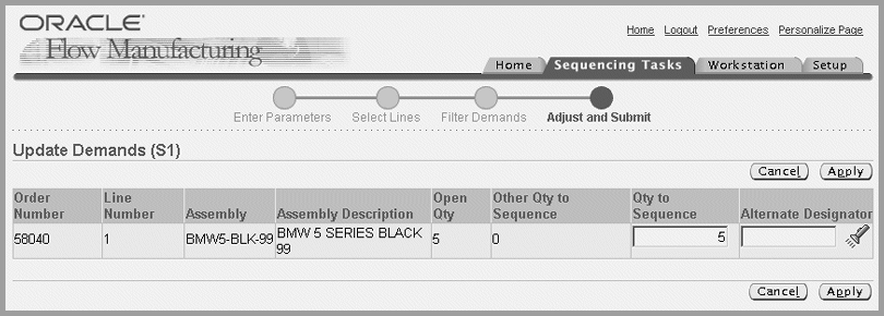

Demand is based on the assembly's primary routing. The Update Demands page enables you to change either one or both of the values for the quantity to sequence, and the routing. The alternate routing must exist for the same line as the primary routing.
To update demand and routing information
Choose Update to display the Update Demands page.
This page displays the order information including fields for Order Number, Line Number, Assembly number, Assembly Description, Open Quantity, and Other Quantity to Sequence.
To change the demand for this order, enter a new value in the Quantity to Sequence field.
To change the routing to an alternate routing, select a value in the Alternate Designator field.

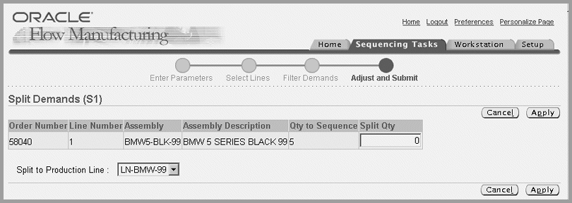

You can optimize production by dividing sales order line quantities to create multiple schedule, or splitting a quantity and moving it to another production line. You can only split demand to an alternate routing, for a production line selected, when you created the sequencing task. See: Selecting Production Lines for a Task
To split demands on a sales order
Choose Split to display the Split Demands page.
This page displays the sales order information including Order Number, Line Number, Assembly number, Assembly Description, and Quantity to Sequence fields.
In the Split Quantity box, enter the quantity you want to put on a new Flow schedule.
In the Split to Production Line, you have the option to select another production line for this new Flow schedule.
The alternate routing must exist first to change the routing path

The Sequencing Tasks Search page displays a table with the last ten sequencing tasks from the Home page, for the organization selected. This page enables you to filter your search, and access pages to create a new task or delete a task. You can navigate to the summary and detail pages for the search results.
To search for sequencing tasks
Navigate to the Sequencing Tasks Search page.
Select search criteria to filter your search.
You can select criteria in the following fields: sequencing task Name, Submission Dates From and To, concurrent request Status, concurrent request Phase, Production Line, and User Name.
Choose Go to display the results of your search.
If you do not select any criteria, all sequencing task records display. Records display in a table view.

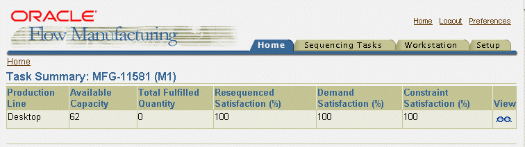

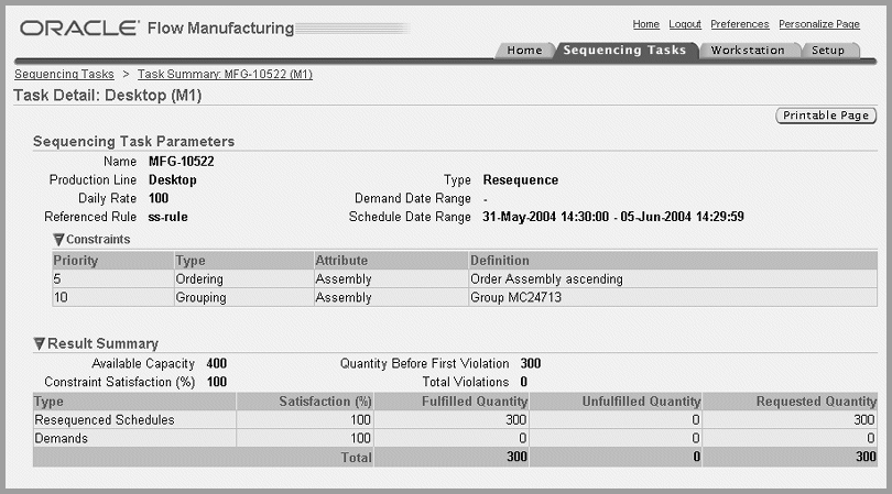

The Task Summary page displays summary data for an individual task and production line—including the available capacity for the line, the quantity fulfilled—and the percentage of resequencing, demand, and constraint accomplished. Choose View to see the details, see: Sequencing Task Details and Results
The Task Detail page is a view only, printable page displaying the results from your sequencing run. This page contains regions for:
Sequencing Task Parameters
Constraints
Results Summary
Unfulfilled Demand
Violated constraints
Violated Flow Schedules
Other Exceptions
The Sequencing Task Parameters region displays setup details for the production line, and parameters entered for the task. This includes production line, daily rate, rule, constraints, demand type, and dates for demand and schedule ranges. The Constraints region displays a list of constraints for this rule and can be used in comparing results in the Violated Constraints list.
The Results Summary region provides a view of production line actual capacity considered on this specific run. It excludes the capacity fixed. For example, if the option is to fix schedules starting at the time 10:00 am, and the line time is 8:00 am to 4:00 pm, it considers the capacity from 10:00 am to 4:00 pm.
The Constraint Satisfaction percentage displays. For example, 80 percent signifies that of a total of 100 lines, the Flow schedules created on the first 80 lines do not have any violations.

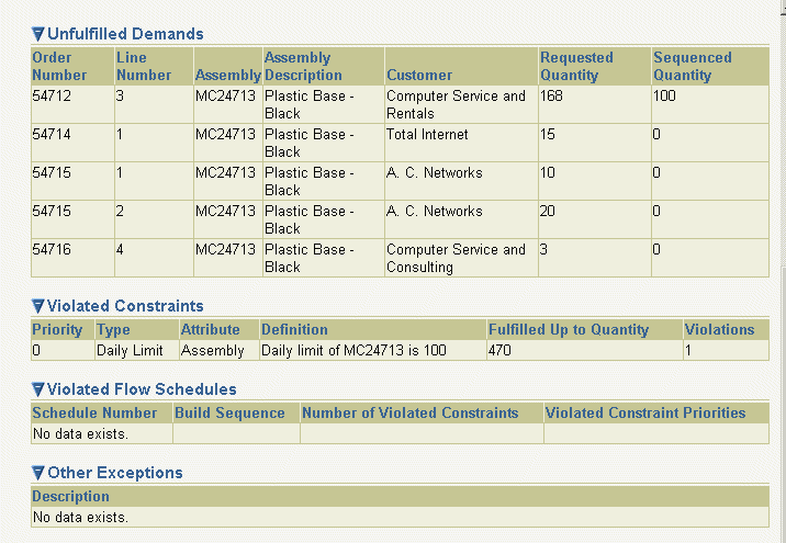

The Unfulfilled Demand region provides the details for the Demand Satisfaction listed in the summary view. For example, 80 percent signifies that out of 100 quantity demands, 80 of them are scheduled.

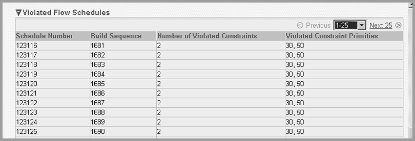

The Violated Constraints region lists the constraints broken in this sequencing run. Constraint violations are pushed to the end of the sequencing horizon.
The Violated Flow Schedule region displays a list of schedule numbers, their build sequences, the number of constraints violated, and the priorities of the constraints. The sequencing program fails when a hard constraint is violated on any newly created schedules. Violations are ignored on existing schedules. The priority level designates if the constraint is classified as a hard constraint—a constraints that must be fulfilled. If these constraints are broken—or violated—Flow Sequencing stops. A value of zero indicates a hard constraint.
