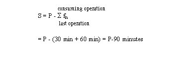

The feeder line synchronization program calculates the date and time when the subassembly is delivered to the particular line operation. This date is then used as the completion date for the subassembly line. To calculate this time, the program uses the following formula:
The values are defined as follows:
S is the subassembly completion time.
P is the parent item completion time.
fn is he operation time rounded up to the closest multiple of takt. Summation is done by following the routing network primary paths from the point of consumption to the consuming operation.
takt = parent line takt = 1/maximum hourly rate from parent line definition
The following graphic illustrates an example of a flow line producing pumps. On the main line is the final pump assembly. The subassembly line produces pump housings and feeds the line at Operation 5.
P is the completion time of the final pump assembly as scheduled
S is when the subassembly, the pump housing, is consumed at Operation 5
T is the takt time, 30 minutes
When you schedule the parent line, schedules are created with P as the completion time. The completion time of the subassembly is shown in the following calculation:
