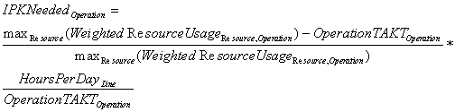

Based on One Resource
The IPK needed on the line operation is calculated assuming one resource at each operation.
Resource Needed per operation = 1

Based on Assigned Resource
The IPK Needed on the line operation is calculated using all the Assigned resources.
IPK Needed for the operation
