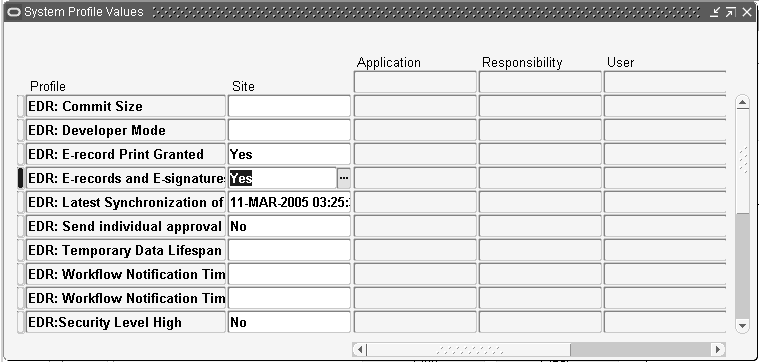

How to enable the Oracle E-Records profile options
Before enabling a specific transaction for Oracle E-Records, decide how to set the profile options described in Enabling Profile Options, Oracle E-Records Implementation Guide. The following steps show how to define one of the profile options, EDR: E-records and E-signatures.
  1. Navigate to the Find System Profile Values window (see: System Adminstrator Windows and Navigation Paths).
  2. Find and select the profile EDR: E-records and E-signatures.
  3. Enter Yes for the appropriate level (Site, Application, or Responsibility).
    Tip: Oracle recommends setting the profile option value at the Site level.

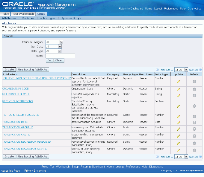

  3. Under Define Components, click on Attributes to review the list of seeded attributes for the transaction.
    Notice the ORGANIZATION_CODE attribute. Use this attribute later to build a condition.

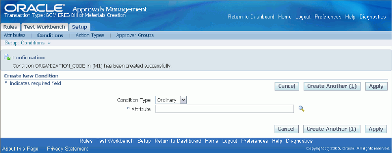

  1. Select the Conditions tab, then click on Create to add a Condition.
    the picture is described in the document text

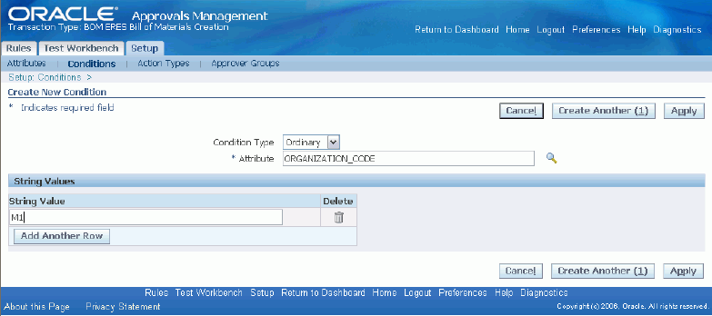

  2. Select a Condition Type.
    For more information about Condition Types, see: Condition Types, Implementing Oracle Approvals Management.

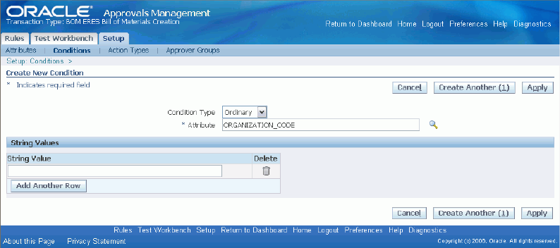

  3. Select ORGANIZATION_CODE from the Attribute list of values.
  4. Enter the organization code M1 in the String Value field.
  5. Click on Create Another.
    You receive a confirmation message stating that the condition was created.

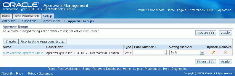

Creating Approval Groups
  1. For this example, use a previously defined Approval Group named BOM Creation Approval Group.
    For more information about creating Approval Groups, see: Approval Groups, Implementing Oracle Approvals Management.

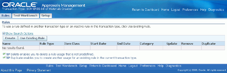

  1. Select the Rules tab, and click on Create.

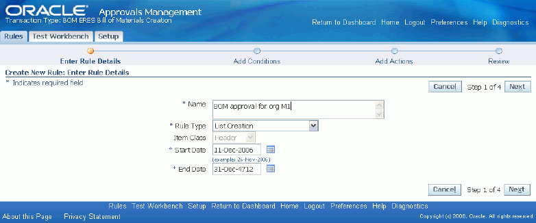

  2. Enter the Name of the Rule you want to create. This example uses: BOM Approval for Org M1.

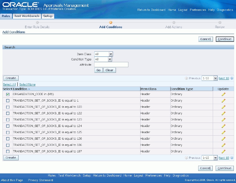

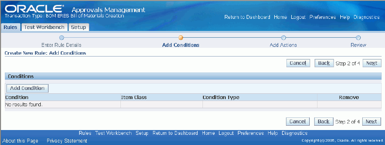

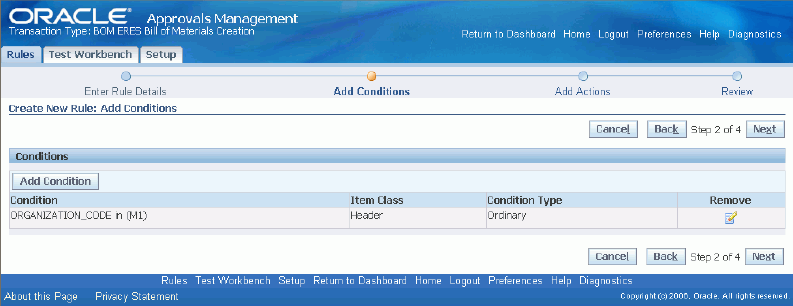

  4. Click on Add Condition.
  5. Select the Organization Code M1 as condition type from the list. Click on Continue.

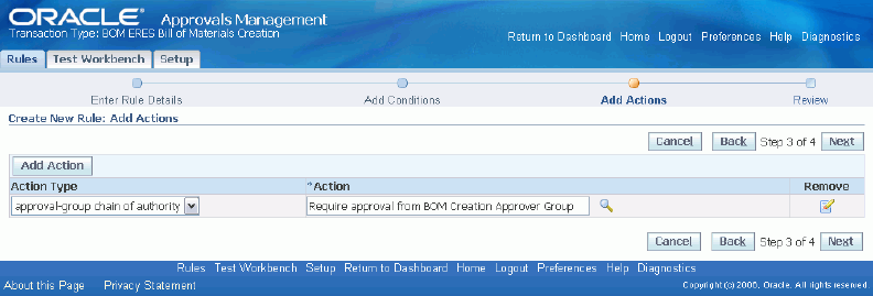

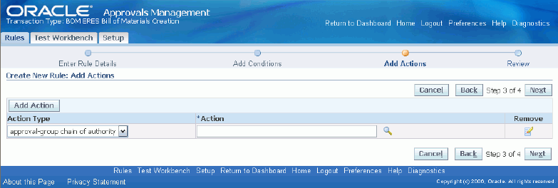

  7. In the Action field, select the approval group by clicking on the list of values.
  8. For this example, select Require approval from BOM Creation Approver Group.
    Click on Next.

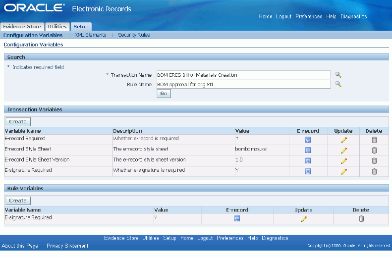

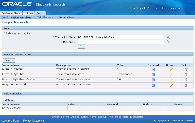

  1. Navigate to the Configuration Variables page (see: ERES Administrator Windows and Navigation Paths).
  2. Search for the Transaction Name BOM ERES Bill of Materials Creation.
    Review the Default Values for the transaction and modify them if necessary.
    For this example, set the variable default values as follows:
  3. Add additional variables as needed.
    In this example, add CHANGE_SIGNERS = NONE (see: Setting Up Ad Hoc Signers, Oracle E-Records Implementation Guide). Add this variable to meet the requirement for M1 of allowing signers to be added or deleted prior to submitting the document for approval.. The default value of NONE does not allow signers to be added or deleted. You can add a rule variable with CHANGE_SIGNERS = ALL to override the default value.
How to Set Up a Rule Variable

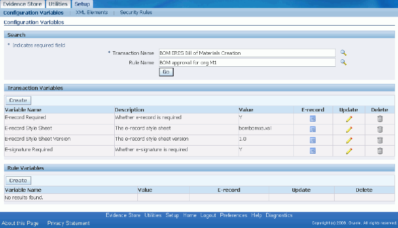

The requirements for organization M1 differ from the other manufacturing organizations. M1 requires e-signatures for each new bill of material created. Define a rule variable to meet these requirements.
  1. Enter BOM ERES Bill of Materials Creation in the Transaction Name field. Leave the Rule Name field blank. Choose Go.
    This shows all rules associated with the transaction. Currently, there are no rules associated with the BOM ERES Bill of Materials Creation transaction.
    If no rules are defined, then the default transaction variables apply to all transactions.
  2. Choose Search (flashlight icon) for the Rule Name field.
    In the Search and Select: Rule Name page, choose Go. The rule you defined earlier, BOM approval for org M1, appears. Select this rule.
  3. Underneath the Rule Variables title, choose Create.
  4. Search for and select the following input variables individually:
    Now, when a BOM ERES Bill of Materials Creation transaction is entered for organization M1, the system requires an e-signature and allows a list of signers to be modified before submitting the document for signatures.

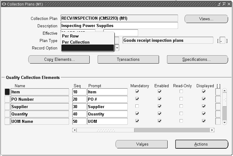

Tip: This tip is for Oracle Quality users who use the Copy Collection Plan program (An OA Framework program. See: Collection Plan Templates, Oracle Quality User's Guide for more information.). When copying a parent-child collection plan structure, check the Create Plans as Disabled box. Enable the new plan structure using the Collection Plan window. This ensures that Oracle E-Records can create e-records and e-signatures for the new plan structure.

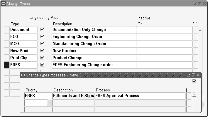

  2. Navigate to the Change Types window (see: Manufacturing and Distribution Manager Windows and Navigation Paths).
    Enter a change type for those ECOs requiring e-signatures. See: Defining ECO Types, Oracle Engineering User's Guide.
    In this example, enter ERES in the Change Type field.
  3. Navigate to the Change Type Processes window (see: Manufacturing and Distribution Manager Windows and Navigation Paths).
    Link the change type and the priority you defined in the previous steps to the ERES Approval Process workflow.

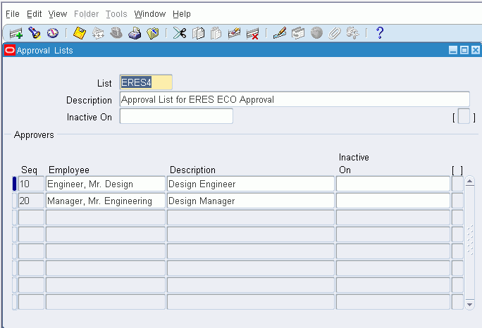

  4. Navigate to the Approval Lists window (see: Manufacturing and Distribution Manager Windows and Navigation Paths).
    Create a list of the employees responsible for approving new and updated engineering change orders (see: Defining ECO Approval Lists, Oracle Engineering User's Guide).
    In this example, create a list named ERES4.

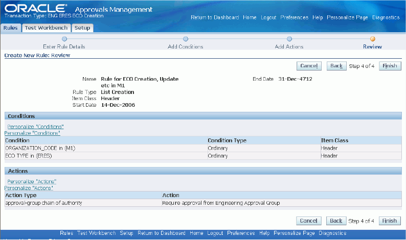

  1. Navigate to the Oracle Approvals Management page (see: Approvals Management Application Administrator Windows and Navigation Paths).
  2. Set the transaction type to ENG ERES ECO Creation.
  3. Verify that the following attributes exist:
  4. Add the following conditions:
  5. Add an approval group.
    For this example, use an existing approval group, Engineering Approval Group.
  6. Add an approval rule.
    For this example, enter the following information:

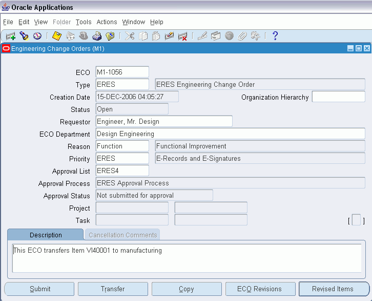

Enter and submit an ECO for approval
The remaining steps test the scenario set up in the previous steps. The following should occur:
  1. An e-record generates when an engineering change order (ECO) is created.
  2. An e-record requiring an e-signature is created when an ECO is submitted for approval.
  1. Navigate to the Engineering Change Orders window (see: Manufacturing and Distribution Manager Windows and Navigation Paths) and enter an ECO (see: Creating an ECO, Oracle Engineering User's Guide).
    For this example, enter the following:
    Notice that the Type and Priority values default the Approval Process of ERES Approval Process. The Approval List is chosen by the requestor of the ECO. For all other transactions, the approval group is automatically applied according to the transaction's applicable rule variables.

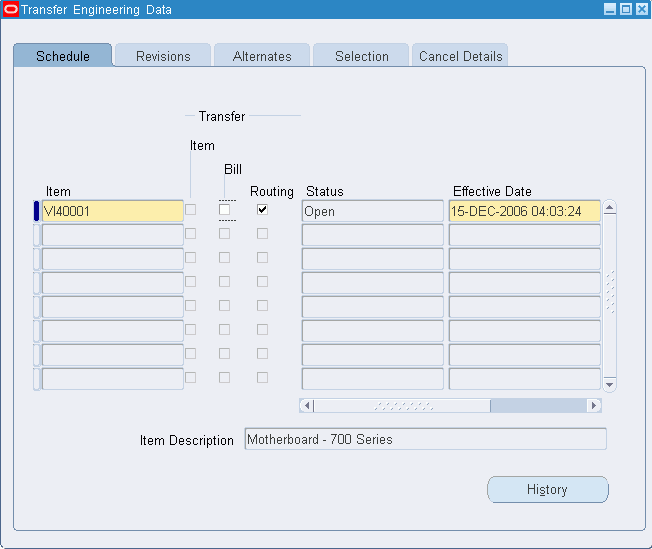

  2. For this example, choose Transfer.
    This ECO transfers the item VI40001 to manufacturing.
    Save your work.

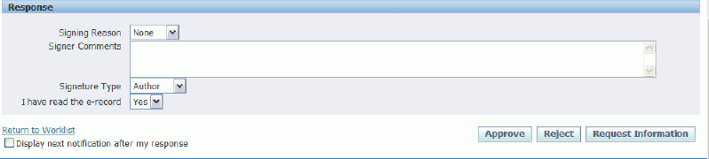

  2. Review the approval notification and choose Approve, Reject, or Request Information after entering your response.

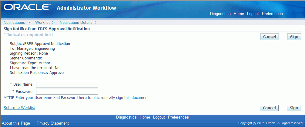

  3. Sign the approval notification.

For nonconformance, disposition, and corrective action request collection plans, you can only enter your e-signature by row, not by collection. For other collection plans, you have the option of signing by row or by collection.
The following picture of the Collection Plans window shows a collection plan with the Record Option field selected:
The following picture of the Collection Plans window shows a corrective action collection plan. Notice that the Record Option field is not visible. The Record Option field is not visible for nonconformance, disposition, and corrective action request collection plans.
