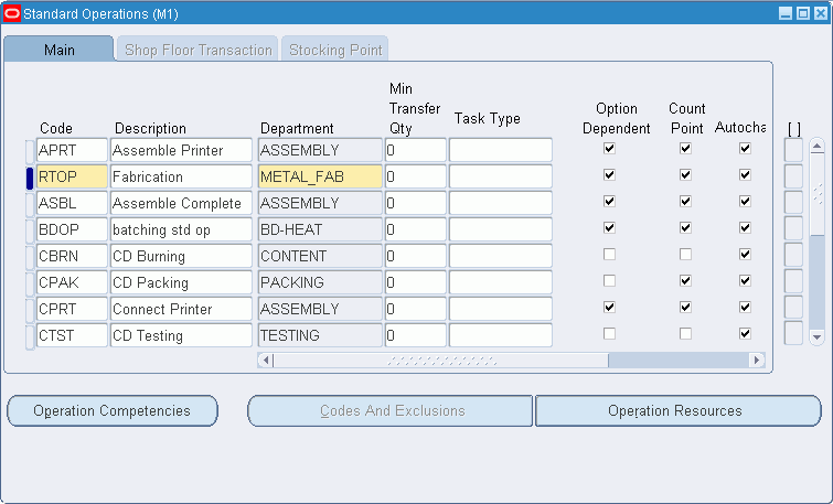

Standard Operation
A standard operation is a commonly used operation that you define as a template to default operation information when you define routings. When you define a new operation on a routing, you can specify a standard operation whose information Bills of Material copies into the operation you are currently defining. You can then change any of the copied information for the new operation. See: Creating a Standard Operation.
Setup Standard Operation
A setup standard operation is the same as a standard operation except that it defines an operation used for setting up machine type resources only. Use the setup standard operation to specify the operation used during changeovers. See: Defining Resource Setup Information.

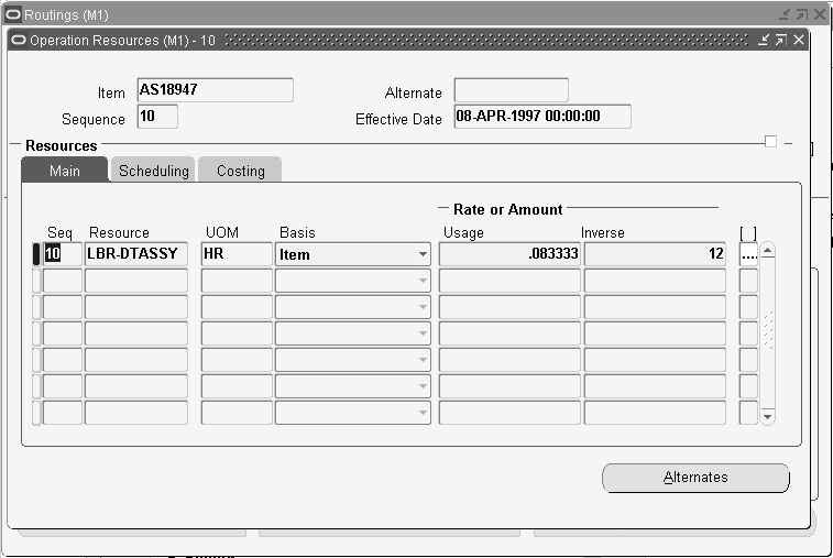

Resource Usage
You can associate multiple resources with an operation on a routing. For each resource, you can determine if you want to include that resource in scheduling and lead time calculations. You can also collect costs for a resource on a routing if you specified the resource as a costed resource. See: Defining a Resource. If a resource is unavailable, you can define alternate resources. An alternate resource can be a single resource or a set of resources.
Resource parents and resource sets are used to group similar resources. Routings can then be defined with their general resource requirements, while WIP lots are tracked with the usage of the specific resources. While a resource can belong to several resource sets, a resource can only belong to one parent resource. When a WIP lot is at an operation with a parent resource or resource set attached to it, you are prompted to enter a valid resource used in processing the WIP lot.

Resource Usage Rate or Amount
The usage rate or amount is the amount of the resource consumed at the operation, either the quantity per item or per lot. If you assign more than one resource unit to work at an operation, Work in Process considers the number of units when scheduling a resource at an operation. (Assign the usage rate for the resource as the total quantity per item or lot, regardless of the number of resource units you specify.) For example, if you define a machine resource to require 10 hours per item and you assign 2 resource units to the resource, Work in Process automatically schedules 2 machines for 5 hours.

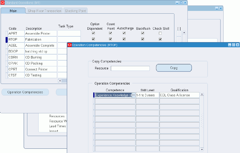

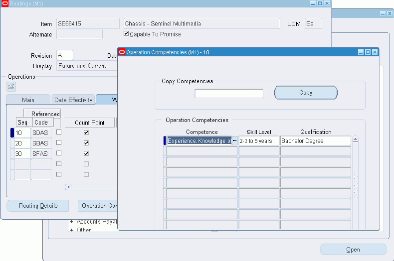

Labor Skill Validation
You can define competencies for a resource to perform a particular operation. Labor Skill Validation ensures that job operations are performed by competent operators who have the required qualifications, competencies and certifications. This prevents potential errors and issues that arise from incompetent operators performing job operations.

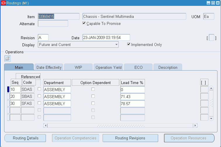

To create a routing
  1. Navigate to the Routings window.
    the picture is described in the document text
    Note: If your current responsibility does not include the Privilege to Maintain security function, you can only view routing information. If so, enter selection criteria in the Find Routings window and choose the Find button. The Routings Summary folder window appears.
  2. Enter a manufacturing item for which you will create a routing.
  3. If you are creating an alternate routing, enter an alternate. For a primary routing, do not enter an alternate. See: Primary and Alternate Routings.
  4. If you are updating an existing routing, enter the routing revision and the effective date.
    To update the revision, choose the Routing Revisions button to open the Routing Revisions window. See: To create or update a routing revision.
  5. If you would like this routing to be capable to promise, then select the Capable to Promise checkbox. See: Capable to Promise (CTP), Oracle Master Scheduling/MRP User's Guide.
    Note: Capable to promise describes an available to promise calculation that considers both available material and capacity of manufacturing and distribution resources. You are able to define one and only one CTP routing for each item.
  6. Select a display option to display All, Current, or Future and Current operations effective as of the revision date you specify.
    To enter completion subinventory and locator information, or view a common routing, choose the Routing Details button to open the Routing Details window. See: Completion Subinventory and Locator.
  7. Enter the operation sequence, or let the system automatically generate it for you, according to your profile setup. See: Item and Operation Sequence Fields.
  8. To copy or reference standard operations into a routing, use the Operation Code list of values. You can define a new standard operation by selecting Standard Operations from the Tools menu.
    If you use a standard operation code, the operation information for that code will be copied into the operation you are currently defining. You can then update that information as desired. See: Creating a Standard Operation.
    Tip: You can assign the same standard operation to more than one operation sequence within the same routing.

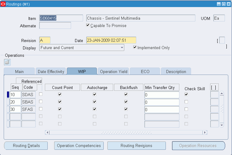

    The Routings window has five tabbed regions: Main, WIP, Date Effectivity, Operation Yield, ECO, and Description.
  9. Enter the department in which the operation is performed.
  10. For operations in ATO model or option class routings only, indicate whether the operation is option dependant, that is, whether the operation is dependant on the choice of an optional component. All mandatory components and their related operations appear on the routing for each configuration. The default is enabled. See: Overview of Configure to Order.
  11. Optionally, enter the item's manufacturing lead time percent required to complete all previous operations on the routing. See: Calculating Lead Times.
    If the manufacturing lead time equals 10 days and all previous operations combined require 2 days, the lead time percent is 20%.
  12. Open the Date Effectivity tabbed region and enter an effective date range. See: Effective Date Fields.
  13. Open the WIP tabbed region and select Count Point and Autocharge options. See: Count Point and Autocharge. See: Charge Type.
    Indicate whether to backflush components on shop floor moves at this operation. A backflush transaction automatically pulls Operation pull components from inventory. Work in Process also pulls all Operation pull components at non-backflush operations preceding this operation (through the previous completed backflush operation.) See: Backflush Transaction Options, Oracle Work in Process User's Guide.
    Enter the minimum transfer quantity of assemblies to move from this operation to the next. Work in Process will warn you if you attempt to move a number less than this value. If you used a standard operation, this value defaults to minimum transfer quantity defined for the standard operation. Otherwise the default is 0.
  14. Open the Operation Yield tabbed region. You can define routing networks for Standard, Flow, and Lot-based routings.
    If the routing is standard or lot-based, then the Yield, CUM Yield, Reverse CUM Yield, and Include in Rollup fields will display. To enable Operation Yield in Shop Floor Management, enter expected operation yields for each operation listed. For example, enter 0.9 for a 90% yield. These fields are displayed for Shop Floor Management enabled organizations.
  15. Indicate whether the operation yield is to be considered in the cost rollup, as required by the costing team.
  16. Open the ECO tabbed region and verify the following:
    The Implemented check box indicates whether the component is implemented.
    Checked: Operation is on a pending Engineering Change Order (ECO)
    Unchecked: Operation is on implemented ECO or was added directly to the routing
  17. Open the Description tabbed region and enter a description of the operation.

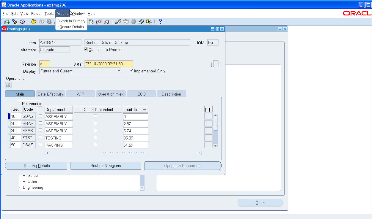

To switch between a primary and alternate routing
From the Routings window you can switch between Primary and Alternate routings.
  2. Perform a query to display the alternate routing which you would like to switch to the primary routing.
  3. Choose the Actions menu and select Switch to Primary.
    Note: Switch To Primary option appears in Actions menu.
  4. After the switch is completed a message will appear confirming the switch. Choose OK.

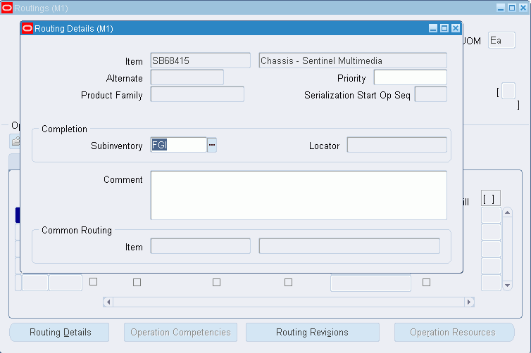

To assign a completion subinventory and locator
  1. Navigate to the Routing Details window. You can do this by choosing the Routing Details button from the Routings window.

To begin using serial number tracking at an operation
The Serialization Start Op Seq flag in the Routing Details window indicates that item tracking with serial numbers begins at this particular operation. This enables you to track items using serial numbers prior to the completed transaction. See: Viewing Serial Genealogy, Oracle Inventory User's Guide.
  2. In the Serialization Start Op Seq field, enter the operation sequence number where you want to begin tracking items with serial numbers.
    Important: You must check this field to use serial number tracking for Oracle Work in Process transactions. See: Serial Number Tracking Throughout Manufacturing, Oracle Work in Process User's Guide.
To define competencies for performing routing operations
  2. Query on the manufacturing item’s routing.
  3. Select the Check Skill check box for the operation sequence for which you would like to define the competence.
  4. Click on the Operation Competencies button.
    Operation Competencies button will be enabled only when you select Check Skill check box.
  5. Select the Competence level for the operation sequence.
    Based on the Competence selected, the skill level values for the selected competence appear in the drop down menu of the Skill Level field.
  6. Enter the skill level.
  7. Enter the qualification required for the competence.
  8. Save your work and close the Operation Competencies window.

To assign a resource to a routing operation
  1. Navigate to the Operation Resources window. You can do this by choosing the Operation Resources button from the Routings window.
  2. Enter the sequence number of the resource and the resource name. You can use any resource assigned to the department. Valid values for sequence range from 1 to 9999999 and must be unique for the operation.
  3. Select a basis type by which to charge and schedule the resource. The default is the basis specified for the resource.
    Item: Charge and schedule the resource by multiplying the usage rate by the job or schedule quantity for the assembly. Select Item when your charges fluctuate with quantity change.
    Lot: Charge and schedule the resource by charging the usage rate or amount once per job or schedule. Select Lot when your resource usage quantity is the amount required per job or schedule, for example, setup charges.
  4. Enter a value for the Rate or Amount in either the Usage or Inverse fields. That is, enter the resource consumed at the operation (per item or per lot) or it's inverse. Entering a value for either field updates the other field.
    Resources with time-based unit of measures must have usage rates greater than zero.
    Enter an inverse when you know the number of units a resource can process (rather than the duration an assembly unit consumes the resource. For example, if you know a resource can process 10 units per hour, enter 10 for the inverse.
    Usage or Inverse can be negative only for resources that cannot be scheduled and where the charge type is neither PO move nor PO receipt.
  5. Open the Scheduling tabbed region and enter the Schedule Sequence Number. Two or more resources can be scheduled to be working concurrently within the same job operation. Simultaneity is implemented by having more than one resource with the same Schedule Sequence Number.
    Note: The Schedule Sequence Number field is independent of the resource sequence, which is used only as part of the primary key to list the resources. The Schedule Sequence Number shows the actual sequence of each resource used in the operation.
  6. Optionally, enter the Substitute Group Number.
    Resources with the same substitute group number are substituted together with alternate resources that have the same substitute group number as the operation resource and the same replacement group number. See: Alternate Resources for an explanation of using the Substitute Group Number field when defining alternate resources.
  7. Enter the number of assigned units to the resource. See: Resource Usage.
  8. If the unit of measure of the resource is time-based, select a schedule value. See: Schedule and Defining a Resource.
    Caution: When defining either primary or alternate resources within the same Schedule Sequence Number, you must set the Schedule field value for the next resource to:
  9. o
    Enter the resource ffset percent within this routing.
    For example, a value of 50 means that you utilize the resource when the routing is half completed. This value is automatically calculated when you compute the lead time for the assembly.
  10. Indicate which resource is the principle resource, within a group of simultaneous resources.
    Users can schedule two or more resources to work concurrently within the same routing operation by having more than one resource with the same schedule sequence number. The Principal Flag defines which resource to use first when there is a choice. Similarly, when defining alternate resources, you must define one of the alternates as the principal substitute resource within a replacement group. Although you can have many replacement groups, you can only designate one principle resource per replacement group.
  11. Open the Costing tabbed region and enter an activity to perform when you use the resource. Use activities to group resource charges for cost reporting. The default is the activity associated with the resource. See: Defining Activities and Activity Costs in Oracle Cost Management User's Guide.
  12. Indicate whether to charge jobs or schedules based on the standard rate defined for the resource (default).
    Off: Use this option if you import charges from an outside labor system and want to record actual costs, or to record the labor rate of an employee.
    On: For outside processing resources, if you charge a job and repetitive schedule at the standard rate, Oracle Purchasing computes any purchase price variance and posts it to the rate variance account.
  13. Select a charge type. The default is the charge type specified for the resource. See: Charge Type.
  14. Select the Alternates button.
    Optionally, you can define substitute resources for each primary resource group defined. This enables you to specify resource sequences that can replace the primary resource group.
  15. Enter the substitute resource name.
    This is one of the resources that may replace the resource group.
  16. Enter the Replacement Group.
    This is used to group substitute resources together, to substitute a resource group. See: Alternate Resources under Resource Usage for an explanation of using the Replacement Group field when defining alternate resources.
  17. Select a basis type by which to charge and schedule the resource. The default is the basis specified for the resource.
  18. Enter a value for the Rate or Amount in either the Usage or Inverse fields. That is, enter the resource consumed at the operation (per item or per lot) or it's inverse. Entering a value for either field updates the other field.
Standard operations are commonly used operations you can define as a template for use in defining future routing operations. If you assign the operation code of standard operation in a routing, the standard operation information is copied into the operation you are currently defining. You can then modify the operation information in your new operation.
You can also create setup standard operations that are used only when setting up machine type resources. When defining resource setup information (see: Defining Resource Setup Information), you have the option of specifying the standard operations used during changeovers.
Prerequisites
To create a standard operation

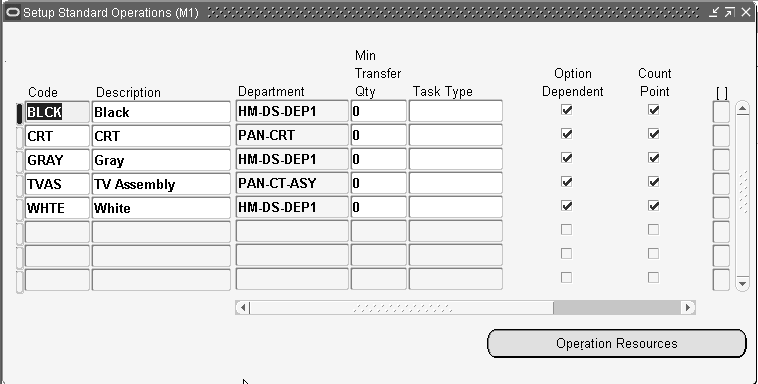

  1. Navigate to the Standard Operations window.
  2. Enter a unique operation code to identify a standard operation.
    Note: If Oracle Warehouse Management is installed, the Standard Operations form is used to define which resources of a given department are required in order to perform a warehouse task. Oracle Warehouse Management refers to standard operations as Task Types. The rules engine uses the Code defined for the Standard Operation to reference the Task Type. A bulk picking task may require a forklift machine and a pallet picker manual resource. Oracle Warehouse Management uses a rules based system to determine the task type, or standard operation, each task should be associated with. Tasks of a given type are then dispatched to users associated with the resource definition, who have the qualified equipment for the task available to them. See: Set Up Warehouse Task Types, Oracle Warehouse Management Implementation Guide.
  3. Enter the department where the operation is performed.
  4. Enter the minimum transfer quantity of assemblies to move from this operation to the next.
  5. For operations in ATO model or option class routings only, indicate whether the operation is option dependant, that is, whether the operation is dependant on the choice of an optional component. All mandatory components and their related operations appear on the routing for each configuration. The default is enabled. See: Overview of Configure to Order.
  6. Select your Count Point and Autocharge options. See: Count Point and Autocharge.
  7. Indicate whether to backflush components on shop floor moves at this operation.
  8. Select the Check Skill option to enable check skill.
    If the Check Skill option is selected, then you have to capture the requirement for skill check.
    Tip: The value in this check box is only a default value in routing and can be overridden in the Routing window.
  9. If you are creating operations for a Shop Floor Management enabled organization, see: To create a standard operation for a Shop Floor Management enabled organization. If not, choose the Operation Resources button to assign resources to the standard operation. See: To assign a resource to a standard operation.
    1. To enable operation yield in Shop Floor Management, enter the Yield for each operation listed. The valid values range between zero and one. This field is displayed for Shop Floor Management enabled organizations.
    2. Indicate whether this operation yield needs to be considered in the cost rollup, as required by the costing team. This field is displayed for Shop Floor Management enabled organizations.
    3. Select the Shop Floor Transaction tab and select the following fields, if appropriate. See: Oracle Shop Floor Management User's Guide for information about each field. This tab is enabled for Shop Floor Management enabled organizations.
      • Lowest Acceptable Yield
      • Use Organization Settings
      • Queue Mandatory Flag
      • Run Mandatory Flag
      • To Move Mandatory Flag
      • Show Next Operation by Default
      • Show Lot Attributes
      • Show Scrap Codes
    4. Optionally, select the Stocking Point tab and enter the default subinventory and locator for the standard operation.
    5. Optionally, choose Codes and Exclusions to enter Bonus Codes, Scrap Codes, and Responsibility Exclusions for a Shop Floor Management enabled organization.
    To define operation competencies for standard operations
    Use the Operation Competencies window to enter the competencies required for carrying out the operation. You can add the competency for a resource only once and you cannot enter duplicate records in the operation competency set.
    For standard operations and routing, the Check Skill option will remain unchecked when imported. For discrete jobs created through the interface, the job operations will have competencies and check Skill values inherited from the routing. While adding standard operations through the interface the values for Check Skill and competencies will be inherited from standard operation.
    Competence and Skill Level are related fields. The Skill Level field is enabled if you enter value in the Competence field and tab out and the Skill Level will have the values relevant to that Competence.
    The competencies defined in the resource definition are added to the operation by selecting the assigned resources in the list of values and clicking the Add button.
    1. Navigate to the Operation Competencies window by choosing Operation Competencies from the Standard Operations window.
    2. Create a standard operation.
    3. Select the Check Skill check box.
      The Operation Competencies window opens. Based on the Competence selected, the skill level values for the selected competence appear in the drop down menu of the Skill Level field.
    5. Enter the skill level.
    6. Enter the qualification required for the competence.
    7. Save your work and close the Operation Competencies window.

    1. In the Standard Operations window, choose the Operation Resources button to assign resources to the standard operation. See: To assign a resource to a routing operation.
      Caution: To assign resources to the standard operation, follow the same steps as you would to assign a resource to a routing operation with one exception. When assigning resources to a standard operation, the Schedule Sequence Number field in the Resources window, Scheduling tab does not exist. If you use the Schedule Sequence Number functionality, you must manually update this field when adding a new operation to a routing using the Standard Operations window.

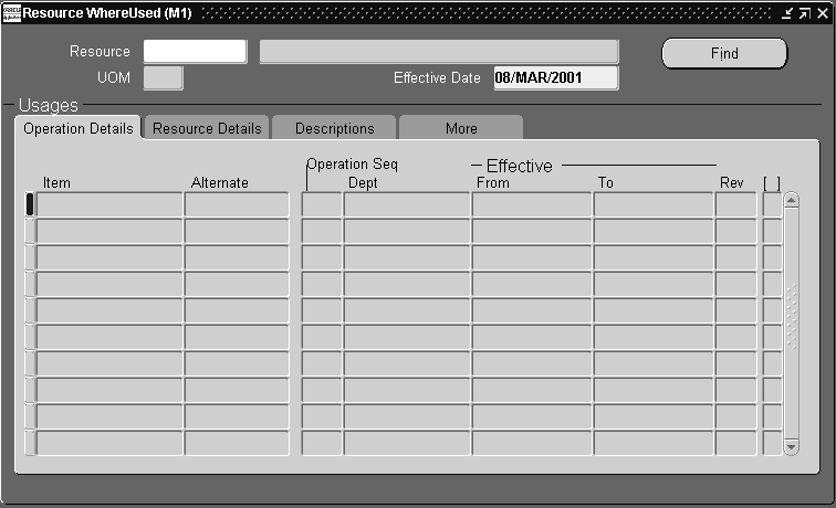

  1. Navigate to the Resource WhereUsed window.
  2. Enter the name of the resource for which to view the operation and routing usage.
  3. Enter an effective date. Operation information effective on this date is displayed.
    The Resource WhereUsed window contains four tabbed regions: Operation Details, Resource Details, Descriptions, and More.

Work in Process does not default the operation. You can still record movements into, out of, and through the operation by overriding the default in Work in Process.
Count Point on / Autocharge on
Assign this count point to operations you want to automatically default as destination operations in the Move Transactions window. You should always assign this count point to the final operation in a routing, to insure that you record move transactions into the operation, and then record completion transactions.
You can automatically complete and charge operations in a routing with this count point. Work in Process automatically completes an operation and charges its WIP Move resources to your job or schedule when you record a move transaction through or beyond the operation.
For operations that you always perform in a routing, you can also monitor assembly moves into, out of, and through the operation. For example, choose this count point for critical, time-intensive, or bottleneck operations.
Schedule Field
Charge Type Field
You can determine how each resource is charged in Work in Process. When an operation completes, Work in Process records the units applied to the job or repetitive schedule in the resource unit of measure. You can charge resources manually or automatically.
