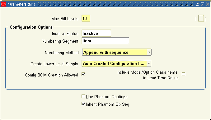

The following table lists the fields in the BOM Parameters form that are relevant to configurations.
| Field Name | Value | Usage Notes |
| Create Lower Level Supply | You can choose one of the following values: No Auto-created Configuration items only ATO items and Auto-created Configuration Items | This parameter is used to indicate whether or not the system should create supply for lower level configurations and ATO items when progressing an order online in order management, or when using the Autocreate FAS batch program. If set to No, the system will create supply only for the top-level ATO item or configuration. This is the default value for this parameter. If set to Auto-created Configuration items only, the system will create supply for any lower level configuration that was generated because of the specific sales order configuration. Note that it will not create supply for any lower level configuration that was matched to a preconfigured item. If set to ATO items and Auto-created Configuration Items, the system will create lower level supply for all ATO items, preconfigured items and autocreated configured items. Note that supply will be created even for ATO items setup as standard mandatory components on the model bill. This option should be used only if you do not expect to have on hand for your ATO items and preconfigured items. |
| Inactive Status | The list of value consists of all the item statuses that are defined in the system. | The Deactivate Configuration Items program sets item status of configuration items to this value. |
| Numbering Segment | The list of value consists of all the item segments. | The item field is a flexfield that may contain multiple segments. Let's say you have a two-segment item field. The two segments are Item-Group. Item, Group will show up in the LOV. The segment you choose here will be the field that the Numbering Method applies. Note: The numbering segment parameter must be set in the OE validation organization. The setting in all other organizations will be ignored |
| Numbering Method | You can choose one of the following values: Append with sequence Replace with sequence Replace with order, line number, shipment # User defined | Using the preceding example, let's say you choose the Item segment in the Numbering Segment. For an ATO model CN97444-Laptop, the configured item number will be the following for each Numbering Method: CN97444*1236-Laptop 1236-Laptop 45623*1*1-Laptop (45623 is the sales order number, 1 is the line number, 1 is the shipment number.) User defined: You can use the user-defined method to generate customized numbering for configuration items. You can use the customized method to implement in packages, BOMCFGI.pls and CTOCUCNB.pls. For details on how to use these packages, see: See Custom CTO Packages. Note: The numbering method parameter must be set in the OE validation organization. The setting in all other organizations is ignored. |
| Config BOM Creation Allowed | You can optionally clear this check box to set this parameter to No. By default, this check box is selected (set to Yes). | Set the check box to Yes in all organizations in which you plan to manufacture or purchase your configurations. It can be set to No in other organizations where a model BOM exists, but a config BOM is not necessary. For example, an OM validation organization that is not a manufacturing organization can be set to No. |
| Include Model/ Option Class Items in Lead Time Rollup | You can optionally select this check box to set this parameter to Yes. By default, this check box is cleared (set to No). | This parameter determines if a lead time rollup is performed on the model and option class items in the organization. This defaults to no, as rolling up a lead time on the model or option class results in a highly inflated model lead time, which affects the "Estimated manufacturing start date" calculation in AutoCreate Configuration, and affects the offset used by planning with Planning to Forecast and used by ATP against the model. |

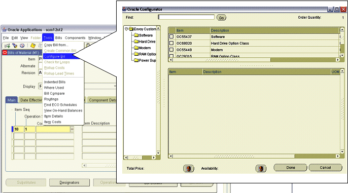

In order to preconfigure items using BOM, this profile must be set to the proper URL for the configurator in your instance. See Preconfiguring Items

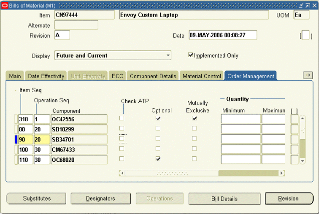

BOM: Inherit Option Class Operation Sequence Number
This profile controls whether components within the model structure inherit the operation sequence from their parent option class or model. The list of values is Yes or No. When the profile is set to Yes, Bills of Material applies inheritance logic for all items in the model structure with an operation sequence defaulted to 1.
In the following example, the profile option is set to Yes, and the CPU and Monitor option class items have operation sequence numbers for the Laptop Computer routing. The processor options are defaulted to an operation sequence of 1, and inherit operation sequence 30 from the CPU option class item. The VGA Option class, options and included item are defaulted to an operation sequence of 1, and then inherit operation sequence 40 from the manual option class item. Routings are not required for the CPU, Monitor, and VGA option classes.
| Level | Item | Item Type | Op Seq | Operation Sequence Inherited |
| . 2 | . Laptop Computer | ATO Model | ||
| . . 3 | . . CPU | Option Class | 30 | Retains 30 |
| . . . 4 | . . . Pentium I | Option | 1 | Inherits 30 |
| . . . 4 | . . . 486 Processor | Option | 1 | Inherits 30 |
| . . 3 | . . Monitor | Option Class | 40 | Retains 40 |
| . . . 4 | . . . VGA | Option Class | 1 | Inherits 40 |
| . . . . 5 | . . . . VGA Manual | Included Item | 1 | Inherits 40 |
| . . . . 5 | . . . . VGA1 | Option | 1 | Inherits 40 |
| . . . . 5 | . . . . VGA2 | Option | 1 | Inherits 40 |

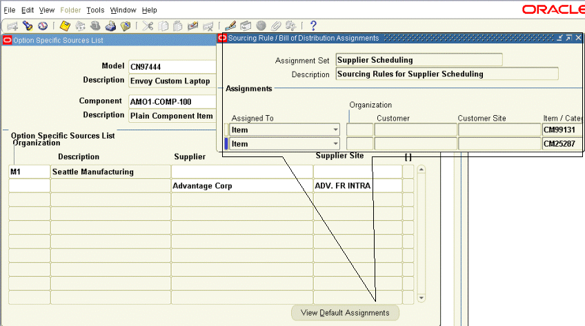

For option specific sourced (OSS) items, the organizations in which BOMs are created are further restricted by OSS rules. See: Impact of Option Specific Sources.

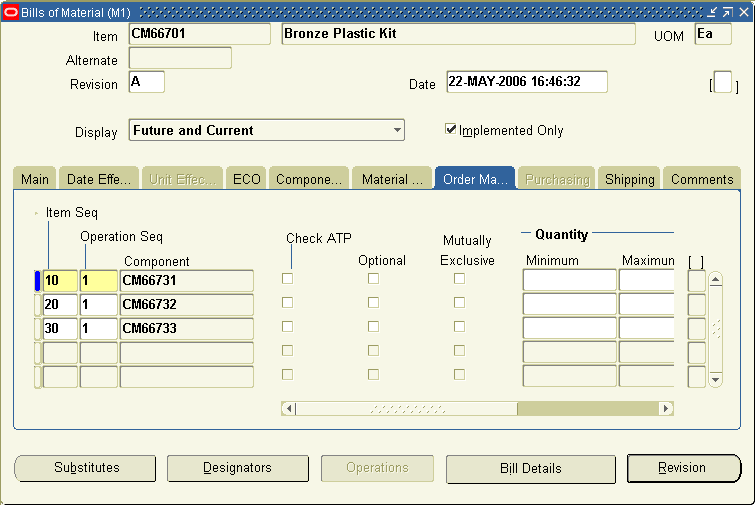

The following BOM attributes are important for model or option class bills of material:
Maximum and Minimum Quantity: For each option, you can specify a quantity range that limits the quantity of the option you can order during Order Management.
Optional: The Optional attribute is applicable only to component items on model and option class bills of material. If this attribute is not selected for an option, the option will not appear in the configurator, or in the OM options window. However, it will l be chosen automatically when you choose an optional item from the same model or option class. If this attribute is not selected for an option class, you are required to select at least one of the options from its bill of material.
Mutually Exclusive: The Mutually Exclusive attribute is only applicable to option class items. If this box is selected, you are allowed to select only one option from the option class bill of material.

Invoke Oracle Configurator from within Oracle Bills of Material to create a configured bill of material and routings for a predefined ATO item. This is useful in a business to business environment where the same configuration is ordered repeatedly. Preconfigured items can be built to forecast and kept on hand. Customers can order the preconfigured items directly, as they would a standard ATO item.

Option specific sourcing allows you to restrict the sourcing of a configuration based on a specific option or options that are ordered. For example, you may have a model that can be manufactured in three organizations. But if a specific option is chosen, it can be made only in one of the three, as they have the specialized machinery to build it.
If you have restricted options, specify the list of valid organizations and vendors where the model can be manufactured, stocked, transferred or procured, if that option is chosen. This list of organizations is overlaid with the model sourcing chain, during the ATP and Autocreate configurations processes, to restrict the sourcing of a specific configuration based on the options that were chosen. See: Impact of Option Specific Sources for more information.
This section is intended to give you a feel for situations in which you may need to setup option specific sourcing for your models:
OSS setup is not required
There are three organizations, set according to regions of the world:
Japan Org
US Org
Europe Org
The model is a Make item in all three, but the BOM in each is different, and contains only options pertinent to its respective region.
For previous releases, you manually chose the warehouse on the sales order based on where the order originated (or used OM defaulting rules to do so). In this case, CTO creates the BOM only in the org against which the order is placed. This is still true if the model's Create Configuration Item, BOM attribute is set to Based on Sourcing (the default). No further set up is required.
You can use this attribute even if you are doing PDS based ATP with matching, because the ship from organization is always defaulted, and there is no variation in sourcing once that organization is picked. No OSS setup is required.
OSS setupis required
The ATO model can be made in any of six manufacturing organizations, and you want the choice of the manufacturing organization to be based on GOP, rather then simple defaulting rules. However, if the customer chooses a specific option (for example a specific specialty coating for the product) it can only be made in Org1. Match is used on this model.
For 12.0, if you want to use GOP to pick the warehouse or want to match during ATP, the model's Create Configuration Item, BOM attribute must be set to Based on Model so that the item, BOM, and routing are created in all six manufacturing organizations, and future matches to the configuration item are valid and ATPable in all six manufacturing organizations.
If you do not set up OSS for the model with the specialty coating, CTO attempts to create the bill for these configurations in all six organizations no matter which one is shipping the material. Because the speciality coating option does not exist on the model BOMs in organizations 2-5, autocreate configuration completes with a warning and puts the order on hold for all sales orders with this option.
To avoid this, set up OSS for the Model with the specialty coating as a component to restrict ATP to choose only Org 1, and to restrict the BOM creation for that item to Org1.
This is required even if you are not using ATP or APS.
To set up option specific sourcing
Navigate to Advanced Planning, Source Instance Setup, Sourcing, CTO Option specific sourcing.
In the header, enter the following:
Model Name: List of values contains all ATO models in your item master
Component Name:List of values that contains all active items in the system. You should pick only options, options classes or sub-models that are components of the parent model specified
If an option is specified, the sourcing chain for a configuration with that option will be limited to the organizations and suppliers listed in the setup
If an option class is specified, the sourcing chain for a configuration with that option class chosen is limited to the organizations and suppliers listed in the setup. If there is setup for both an option class and an option underneath it, an intersection of the specified sources is taken to determine the valid sources for the configuration.
If a sub model is specified as a component, any configuration that has that sub model is restricted to the organizations specified in the setup.
Note: If the sub model is phantom on the parent models bill in the OM validation organization, it is treated as an option class for the purposes of OSS processing.
In the child form, enter list of organizations and supplier/supplier sites that are valid parts of the sourcing chain for this model and component combination. Valid parts of the chain are anywhere this model with this option can be can be manufactured, stocked, transferred or procured:
Organization: List of values contains all organizations in your system in which the model is enabled
Supplier:List of values contains all vendors in all operating units
Supplier Site:List of values contains all vendor site code. Note that the LOV displays the vendor code (name) and not the vendor ID, as vendor ID is operating unit specific. This enables you to set up a vendor site once and have it apply to all operating units that use that vendor.
Selecting View Model Assignments opens the assignments form with MRP: Default assignment set data. If the profile is set to Null then the Assignment form opens with no specific assignment in it.
Note: Option specific source lists setup for a model are ignored in cases where that model appears as a phantom on a parent model bill in the OM Validation Organization.
Note: An option specific list defined for a submodel will affect the parent model's available sources if the model appears as a nonphantom in the parent model's bill in the OM validation organization.
For ATP to consider option specific sourcing, any model with option specific sources defined, or any model with child models with option specific sourcing defined must have ATP Components set to something other then None. If this is not done, you could schedule against an invalid organization. If this happens, autocreate config will error out. Components with Option Specific Source lists do not have to be ATPable.

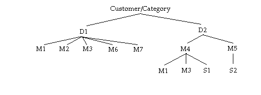

Model1 sourcing:
Model2 sourcing:
| Sourcing rule | Org / Global | Type | Org | Supplier | Alloc% | Rank |
| SR11 | Item | Transfer | D1 | - | 40% | 1 |
| - | - | Transfer | D2 | - | 60% | 1 |
| SR12 | Org D1 | Transfer | M1 | - | 30% | 1 |
| - | - | Transfer | M2 | - | 30% | 1 |
| - | - | Transfer | M3 | - | 30% | 1 |
| - | - | Transfer | M6 | - | 40% | 1 |
| - | - | Transfer | M7 | - | 100% | 2 |
| SR13 | Org D2 | Transfer | M4 | - | 50% | 1 |
| - | - | Transfer | M5 | - | 50% | 1 |
| SR14 | Org M4 | Transfer | M1 | - | 50% | 1 |
| - | - | Transfer | M3 | - | 25% | 1 |
| - | - | Buy | - | S1 | 25% | 1 |
| SR15 | Org M5 | Buy | - | S2 | 100% | 1 |
| SR16 | Item | Transfer | M4 | - | 40% | 1 |
| - | - | Transfer | M5 | - | 60% | 1 |
| Assigned to | Org | Item/ | BOD/SR |
| Customer | - | Model1 | SR11 |
| Model-Org | D1 | Model1 | SR12 |
| Model-Org | D2 | Model1 | SR13 |
| Model-Org | M4 | Model1 | SR14 |
| Model-Org | M5 | Model1 | SR15 |
| Item | - | Model2 | SR16 |

Set up the option specific source lists listed in Table 2–17.
| Model | Component | Org | Vendor | Vendor Site |
| Model1 | O1 | D1 | - | - |
| - | - | D2 | - | - |
| - | - | M4 | - | - |
| - | - | M1 | - | - |
| - | - | M3 | - | - |
| - | - | M6 | - | - |
| Model1 | O2 | D1 | - | - |
| - | - | M2 | - | - |
| Model1 | O3 | D2 | - | - |
| - | - | - | S1 | Ste1 |
| Model1 | O4 | D1 | - | - |
| - | - | M7 | - | - |
| Model2 | O5 | M4 | - | - |
Category or organization level assignments cannot be used for option specific source models, or models that are parents of option specific sourced models. If specified, those rules will be ignored during CTO process. In addition, Region or other assignments that cannot be defined on the source should not be used for option specific sourced models. This means that users of option specific sourcing will be restricted to item-level and customer-item assignments for Global ATP and loop back.
In organizations where you will be purchasing a configuration, you must define explicit buy rules in order for those organizations to be considered as valid organizations during OSS processing.
Defining an item rule for an option specific model, or a parent of an option specific model, will make all the organizations where the model is enabled as valid organizations. To avoid this, you must assign specific Make At or Buy From assignments in the end node of your sourcing chains.
If users set the new model level Create Configuration Item, BOM item attribute to create configuration data based on the model, and they have certain organizations where they build configurations with certain options (and the options are not on the model BOM in those organizations), they must set up option specific sourcing for these options. If they don't, CTO will attempt to create the bill and routing in all valid sources for the model, which could result in all of their sales orders getting put on hold, because some of the selected options didn't exist in some of the model sources.
The model order line is promised by looking at model sourcing rule and the list of organizations specified for the selected option items. In certain setups, a specific configuration for this model may not have a valid source. If this happens, during availability check the user will get an error stating no valid sources exist based on option specific sourcing. To avoid this, the user should create configurator rules to ensure nonvalid configurations are not configured and sent to ATP.
When a configuration is created from a model with option specific sourcing defined, either from a sales order or through Bills of Material, the configuration will be marked as an option specific sourced item. If these configurations are ordered directly on a sales order line, ATP will validate that the ship from organization appears as an explicit organization in the items sourcing tree.
If there is a single, mandatory, mutually exclusive option class that determines the valid organizations, this setup needs to be done only for options in this option class. For example, you sell computers to all parts of the world, but have a single model setup regardless of where you are shipping. Your user is restricted to a specific base computer by the region in which they use the computer. In addition, they will be restricted to certain accessories (keyboards, power supplies, and so on). You always build the computers in the plant closest to your customer (so all Asian computers are built in Singapore, all U.S./Canada computers are built in the U.S., and so on.).
You could setup your option specific rules based on the base unit to restrict the models sourcing to a specific plant. Because this is a mandatory choice, there is no need to also set up OSS for all the accessories.
If there is no single, mandatory option that determines the source, users may want to consider creating a dummy mutually exclusive option class to which they can assign this option specific rule. Otherwise, they will need to set up option specific rules for all the options in the model structure that are not made in all organizations.
If the choice of organization is based on an attribute or a value of an option, you may want to consider creating a dummy option to represent the attribute for OSS. For example, you are selling pipe, and your customers can order a pipe with a length between 2 inches and 20 feet. Anything under 15 feet can be made in all six organizations of your manufacturing organizations, but anything over fifteen feet can only be made in Org6. You can create a dummy option class with two components: Less than 15 feet and 15 feet or greater. This could be selected in the background by the configurator, and used to restrict the sourcing of these items to Org6, and restrict the BOM creation for these items to Org6. If you change the option specific sourcing on a model, you need to run the Update Existing Configurations program before the change will appear on your existing configurations. See Updating Existing Configurations for more information.

If you have assigned your model sourcing rules at the item level, the sourcing rules must have both a supplier, and supplier site and must have both a start and end date. Your blankets do not need effective and disable dates. But if they have them, they must be inside the effective dates on the sourcing rule. The latest blanket is used for the calculation instead of the one defined in the model ASL. This blanket is linked to the new configuration ASL.
If you have assigned souring rules to your model at any other level (for example, item-org), the blanket PO must have both effective and disable dates on the terms tab. Additionally, if you have multiple blankets defined for a single model, the effective dates on all blankets must be the same.
Next, in each requisitioning organization, define global approved supplier, supplier sites for the ATO model that point to the appropriate blanket. These ASLs can point to either a local or a global agreement. See the Define Approved Suppliers Lists section in the Oracle Purchasing User's Guide for more information.
