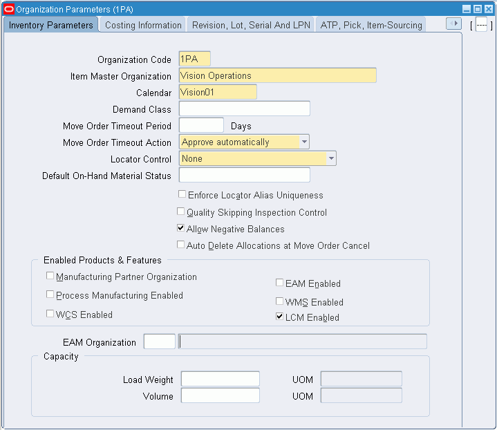

Navigate to the Organization Parameters - Inventory Parameters window.
The Organization Parameters - Inventory Parameters window appears.
In the Enabled Products & Features region of the window, select the LCM Enabled check box.
Note: If you are using Oracle Process Manufacturing, the Process Manufacturing Enabled check box should already be selected for the organization. You will then select the LCM Enabled check box for that organization so that the integration between Oracle Process Manufacturing and Oracle Landed Cost Management can occur.
Note: When the Enable Project Reference checkbox in the PJM Organization Parameters Form is checked, the LCM Enabled flag in the Inventory Organization Parameters form cannot be checked.

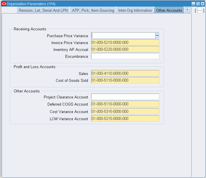

Navigate to the Organization Parameters - Other Accounts window by selecting the Other Accounts tab.
The Organization Parameters - Other Accounts page appears.
In the Other Accounts region of the page, enter a LCM Variance Account.
Save your work.

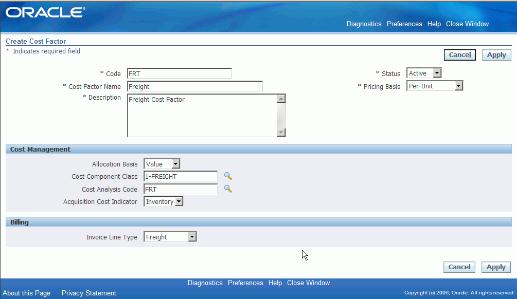

Navigate to the Cost Factors page.
The Cost Factors page appears displaying all of the cost factors.
Click Create.
Create Cost Factor page
The Create Cost Factor page appears.
Enter the code for the cost factor in the Code field.
This code will appear in the Charge Type list of values in the Shipments Workbench.
Select Active for the Status.
Landed Cost Management only uses cost factors with an active status for charge line creation.
Enter a name for the cost factor in the Cost Factor Name field.
Select the basis for pricing using the Pricing Basis field.
Per-Unit appears by default for the pricing basis.
Enter the description for the cost factor in the Description field.
In the Cost Management region, select the Allocation Basis for the cost factor. Options are:
Quantity
Value
Volume
Weight
Landed Cost Management supports all of these basisses for allocation. The allocation basis is used to prorate the charge amounts to the items on the Landed Cost Management shipment.
Note: If the Allocation Basis is blank, Landed Cost Management defaults the allocation basis to Value.

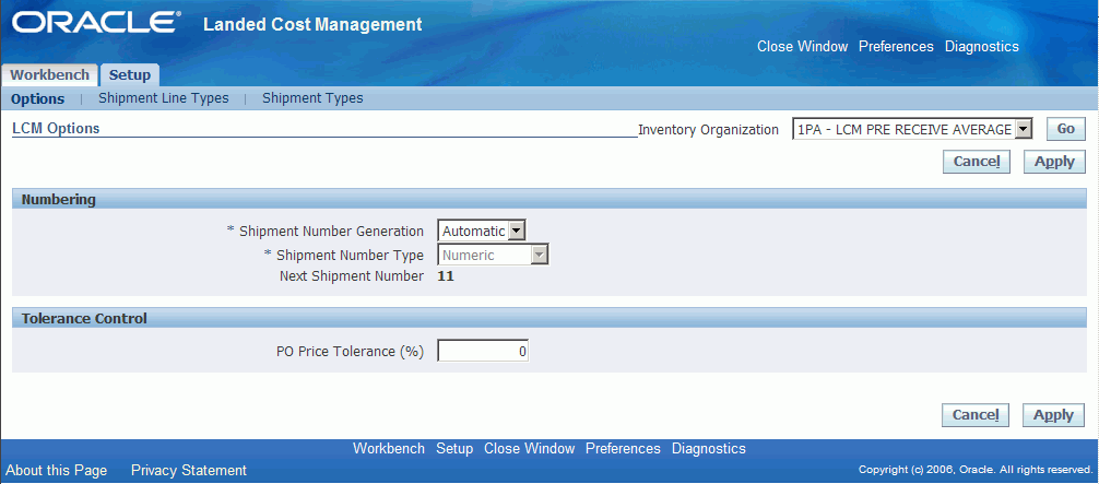

Setting up Landed Cost Management options is a mandatory step before using the Landed Cost Management application. Landed Cost Management options define the numbering behavior and tolerances control for Landed Cost Management shipments.
Use this procedure to set up Landed Cost Management options:
To Set Up Landed Cost Management Options
Navigate to the LCM Options page.
The LCM Options page appears with only the Inventory Organization field available for selection.
Select an Inventory Organization and click Go.
Only the inventory organizations that have LCM enabled appear for selection.
LCM Options page
The Landed Cost Management options display for the inventory organization you selected.
Select how the shipment number will be generated for a Landed Cost Management shipment in the Shipment Number Generation field. Options are:
Automatic
Use this option when using Landed Cost Management as a Service.
Manual
Use this option when using Landed Cost Management as a pre-receiving application.
If Manual is selected for the Shipment Number Generation, then select a Shipment Number Type. Options are:
Alphanumeric
Numeric
The system defaults Numeric as the Shipment Number Type for automatic shipment number generation.
In the case of automatic shipment number generation, the system will start the numbering at "1" and will display the next shipment number that will be created in the Next Shipment Number field.
Enter a price tolerance percent in the PO Price Tolerance (%) field.
Land Cost Management provides a consolidated tolerance control for the purchase price entered in Landed Cost Management (equivalent to the quantity tolerance for a receipt in Receiving). Prices out of the tolerance interval are rejected.
Click Apply to save your work.
