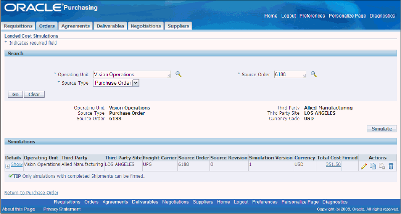

Using the Landed Cost Simulations page, you can search for a purchase order for which to create a simulation.
Use this procedure to create a landed cost simulation:
To Create a Landed Cost Simulation:

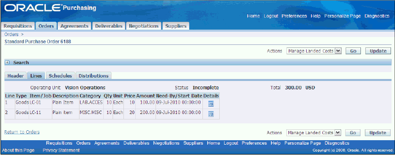

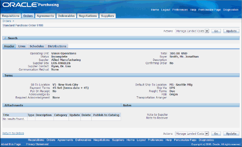

Navigate to the Create or Update Standard Purchase Order page for the desired PO.
Please refer to the Oracle Purchasing User’s Guide for additional information on how to create Purchase Orders.
From the Actions menu, select Manage Landed Costs and click Go to display the Landed Cost Simulation page.

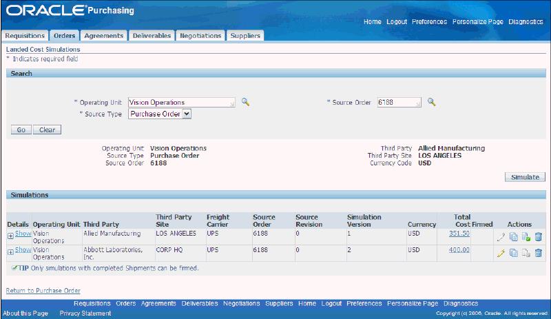

The Purchase Order information is automatically defaulted to the Landed Costs Simulations page.
Click the Simulate button. In the Simulations region, you can view the simulation information derived from the PO in the following columns:
Operating Unit
Third Party
Third Party Site
Freight Carrier
Source Order
Source Revision
Simulation Version Currency
Total Cost
Firmed
Actions

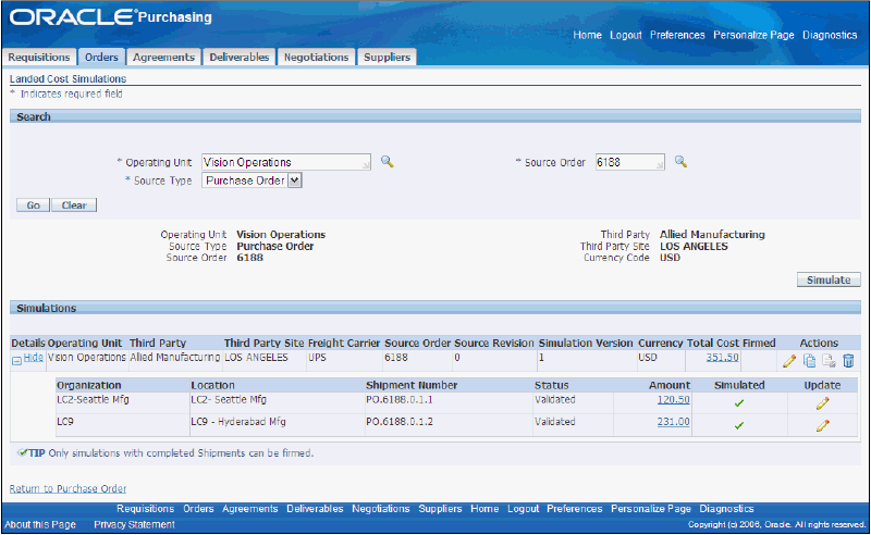

Click the Show link in the Details column to display details of the purchase order. The following columns are displayed for each line of the order:
Organization
Location
Shipment
Number
Status
Amount
Simulated
Update

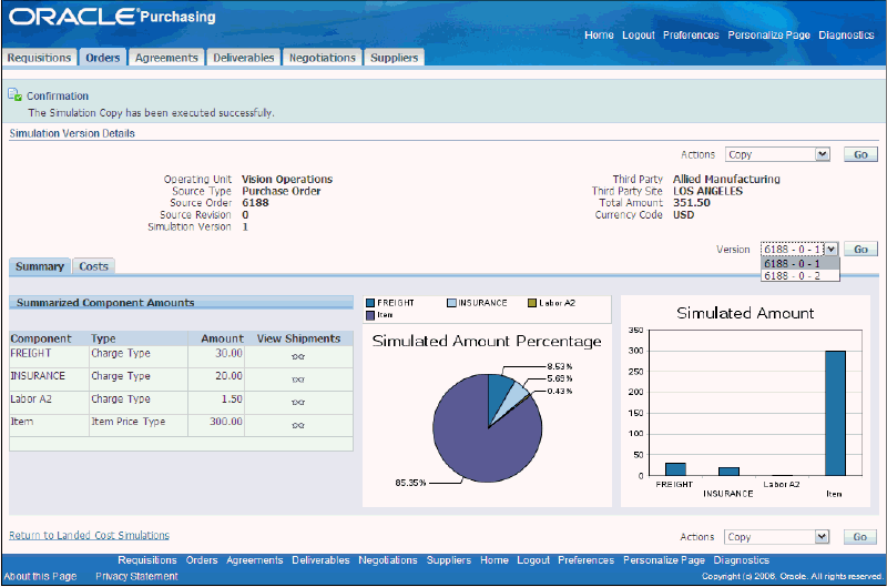

Navigate to the Simulation Version Details page. Click the Total Cost link. On this page, under the Summary tab, you can view simulated component amounts and charts representing simulated amount percentages (pie chart) and component amounts (bar graph).

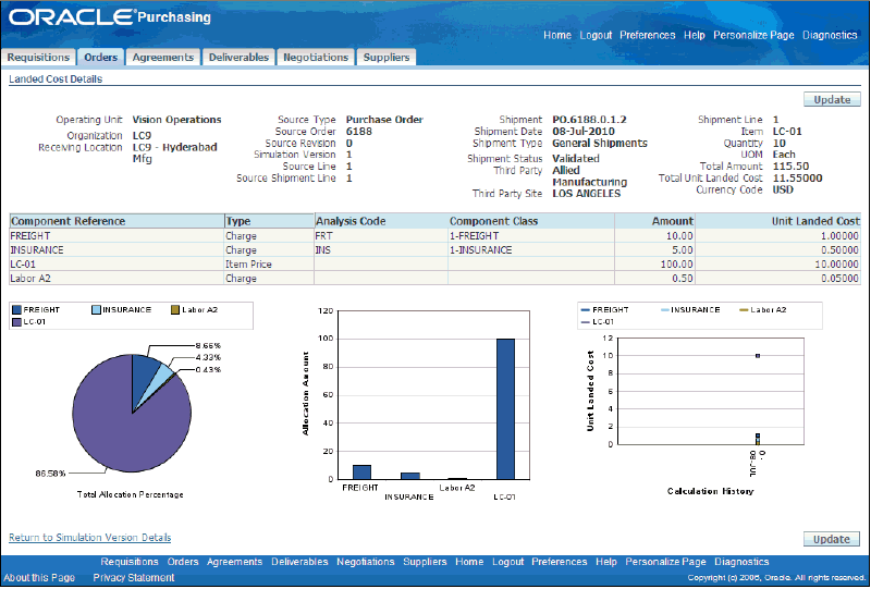

Click the Show icon for each Source Line to view details of the summarized landed costs.
For each Source Line, the following information is displayed:
Source Price per Item
Quantity
Total Amount including all components (for example, freight, insurance, labor)
Unit Landed Cost
In the details row, the following information is displayed for each shipment line:
Source Shipment Line Number
Shipment Number
Organization Name
Organization Location
Quantity
Unit Landed Cost

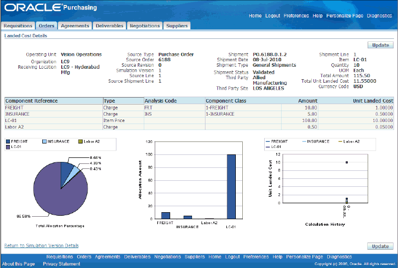

Click the Update icon for a Shipment Line to display Landed Cost Details for this Shipment.
Landed Cost Details page

Navigate to the Landed Cost Simulations page and click the Simulate button.

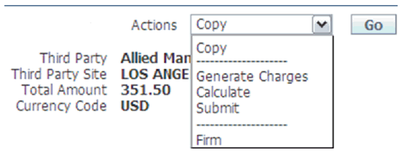

To copy the data from an existent Landed Cost simulation version into a new one
From the Actions menu on the Simulation Version Details page, select Copy and Click Go.
From the Version Menu, select Version 2 and click the Go button.

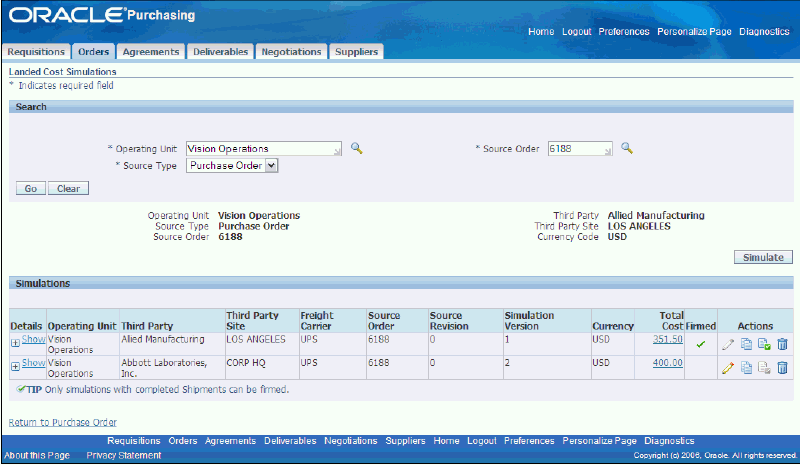

To update the simulation version information
LCM allows you to modify the simulation version information such as third party and freight carrier information in order to determine the most cost effective solution.
On the Landed Cost Simulations page, in the Actions column for Version 2, click the Update icon.
On the Update Simulation Version page, query the desired Third Party name and click Apply.

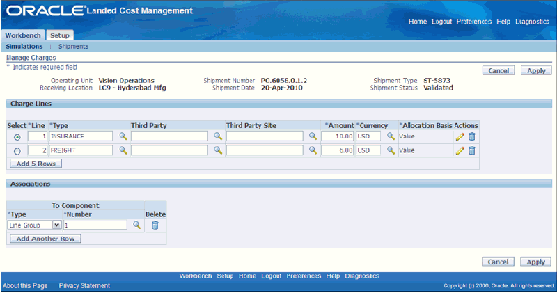

To manage charges and simulation details
On the Landed Cost Details page, click the Update button to navigate to the Update Shipment page.
From the Actions menu, select Manage Charges and click the Go button to display the Manage Charges page in order to update the desired Charge Line information.
Please refer to the Managing Charge Lines for the Shipment section of this document for additional information on how to manage charges.
Manage Charges page

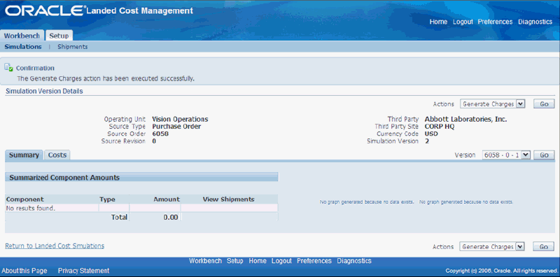

On the Simulation Version Details page, select Generate Charges from the Actions menu and click the Go button.

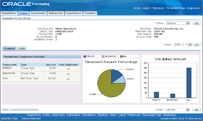

To calculate the landed costs for a Landed Cost simulation
Navigate to the Simulation Version Details page and click the Total Cost link for Version 2 to view the Simulation Version Details page.
From the Actions menu, select Calculate and click the Go button. When you calculate the simulated version, LCM will run the calculation engine for all the Landed Cost simulated shipments that belong to that simulated version. Alternatively, you can run the calculation for each simulated shipment. To do so, use the same navigation as you edit and use the actions list of value available there. Please refer to the section Managing Landed Cost for additional information.
To firm the best Landed Cost simulation
LCM allows you to reuse the charge information from firmed simulations when you are creating the Landed Cost shipments at the time of receipt. To firm a simulation version, you are required to complete, or submit it. When you submit the LC simulated version, you are freezing it from updates and allowing it to be firmed. You should perform this action when you are satisfied with the simulation results and don’t want to update it anymore.
From the Actions menu on the Simulated Version Details page, select Submit and click the Go button.
You have the option to firm the simulation from 2 pages. You can select Firm from the Actions menu of the Simulation Version Details page:
Or you can click on the Firm icon in the Actions column on the Landed Cost Simulations page
On the Landed Cost Simulations page, note that Simulation Version 1 is now firmed.

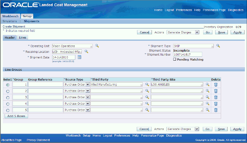

On the Create Shipment page, enter the shipment header information and click the Lines tab.

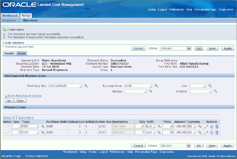

Search for the desired purchase order lines, save the shipment, select Generate Charges from the Action menu and click the Go button.
From the Actions menu, select View Landed Cost and click the Go button to.
