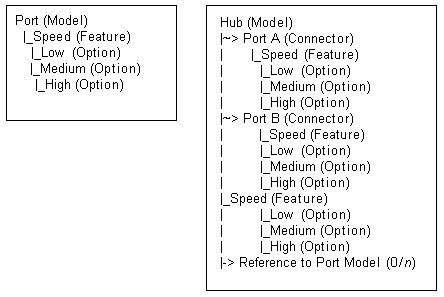

Telephone Network Model
In a runtime Oracle Configurator, an end user configures a telephone network by defining circuits. The user creates a circuit by connecting two Ports, which are part of a configurable Hub Model. One or more configurable Ports exist per circuit, and each Port includes the parameter Speed. The Speed parameter includes the Options High, Medium, and Low, and any two connected Ports must have the same speed. The end user connects two Ports at a time, while constraints defined in Configurator Developer ensure that the Speed of the connected Ports is the same. When all required selections and connections are made and the configuration is valid, the data is passed back to the host application for downstream processing.
The Models required to create the network and rules described in this example are shown in Telephone Network Models.

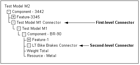

Second-Level Connectors
A target Model can also contain a Connector. When this occurs the structure of the second-level (nested) Connector’s target Model is not visible in Configurator Developer. Because the second-level Connector’s target Model is not visible, nodes from that Model cannot participate in the parent Model’s configuration rules.
First and Second-Level Connectors shows how a Model containing both first and second-level Connectors appears in Configurator Developer.
the picture is described in the document text
To work around the restriction of creating rules using nodes from a second-level Connector’s target Model, perform the following:
  1. Create an intermediate node in the first-level target Model. (Feature 1 in Connectors and Target Models.)
  2. Define a rule in the first-level target that includes the intermediate node and the node(s) you want to use in the nested Connector’s target.
  3. Define a rule in the root Model using the intermediate node to produce the desired results.

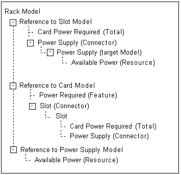

Example: The Rack Model shown in Rack Model Structure contains References to three Models: Slot, Card, and Power Supply.
In the Rack Model, Card has a Connector to Slot, which in turn has a Connector to Power Supply. You need to define a rule that states Power Required consumes from the Available Power Resource in Power Supply. In the Rack Model, however, Power Supply is the target of a second-level Connector (in Card), so you cannot use a node from Power Supply to create the rule.
To work around this restriction, define an intermediate node in Slot (in this example, the Card Power Required Total) to reflect information from Card, and then define the rule in two pieces.
First, relate the Power Required Total in Card to the desired node in Power Supply:
Card.Power Required Consumes from Power Supply.AvailablePower
Then, create a rule in Slot relating Power Required with the intermediate node:
Power Required Contributes to Slot.Card Power Required
