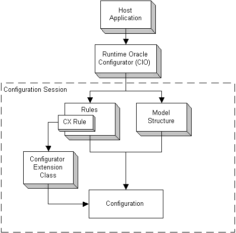

During a configuration session, the bound Configurator Extension methods run in reaction to certain configuration session events that are related to specified nodes of the Model. The Configurator Extension can modify the configuration. The relationship of a Configurator Extension to the runtime Oracle Configurator is shown in Relationship of a Configurator Extension to Runtime Oracle Configurator.
At runtime, the Java class that implements your Configurator Extension runs in the same JVM as the runtime Oracle Configurator.

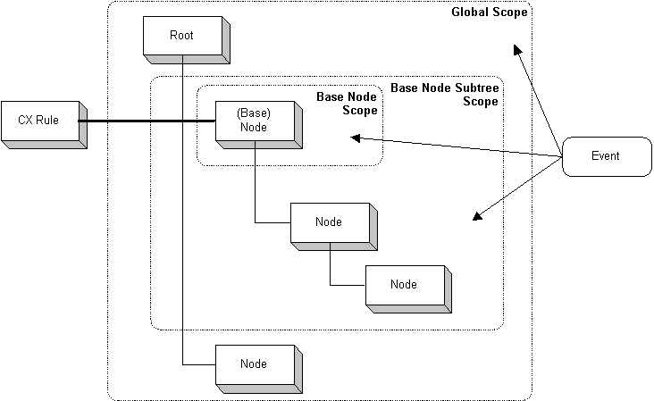

In Configurator Developer, you bind events within a certain scope. This event binding scope tells listeners that are registered for the event where in the runtime Model tree to listen for an occurrence of that event. Event Binding Scopes and Event Binding Scopes describe the scopes for event binding.
| Event Binding Scope | Listens for Events ... |
| Global | Anywhere in the runtime tree of the current configuration instance. |
| Base Node | Only on the node bound to the Configurator Extension Rule. |
| Base Node Subtree | On the node bound to the Configurator Extension Rule and all its descendants. |
At runtime, in a configuration session, an event occurs within an event execution scope, which is either Global or Node.
Events that occur in the Global scope are propagated to all listeners whose event scope is Global. These events are the ones in Predefined Events for Binding that are related to the configuration object, such as postConfigInit.
Events that occur in the Node scope are propagated in the following sequence, which ascends the tree structure of the configuration model:
By listeners that are registered on the node of execution scope and that have an event binding scope of Base Node or Base Node Subtree
By listeners that are registered on ancestors of the node of the execution scope and that have an event binding scope of Base Node Subtree (which means that the node of execution scope is part of their Base Node Subtree binding)
By global listeners, which are registered on all nodes.
