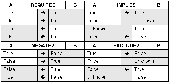

Logic Rules enable you to express constraints among elements of your Model in terms of logical relationships. For example, selecting one Option A may require that Options B and C be included in the configuration.
When defining a Logic Rule, you specify the rule’s behavior by selecting a logic relation. Oracle Configurator Developer provides the following logic relations:
The following sections describe each type of relation and present tables illustrating their behavior. In each table, the unshaded portion indicates the logic state the option has after an end user selects it, and the shaded portion indicates the logic state of the option on the other side of the rule that results from the selection. The arrows indicate the direction in which the rule propagates.
Notice that a rule can propagate from Operand 1 to Operand 2 of the relation, or from Operand 2 to Operand 1. Notice also that for some values and some logic relations the rule does not propagate; therefore logic state of the option on the other side of the rule does not change.
Note: In this chapter, "true" and "false" are used generally to indicate only whether an option is included or excluded from the configuration. Therefore, the examples in the following sections do not differentiate between User True and Logic True, and User False and Logic False. For details about how the runtime Oracle Configurator uses logic state to display options, see Selection State.
The effect of the Implies relation:
If the end user selects Option A it becomes true and Option B is also selected. In other words, Option B’s logic state becomes true.
See The Implies Relation.
Deselecting Option A causes Option B to become Unknown. In other words, Option B is available for selection.
If the end user selects Option B first, it becomes true and Option A becomes Unknown.
If the end user deselects Option B, both Option B and A become false.
The effect of the Excludes relation:
If the end user selects Option A, it becomes true and Option B becomes false. In other words, Option B is excluded from the configuration.
If the end user tries to select Option B, Oracle Configurator displays a contradiction message.
If the end user deselects Option A, Option B becomes Unknown. In other words, Option B is available for selection.
If the end user selects Option B first, Option A becomes false.
If the end user deselects Option B, then Option A becomes Unknown.
Logic rules that use the Requires relation "push both ways," which means that selecting an option on one side of the rule has the same effect on the option on the other side of the rule. See the examples below for details.
The effect of the Requires relation:
If the end user selects an option on one side of the rule, the option on the other side of the rule is also selected. The same is true when the end user deselects an option.
In other words, both options must be either included in the configuration, or excluded from the configuration.
The Negates relation is similar to the Requires relation, in that it also "pushes both ways." However, the Negates relation prevents an option from being selected when an option on the other side of the rule is selected. In other words, selecting one option prevents the other option from being included in the configuration.
The effect of the Negates relation:
If the end user selects Option A, it becomes true and Option B is set to false.
See The Negates Relation.
If the end user then deselects Option A, it becomes false and Option B becomes true. In other words, Option B is selected.
If the end user selects Option B first, it becomes true and Option A becomes false.
If the end user then deselects Option B, Option A becomes true.

Compare and contrast the effects of the logical relationships as shown in Summary of Logical Relationships :
