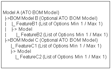

A referenced BOM Model is not required to create a valid configuration if the Optional check box is selected for that Model in Oracle Bills of Material. If an optional BOM Model contains a Feature that is required, unintended results may occur at runtime. A required Feature is any Option Feature that has a Minimum greater than 0 (zero), or a Text Feature that has the Required check box selected in Configurator Developer.
This can occur at runtime when an optional BOM Model has a required Feature:
At the Model level
In a child (referenced) Model
This applies whether the Reference is to an imported BOM Model or a non-imported Model.
Example: Model A references Model B and Model C, which are both optional BOM Models. Model B and C are variations of the same component, and a valid configuration may contain one and only one of these components. Both Models contain a required Feature, and reference a Model that contains a required Feature (this structure is shown in Optional BOM Models with Required Features).
At runtime, the end user selects and configures Model B, satisfying the configuration requirement for that component. However, a selection from Model C is still required because it contains a required Feature. In this situation, the end user will be able to save a valid configuration of Model A, since only Model B or Model C is allowed. However, the configuration will still be incomplete.
To avoid this situation, do the following:
Make any required Features optional by changing the Minimum Selections to 0.
If the end user must make a selection from the Features to create a valid configuration, create a Logic Rule that uses the Requires relation to tie the Features to the parent BOM Model.
For example, using the Model shown in Optional BOM Models with Required Features, change the Initial Minimum for all of the required Features to 0, and then create the following rules:
"BOM Model B REQUIRES FeatureB1"
"BOM Model B REQUIRES FeatureB2"
"BOM Model C REQUIRES FeatureC1"
"BOM Model C REQUIRES FeatureC2"
