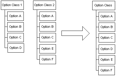

Are the Same Product Elements Repeated in Separate Models?
Any identical or similar model structure that is duplicated at least twice in your Model can be considered as a repeating product element. For example, BOM Option Classes that are similar share some options in common, but also contain different options, as shown in Repeating Similar Product Elements graphic.
The graphic shows two BOM Option Classes, "Option Class 1," and "Option Class 2." Each BOM Option Class contains Options, some of which are repeated in the two BOM Option Classes, and some of which are not. "Option Class 1" contains Options A, B, C, and D, while "Option Class 2" contains Options A, B, C, E, and F. An arrow points to a third BOM Option Class that contains a union of the Options A, B, C, D, E, and F.
the picture is described in the document text
Repeating Similar Product Elements shows that when the separate and duplicated structure is combined, the total structure that has to be loaded, instantiated, or maintained is smaller. In this example, the number of nodes has been reduced from 11 to 7, a reduction of 36%. When combining structure in this way, you need appropriate rules to ensure that only the relevant options are visible or available where the abstraction appears in the runtime Oracle Configurator.
