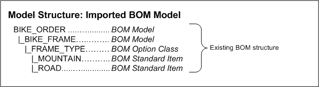

The structure of a BOM Model does not have a location for storing configuration attributes data. To create such locations, you must add structure to imported BOM Models, in Oracle Configurator Developer. In the configuration attributes methodology, the added structure takes the form of attribute Features. Attribute Features are not a new type of Feature. The term attribute Feature simply means a Feature that is used to contain the data for a configuration attribute.
The figure Imported BOM Model shows the structure of the imported BOM Model for this example, before addition of attribute features.
This imported BOM structure does not have locations for storing certain pieces of data that you might want to capture during a configuration session for ordering a bicycle, such as:

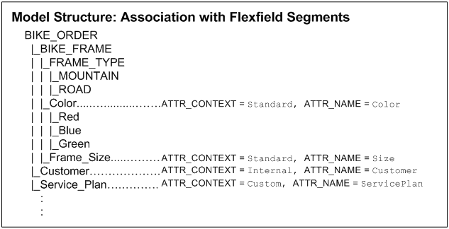

To create associations between attribute Features and their corresponding descriptive flexfield contexts and segments, you must add attribute Properties to the Features, in Oracle Configurator Developer.
To associate an attribute Feature to the corresponding descriptive flexfield segment, define a Property of type Text, named ATTR_NAME. The value of the Property must be the name of the corresponding segment.
To associate an attribute Feature to the corresponding descriptive flexfield context, define a Property of type Text, named ATTR_CONTEXT. The value of the Property must be the name of the corresponding context.
The figure Association of Attribute Features to Flexfields shows how the attribute Properties ATTR_CONTEXT and ATTR_NAME define associations between attribute Features and their corresponding descriptive flexfield contexts and segments. Compare this figure to the figure Flexfield Contexts and Segments, and to steps 4 and 6 in the table Configuration Attributes Flow.
For more information about defining Properties, see the Oracle Configurator Developer User’s Guide.

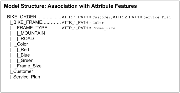

To create associations between BOM nodes and the attribute Features that store their configuration attribute values, you must add attribute Properties to the BOM nodes, in Oracle Configurator Developer.
The Property must be named ATTR_n_PATH, where n is an integer that makes the name unique within the scope of the current node.
The value of the Property must be the node path to the attribute Feature, starting from the BOM Model node that is nearest to the node with the ATTR_n_PATH Property.
If the node with the path property is a BOM Model, then that nearest BOM Model node is itself. If not, then the nearest BOM Model node is found by recursively looking upward in the Model tree until the nearest BOM Model node is found.
The nodes in the node path are delimited by a dot (‘.’).
You can create multiple ATTR_n_PATH Properties for the same node, with different values of n, to assign multiple attribute Features to the node. This means that you can assign multiple configuration attributes to the same inventory Item.
You can use the same ATTR_n_PATH name in different nodes without conflict. (In ordinary practice, you would probably start by using ATTR_1_PATH each time you created a Property on a different node.)
See steps 2 and 3 in the table Configuration Attributes Flow for an example of an ATTR_n_PATH Property and how it is used by attribute processing.
The figure Association of BOM Nodes to Attribute Features shows how the attribute Property ATTR_n_PATH is defined to associate BOM nodes with attribute Features. Compare this figure to steps 2 and 3 in the table Configuration Attributes Flow.

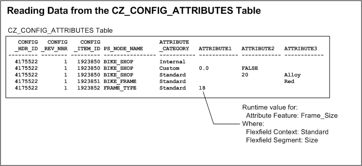

The goal of the configuration attributes methodology is to place attribute data in a database table where it can be used by downstream applications. See the following sections for details:
The attribute flexfield table, CZ_CONFIG_ATTRIBUTES, is used as the intermediate store of configuration attribute data between Oracle Configurator and a host application.
| Column Name | Null? | PK? | Type | Comments |
| CONFIG_HDR_ID | N | Y | NUMBER(9) | Configuration header ID |
| CONFIG_REV_NBR | N | Y | NUMBER(9) | Configuration revision number |
| CONFIG_ITEM_ID | N | Y | NUMBER(9) | Configuration item ID |
| ATTRIBUTE_CATEGORY | N | Y | VARCHAR2(30) | Name of flexfield context |
| ATTRIBUTE1 | N | N | VARCHAR2(4000) | Flexfield segment value for the specified context |
| ATTRIBUTE2 | N | N | VARCHAR2(4000) | Flexfield segment value for the specified context |
| ATTRIBUTE30 | N | N | VARCHAR2(4000) | Flexfield segment value for the specified context |
The columns CONFIG_HDR_ID, CONFIG_REV_NBR, CONFIG_ITEM_ID and ATTRIBUTE_CATEGORY constitute the primary key for CZ_CONFIG_ ATTRIBUTES.
All of the columns ATTRIBUTE1 through ATTRIBUTE30 are defined identically, and the columns between ATTRIBUTE2 and ATTRIBUTE30 have been omitted from the table The CZ_CONFIG_ATTRIBUTES Table for brevity. The standard columns such as LAST_UPDATE_DATE have also been omitted for brevity.
For information about the Oracle Configurator schema, see the Oracle Configurator Implementation Guide. For technical details about CZ_CONFIG_ATTRIBUTES, CZ_ CONFIG_EXT_ATTRIBUTES, and other tables, see the Configurator eTRM on Metalink, Oracle’s technical support Web site.
When attribute processing is in effect, and a runtime configuration is saved, then the Core Java API for Oracle Configurator (oracle.apps.cz.core) writes the accumulated attribute data to the attribute flexfield table CZ_CONFIG_ATTRIBUTES, using the flexfield associations for guidance on which columns to write into.
When a runtime configuration is saved, the API method that is invoked takes a list of BOM nodes that have associated configuration attributes. For each BOM node in the list, the attributes are sorted by flexfield context, which corresponds to the ATTRIBUTE_CATEGORY column of the table. Then for each attribute category for that BOM node, a row is written to the table. The row contains all the attribute values for that node and context. The flex field tables (FND_DESCR_FLEX_COLUMN_USAGES, FND_DESCRIPTIVE_FLEXS and FND_APPLICATION) are queried to determine the mapping between attribute-context and flex field column.
When you need to obtain configuration attribute data from the CZ_CONFIG_ATTRIBUTES table, you can use a SQL query like the one shown in the example Query for Attribute Data. The results of this query are shown in the figure Configuration Attribute Data.
You must write any custom procedures required to provide configuration attribute data to downstream applications.
To run the query shown here, replace the values for a.CONFIG_HDR_ID and a.CONFIG_REV_NBR with the Configuration Header ID and Configuration Revision values returned when a configuration session ends and the configuration has been saved. When you use the Test Model function of Oracle Configurator Developer, these values are displayed on the Confirmation page. When you save a configuration by other means (for instance, from a host application), then the Configuration Header ID and Configuration Revision values are written to the config_header_id and config_rev_nbr elements of the XML termination message. See the Oracle Configurator Implementation Guide for information about the termination message.
SELECT
a.CONFIG_HDR_ID,
a.CONFIG_REV_NBR,
a.CONFIG_ITEM_ID,
i.PS_NODE_NAME,
a.ATTRIBUTE_CATEGORY,
a.ATTRIBUTE1,
a.ATTRIBUTE2,
a.ATTRIBUTE3,
a.ATTRIBUTE10
FROM
CZ_CONFIG_ATTRIBUTES a, CZ_CONFIG_ITEMS i
WHERE
a.CONFIG_HDR_ID = 4175522 -- from saved configuration
AND
a.CONFIG_REV_NBR = 1 -- from saved configuration
AND
a.CONFIG_ITEM_ID = i.CONFIG_ITEM_ID
AND
a.CONFIG_HDR_ID = i.CONFIG_HDR_ID
AND
a.CONFIG_REV_NBR = i.CONFIG_REV_NBR
ORDER BY
a.CONFIG_ITEM_ID
set linesize 400
set headsep on
column CONFIG_HDR_ID heading 'CONFIG|_HDR_ID'
column CONFIG_REV_NBR heading 'CONFIG|_REV_NBR'
column CONFIG_ITEM_ID heading 'CONFIG|_ITEM_ID'
column ATTRIBUTE_CATEGORY heading 'ATTRIBUTE|_CATEGORY'
column PS_NODE_NAME format a16
column ATTRIBUTE_CATEGORY format a24
column ATTRIBUTE1 format a12
column ATTRIBUTE2 format a12
column ATTRIBUTE3 format a12
The output in the figure Configuration Attribute Data shows the result of running the query in the example Query for Attribute Data.
