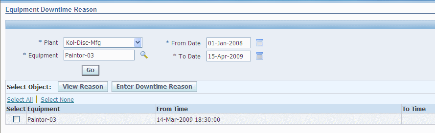

From the Tag Data Workbench, you can add or view reasons for equipment downtime or equipment scrap quantity.
To view and add reason codes from the Tag Data Workbench
Navigate to the Equipment Downtime Reason page or the Scrap Reason page. The Tag Data Workbench appears.
Note: The following steps apply to both Equipment Downtime Reasons and Equipment Scrap Reasons.
Select a Plant from the List of Values (LOV).
Enter a valid value for Equipment, or search for a value.
Specify a date range for viewing or adding equipment downtime or scrap reason.
Click Go. The page displays the equipment downtime or scrap reading.
Select rows to view and add one or more reasons.

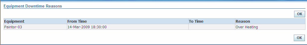

Click the View Reason button to view existing reasons for the date range specified.

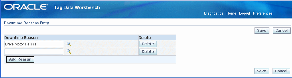

Click the Enter Downtime Reason button to add a downtime reason to your equipment. The Downtime Reasons Entry page appears.
Note: If you are adding Equipment Scrap Reasons, then the Equipment Scrap Reasons page appears.
In the Downtime Reason field or Scrap Reason field, enter a value, or search for a valid reason. You can add multiple reasons to selected equipment downtime or scrap reading rows.
Save your work. You can now click the View Reason button to verify that the reason code is now attached to the selected downtime or scrap reading rows.

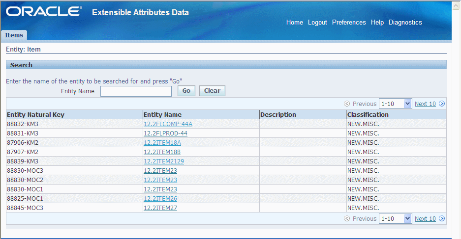

Equipment and other manufacturing entities are business objects in the shop floor with unique characteristics and processes. MOC supports the collection of attributes for item, equipment, work order, batch operation, and miscellaneous custom entities. You can update or view attributes for manufacturing entities from the Manufacturing Operations Center User responsibility.
To view extensible attributes data for entities
Navigate to the entity-specific page. The entity-specific attributes display.
You can further refine your display by searching on the Entity Name.

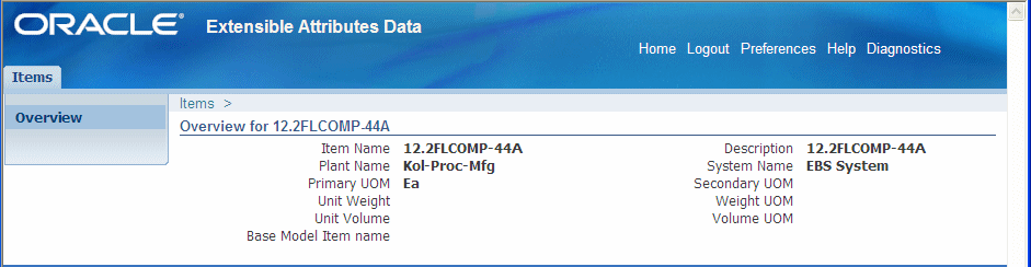

Click on an Entity Name link to view details. The Overview page appears and displays entity-specific details.
Note: The MOC User Role allows you to enter the values for the attributes. A typical example would be defining specification attributes and comparing with actual attribute values for the entities.
The Entity Instance Attribute Details page of the MOC Administrator Role appears in the MOC User Role for the entity, and allows you to enter or view the attribute values.

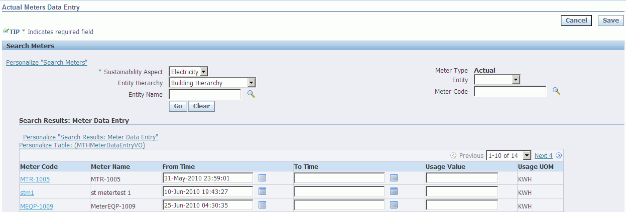

You can enter meter readings manually using the Actual Meters Data Entry page and also view the history of readings for a meter.
To enter meter readings manually
Navigate to the Actual Meter Data Entry page.
Enter Sustainability Aspect to find a meter using its sustainability aspect.
Enter the following criteria to search for a meter:
Meter Type to find a meter using its type.
Entity Hierarchy to find a meter using its entity hierarchy
Entity and Entity Name to find a meter by its entity.
Click Go. The page displays a list of all the actual meters for which you can enter data readings.
The following fields display for each meter:
Meter Code
Meter Name
Enter the time period for which you want to enter the readings in the From Time and To Time fields.
Enter the value of the sustainability aspect usage in the Usage Value field. Usage UOM is the unit of measure in which the sustainability aspect usage is expressed.
