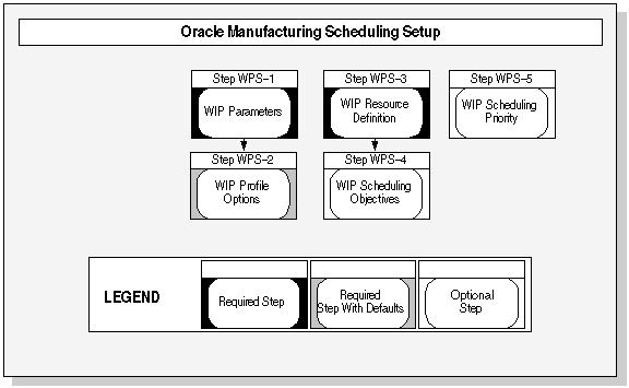

This chapter provides information about setting up Oracle Manufacturing Scheduling as well as the necessary Oracle Work in Process application functionality.
This section contains an overview of each step you need to complete to set up Oracle Manufacturing Scheduling. For instructions on how to complete each task, see the setup sections indicated in each step below.
You may not need to perform some of the steps below if you've already performed a common-application setup (setting up multiple Oracle Applications products).
Oracle Manufacturing Scheduling requires that Oracle Work in Process Release 12 be set up for discrete jobs. See: Overview of Setting Up, Oracle Work in Process User's Guide.
Some of the steps outlined in this flowchart and setup checklist are:
Required
Required Step With Defaults
Optional
Required Step With Defaults refers to setup functionality that comes with pre-seeded, default values in the database; however, you should review those defaults and decide whether to change them to suit your business needs. If you need to change them, you should perform that setup step. You need to perform Optional steps only if you plan to use the related feature or complete certain business functions.
The following table lists setup steps. After you log on to Oracle Applications, complete these steps to implement Oracle Manufacturing Scheduling.
| Step No. | Required | Step | |
| Step 1 | Required | Defining WIP Parameters | |
| Step 2 | Required | Defining WIP Profile Option | |
| Step 3 | Required | Defining WIP Resource Definition | |
| Step 4 | Optional | Setting Up Scheduling Objectives | |
| Step 5 | Optional | Defining WIP Scheduling Priority |
