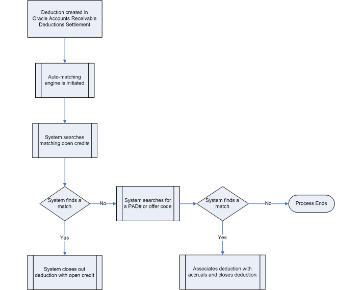

Rule Based Settlement enables claims processors to automate the process of claim research and settlement for claims that are raised by distributors against promotions or price protection agreements.
If you enable Rule Based Settlement when setting up system parameter defaults, you can also define rules that the Rule Based Settlement Engine concurrent program uses to
match deductions with open AR credits
match claims and deductions with unpaid distributor accruals
set thresholds to find possible matches of deduction and claims with open credits and unpaid accruals
In addition, you can directly set up approval rules on the System Parameters page separately for credit matches and accrual matches that the Rule Based Settlement Engine concurrent program finds. If you enable one or both of the approval options for New Credits and Matched Credits, then you can use the report that the Rule Based Settlement Engine concurrent program produces to manually review, approve, and settle each of the matches found. Alternatively, to review and approve all of these claims at one go, navigate to the Mass Approvals sub tab of the Claims page, search for all claims in Pending Approval status, drill down on the claim number to review claim details, and select the approve check boxes against the ones that clear the review.
On claims against offers and price protection agreements, distributors cite a promotion ID or a pre-authorized (PAD) debit memo number on the claims. When matching, the Rule Based Settlement Engine concurrent program first looks to match deductions with a Accounts Receivables credit and if unable to find a credit match, then looks to match deductions with unpaid accruals based on the PAD number provided by the distributor on the claim.
The promotion ID or PAD number is just one of the attributes in the matching process. Other matching attributes that the program uses are listed below in order of precedence. The program uses each matching attribute to find an exact or possible match before moving on to the next attribute in the order of precedence.
Customer reference ID on the deduction - If one exists then the program looks to match the customer reference ID to that on an open credit for the customer in the system.
If an exact match exists, then the program offsets the deduction with the credit and closes the claim.
If an exact match does not exist, but the match is within the thresholds you specified on the System Parameters page, then the program lists the deduction as a possible match to the credit on the report for your review.
Pre-Authorized Debit Memo (PAD) number on the deduction - If one exists then the program looks to match the PAD# to an offer code.
If an exact match exists, then the program associates the accruals on the offer to the deduction, settles the deduction with a credit memo and closes the claim.
If an exact match does not exist, then the program moves to the next matching attribute.
Note: To add a PAD number when manually creating a deduction, set up the Receipt Application Information flexfield in Oracle Receivables to include PAD number in the segment and map it to a claim attribute. Then, set this attribute value for the OZF: RBS Receipt PAD Attribute profile option. For more information, see the Setting Profile Options section. You can update the offer code of an open deduction.
Amount on the deduction - The program looks to match the deduction amount with credit amount or the unpaid accrual amount.
For a credit memo, if an exact match does not exist, but the difference in deduction and credit amount is within the threshold of 5 or 10 percent of the credit amount, then the program lists the deduction as a possible match to the credit on the report for your review and approval before closing it.
For accruals, if an exact match does not exist, but the difference in is within the pay over earnings threshold for the distributor, then the program lists the deduction as a possible match to the accrual on the report for your review and approval before closing it.
The following diagram illustrates the matching process.
The process above includes the following steps that the Rule Based Settlement Engine concurrent program uses to find matches for claims and deductions.
Deductions are generated.
The Rule Based Settlement Engine concurrent program is initiated.
The program first looks to match deductions with open credits.
If a match is found, the engine offsets the deduction with the credit.
If a match is not found, the engine looks to match deductions with open accruals with the same PAD number or offer code.
If a match is found, the engine associates the accrual with the deduction and closes out the deduction.
If a match is not found, the engine terminates the match process.

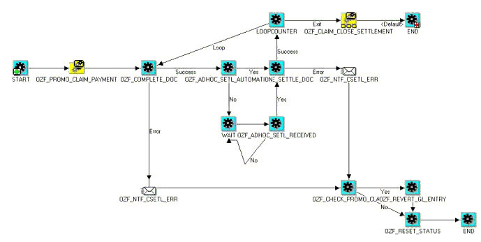

Oracle Accounts Receivable Deductions Settlement uses Oracle Workflow to control the sequence of events and notifications that occur when settling claims. The following sections provide:
Detailed information about Overview of the Claim Settlement Workflow Process that is seeded with Oracle Trade Management.
Instructions on configuring the OZF: Claim Settlement workflow process to extend the settlement process for any non-seeded payment methods your organization requires. For details see:
For information on the implementation and setup of Oracle Workflow, refer to the Oracle Workflow Administrator's Guide.
In Oracle Accounts Receivable Deductions Settlement, the settlement process is initiated when a user changes the following claim attributes:
Settlement method: Select applicable settlement methods for a claim.
Status: Change claim status to closed.
The claim settlement workflow process is invoked as follows:
If the OZF : Automate Deduction/Overpayment Settlement profile option is set to No, the claim settlement workflow process is invoked if the user tries to settle deductions or overpayments by a settlement method related to Oracle Receivables.
If the OZF: Automate RMA Settlement profile options is set to Yes, settlement automation is enabled between Oracle Receivables and Oracle Trade Management.
For credit memo invoice settlements, the claim settlement workflow is invoked in the following cases:
For both transaction-related and non-transaction-related deductions, if the invoice defined in the claim line was not applied on the receipt for which the deduction was created, the claim settlement workflow is invoked. The user must verify the claim information and create a credit memo in Oracle Receivables to close the claim.
If the OZF: Derive Accrual Account during Claims Settlement profile option is set to Yes, when you settle a claim by changing the claim status to Closed, the claim status becomes Pending Close immediately and the claim settlement workflow is invoked. The Oracle General Ledger entries and payment creation process are put into background processing. The user must run the Workflow Background Engine concurrent program to proceed with the settlement workflow.
The Claim Settlement Workflow process is called in any of the following scenarios:
If post to GL is set to Yes and the OZF: Derive Accrual Account during Claims Settlement profile option is set to Yes, the creation of GL entries are deferred to the background. This is because the applicable GL account is derived based on the account derivation rules that you defined.
The Automate Deduction/RMA profiles is set to No.
Claim is settled by a credit memo invoice and:
For an invoice deduction, the invoice is not the source invoice.
For non invoice deduction, the invoice is not on the source receipt.
When crediting an invoice, different types of credits are mixed. An invoice can be credited as credit to total amount, credit to type where type is tax/freight/line amounts or credit to individual invoice line number.

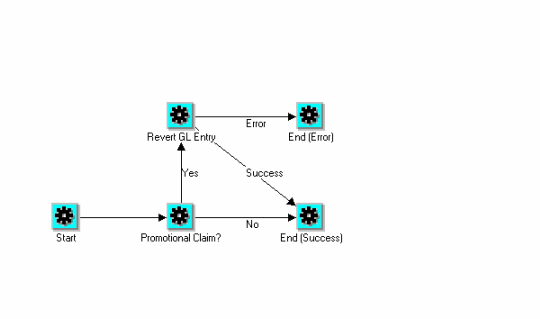

Claim Generic Settlement Process verifies if a settlement method is seeded. It is associated with the following sub-processes:
Start: This activity marks the start of a process and does not perform any action.
Promotional Claim Payment: This activity verifies if the activity is a Promotional Claim Payment. If not, it generate an error. If is successful, if goes to Seeded Settlement Method.
Seeded Settlement Method: This activity is used to verify whether or not the settlement method is seeded. It also sets the item attribute Settlement Type to ADHOC if the settlement method is not seeded. The resulting type for this activity can be Yes or No. If Yes, it goes to the Claims Settlement Process and if No, it goes to the Non-seeded Settlement Process.
Claim Settlement Process : If this activity is successful, the process ends. If the activity generated an error, it Reverts Entries and ends.
Non-seeded Settlement Process:If this activity is successful, it ends. If it is not successful, it generates an error, Reverts Entries and ends.
Generic Claims Settlement

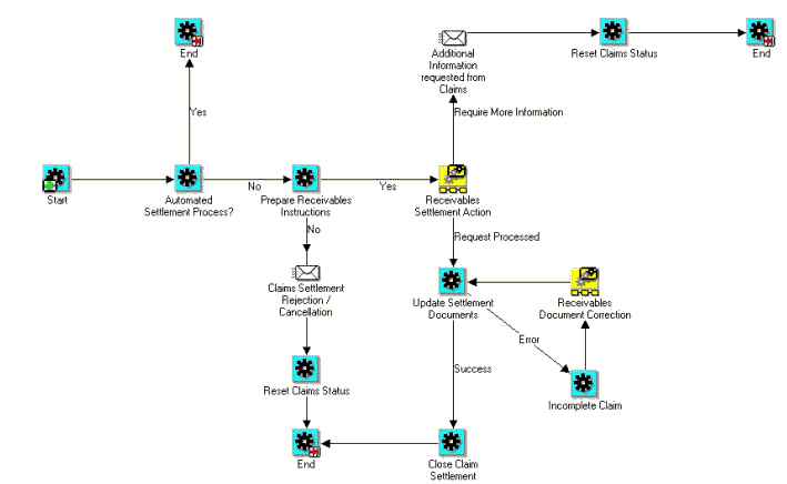

The Claim Settlement New diagram is associated with the following sub-processes:
Automated Settlement Process: This activity verifies if the activity is an Automated Settlement Process. The resulting type for this activity can be Yes or No. If yes, , the activity ends. If no, it goes to Prepare Receivables Instructions.
Prepare Receivables Instructions: This activity is used to Prepare Receivables Instructions. The resulting type for this activity can be Yes or No. If yes, it goes to Receivables Settlement Action. If no, it goes to Claims Settlement Rejection/Cancellation, Resets the Claims Status, and Ends.
Receivables Settlement Action: If this activity is successful, a request is processed, the settlements documents are updated, and the claim settlement is closed. If there is an error during the updating settlement documents process, an incomplete claim is generated and a Receivables Document Correction is generated which in turns goes back to the Update Settlement Documents process.
If the Receivables Settlement Action process requires more information, additional information is requested from Claims, the claim status is reset, and the process ends.

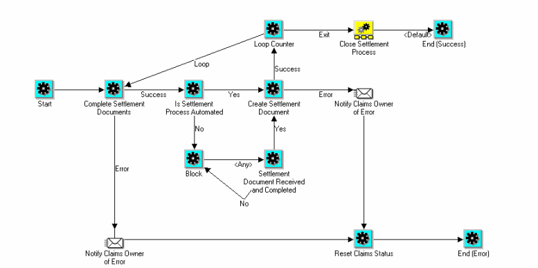

The Non-Seeded New diagram is associated with the following sub-processes:
Complete Settlement Documents Process: This activity verifies if the activity is a Complete Settlement Documents Process. The resulting type for this activity can be Error or Success. If there is an error, the claims owner is notified of an error, the process reverts entries, and ends.
If successful, the Settlement Process is automated.
Is Settlement Process Automated: The resulting type for this activity can be Yes or No. If no, it continues to wait to verify that the settlement document was received and completed. If the Settlement Process is Automated, it creates a settlement document. .
Create Settlement Document: If this activity is successful, it goes to a loop counter where it either closes the settlement process and ends or goes back to the Complete Settlement Documents step.
If the Create Settlement Document process generates an error, it notifies the claims owner of the error, reverts entries, and ends the process.
Non Seeded Settlement New
The following diagram shows the flow for Promotional Claim Payment.
The Promotional Claim Payment diagram is associated with the following sub-processes:
OZF_CHECK_PROMO_CLAIM: This activity verifies if the activity is a promotional claim. The resulting type for this activity can be Yes or No. If No, it continues the flow. If yes, it defers to OZF_CREATE_PAYMENT.
OZF_CREATE_PAYMENT: The resulting type for this activity can be Success or Error. If it is successful it continues the flow. If the process generates an error, it goes to OZF_NTF_CSETL_ERR, resets the status and ends the process.

The following diagram shows the flow to revert entries.
The Revert Entries diagram is associated with the following sub-processes:
Promotional Claim: This activity verifies if the activity is a promotional claim. The resulting type for this activity can be Yes or No. If No, it ends the process because it is successful. If yes, it goes to Revert GL Entry.
Revert GL Entry:: The resulting type for this activity can be Success or Error. If it is successful it ends the process. If the process generates an error, it ends the process with an error.
Revert Entries
