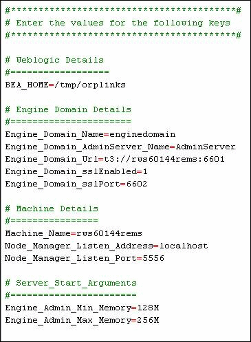

For the initial configuration, the WLST_Config.properties file needs to be up to date with the relevant details. The file is located in the folder WLST_scripts. A sample property file has been attached for reference. Refer to the example below to populate the file with the proper details.
# Weblogic DetailsExample:
BEA_HOME -
Provide the WebLogic home directory – the path in which WebLogic is installed
<line break>
# Engine Domain Details
Engine_Domain_Name –
Name of Engine Domain provided during installation in 2.1.
Engine_Domain_AdminServer_Name –
Name of Engine Domain Admin Server provided during installation in 2.1.
Engine_Domain_Url –
t3://<Machine_Name>:<Port_No>
Protocol used should be t3 and not http
Machine_Name (For ex. rws60144rems)
Port_No :- Listen Port No. for Engine Domain
Engine_Domain_sslEnabled=1
Engine_Domain_sslPort –
SSL Port Number provided during installation in 2.1.
# <line break>
# Machine Details
Machine_Name –
Host name of the machine on which the WebLogic server is running (e.g. rws60144rems.us.oracle.com)
Node_Manager_Listen_Address = localhost
Node_Manager_Listen_Port = 5556
# <line break>
# Server_Start_Arguments
Engine_Admin_Min_Memory –
Minimum size of the server memory (like 128M)
Engine_Admin_Max_Memory –
Maximum size of the server memory (like 256M)
A sample configuration file appears below.

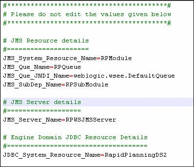

# JMS Resource details
JMS_System_Resource_Name=RPModule
JMS_Que_Name=RPQueue
JMS_Que_JNDI_Name=weblogic.wsee.DefaultQueue
JMS_SubDep_Name=RPSubModule
# <line break>
# JMS Server details
JMS_Server_Name=RPWSJMSServer
# <line break>
# Engine Domain JDBC Resource Details
JDBC_System_Resource_Name – RPPlanningDS2

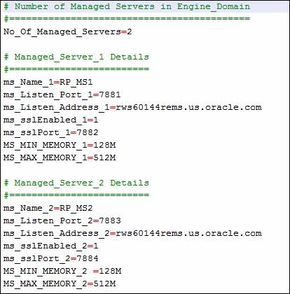

Perform the following procedure to create the Managed Servers using a script.
Edit the CreateServer.Properties file to create additional Managed Servers and provide the necessary server details for your environment.
Input the server details in the format below. (Refer to the sample CreateServer.properties file provided in the folder WLST_scripts.)
Enter the No_Of_Managed_Servers to be created.
For each Managed Server to be created, enter the following values:
ms_Name_[i]=
ms_Listen_Port_[i]=
ms_Listen_Address_[i]=
ms_sslEnabled_[i]=
ms_sslPort_[i]=
ms_Min_Memory_[i]=
ms_Max_Memory_[i]=
where i represents the number of the server.
For example, if No_Of_Managed_Servers is 5, then there should be 5 sets of the values above in the format as mentioned where i has values 1, 2, 3, 4, and 5. Each Managed Server is defined by the following values you define in the CreateServer.Properties file:
ms_Name_[i] - Enter the name of the Managed Server.
ms_Listen_Port_[i] - Enter the Listen Port for Manager Server.
ms_Listen_Address_[i] - Enter the Listen Address for Manager Server.
ms_sslEnabled_[i] - Enter '1' to make SSL Port enabled.
ms_sslPort_[i] - Enter the SSL Port Number.
ms_Min_Memory_[i] - Enter the minimum memory argument for Manager Server.
ms_Max_Memory_[i] - Enter the maximum memory argument for Manager Server.
A sample CreateServer.properties file appears below.

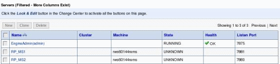

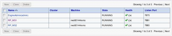

Verify the newly created Managed Server.
If the log file shows that the Admin Server was shutdown, start the server as per the instructions in Starting the Engine Admin Server.
From the WebLogic home page, select Environment from the Domain Structure region.
Select Servers.
Select a server name (for example, RP_MS1). The machine details appear.

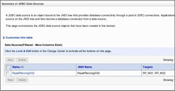

From the Domain Structure region, expand the Services tree node and select Data Sources. The Summary of the JDBC Data Sources screen appears.
The Target Servers for the JDBC Resource appear in the Targets column.

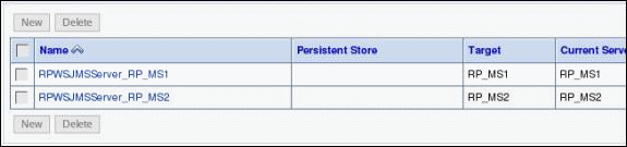

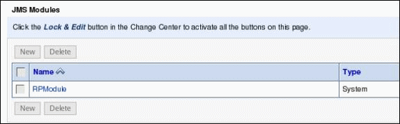

From Domain Structure region, select Services > Messaging> JMS Servers. One JMS Server is created for each Managed Server.
In left pane, select JMS Modules. One JMS Module is created. All the Managed Servers will be mapped to a single JMS Module.
A JMS Module contains JMS Queues and Subdeployments.
Select the module name (RPModule in this example). One Queue is created for each server.

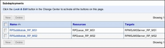

From the Settings region, select the Subdeployments tab.
One Subdeployment is created for each server.

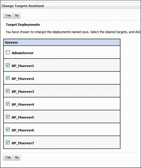

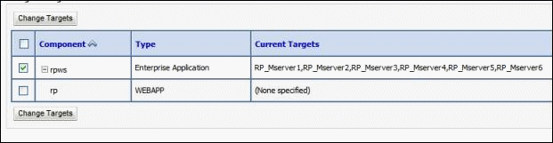

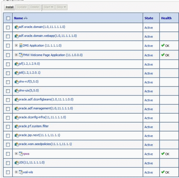

After the necessary Managed Served are added, target all the newly created Managed Servers to the Deployed Application. In order to achieve this, open the WebLogic User Interface for Engine Domain using the procedures in Starting the Engine Admin Server.

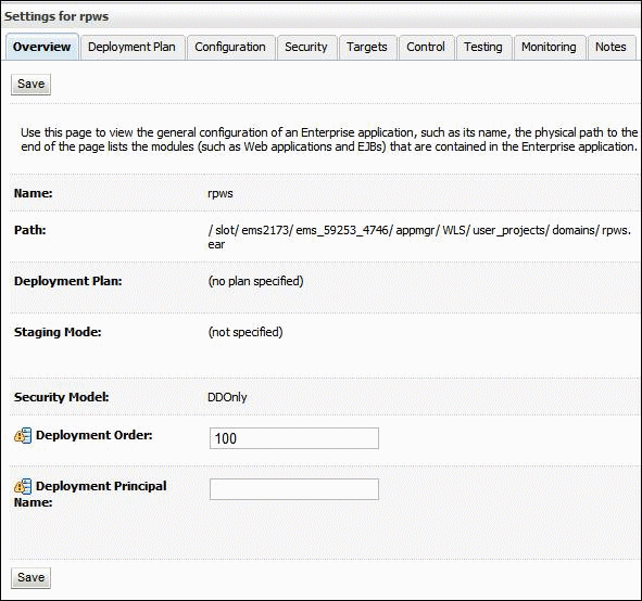

Select Deployments from the Domain Structure region.
The following page appears.
Select the Engine Application (rpws in the example).
Select the Targets tab.
Select the check box with the Type "Enterprise Application", and click Change Targets.
Check all the Managed Servers you want to deploy the application, except the AdminServer, and click Yes. Follow the instructions.

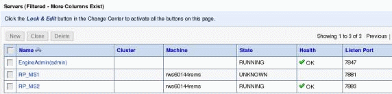

View the log file StartManServer.log to verify the Managed Servers were successfully started. To view the log file, go to the next directory WLST_log and open the file StartManServer.log file.

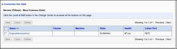

To verify the status of the Managed Servers, select Servers from the Domain Structure region.
The table displays the status of all the servers.

While performing the configuration steps, “Lock & Edit” mode is not available. Why?
The domain has been created in the Development mode. Production mode is recommended.
