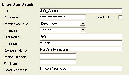

Specify basic user details as follows:
Under Enter User Details, type the following information in the appropriate boxes (or select from the drop down lists):
The user name, password, permission level, and the language in which the system will be operated. Each user name must be unique within your Demantra implementation.
The first and last name of the user, the company name, phone and fax number, and the email address. If you set up automated email within workflows, it is important to make sure the email address is correct here.
For Permission Level, see “Permission Levels”.

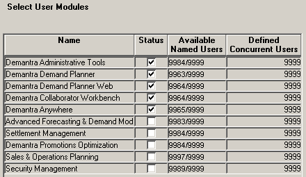

The User Modules dialog box appears. Here you specify which Demantra user interfaces this user can access.
Click the check box next to each module that the user needs to work with. Then click Next.
If you are logged in as the component owner and the user’s permission level is ‘System Manager’, then the following two options will be enabled:
Demantra Administrative Tools – Select this option if you want the user to be able to access the Business Modeler, Engine Administrator, Chaining Management, and Member Management applications.
Security Management - Select this option if you want the user to be able to create new or modify existing users or user groups. Note that users assigned to this option will not be able to create new users and give them access to Administrative Tools and/or Security Management, nor will they be able to, copy, modify or delete any existing users that have access to these tools.
Note that these options are disabled for all users except the component owner.
Users with access to ‘Security Management’ will be able to:
Maintain (create, copy, modify, and delete) any users with the same or lower module access then they have themselves. For example, if User A does not have access to the Demand Management module, then that user will not be able to maintain other users that do have access to that module.
Maintain Series, User Filters, and User Groups for the Users that they can maintain. This is true regardless of the series, User Filters, and User Groups that they have access to. For example, even if User A does not have access to the Series “Mfg Profit,” User A can still grant access to that series to other Users.

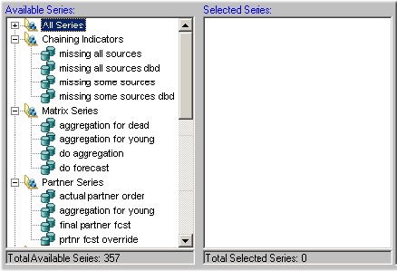

The New User - Select User Series dialog box appears. This dialog box allows you to determine what data series will be active for the new user, from the entire set of series in this component. Each list is a collapsible list of series groups and the series in them.
If a series is not active for a user, it is not available when the user creates worksheets and is not viewable in existing worksheets to which the user has access.
Specify the series that a user can see, as follows:
Move all series that you want into the Selected Series list. To do so, either double-click each series or drag and drop it.
Remove any unwanted series from the Selected Series list.
Note: You can also move an entire series group from one list to the other in the same way.
When you are done specifying series, click Next.

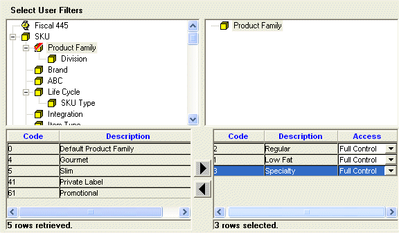

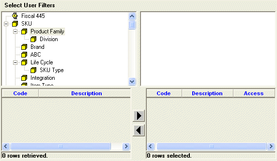

The New User - Select User Filters dialog box appears. This dialog box lets you filter the data that the user can see; specifically, you control which levels and which members of those levels the user can see.
Filter the data that the user can see, as follows:
Click a level in the left side of the dialog box and drag it to the box on the right. Or double-click a level in the left side.
Now specify which members of this level the user can see. To do so, click a member in the list, and then click the right arrow button. Or double-click the member you want to filter out.
The system moves the selected members to the box on the lower right side, as in this example:
Now the user can see only the selected members of this level. In the preceding example, the user can see only data that is associated with the Rainbow brand.
Note: The Selected Members list cannot include more than 200 members.
In the lower right, refine the security settings that control the access that the user has to each member. To do so, in the Access column, click one of the following:
Full Control (user can view, edit, create, and delete within this member)
Read & Write (the user can view or edit this member)
Read only (the user can view this member but cannot make any changes)
No access (the user does not have access to this member; this option is equivalent to not including this member in the filter)
System Default (use the default permission controlled by the DefaultContentSecurityAccess parameter)
Repeat the preceding steps for each filter you want to add. Each filter automatically limits the choices available in subsequent filters.
When you have appropriately filtered data for the user, click Next.

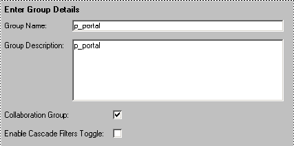

Specify group details as follows:
Under Enter Group Details, type a name and optional description in the appropriate boxes. Each group name must be unique within your Demantra implementation.
If users of this group should be able to see either other in the Who's Online pane in Collaborator Workbench, make sure the Collaboration Group check box is checked. To access the Workflow Manager, a User Group must be assigned to the workflow.group parameter (in the Business Modeler). For details, refer to Providing Access to the Workflow Editor.
The users will also be able to send tasks to each other.
If you clear this check box, users of the group will not see one another.
Check or clear the Enable Cascade Filters Toggle check box.
Click this option to enable users in the group to toggle between cascade and non-cascade filter modes. If not selected, the user will have cascade filtering only.
In cascade mode, users see only members that have combinations with the previously selected members. Members that do not have combinations will not be available in the list. It is generally easier to work with filters in cascade mode.
In non-cascade mode, users see all the members of the selected level regardless of the previously selected members from other levels.

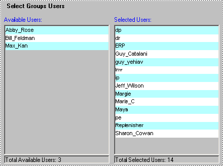

The New Group - Select Group Users dialog box appears. This dialog box allows you to select existing users who will belong to the new group.
Specify the users in a group, as follows:
Move all users that should be in this group into the Selected Users list. To do so, either double-click each user name or drag and drop it.
Note: You can also select and move multiple users with the standard Ctrl+click or Shift+click actions.
Remove any unwanted users from the Selected Users list.

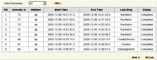

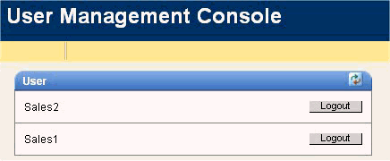

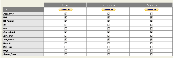

Demantra provides a tool that you can use to log out users whose sessions have hung due to network or other problems. This applies only to the users of the Web-based products
Note: A user with permission level below System Manager can log into this tool and end his or her own session. Other users will not be visible.
To log a user out of Demantra
Browse to the following case-sensitive URL:
http://server name/virtual directory/portal/userManagement.jsp
For example:
http://frodo/demantra/portal/userManagement.jsp
A login page appears.
Type your username and password and then click Log on.
Demantra displays the following screen:
Click Logout in the row corresponding to the user you want to log out.

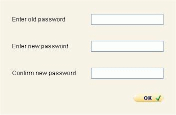

The Business Modeler displays the Change Password screen:
Type your current password in the Old Password field.
Type your new password in the New and Confirm New fields.
Click OK.

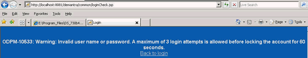

If a user attempts to create a new password that does not follow these policies, a message notifies the user of the password policies.

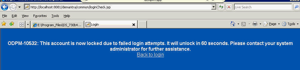

If the user attempts to login and fails, a message similar to the following appears:
The number of tries allowed by the password policy is determined by the system parameter “AccountLockoutThreshold”. (see System Parameters).
If the user is locked out because of too many failed attempts, the following message appears:
An administrator can unlock the user’s account by logging into Business Modeler, navigating to Security > Create/Modify User, and then deselect the Locked check box. If the component owner is locked out, they can log into the Business Modeler and unlock themselves.
If an administrator explicitly locks a user’s account, a different message appears, saying that the account is locked and to please contact your system administrator.
Note that this locking applies to Collaborator Workbench, Workflow Manager, Administrator Login, Demand Planner Web, Dynamic Open Link (DOL) , Demantra Anywhere.Locking does not apply to the Business Modeler, Member Management, or Chaining Management.

The workflow process log displays information on all the workflow instances that have run or that are running.
To view the process log
On the bottom of the Workflow Management page, click Process Log.
The Process Log page appears.
To filter process log entries
Select the required filter from the View Processes drop-down menu.
Click View.
The filtered processes are shown.
See also:
“Viewing Workflow Status”
You can control access to the different Collaborator Workbench panes (My Tasks, My Worksheets, and Who's Online).
To specify access to Collaborator Workbench panes
Log into the Collaborator Workbench Administrator. See "Logging onto the Collaborator Workbench Administrator".
The Administration page appears.
Click Define Content Security.
The system displays a table with one row for each user. Here you specify which panes to make available to each user.
Do one of the following:
Check the check box for a pane to grant user access to the user.
Clear the check box for a pane to deny access to the user.
Click Finish.
