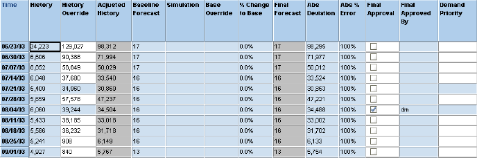

The Demand Tracking table compares sales and demand figures, at your chosen aggregation level, in weekly time buckets. It gives analysts a side-by-side view of their actual sales, demand and forecasted sales, along with Absolute Deviation and Absolute Percentage Error for comparison.
This table tracks the following on a weekly basis:
History
History Override
Adjusted History
Baseline Forecast
Simulation
Base Override
% Chg to Base
Final Forecast
Absolute Deviation
Demand Priority
This table also enables users to track final approval for each line in the forecast. For more information, see Approving the Forecast.

In My Worksheets (in Collaborator Workbench), click Demand Analysis. Or if a worksheet is currently open, click File > Open. Click Demand Analysis and then click Open.
If the worksheet does not show data immediately, click Data > Rerun. Or click the Run button.
This launches the Demand Analysis worksheet.
Enters data in the History Override field for history or base override and/or the % Chg to Base field for the Forecast.
The results are shown in the Adjusted History and Final Forecast columns.
Note: You can select and edit multiple cells.
From the Data menu, choose Save Data. Or click the Save Data button.
From the Data menu, choose Rerun.
The worksheet updates to display the edited values.
